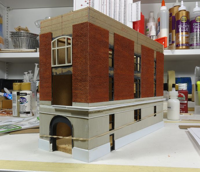

I applied 8 separate pieces of Monster Modelworks brick sheet to the walls. I used only a primer coat of Burnt Sienna for now.
All sections attached.

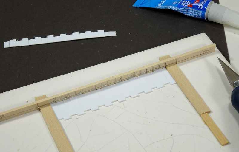

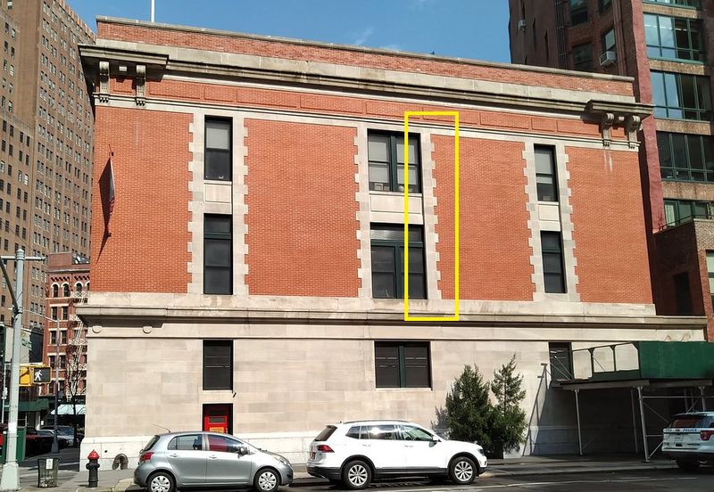

A prominent feature on the building are these vertical sawtooth borders along the 2nd & 3rd floor windows.
My first idea to make them failed, so I settled on a simple jig. (16) .02" X .125" (.5mm X 3.2mm) styrene strips are butted side by side against each other, with .02" X .156" (.5mm x 4mm) for the top & bottom to fit the space properly. I fashioned a 3 sided frame to the exact dimension: 2.79" (71mm), then carved out notches in a piece of strip wood that each styrene strip would slide into. Then trimmed to the correct width. A test piece is laying in back.

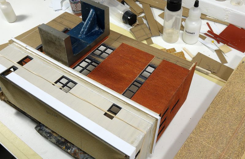

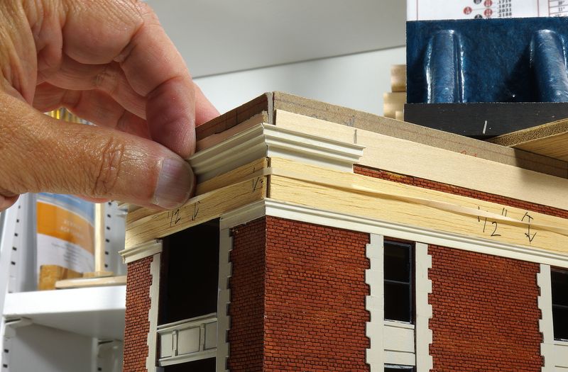

Moving up above the windows, the largest ledge was built up from more Evergreen strip. I made a 1/2" (12.5mm) tall balsa "spacer" to keep the trim in the right place, and hold it level for drying.

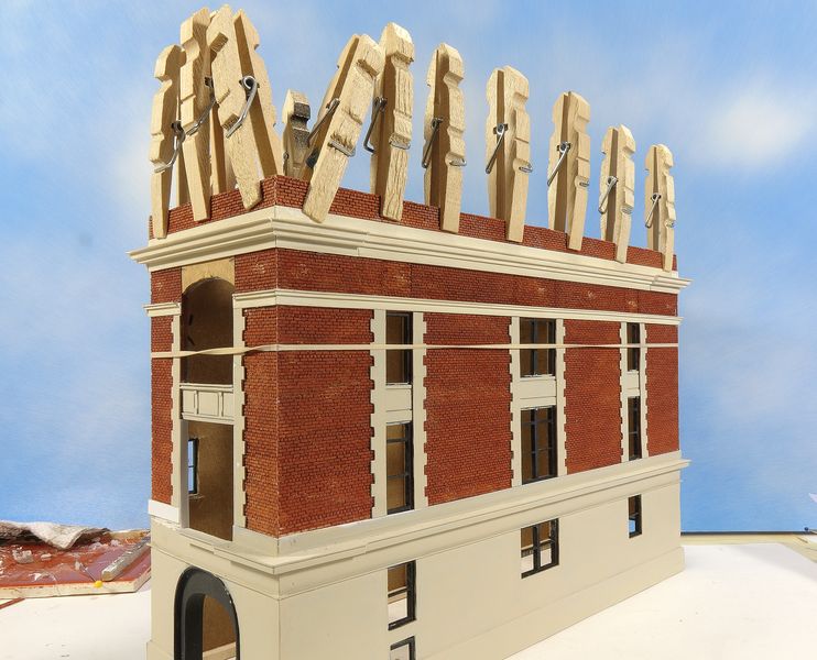

The next section up is brick again, here gluing more sheet in place.

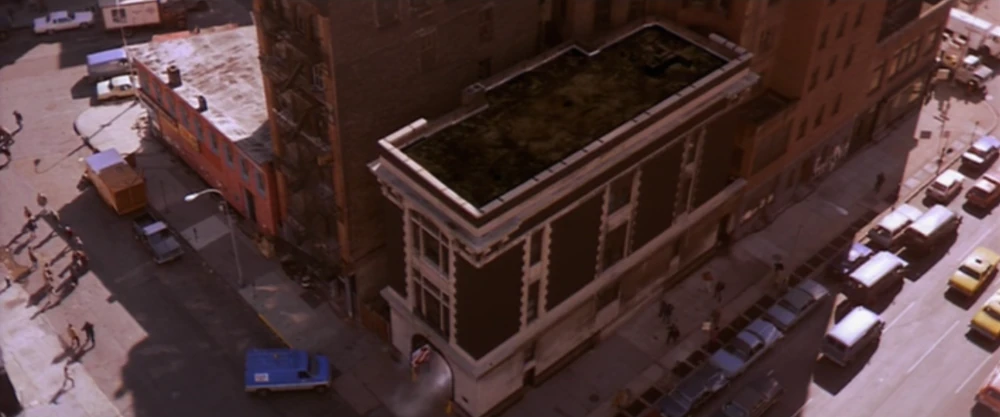

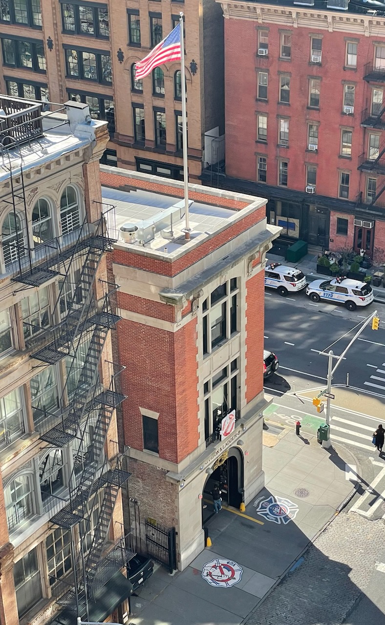

Did you find any good references of the roof?
Google Maps shows a lot of stuff up there while Bing lets you zoom in more but has a lower resolution of it, but the only thing I could find online is this partial distance view.
The matte overpaint in the movie was mostly featureless, probably to spare them the need to animate any complex debris blowing away in the roof explosion scene. Fan recreations and the cartoon and comics all put different stuff up there or leave it blank.
The stuff on the roof in the partial view looks pretty new - I'm guessing it's a new HVAC system(?) - and doesn't seem like it was on the firehouse back in the 80s.

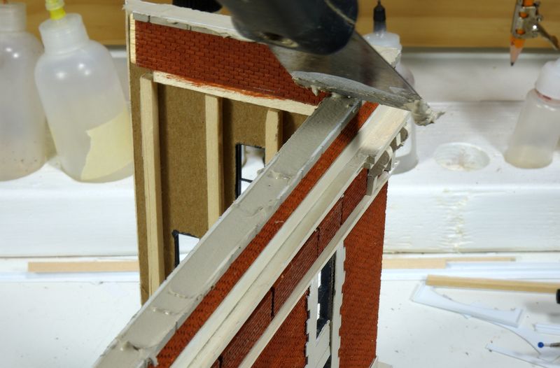

Next, I filled the "channel" created by the strips with gray tinted drywall compound.
This will shrink a bit and need a 2nd coat.
After the drywall compound dried, I scribed mortar lines into them, matching the others. Complete, with 1st coats of paint.

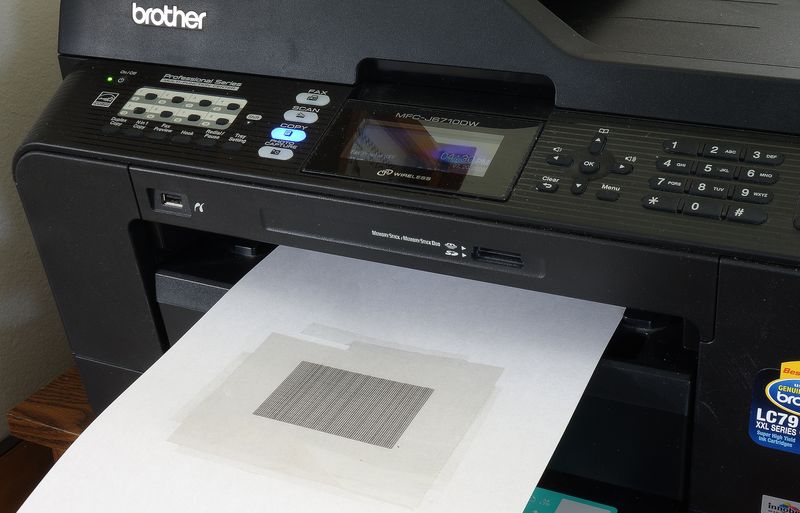

Experimenting with printing the muntins for that door on an average clear piece of scrap acetate.. let it dry for a few days....I have previously used transparency film, but I just wanted to test it......Actually, not looking bad at all.
