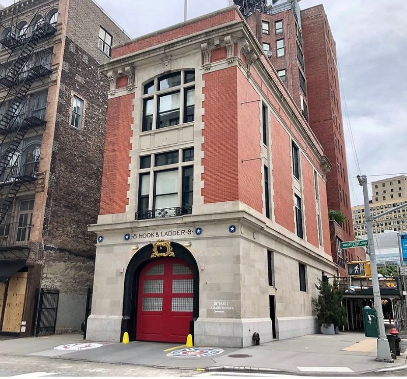

The firehouse was built in 1903 in the French based Beaux-Arts architectural style, common in the U.S from 1880 till 1920. Features of this style include an oversized first story, arched windows, symmetry, and other classic details.
Hundreds of fan photos exist on-line, many were high resolutions images that should give me the opportunity to blow up the details..

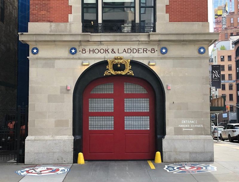

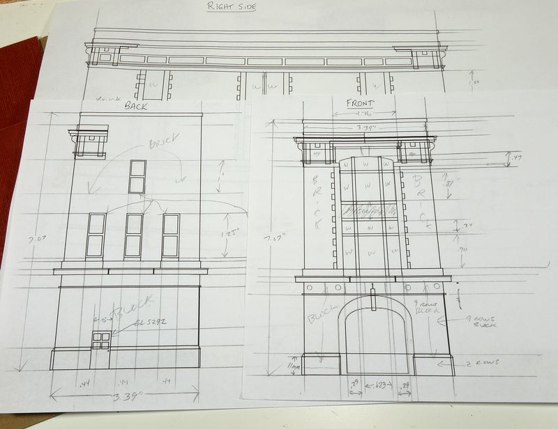

You Tube modeler Dave Hourigan (Dave's Model Workshop) happened to display his own build of the firehouse recently, and I emailed him about the CAD plans he drew up for his project. He gladly sent me PDF copies, which saved me the time and effort of generating my own.
I reduced Dave's' (larger than 1/48 scale) plans to 1/87 scale. Based on Google satellite images, the prototype perimeter is approximately 25 ft X 75 ft.
By 1/87 standards, the actual dimensions are large, approx. 10 1/8" long, 3 3/8" wide & 7" high. I started taking my own measurements.

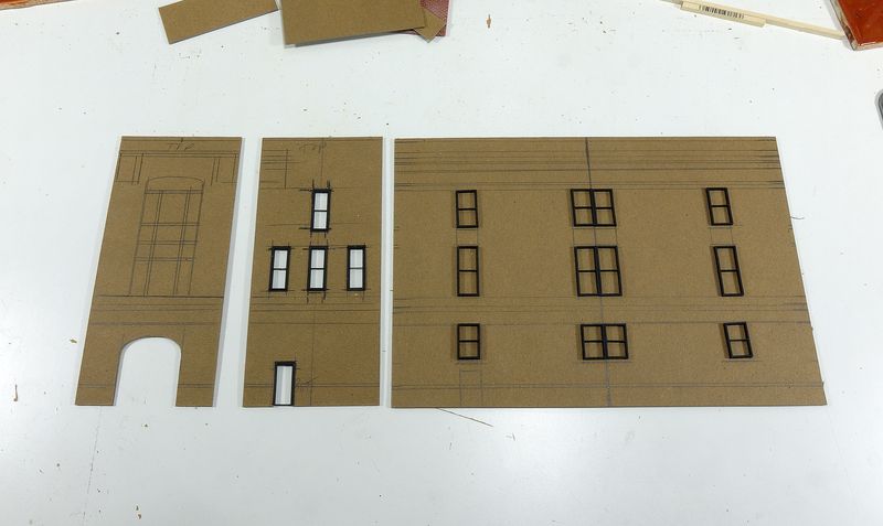

The substrate for all four walls is .05" chipboard. Testing window and door locations here...

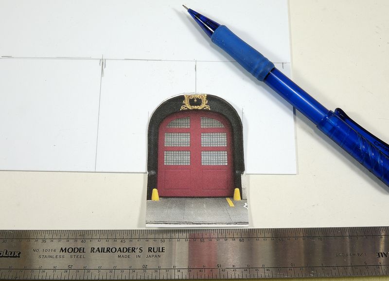

I printed a photo of the front door in 1/87 scale to get the shape of the door frame, and traced that onto ."04"(1mm) styrene sheet.

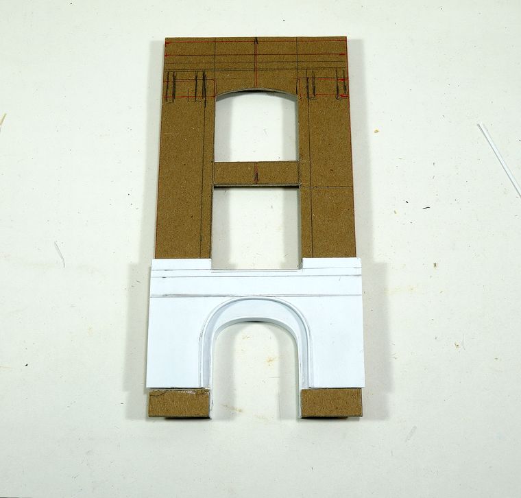

There are actually two arches, one structural, the other decorative. The bottom, or first layer was .010" (.25mm) styrene. Each side was run long and then sanded down to a 45 degree angle at the corners. I'll build the door later on.

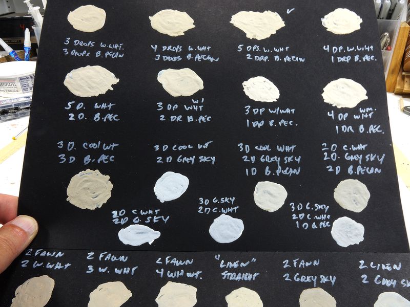

Finding a suitable color for the non-brick masonry was difficult, and I tried 21 different recipes. In the prototype photos, depending on the time of day, season, sunny or cloudy, they all look like a different shade! .... I compromised and finally settled on the third one in the top row....

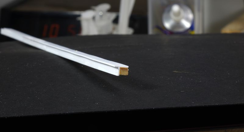

A large ledge is located at the top of the first floor. It's made from two styrene strips, but with a strip wood core. This provides rigidity & gluing surface, rather than just an L-shaped strip of thin styrene.
