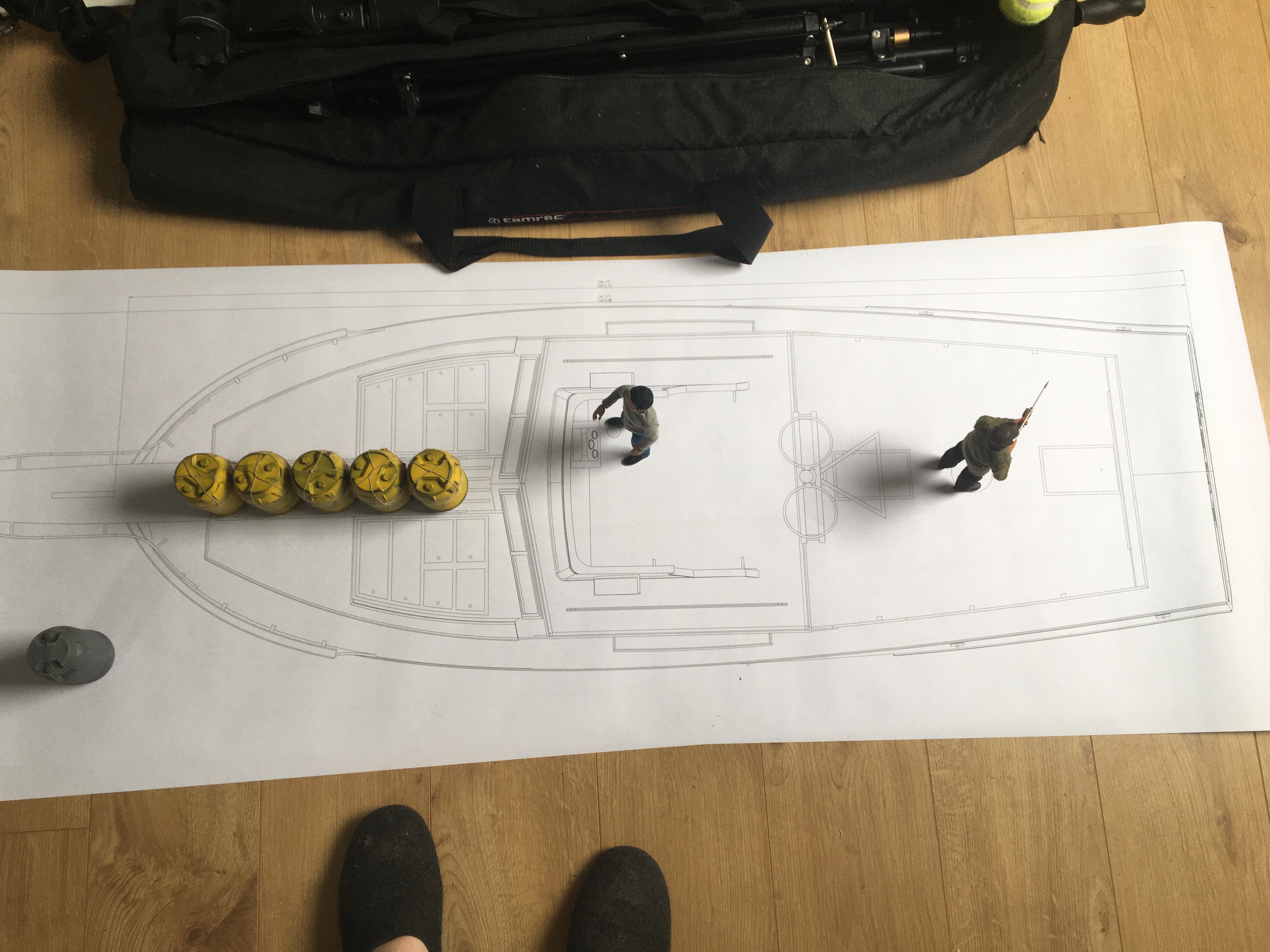

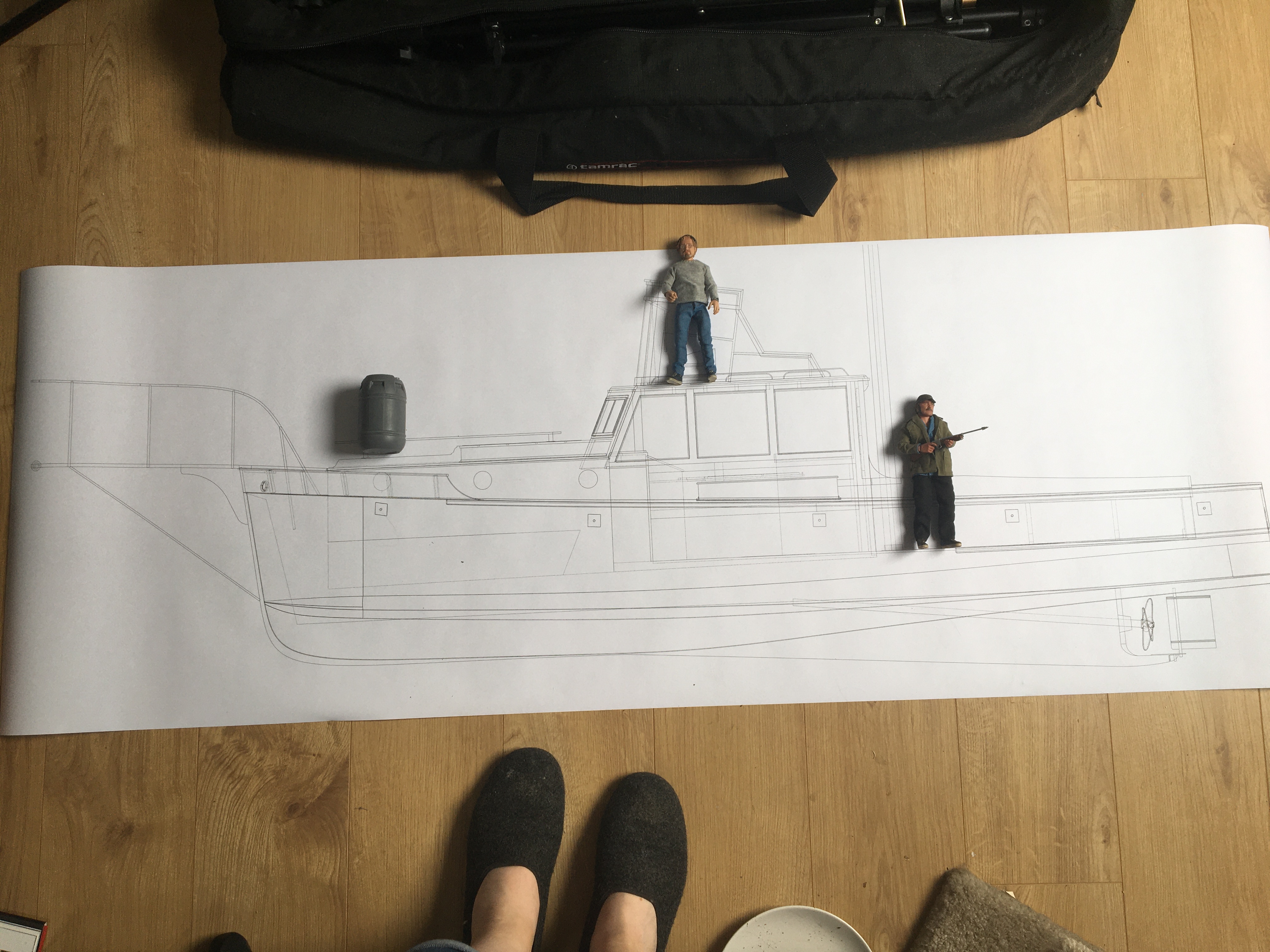

So I think I've got the proportions right now. (For me anyway) I did have an overall dimension that worked. So I've been working off things I can, like the size of the cage, barrels, and actors' height compared to screen grabs. This isn't to say I haven't got it wrong but as it stands now am at 47'7" with the platform and 39'7" without. that would make my model 5'3" (1620mm)

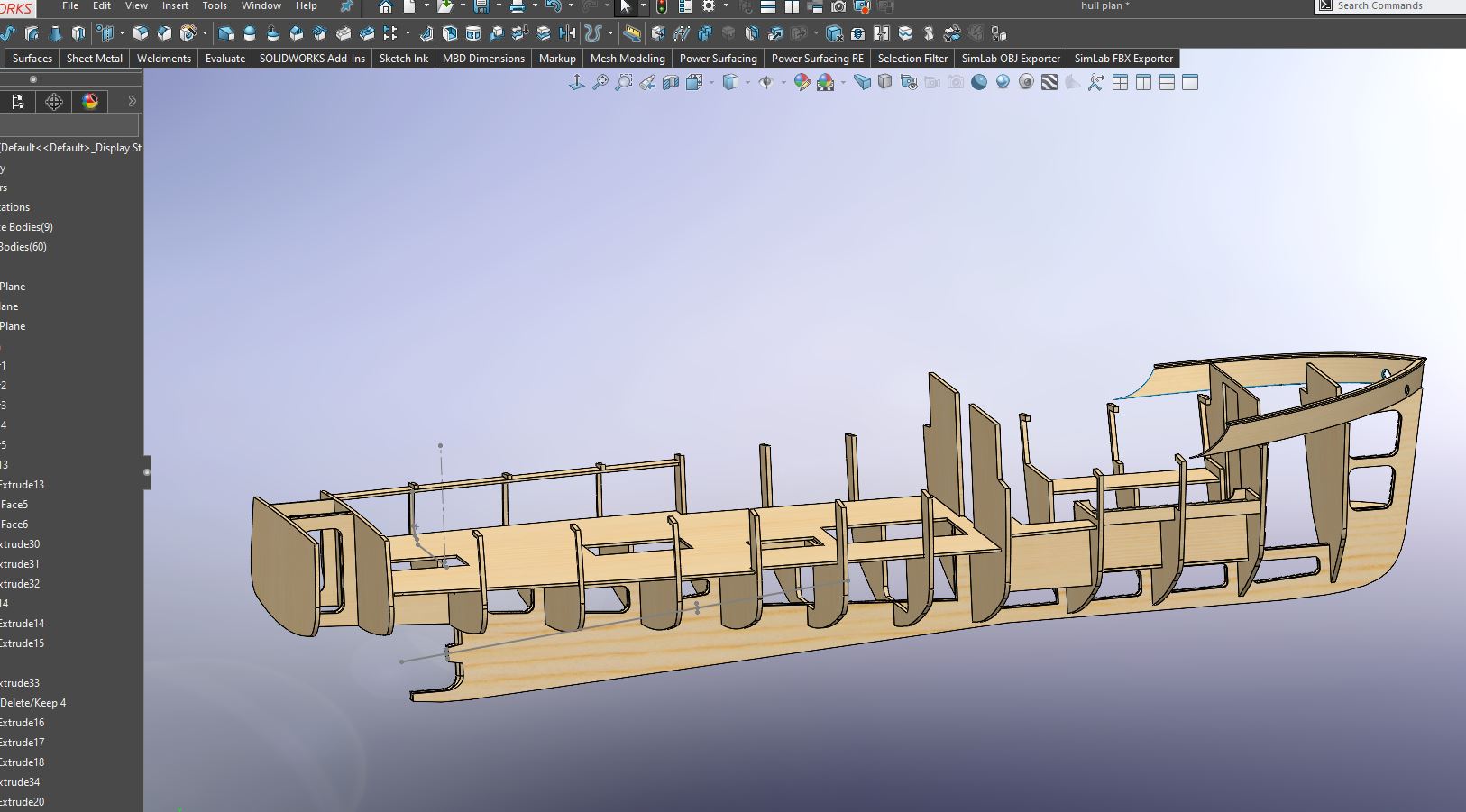

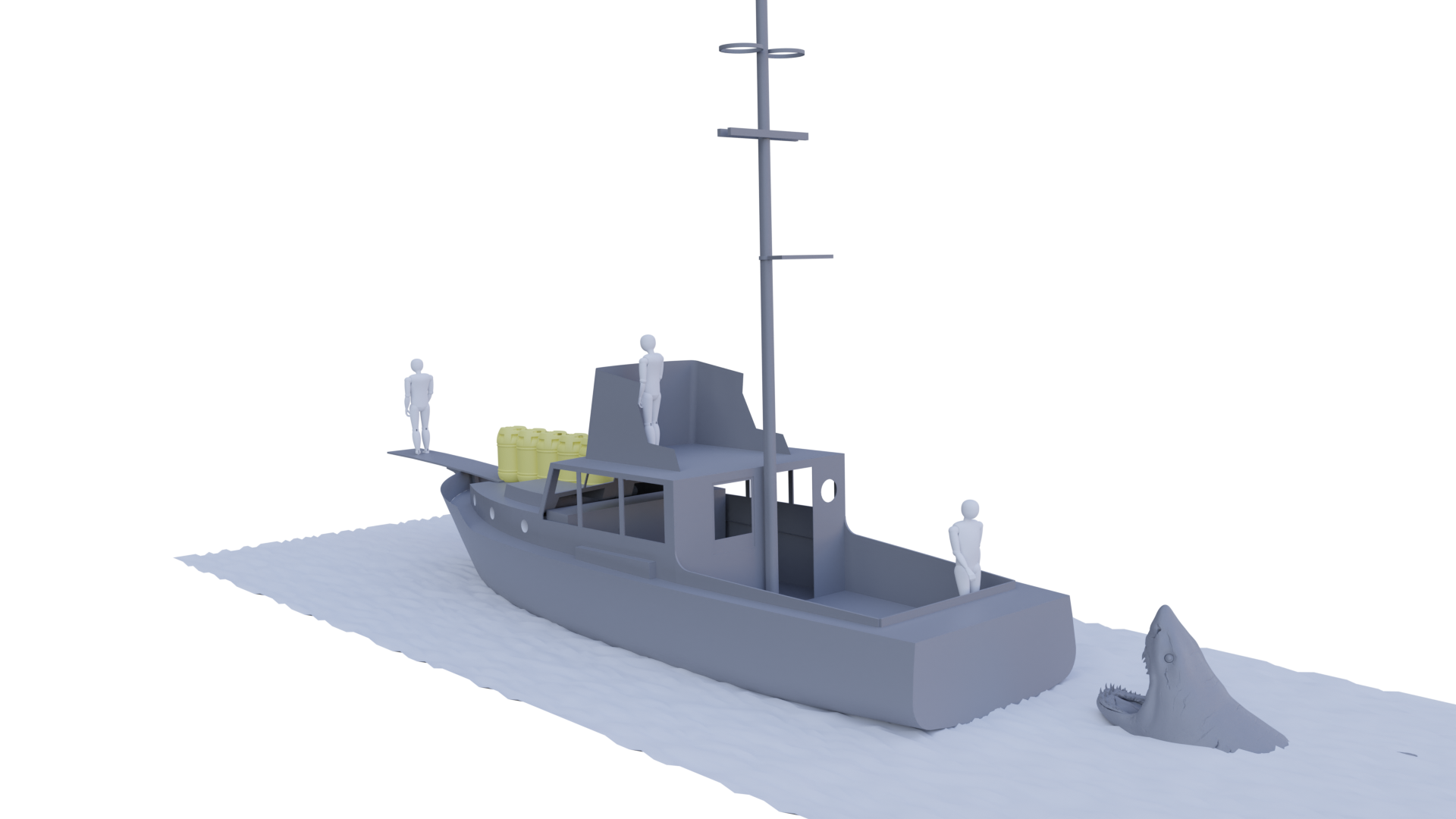

So, first render of the shape so far. This has none of the detail or props, that will come later I just need the CAD model to start making the paper plans. having done a deep dive in to screen shots during this prosses I've noticed I need to redo the roof and upper deck angles. but the proportions are in the right place now. I start cutting wood next week.

well its been raining here so did the changes to the roof and added some more details. I'm pretty happy with the scale now don't think I can get it much closer without standing next to the real thing and that is out of the question now.

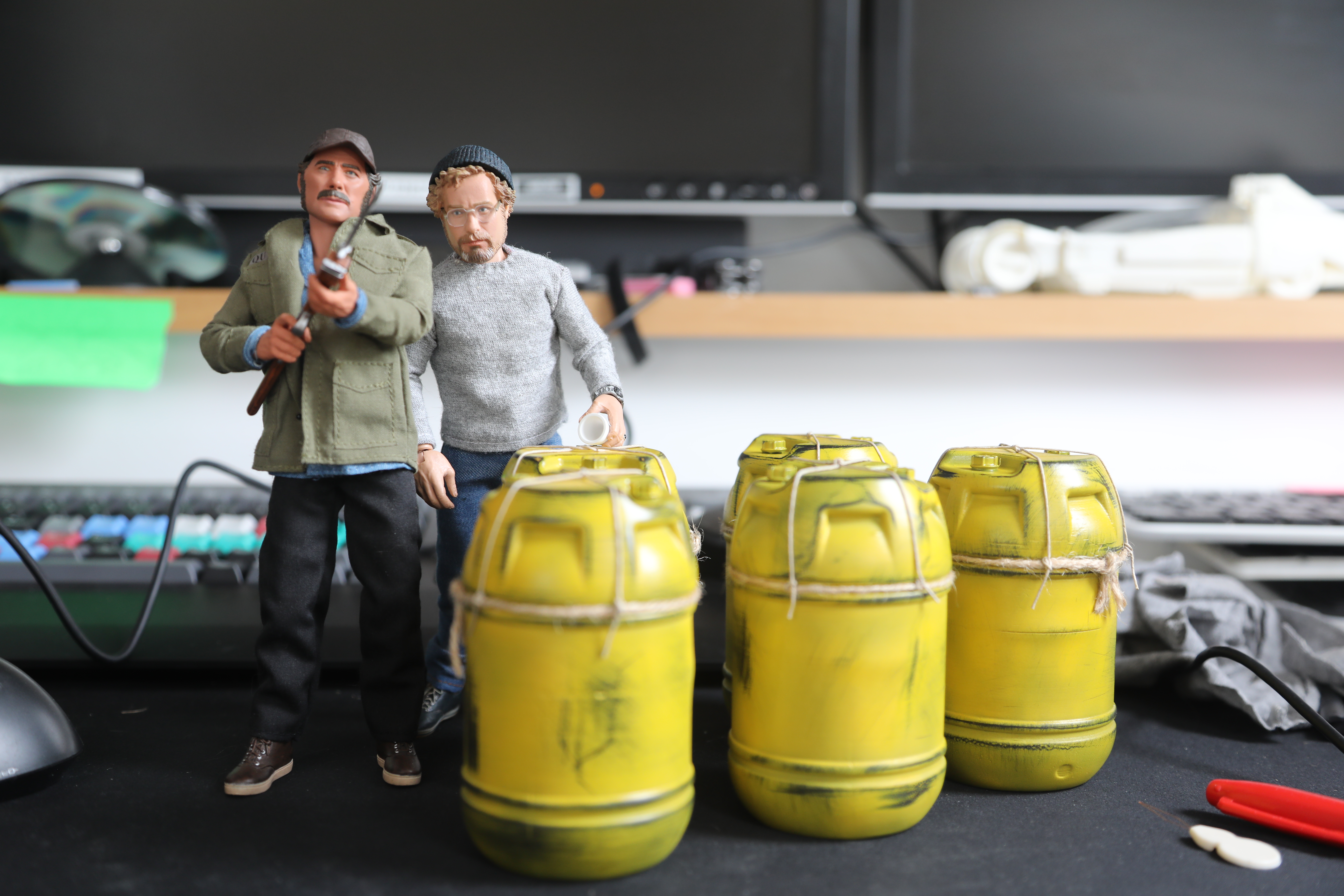

I really like what you're doing with this build! Looking forward to seeing the Orca done out and these figures manning her!
BTW: nice work on Hooper's sweater! :D
