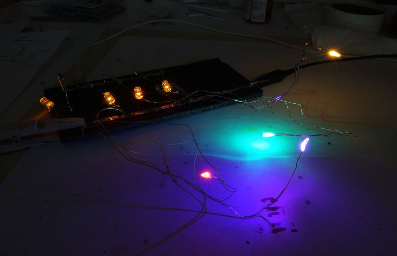

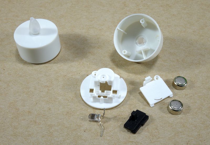

Started lighting...I harvested some "flickering LED's" from these dollar store "tea lights"...these will drive new LED's....
Built a test circuit board with four colors of LED's, including red, purple, yellow and green for a "spooky" random flashing effect inside....Aware that some are not interested in the electrical/lighting phase, I'll stop here on this subject, unless interested parties want a detailed explanation of how it's wired.....

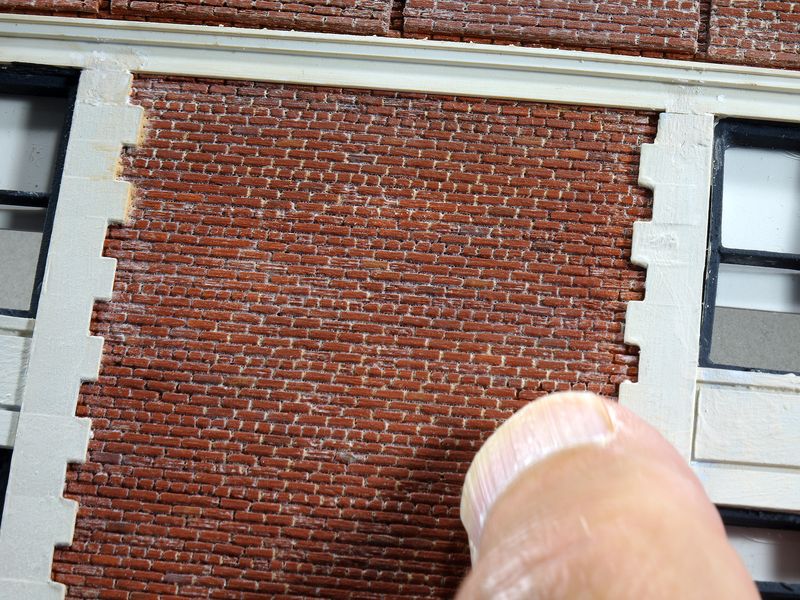

The brick walls were ready to receive some attention. The mortar mix is a very watered down Liquitex Modeling paste.
I brushed it on and immediately wiped away the excess with a finger.

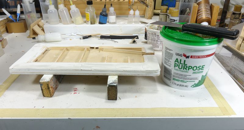

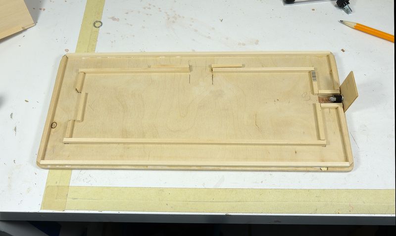

At the same time, I'm building a base from 7/32" (5.5mm) plywood. Just enough room around the model perimeter for a side walk in the front & right sides, and some grungy alley neglect on the back and left side. Power jack on the right.
Building up two coats of drywall compound & will scribe expansion lines into later...

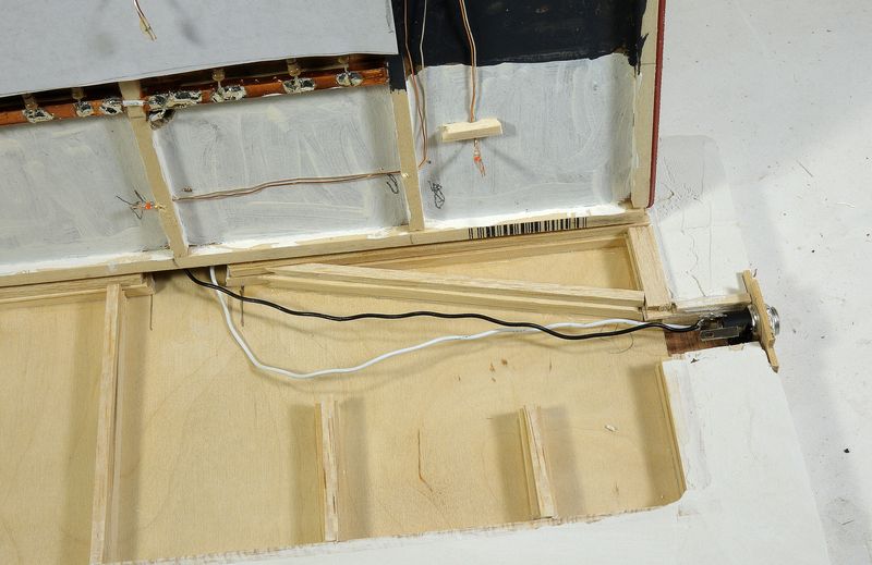

The wiring is concealed thru the chimney chase, and under the base to meet up with the DC power jack.
I'll be using a 12 volt wall wart.

That really looks good. A close up of the brick, without knowing its a model, and it probably could fool someone to thinking it was full sized.

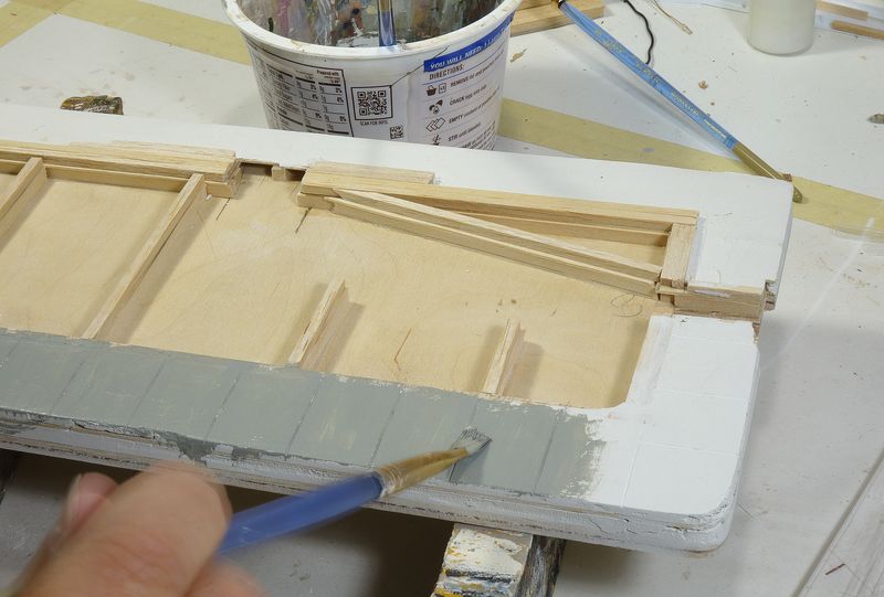

I scribed sidewalk expansion lines in the dried joint compound, and painted a first coat of concrete gray.

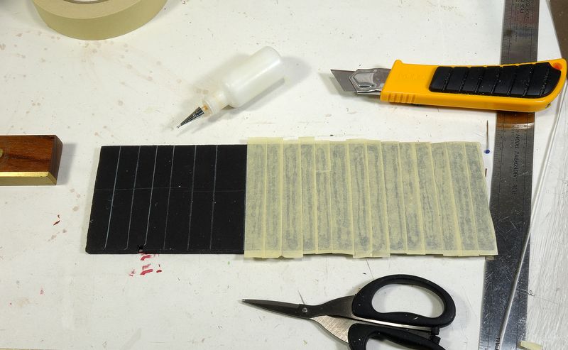

I built a simple roof, just masking tape over a black foam core.

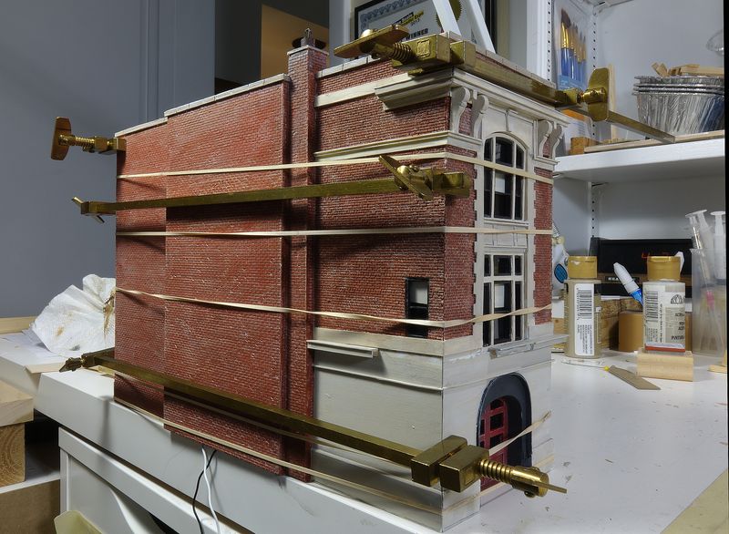

Glue up of the last (side) wall..goodbye (permanently) to lighting access..

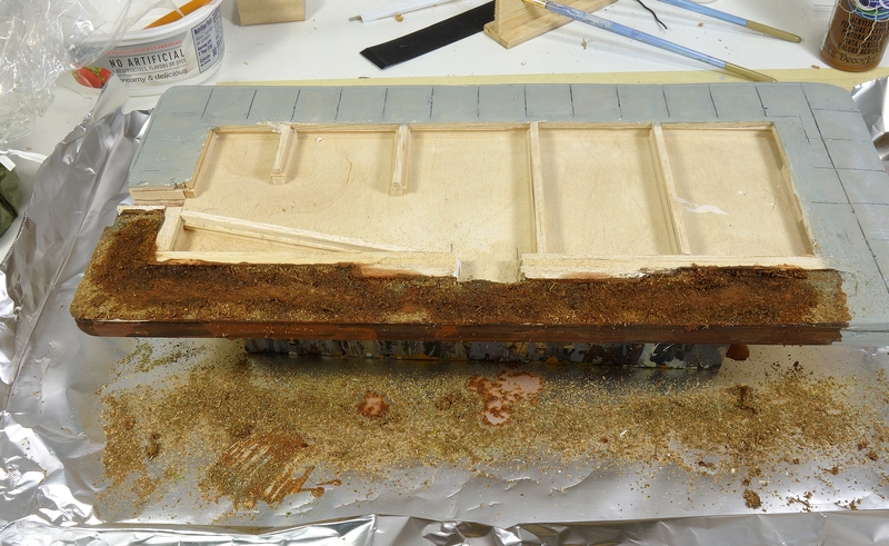

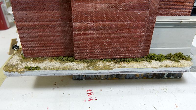

1st layer of a narrow strip of alley scenery.

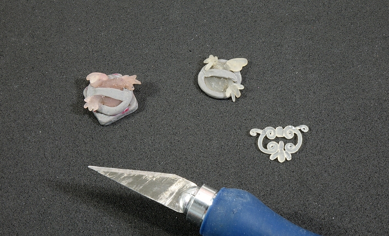

I asked my son-in-law to use his sculpting skills to create the large filigree above the door, and the double-sided Ghostbusters logo sign. He used Sculpey Primo for the logo, and Sculpey Firm for the filigree. These are after they were baked in the oven....

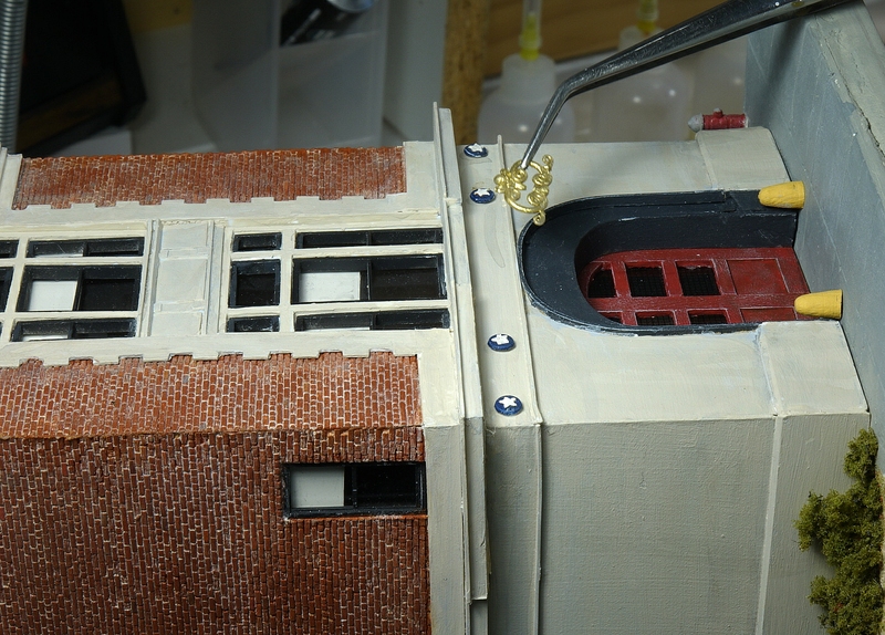

The filigree received a coat of gold gilding wax.

Love it to bits Carl; I love how you've painted the brick wall with different shades of red: looks really life-like:cool::cool:(y)(y)
Searun- Thank you very much. I always enjoy sharing as much as feasible, in order to encourage others.
Joberg- Thanks, I appreciate your continued support. I've built many masonry/brick buildings, and painting
several shades of red on individual bricks is a reliable, albeit tedious, technique.

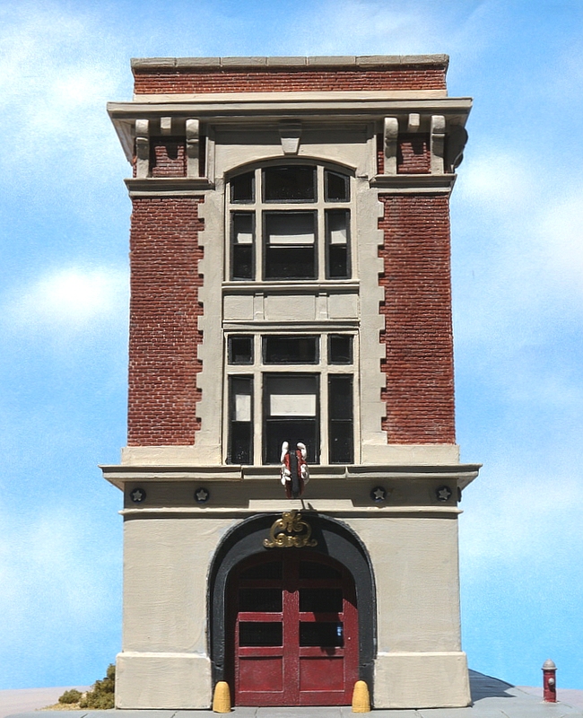

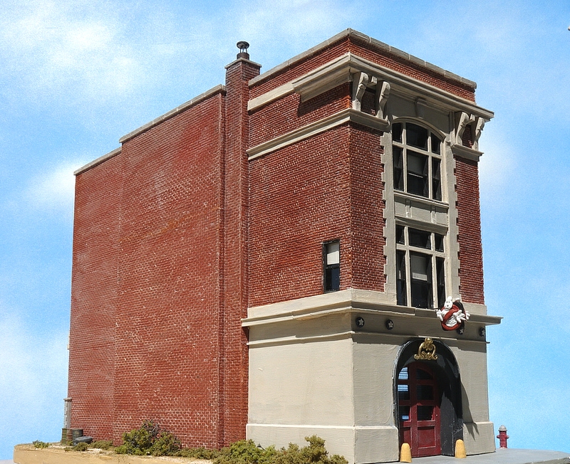

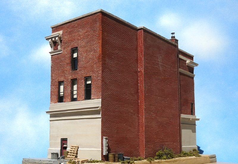

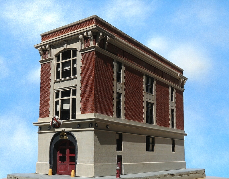

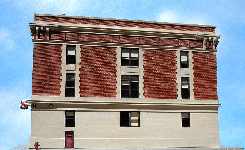

Final pix ... Hook & Ladder #8 station... otherwise known as the Ghostbusters Firehouse Headquarters
After cutting the 12 1/2" x 5 3/4" (317mm x 146mm) base, we decided the Ecto1 car and 4 characters just didn't have enough room to display properly. There's only 1" (25mm) from the walls to the edge.
I needed 3 walls to be assembled early on in the process, to align mitered corner moldings. This made it extremely difficult to work on.
I deliberately kept weathering to a bare minimum.
Thanks to everyone who read and commented on this thread. I appreciate the encouragement of all forum members (and guests too). Many challenges were here. I learned some new things-tried a few techniques. I hope I explained my procedures plainly, and passed on some construction tips along the way....any questions, just ask.
