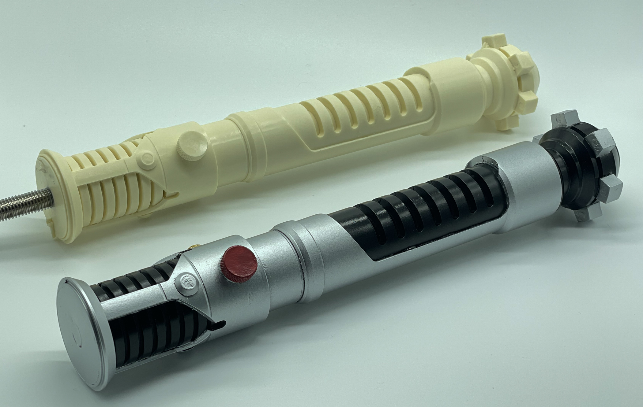

The original stunt props were cast in an off-white polyurethane resin using a mold created from the original metal hero prop. For this project I have created a similar mold using my own personal replica from the recent hero run I worked on with the venerable Anakin Starkiller.

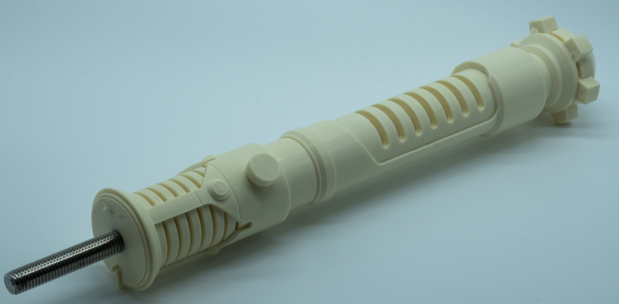

Raw casting with threaded rod on top, painted casting without threaded rod on bottom.
The original mold was a cut type mold which resulted in each casting only having a single seam line. I have devoted a lot of time and effort to develop an equivalent mold that, like the original, results in a single seam line running down the "back" of the lightsaber (180° from the red button). Each replica will be pressure cast using a similar off-white polyurethane resin (currently I am using Smooth-on Smooth-Cast 321). Here are some additional examples of the recent castings I have produced:

RESIN CASTING DISCLAIMER: Just in case anyone is not familiar with the resin casting process, I want to make it very clear that the process inherently yields flawed results. While I take every effort to produce the best casting possible, the process naturally involves seam lines, bubbles, and other imperfections. As mentioned above I am using a type of mold that should minimize the seam lines and I will be using a pressure pot to minimize the bubbles. However, each raw castings will require some sanding and filling! Furthermore, I am just one man (with a full-time day job), not a production shop. As such, each casting will be handmade and no two castings will be identical.
Here is an example of one of the worst case seam lines (taken at an angle and with lighting intended to accentuate the seam line). This can be removed and become invisible with some time and sanding:

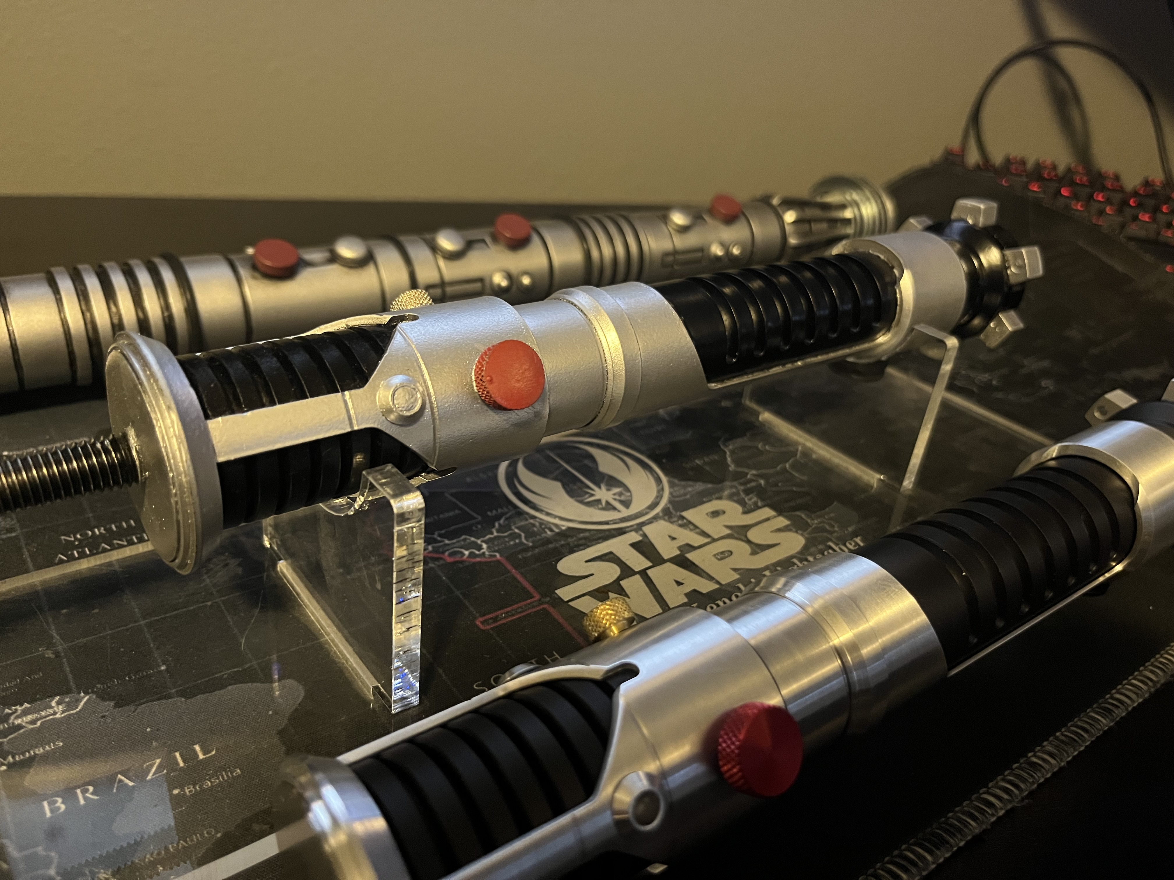

Well, I did a much better job finishing the metal Dewy/ AS Obi tpm hero than this stunt but I'm still pretty happy with how it came out. At first, I had the grips all black like most of the rest of the people who've posted their results then decided I wanted the inside silver because I hate myself (jk it was just way harder than I thought and messed up my silver to black transition lines which had to be then redone.) Anyway, here it is, just needs a blade. Thanks again Dewy!
