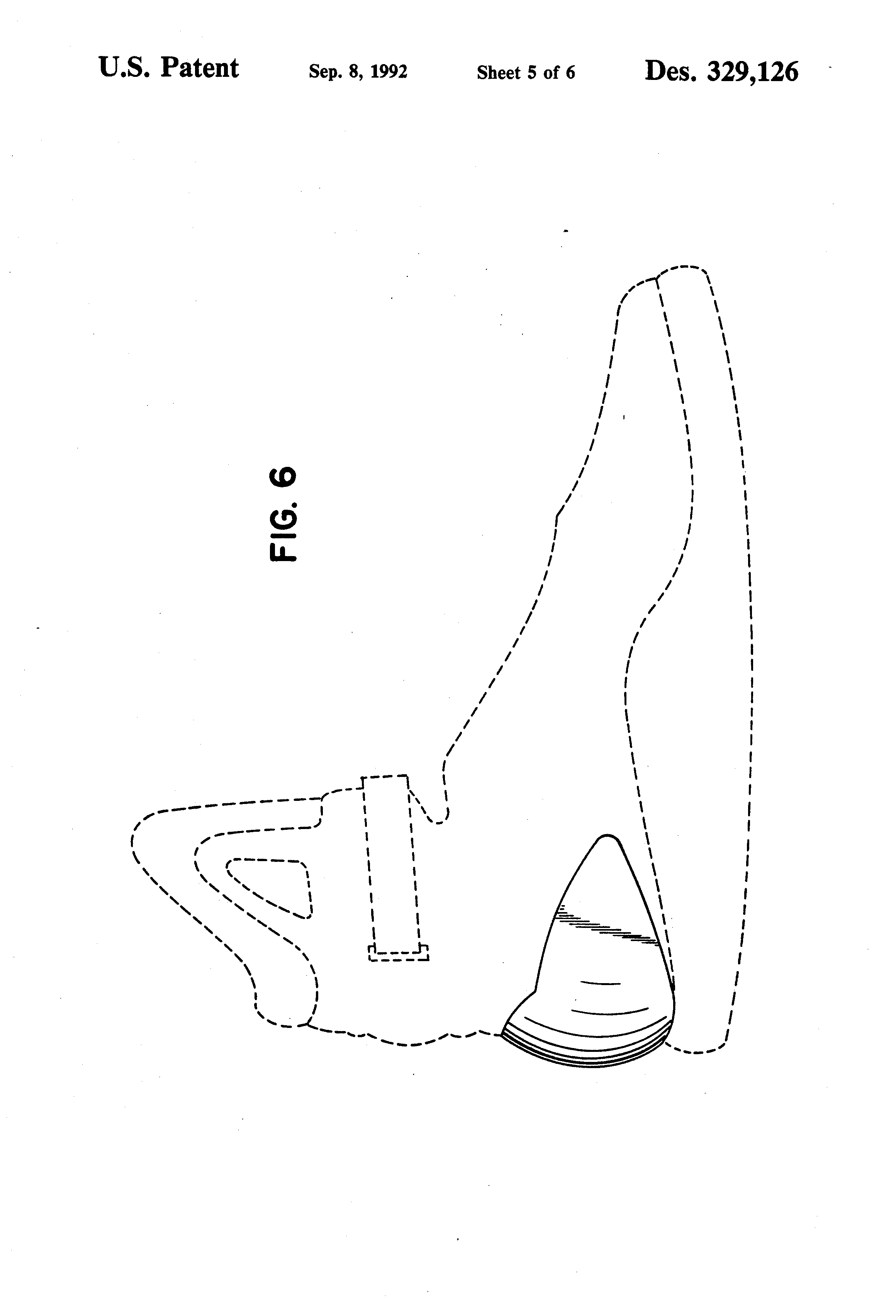

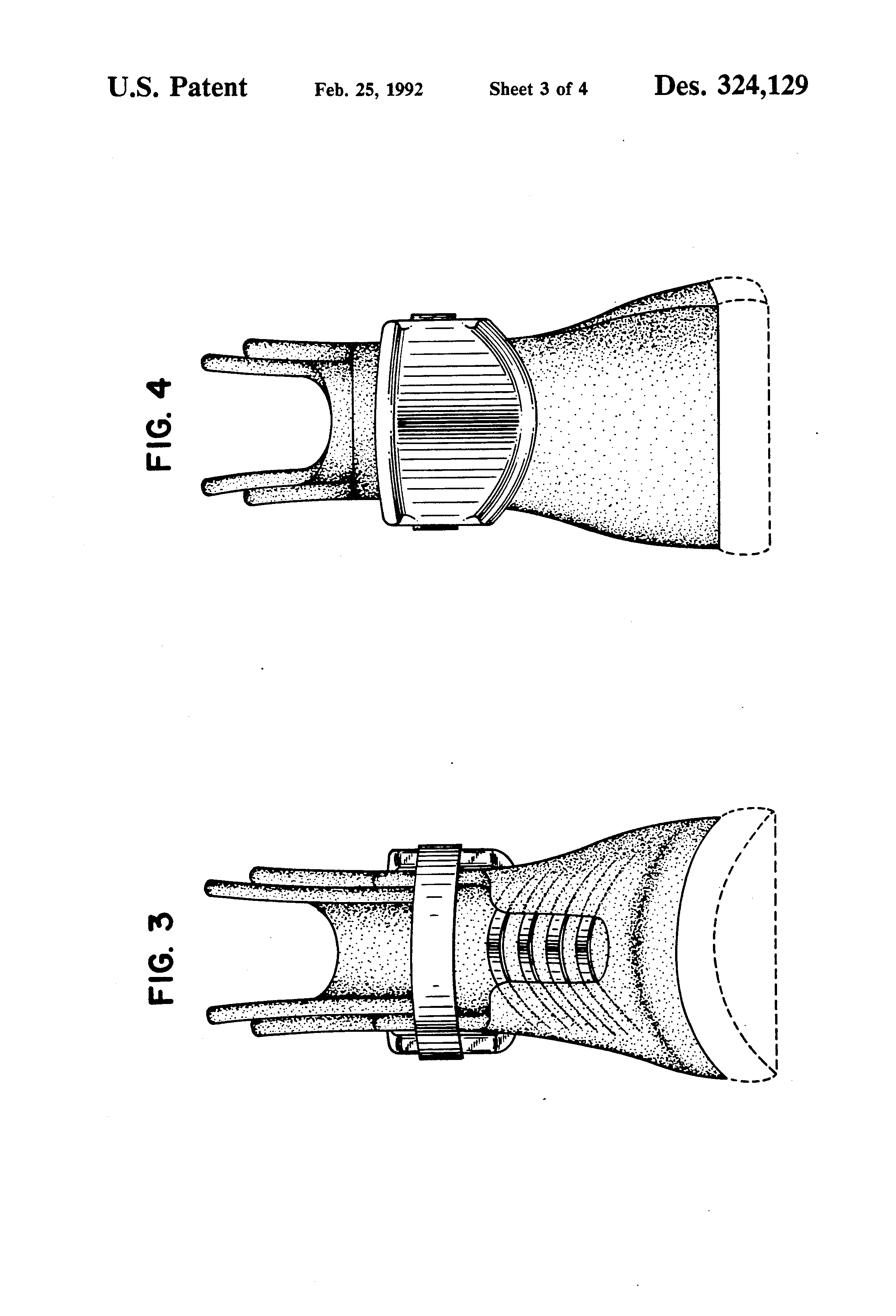

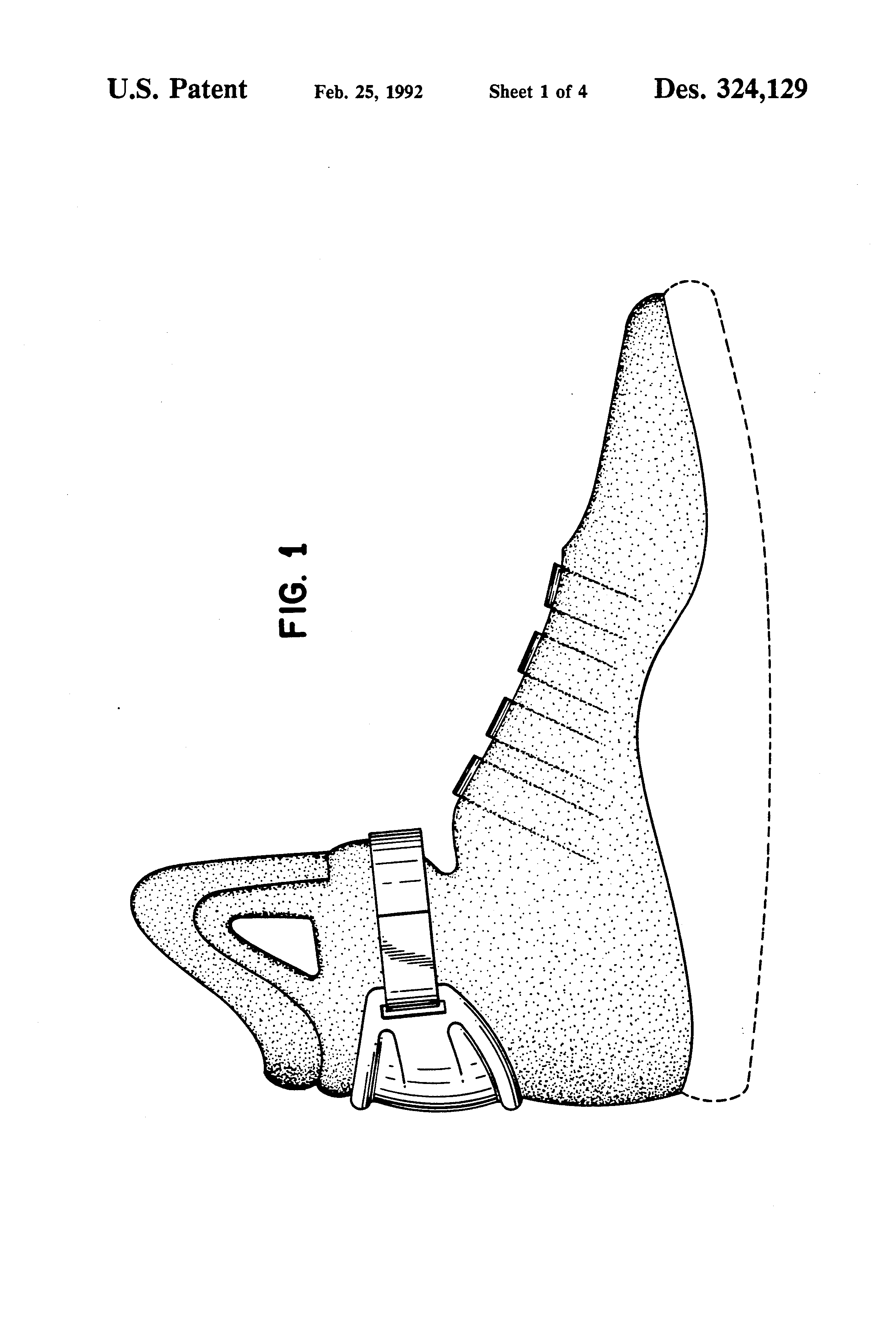

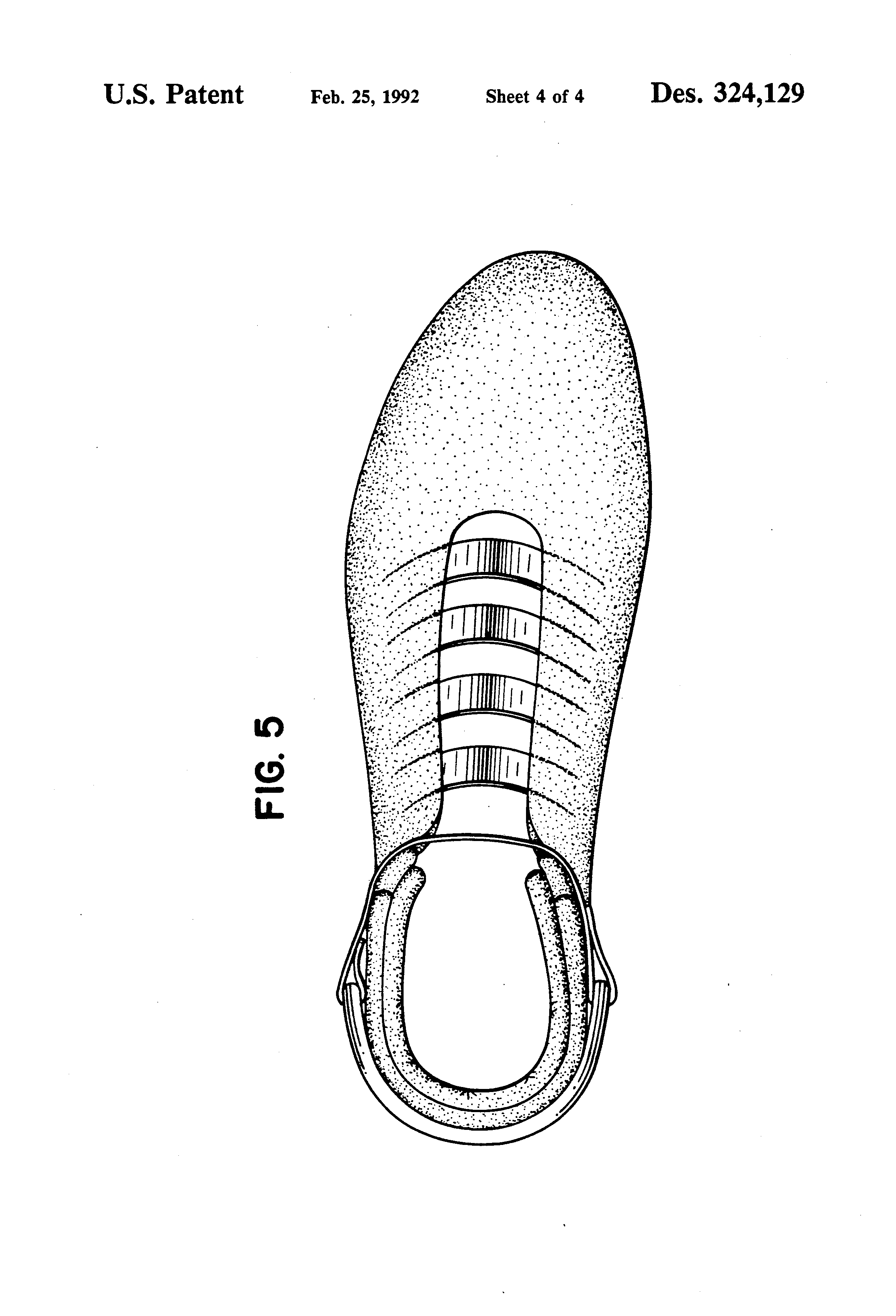

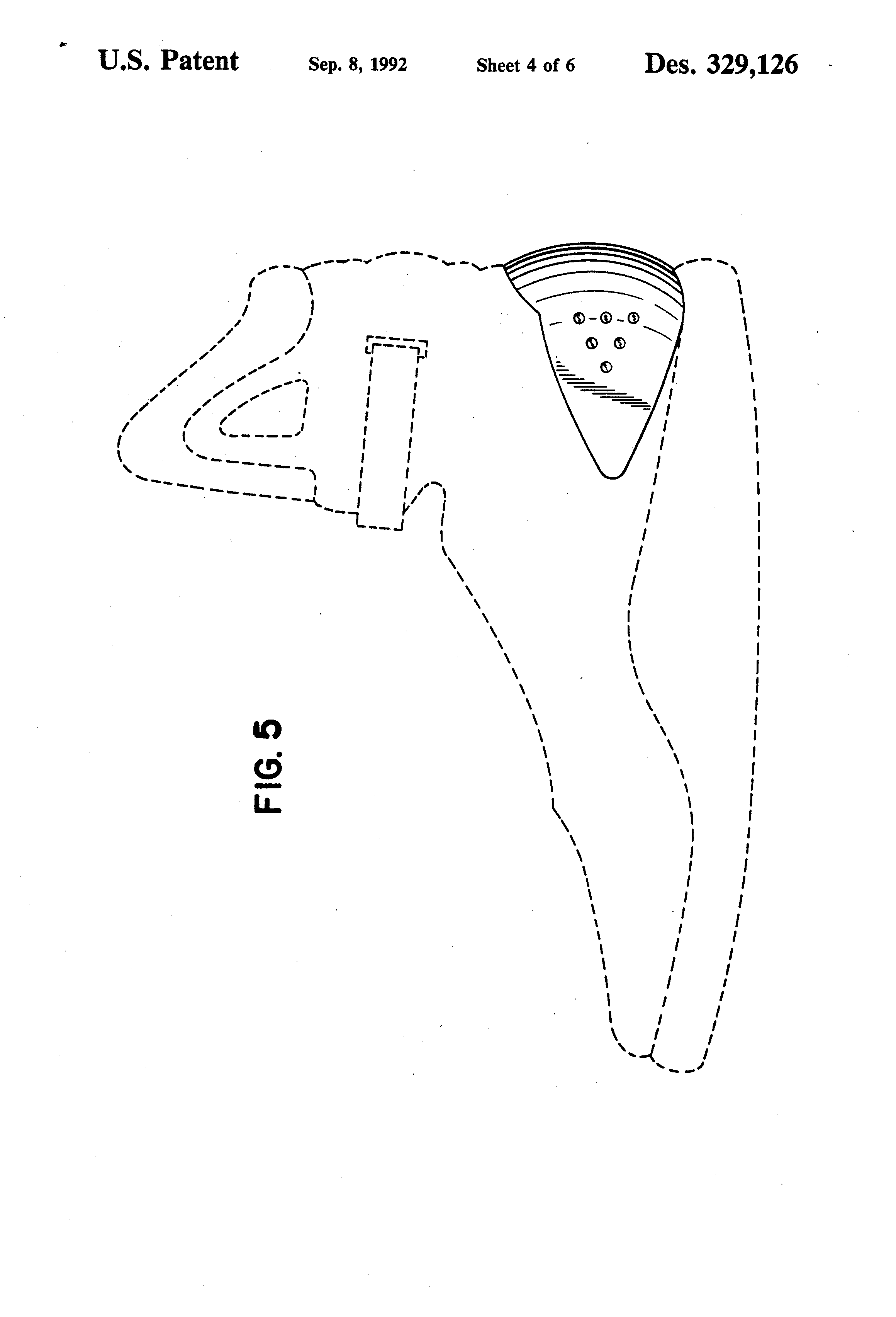

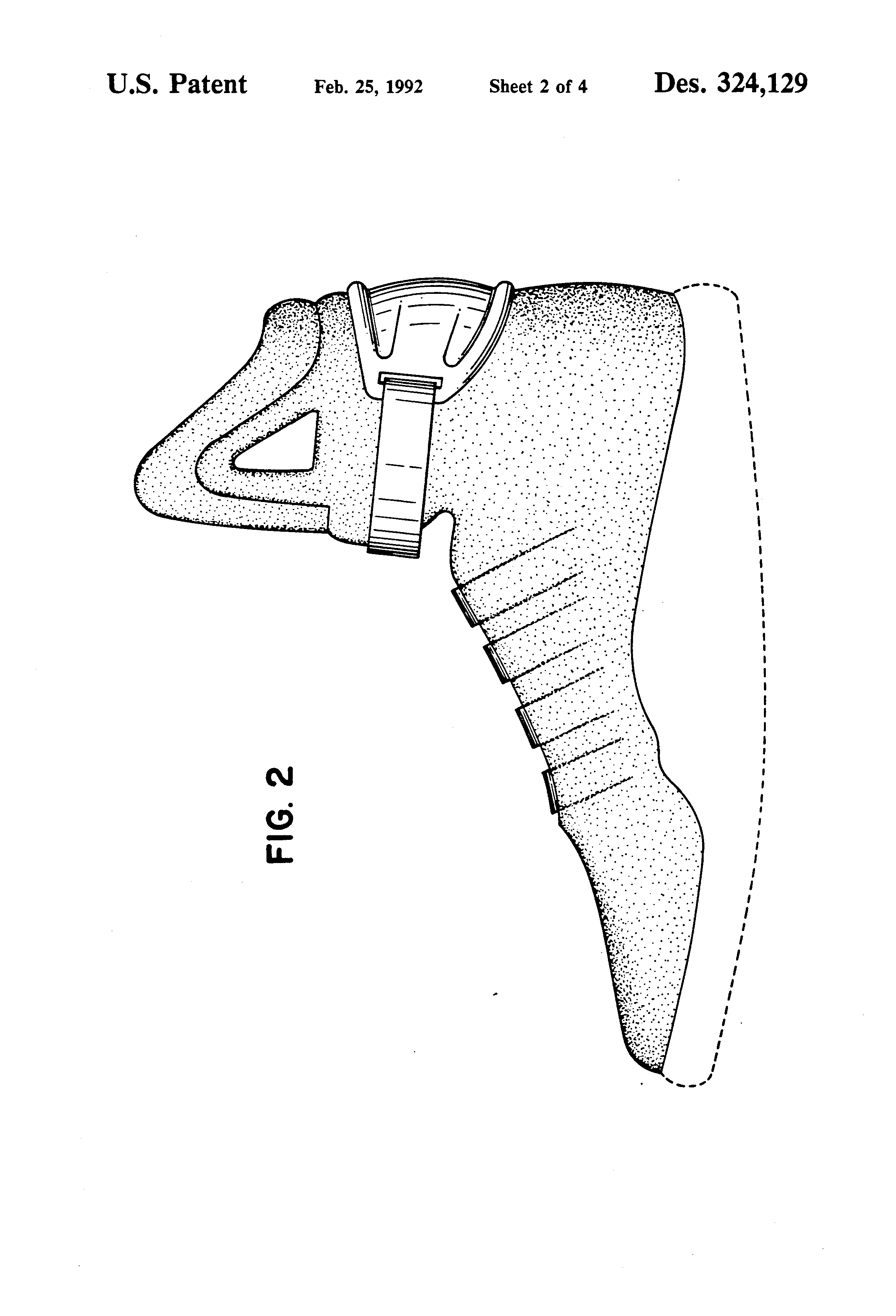

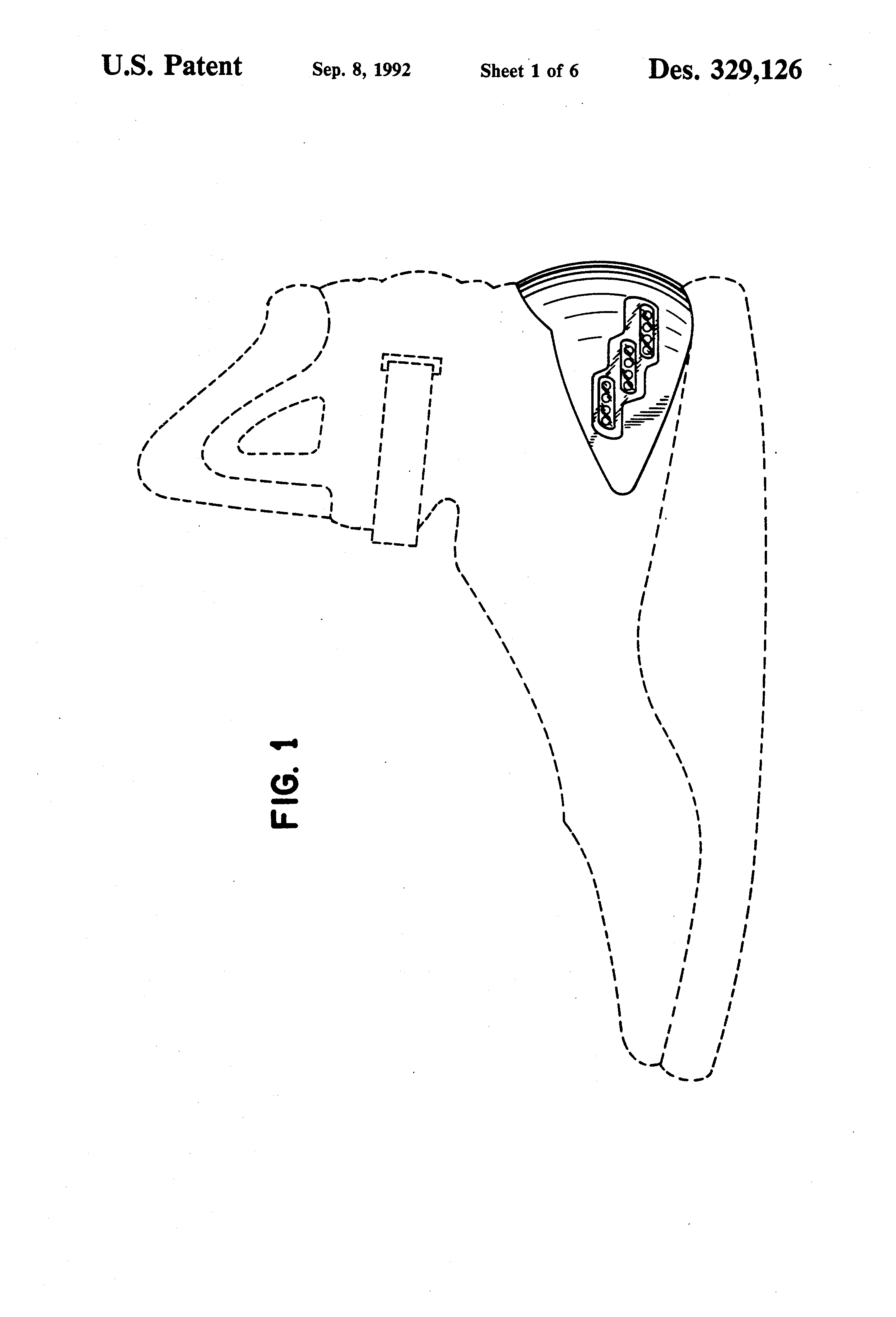

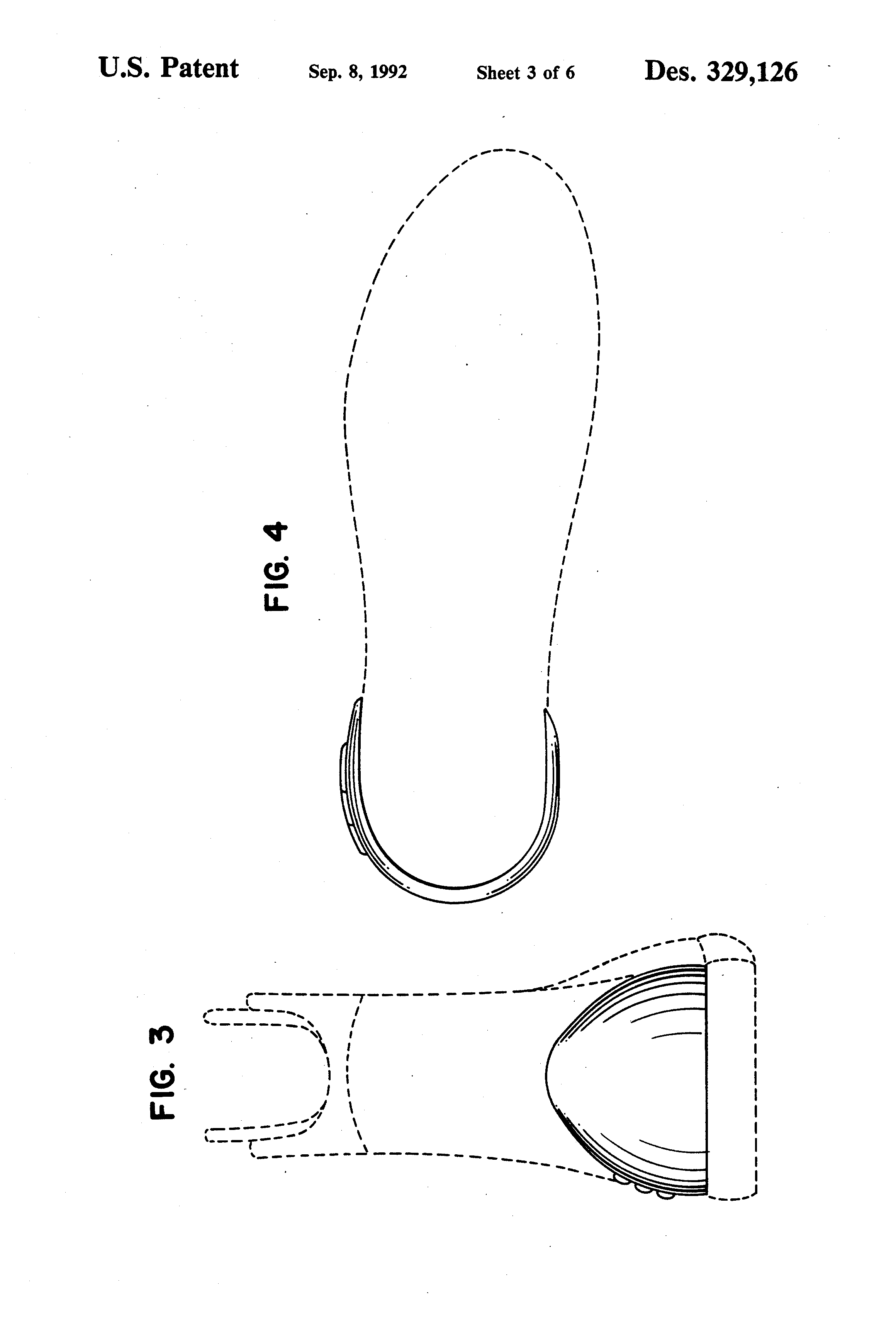

oh and there is the pattent of the soles :
https://www.google.com/patents/USD3...=0ahUKEwitx9OSpKTPAhVG54MKHXE-CoQ4RhDoAQhkMAg
USD324129-1.pngUSD329126-5.pngUSD329126-4.pngUSD329126-3.pngUSD329126-2.pngUSD329126-1.pngUSD324129-4.pngUSD324129-3.pngUSD324129-2.pngUSD329126-6.png

That patent is a design claim which only has a 20 year shelf life. It is expired.

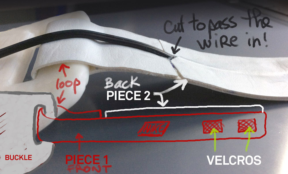

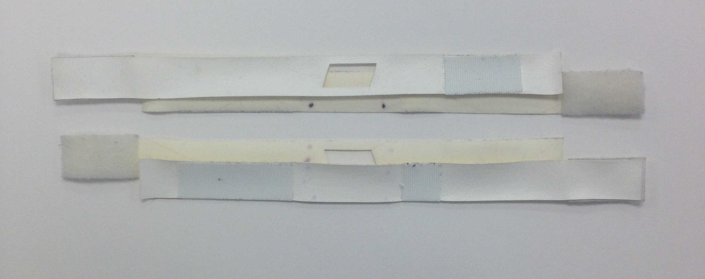

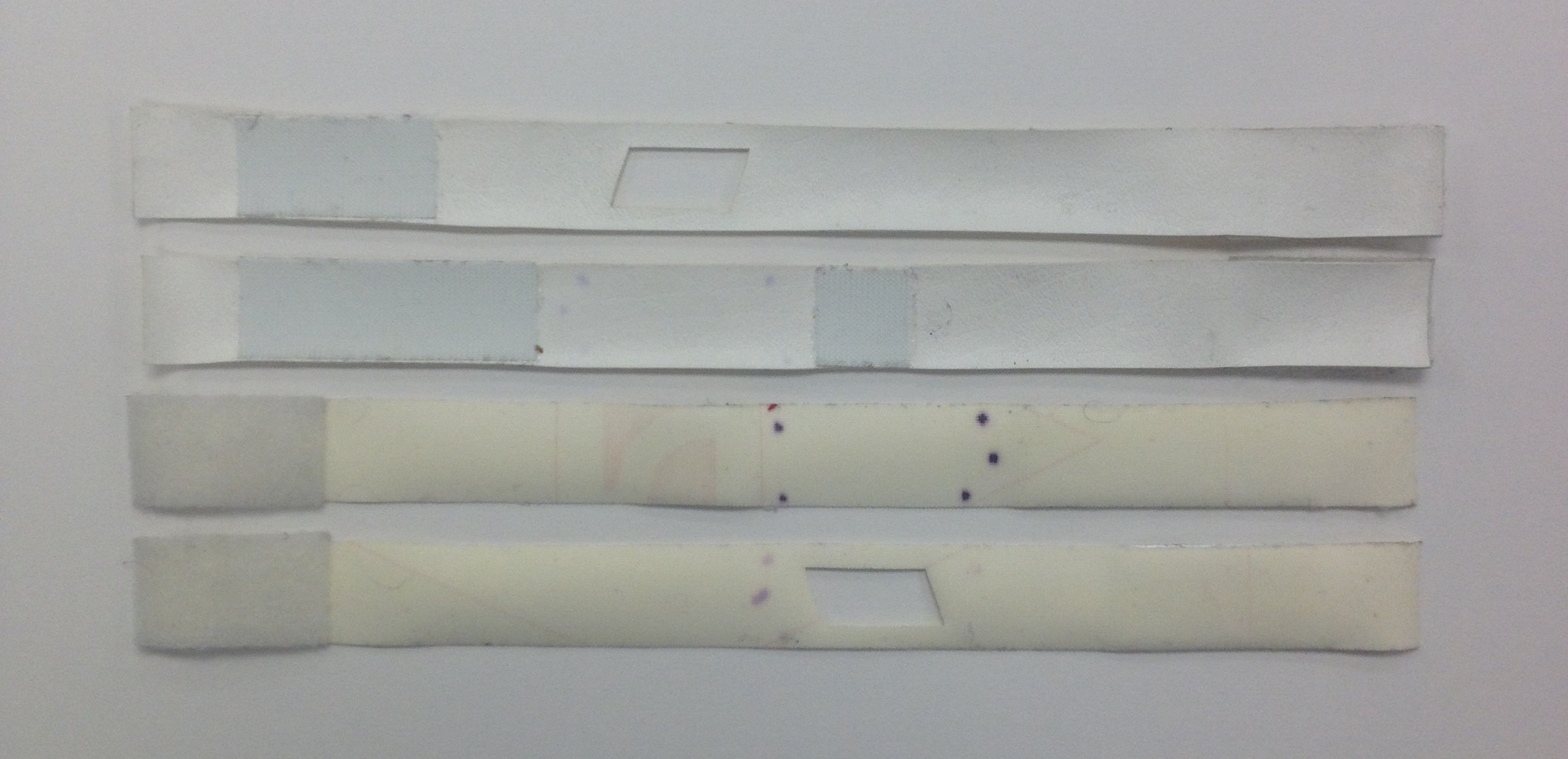

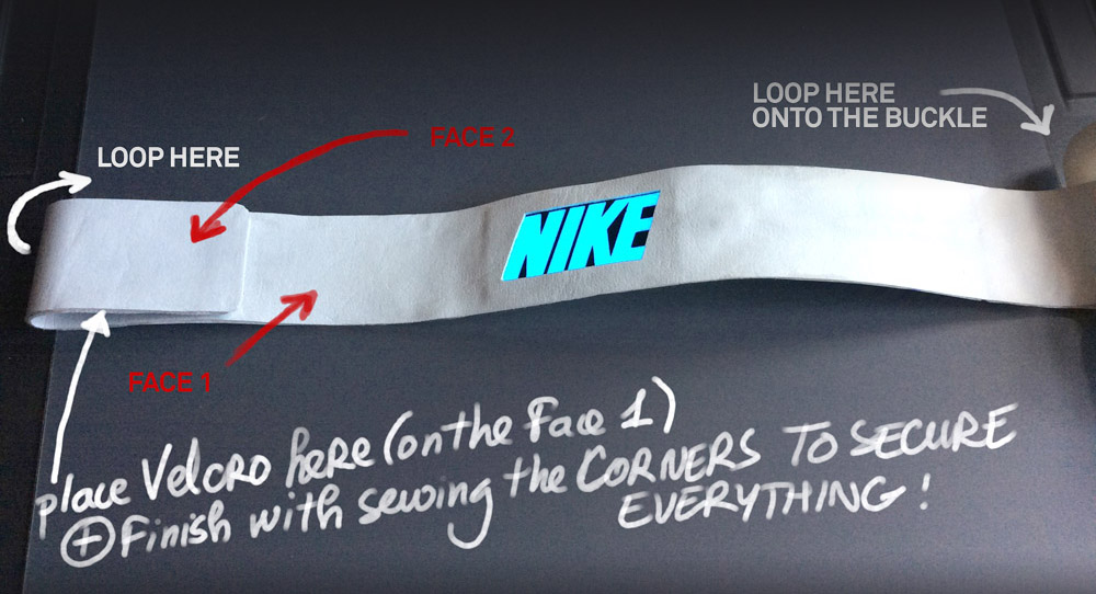

What other way can I make the straps? This is an old pair I had purchased but the velcro has moved and they are all sticky. Plus the ends of the vinyl curl up where they are layered and staggered.
View attachment 666414View attachment 666415
Hope this will help :
attachment.php
- - - EDIT - - -
Be carefull : on the following picture, the buckle is not supposed to be at this place. Look for the method here, don't reproduce my ****ty drawing ;)
(should be upside down)
attachment.php
And if you don't want the wire to be seen, just add a piece between Pice 1 and piece 2 that would be hollowed in the center were the wire is running and glue eveything
