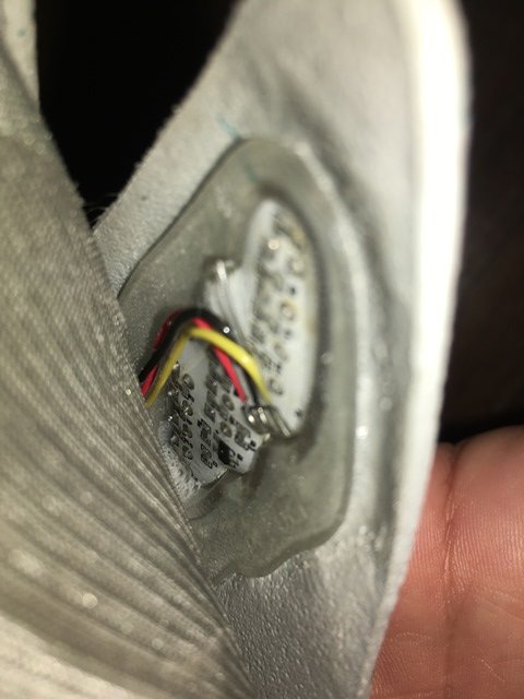

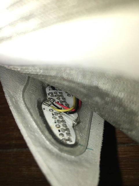

Here are some pics of the electronics exposed on the heel cup.
View attachment 657849View attachment 657850
Nice to see surface mount resistors! Easy to dim the LEDS! And each LED has its own...like it should. Nice! I'd mold the ankle bubbles!
By the look of that, they didn't even glue it. WOW, how did they miss that?
