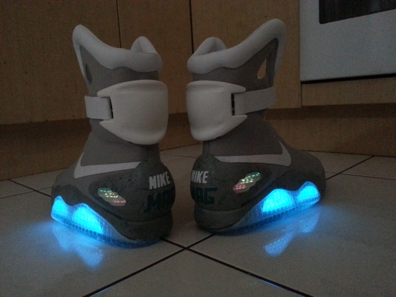

The shoes are V2 MAGs from China. Those decals come on the shoes. They do look good but are too small at 3/4" or 20mm tall. MP's decals are the same size. The ones I am making are 1" or 25mm tall for the MAG and 18mm for the NIKE. Not sure when the guy machining the new tool is going to be done. I don't pressure him and he does not charge me stupid prices.
The factory yellow soles have been removed and my clears (with a slight blue tint) have been added along with EL and a new 9V electrics system. The cloneprops 3D printed buckle is as close to the real part as we will get and it looks fantastic in these taller shoes. I have also slimmed the toe and replaced the strap logo with EL as well.

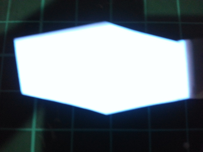

I was playing with EL today and thought I would share.

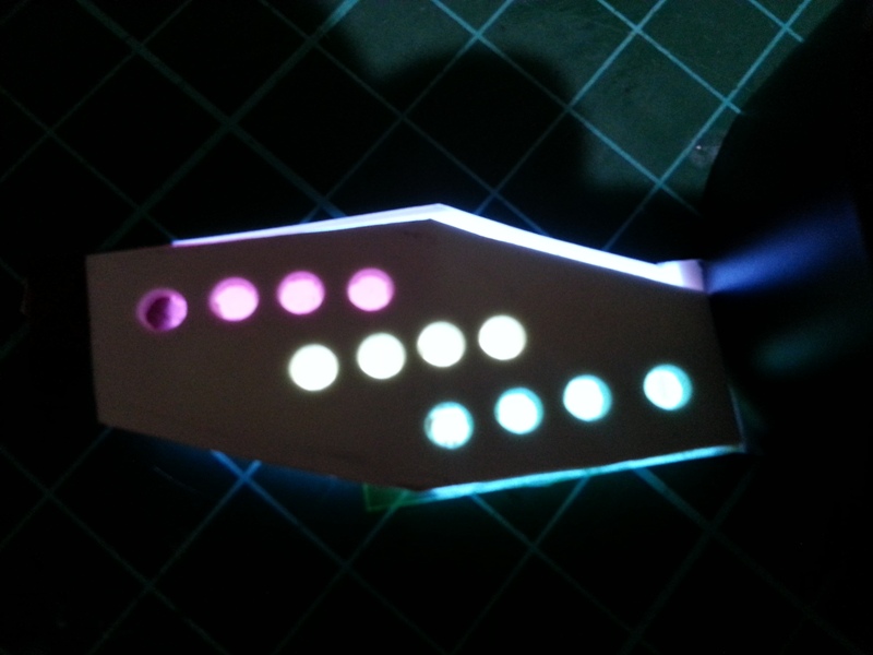

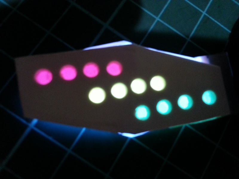

2nd version of the fake LED cluster using a filter over the EL.
attachment.php
This is a single layer of filters over the raw panel. Because the ligth from the panel looks sligthly blue, it changes the colours of the light through the filters.
My 1st version has a white contact over the panel to make the light white.
To make the colours brighter, I simply added a 2nd layer of filter materials.
attachment.php

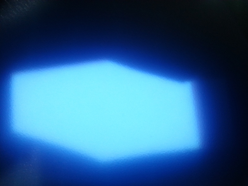

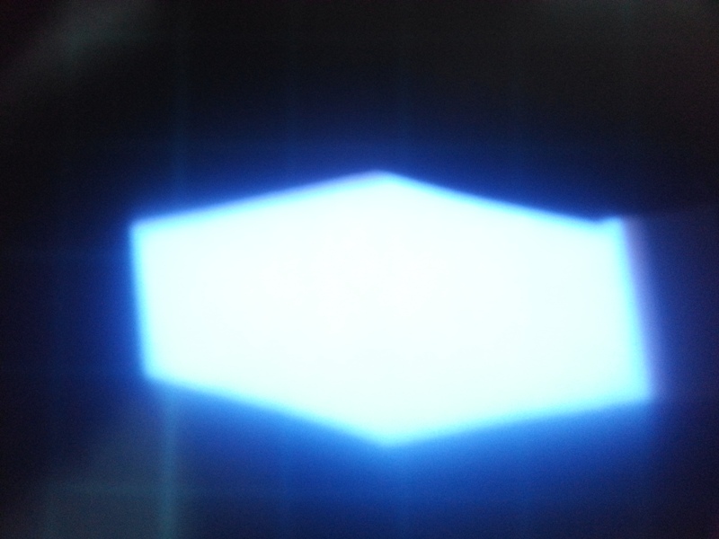

I also wanted to know if I could create other colours.
White, no filter.
attachment.php

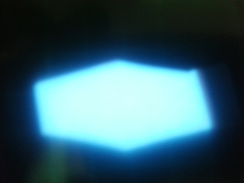

Single layer of blue filter
attachment.php
Double layer of blue filter
attachment.php
Single layer of blue + single layer of green = CYAN
attachment.php

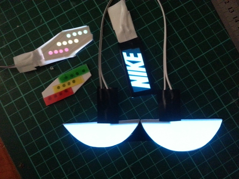

One shoe's worth of EL for my shoes.
attachment.php
I am also showing the back of the LED cluster with the filters attached.
