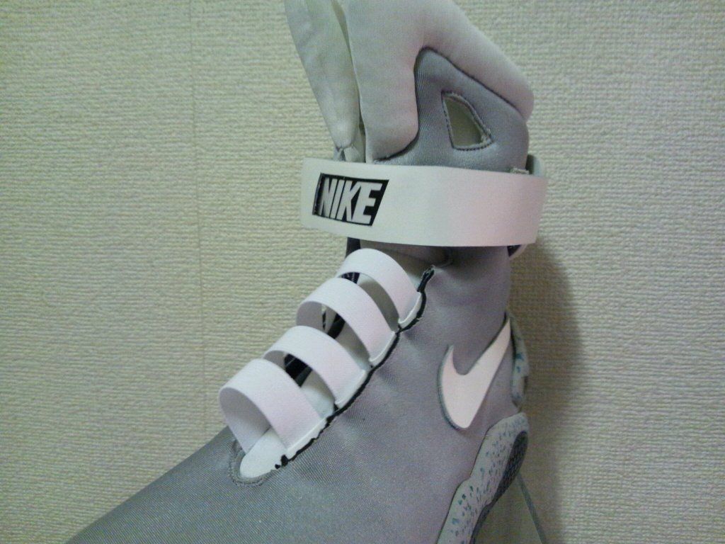

My stunt grade shoes with the adjustable laces dry fitted. There's a length of hidden elastic under the tongue that still allows them to be worn. The laces slide in and out of the ribs which are made from vinyl tubing to allow a smooth slide.
Very rough right now but it should look good once finished. Hey, are these the first Mag replicas with adjustable laces?
I believe they are. Most have either left the elastic as is or like s02 just replaced them giving wider gap in the upper. I'm leaving mine as is but will add the ribs following the direction of the laces giving the false effect of what you are talking about of the lace going through some tubing. Although if I'm feeling brave I might have a go at what you're doing.

I think your shoe looks good. I like the tube idea to assist with them sliding. Very well thought out.
Yeah, the laces are a tad too wide here. I think they might look a lot better once I hide the tubing and stitch/glue it all together.
Though I do kind of like those thicker laces. For an anti grav shoe they look more secure.
Can someone with good screencaps actually tell whether the onscreen mags have elastic laces or some other material? This is literally the narrowest elastic I could find in Tokyo. If I can use another kind of lace then I can meke em narrower. Im also now wondering whether to go the whole hog, pull the upper off and install a motor in the shoe to have a non-wearable, ligghtup powerlace version. Maybe even fix it to an imitation asphalt base and just have the motor in the base.

Looking at these images again, I don't think you too far off if they are too wide. Big loops on the screen used pair though.
Some of the shoes had gaps as wide as the laces. But some scenes show a smaller gap between the laces.
I'm not too fussed over that laces as these are going to the pair I wear out to costume parties etc hence why i'm calling them my stunt pair.
