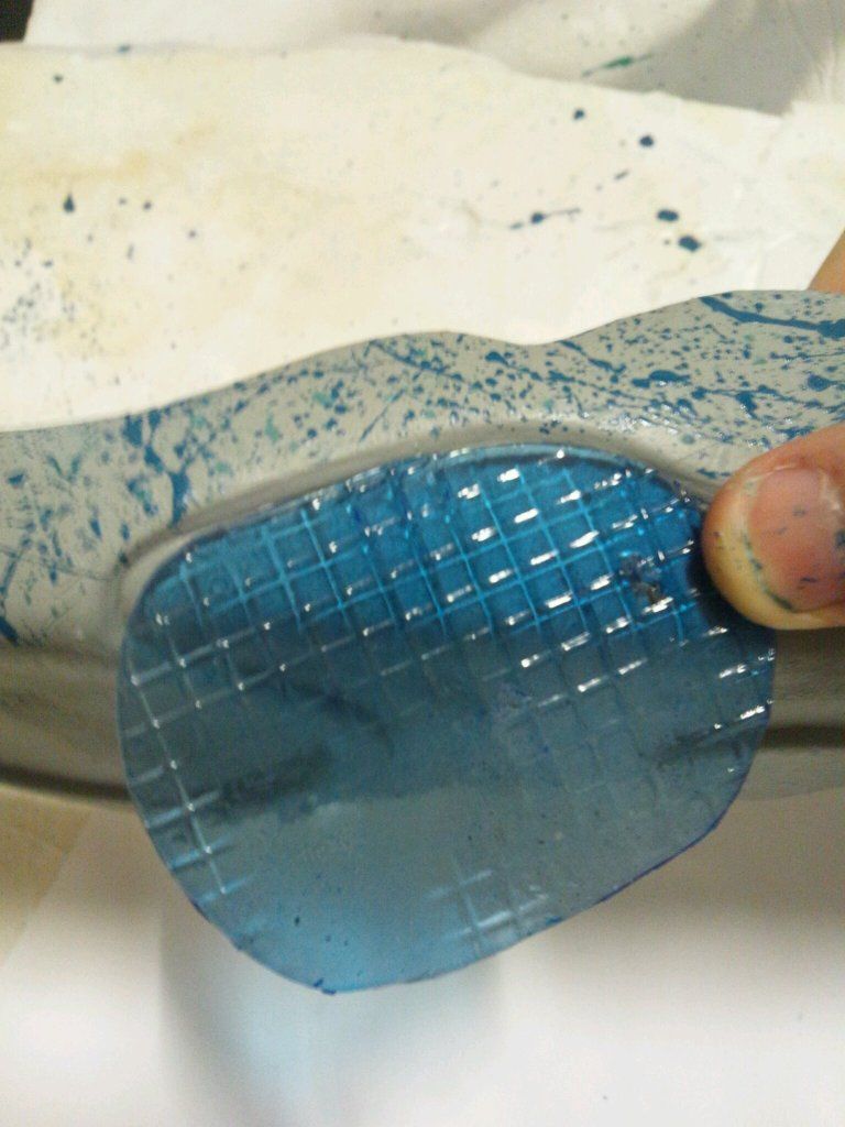

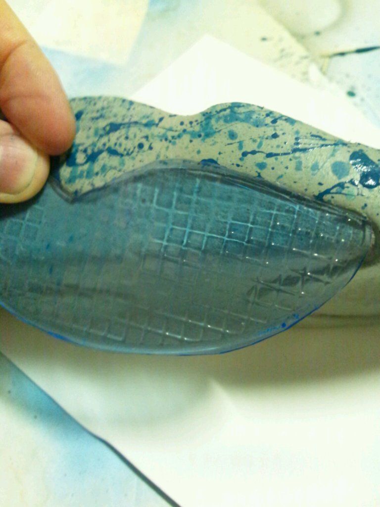

For this test I made a mold from the MP soles in a resin then used that on plastic warmed in the oven. Not happy with it, though. It works for the oval sole piece but the main piece is another matter.
Do you guys think the waffle pattern is looking good there or is it worth researching another option?
Liking the new heel cup btw Cavx. What are you doing about the texture on the sole? I tried adding the texture to my soles but it didn't come out as well as I had hoped. The problem is, if you're going for more accurate splatters, the texture on the white of the shoe makes the splatter look denser from a distance but sparse when you go up close.

A good effort none the less. I think the only way to do this is to remove the soles from the shoes, and cast this part in rubber, creating a 2 part mold from silicone first.
