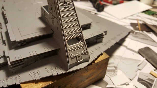

Thanks, Robiwon, very much appreciated - my plan for getting around the battery issue (which, yeah, I totally get the lifespan trade off, in addition to not realistically being able to run a bunch of 5060s as far as I know) was making the top 'roof' removable, held down with a bunch of mini rare earth magnets. I hate this part - sub-assemblies are pretty much done, but I'm at a stand still trying to decide how to light the thing now.

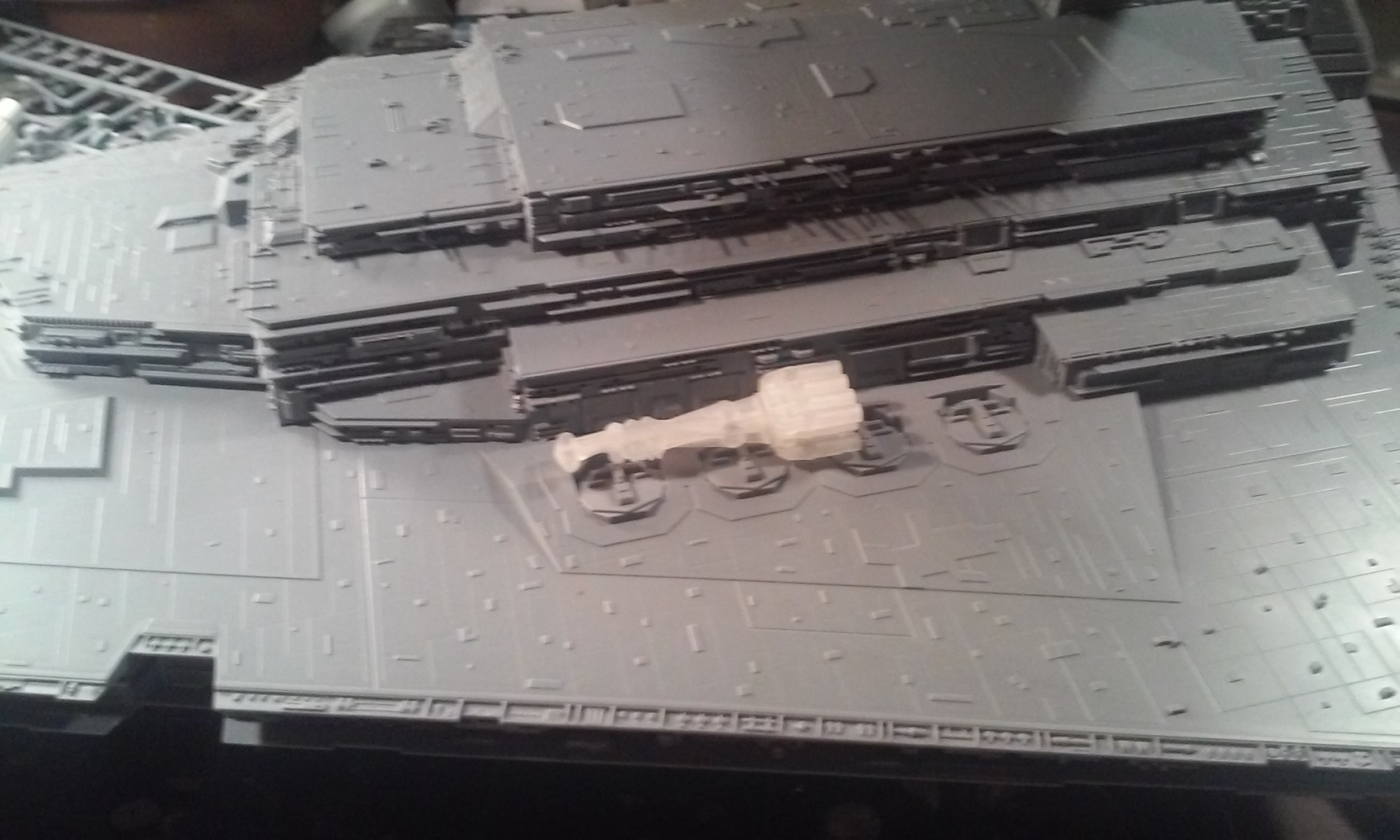

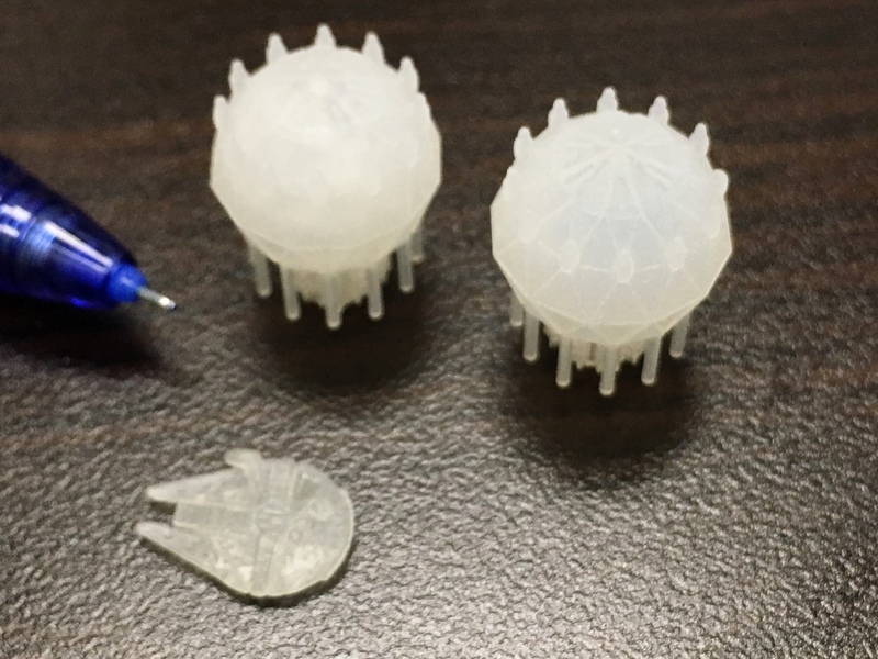

I just received a shipping notice from Shapeways for my 1/2700 Millennium Falcon, to mount on the back of the SD's conning tower. I'll post pics when I receive it.

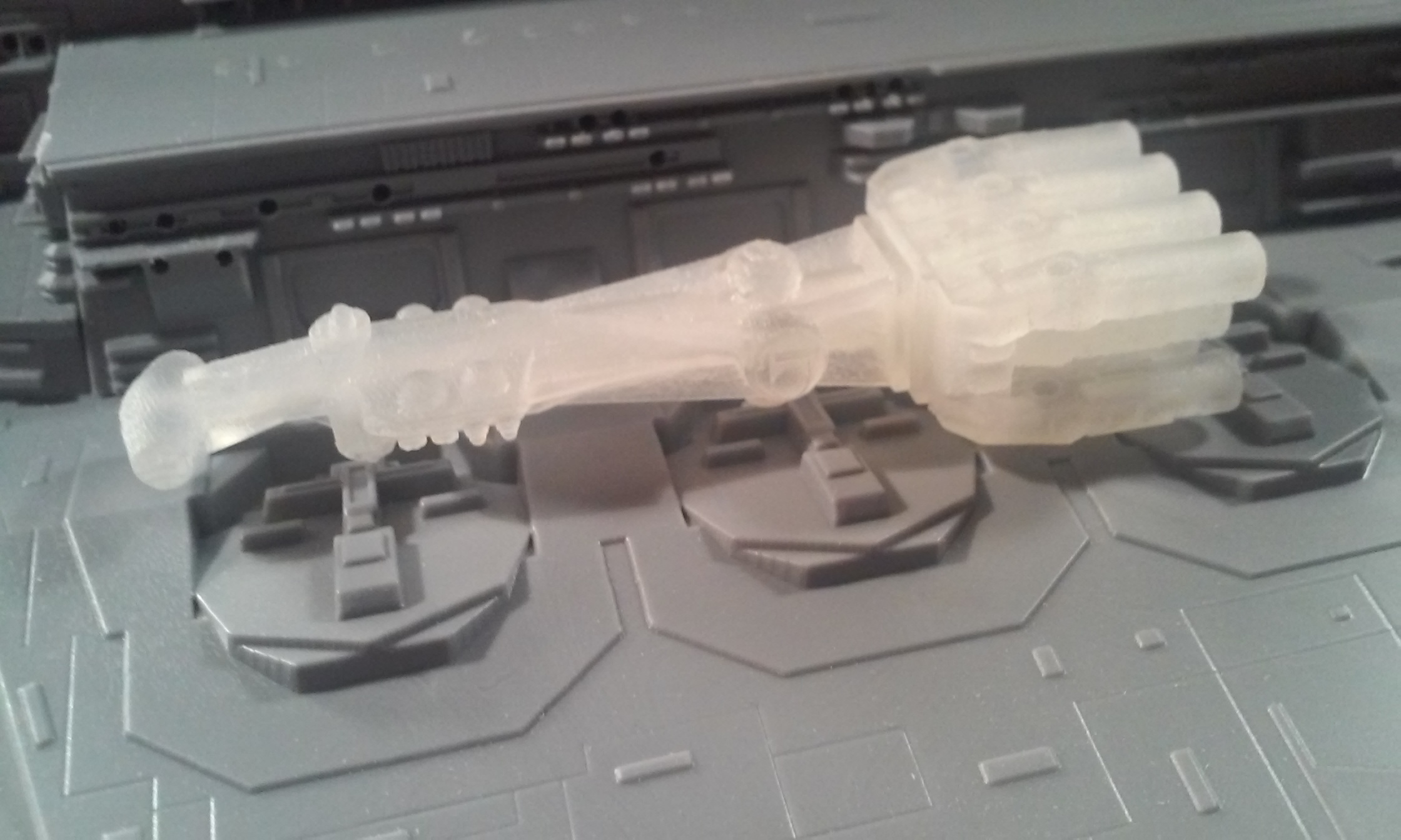

Is there a difference between those shield generators and the Zevezda ones?
No seams for one thing...It's hard to tell from this image but there are also alternating raised and lowered panels as on the "real" thing. The bottom also better approximates the "real" thing but only to a point since the ladder areas really need photoetch to replicate them. I did build something like that on the support structure so with a wash it will look pretty close. The pointed arays surrounding the top are obviously overscale, but they're better than the kit part.

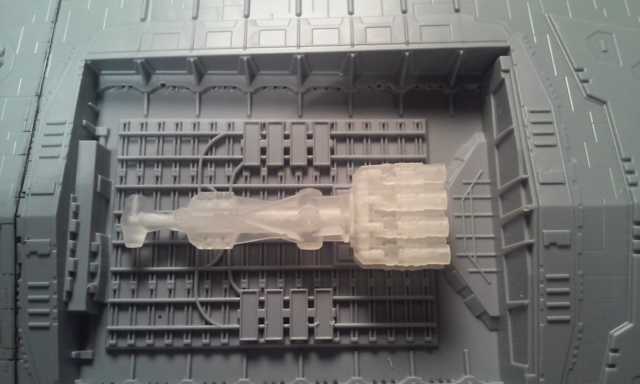

Nice build Robiwon... seeing that you have started to drill the light floods, how thick is the plastic around the hangar?
I'm still awaiting for my kit to arrive, but plan to deepen the hangar a bit on my build.
