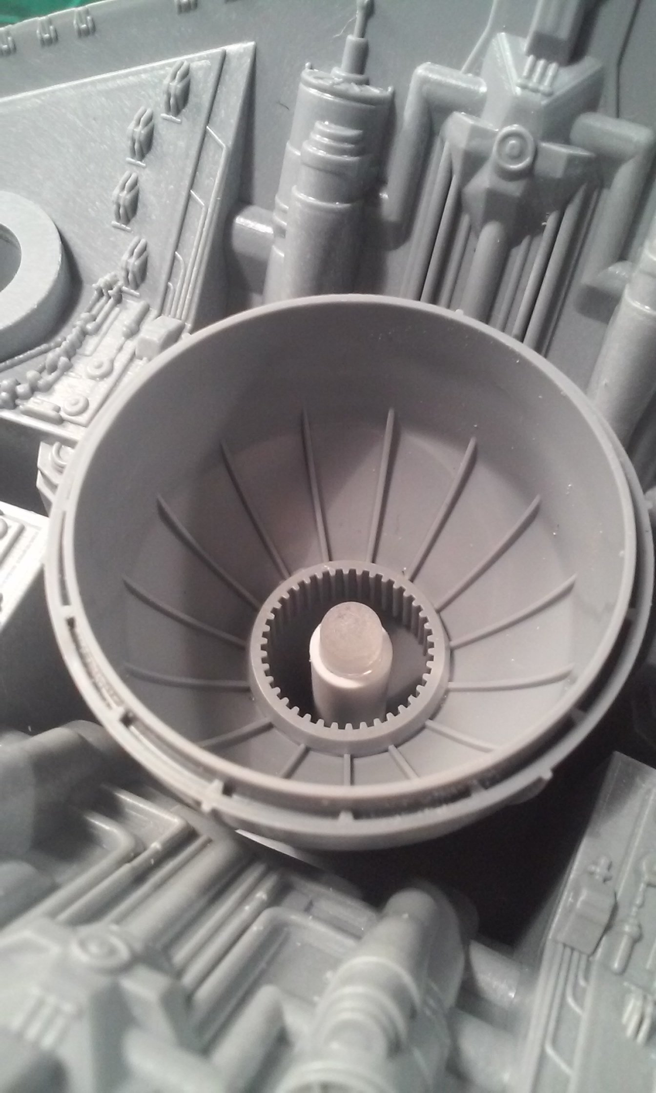

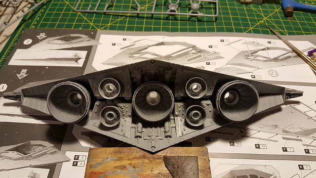

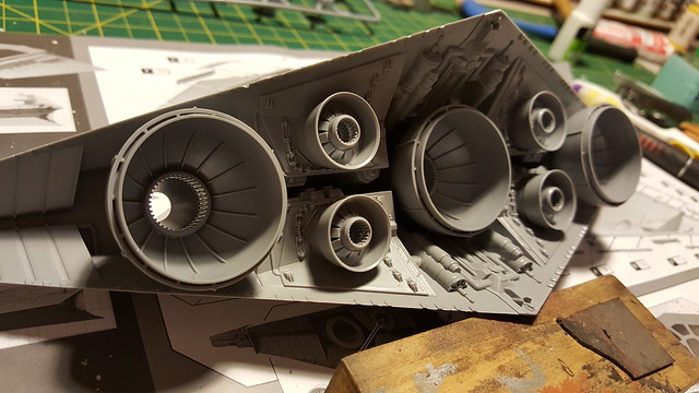

Just drilled out the holes for the engine lights!!
20170117_182351 by Oscar Baez Soria, on Flickr
20170117_182333 by Oscar Baez Soria, on Flickr

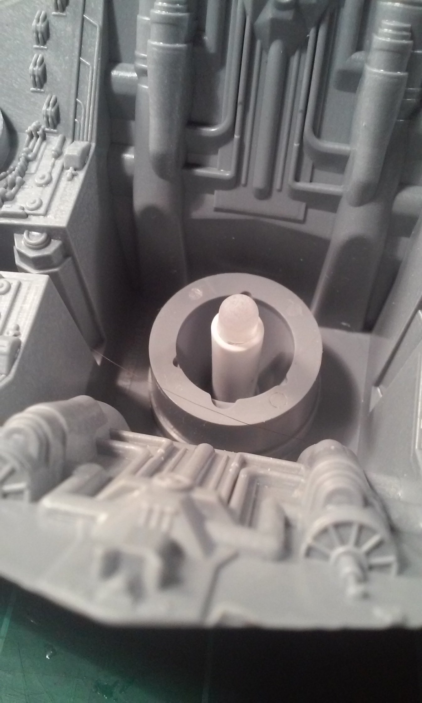

I'm mounting my LEDs in tubes to insert them into the bells.
Yes, those are 5mm, and yes, it's big! :D
I'm waiting for some concave LEDs to arrive from Germany to try out. They emit more light to the sides apparently. I'll give them a shot.
