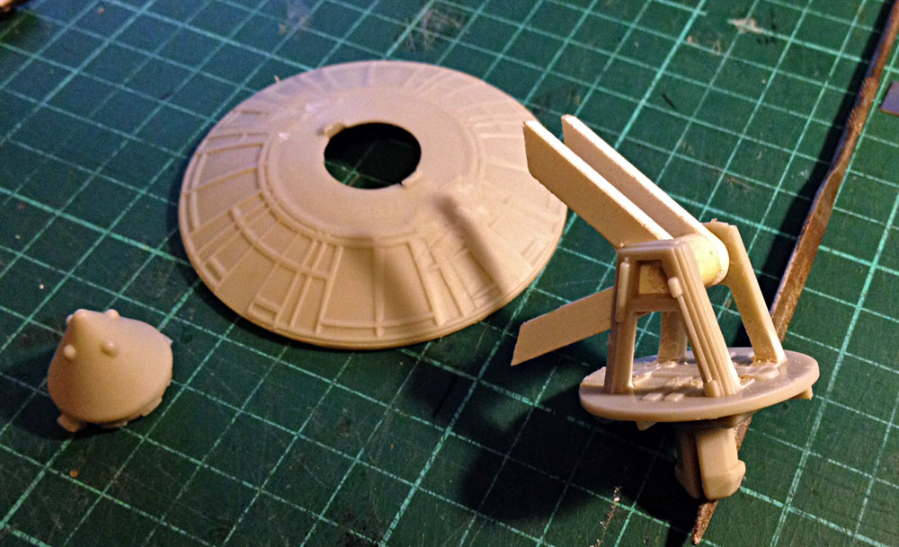

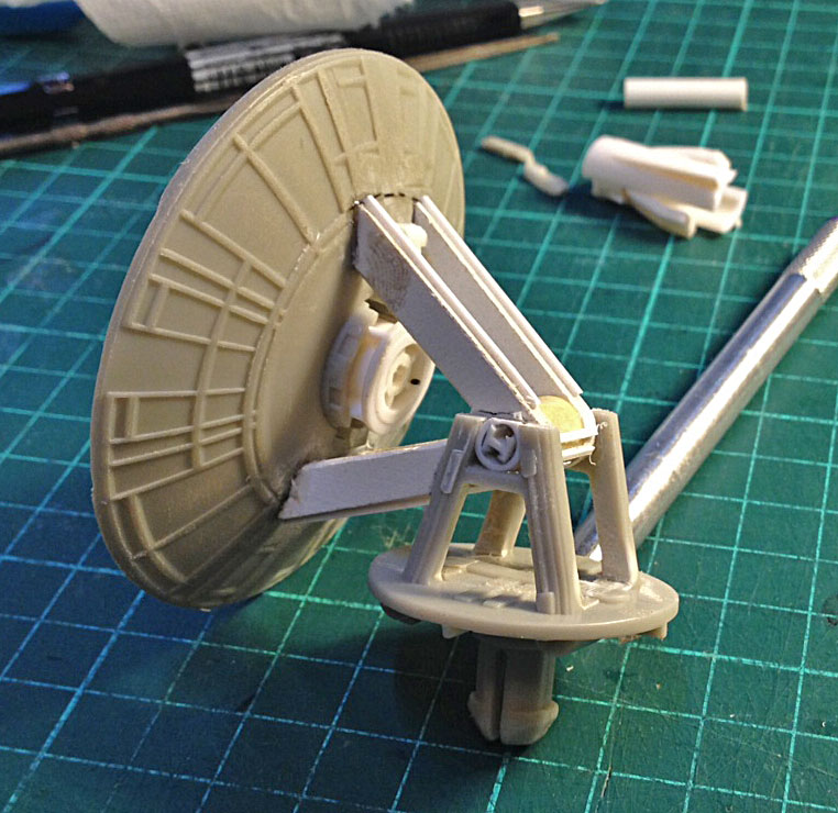

Here's the job I did earlier in the thread
View attachment 417449 View attachment 417450
Wish I had got rid of the detail on the back now though.
Hey, SB, backtracking just a bit - what did you do here? It looks like the base is made from the stock radar support with the middle carved away, but at the same time it looks like the upright 'A' frames are actually closer to the edges of the circle than the stock piece..but then they don't look like they've been cut and glued...but it definitely looks wider spaced than the original...but....then.....but....but...now my brain hurts.
