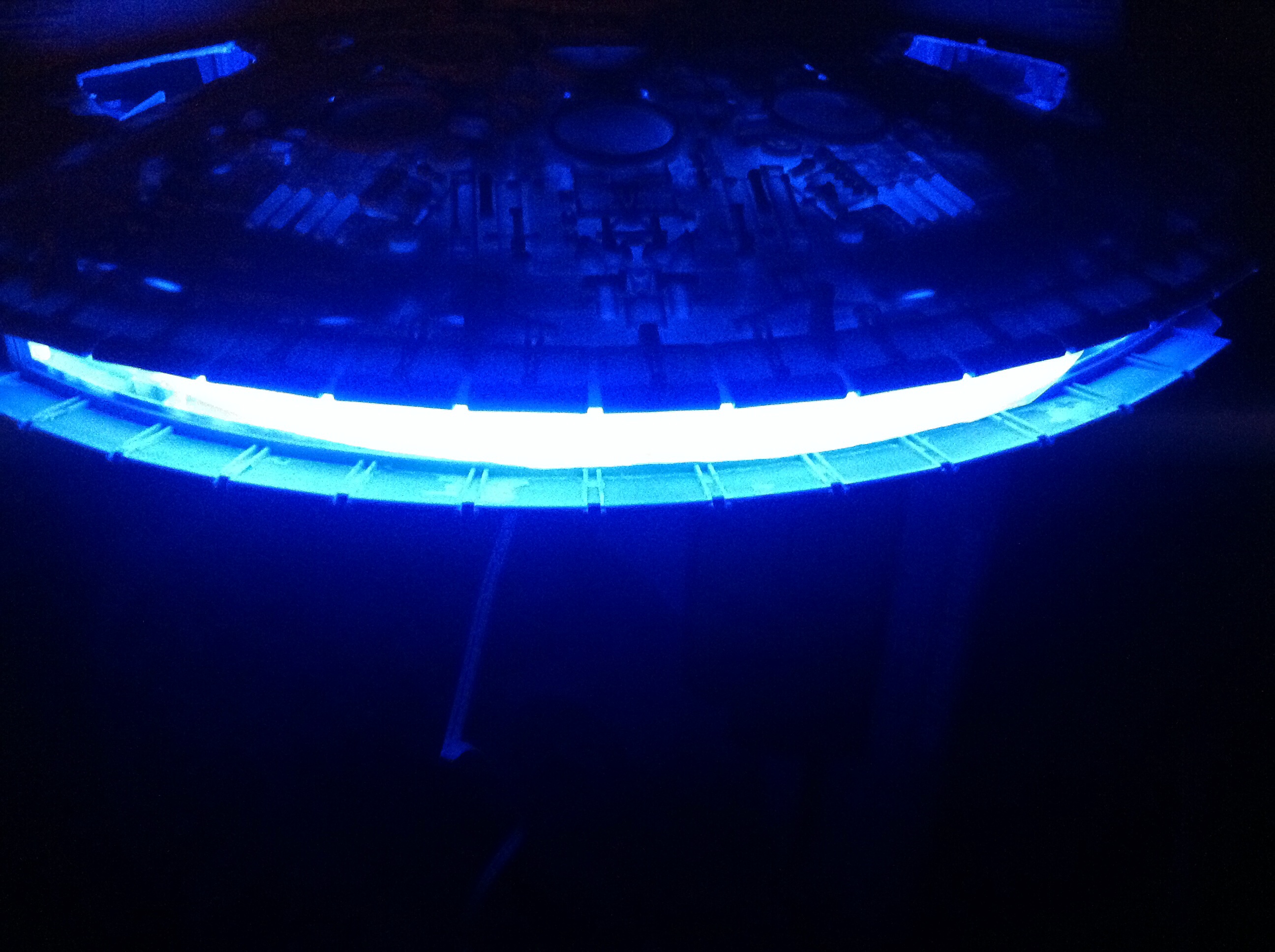

Vacformedhero, that looks like you found a really great light source. What you're describing sounds vaguely like the flexible, variable color led setup I've been looking at on fleabay. Looks good!
I can get flexible led strips via work at cost.. Hmmm
Aaaaaaand you just became the new best friend of everyone on the thread :lol
Actually, do you know anything about them? The one I'm looking at is about eleven bucks. 50cm long with 15 variable SMD5050 leds powered by three AA batteries. I have NO idea if that would be bright enough, or if I should look at something else. Any thoughts?

The brightest led chips by now are the 5630. You can buy led strips with 5630 blue smd chips searching on Internet. Lots of them.
And these are way powerful!!!
Yeah like Tony said the 5630 are the brightest available. The only drawback I can think of are the ones I get from work are AC. We sell the Sylvania Osram Mosaic flexible LEDS.
Nope , this is IKEA dioder system with rigid multi colour with controller , I have a Hotwire that enables multiple colours from one unit , I'll post it soon

They are adjustable and powered by 12V so as well as powered later on I'll think about powering from a battery ( maybe motorbike )
If the LED strips are powered by 12V, are there any drawbacks to powering the strip with an A23 battrery vs 8 AA batteries? I was thinking about using LED strips for the engines as well but would like to make the battery source portable, small, and light. The A23 battery would be perfect.
Luke24 I am not sure, I was going to do battery testing near the end , I,ll test the load , this might indicate how long the A23 could sustain light for, great suggestion, wonder has anyone run these types of bright LEDs off of one before,
I'm no expert, but I would think the disadvantage would be that while an A23 would gve you the voltage you need, they've got really, really, REALLY low mAh ratings compared to AAs. You'd be replacing your batteries constantly.

Ordered a strip of 5630 LED and was thinking to power it off a Yuasa 12V 1.2Ah, but cannot find anywhere to see if it would be OK. A 30cm strip of 5630 LEDs is 7.2w. Have also bought an IR wireless controller to turn it on. The battery is small and will fit in the rear engine area where I have made the panel removable so the battery can be taken out and re-charged.
Will the Yuasa be ok? At the end of the day the engine lights will not be on for ages anyway, just to demo and maybe enough to fly the Falcon around the room for 5 mins :lol when no one is watching!

I'm not a tech but for the small led stripe snuggled into the Falcon it would be way enough. If someone can check it it would be great.
