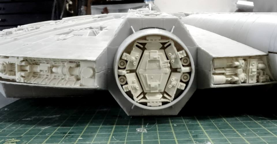

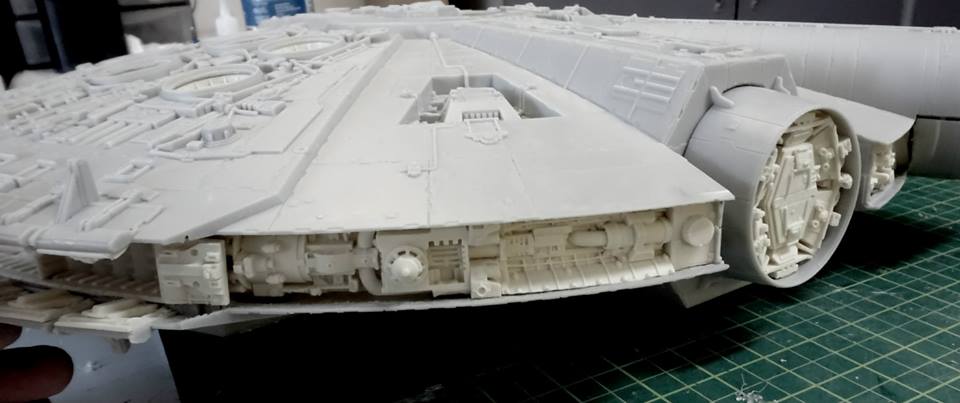

Yeah me too I'm in the same boat as well. Its my first time modeling a spaceship normally I do tanks and armored stuff. My MF will have interior details and removal outer panels. You are right this model is a challenge as it has structural issues... very flimsy, to counter this I plan to build up the interior walls and reinforce it using 2-3mm styrene sheets.

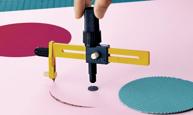

I finished the cutting of the cockpit windows, have to be very careful. My cutting technique is to use a normal blade cutter, first a very light cut, and then repeating the cut up to five times with gradual increase of effort. On the sixth cut I will press the blade in one small area until it pierce the plastic on the other side, then slowly rocking the blade front and back until the whole blade slide through. I then slice cut the remaining line until the cut is complete. I know it is time consuming approach and you must have a steady hand, but so far I never needed to heat the plastic and it gets the job done.

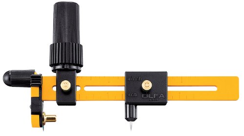

As for the engine circles, I used the Olfa Circle Cutter shown below. There are two types of these, one with a rotary circle blade and one with a normal cutting blade. I use the normal cutting blade to cut the engine grilles off.. Try practice cutting first on a used plastic sheet before attempting on the MF. The best thing about this as it has a ratchet type handle on the top so your hand wont need to turn 360 degrees, 45 degree steps is ok.
Neat tool - am I right in thinking that the pic you posted is actually the rotary version? I think I've found the compass version, but it lacks a number of the black doo-dads on your pic.
The one i posted is the compass version with the single cutter tip. The rotary version has a circular cutter..cant use that for the engine grilles.

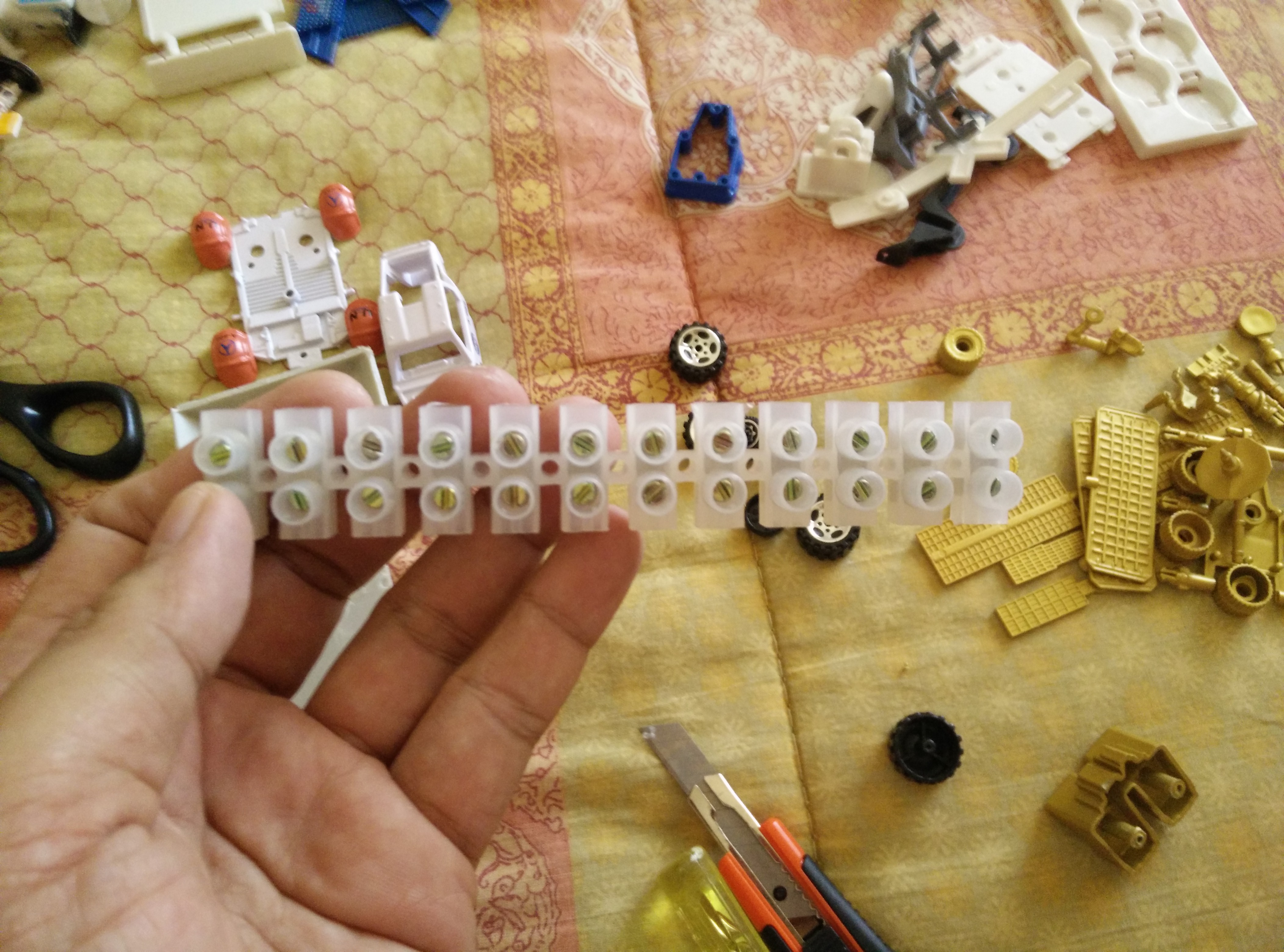

Hi guys, while at the hardware store I saw these 10A wire Connectors, I think I will try to use them as engine details...
They will be set much more inner than what is shown in the picture. Then I will cover it with Randy's PE grilles or just make the rectangular grilles by styrene....
Also since these are opaque I want to see the effect it has when my blue LEDS are mounted at the back. Just waiting for my strips to arrive....
