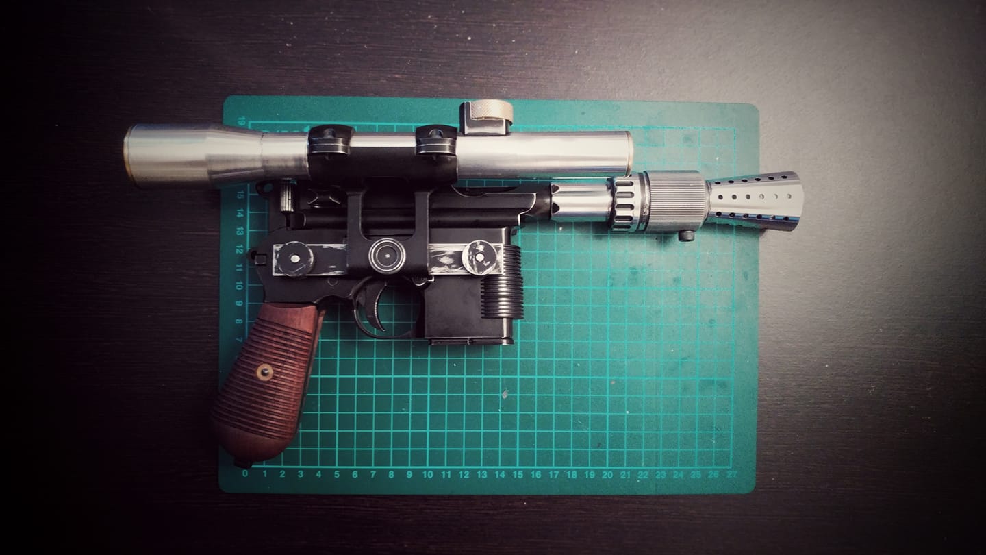

Ran into the exact same roadblock as BipeFlyer and ran out of Perma Blue. Though having the clean polished elements is very satisfying to handle.
3D printed Heatsink and T-track for the Reade antennae greebles are still to be painted and attached. Cherry Wood Mauser grips added.

This looks quite nice in this picture. I like the contrast of the silver and black elements. Interesting. I know some here have said they'd like to have an all silver version but if I were to have an alternate, It might be like this.

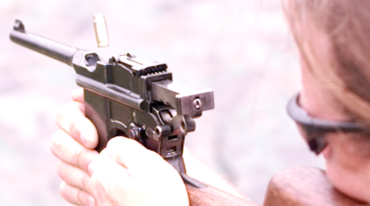

I think you're right for the TFA version, which is what I'm making mine. The selector switch is on at least some M712s, which I think is what the TFA version is. I haven't seen any pictures clearly showing the left side of the TFA DL-44, so I left the selector on.
Here's a picture of a M712 with the selector.

You can see the left side very clearly here..

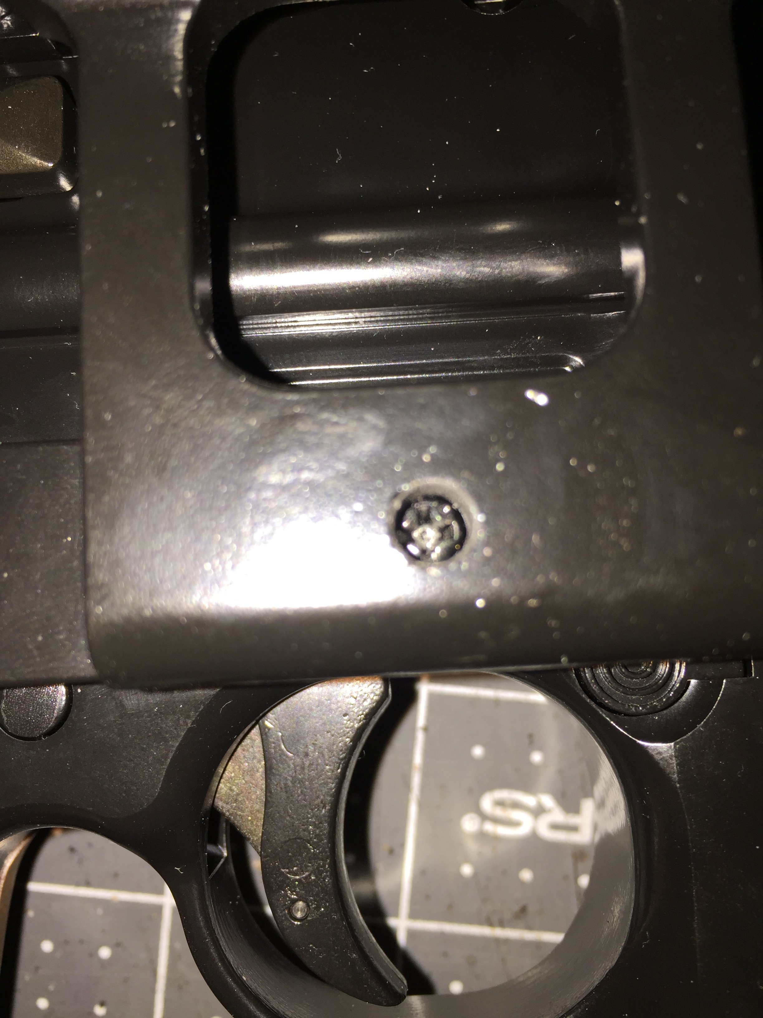

Well it finally arrived and I must say many of the positive and negative comments made so far are pretty dead on. This thing has some heft to it for sure and it's crazy satisfying holding it in your hand. Mine all arrived in one box, so I didn't have to wait for the flash hinder to arrive separately which was nice. I also was suppose to receive the replica wood grips I ordered off eBay that we're "Guaranteed" to be delivered today and it appears USPS dropped the ball on it because they did not arrive today but hopefully will be here tomorrow (but what the hell good is a "guaranteed" delivery date if there are no repercussions for it not arriving?)
Couple road blocks I ran into or am still dealing with, as we all know, there are no "building" instructions with the weapon.

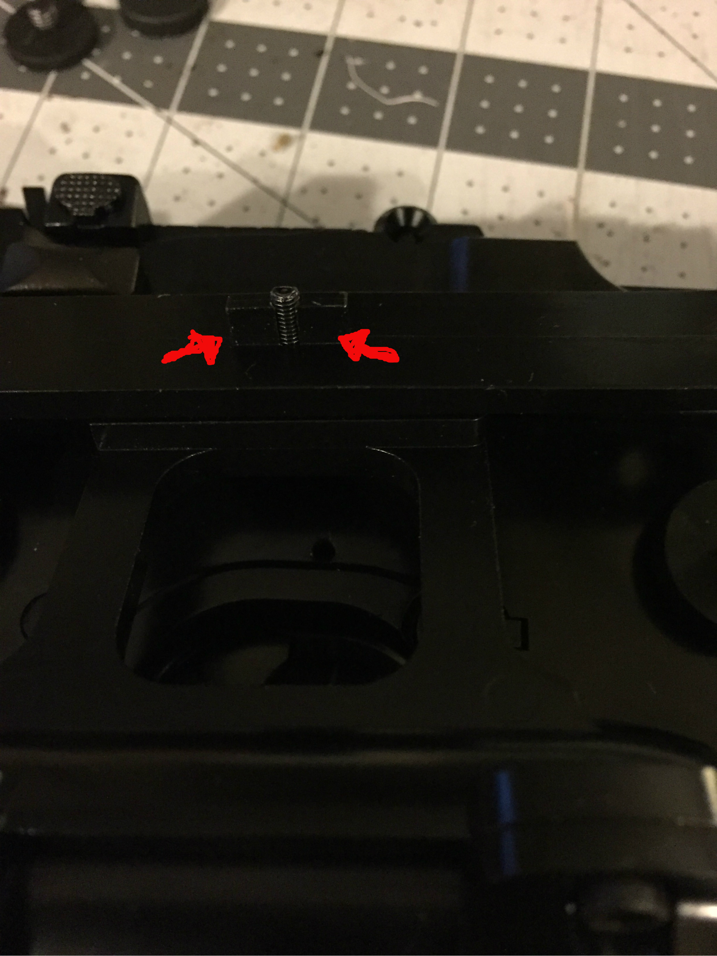

So the round thumb screws that hold the "scope mount" onto the main body of the gun still don't seem to be screwing in all the way and tight. Plus the t-bar part has a tiny screw that doesn't seem long enough to successfully screw into the gun all the way and I can see there is a "tab" on the back of the bar that seems to preventing the tiny screw from catching properly and I fear it might fall off.
Was this the same on everyone's? Anyone have any suggestions or tips on how to make these more flush with the body of the weapon?
-Ash
It's just the paint/powder coat in the threads. At first I thought I would have to re-tap mine, but screwing them in and out a few times cleared the threads and everything fits fine now.
