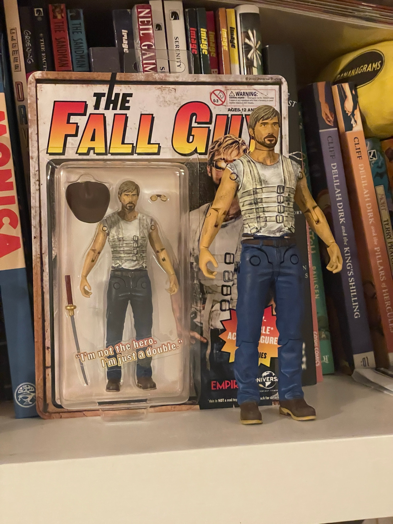

I appreciate that once you've seen one of these things, you've seen them all BUT it was a real challenge to turn around 8 of these, entirely on my own so I am proud that I managed to FINALLY get them all finished.
Finally, here are some (frankly, terrible) photos of The Big Boy/McFarlane scale version, next to his tiny brother
