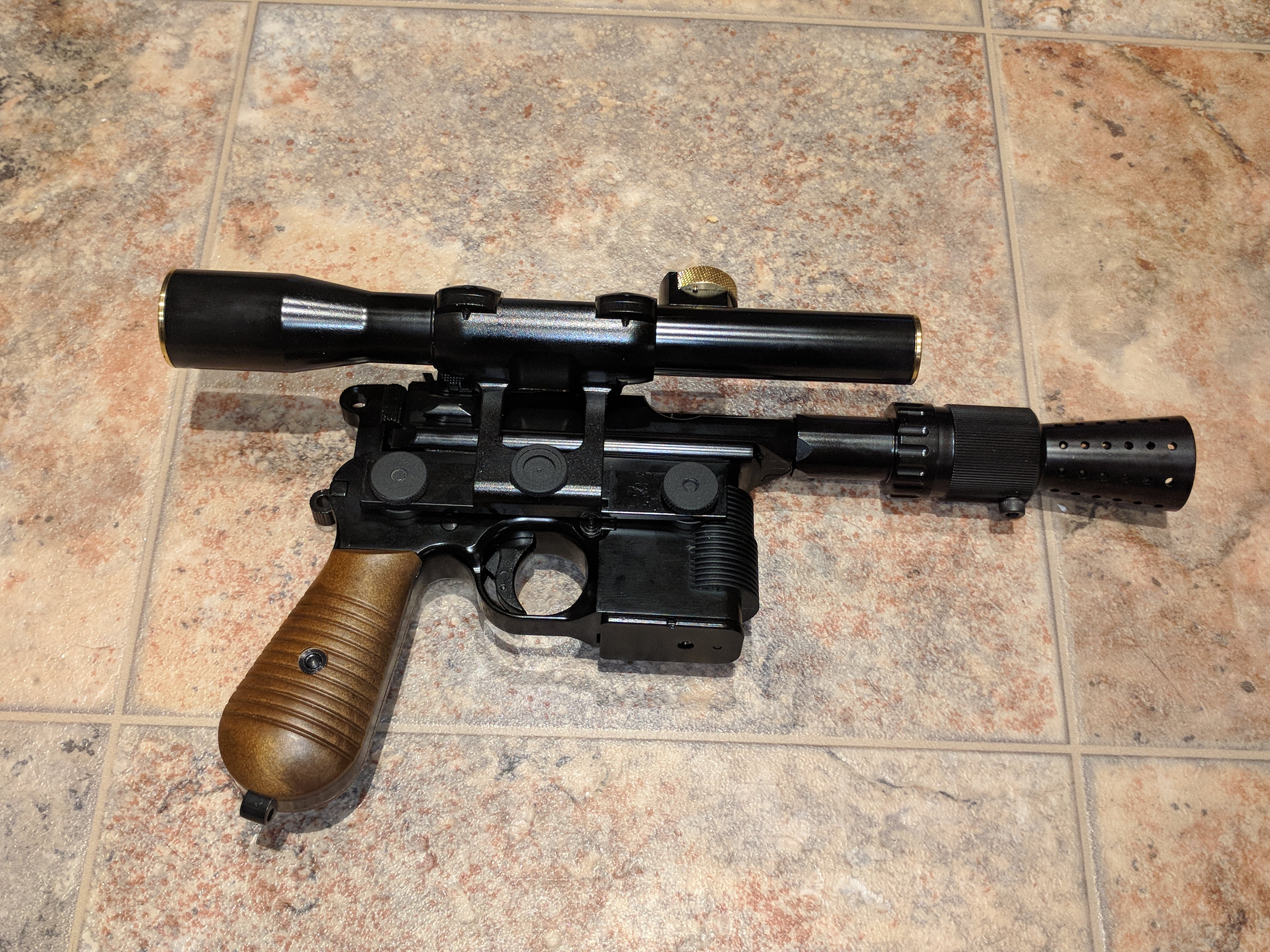

These grips fit perfectly! Where did you get them? I tried swapping out for a set of wood grips from ebay but I'm not entirely happy with how they look. I'd love an alternative for an ANH look.
They look like grips of the Master Replicas Han and Luke ESB Limited Edition Blasters.

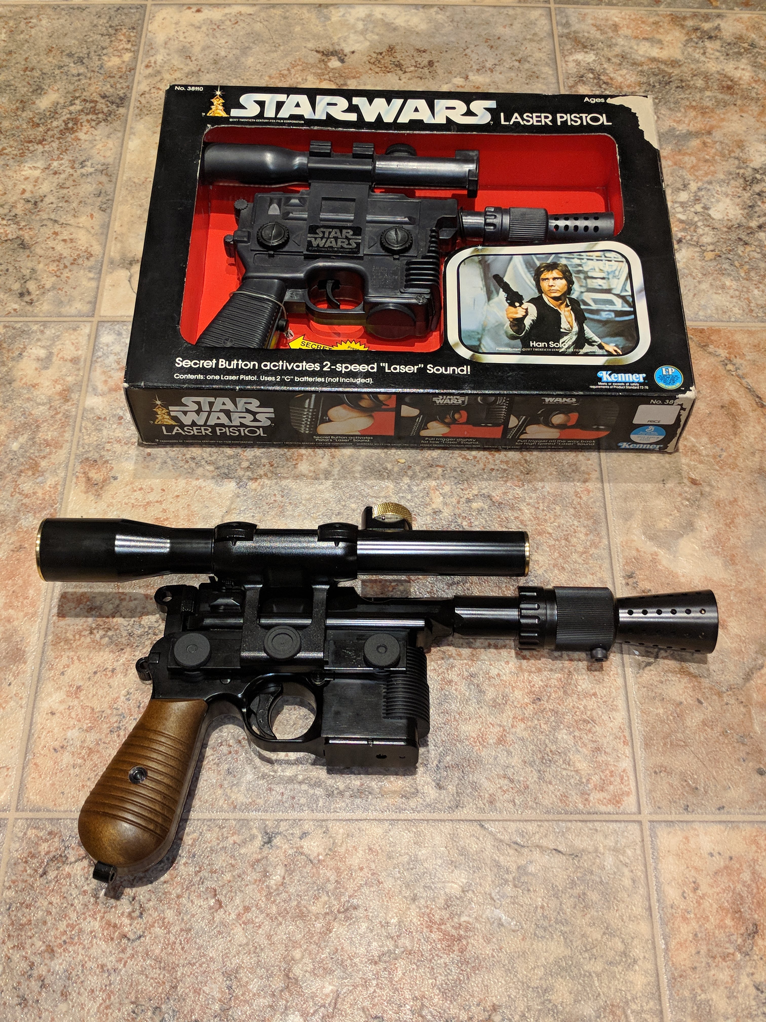

Mine arrived today. Now I have a companion for my original. ;)
Next is to do some weathering.

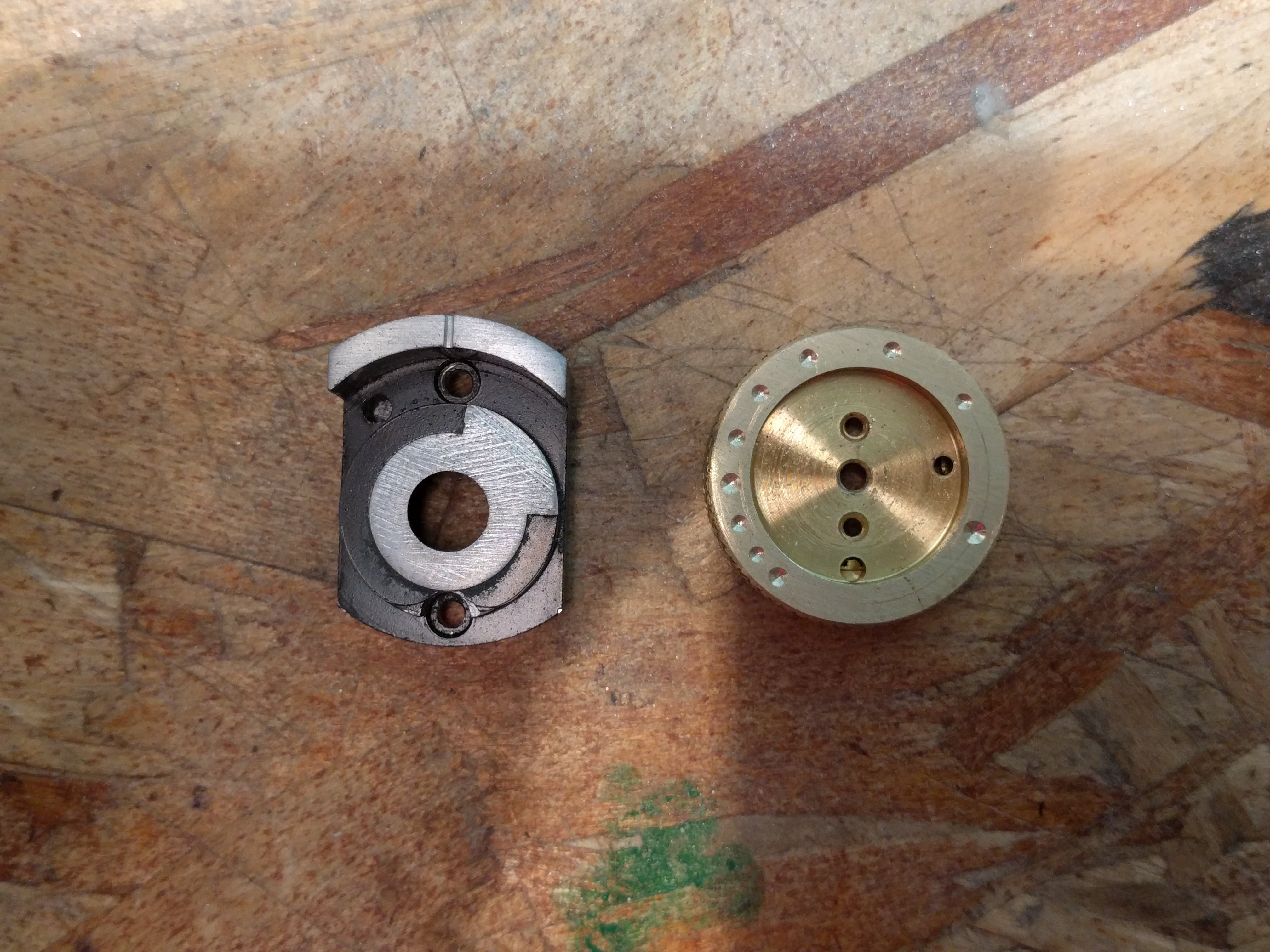

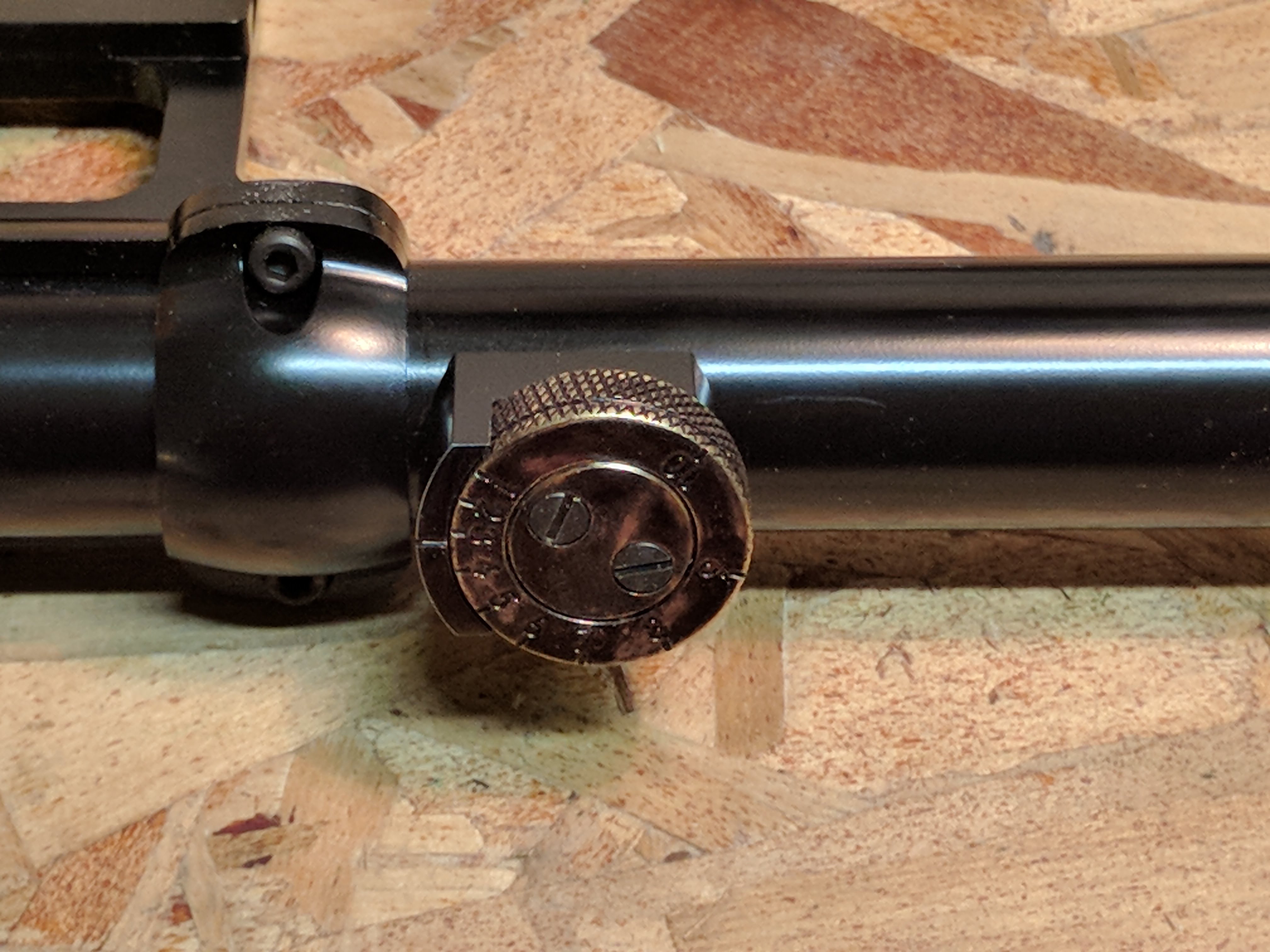

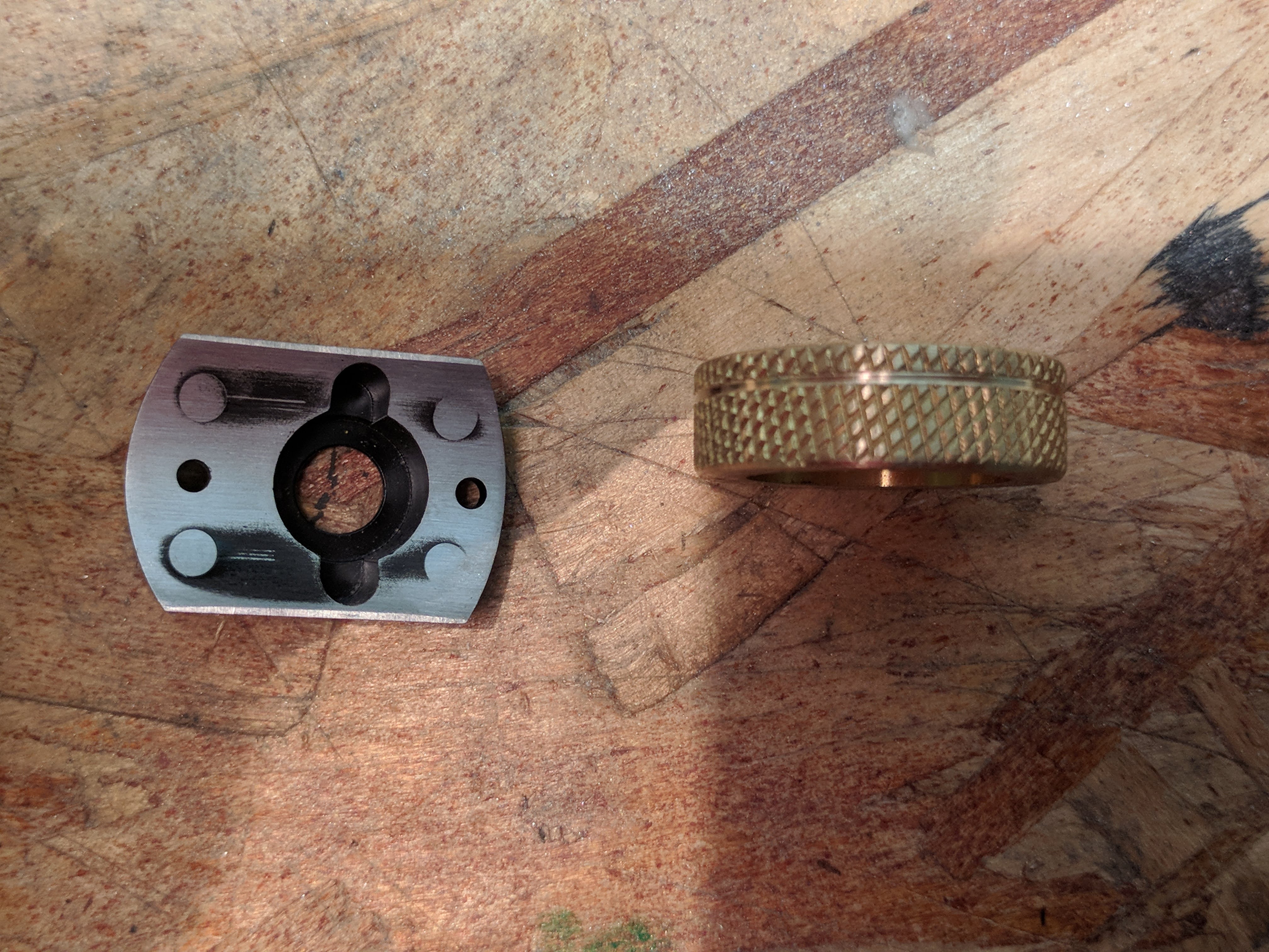

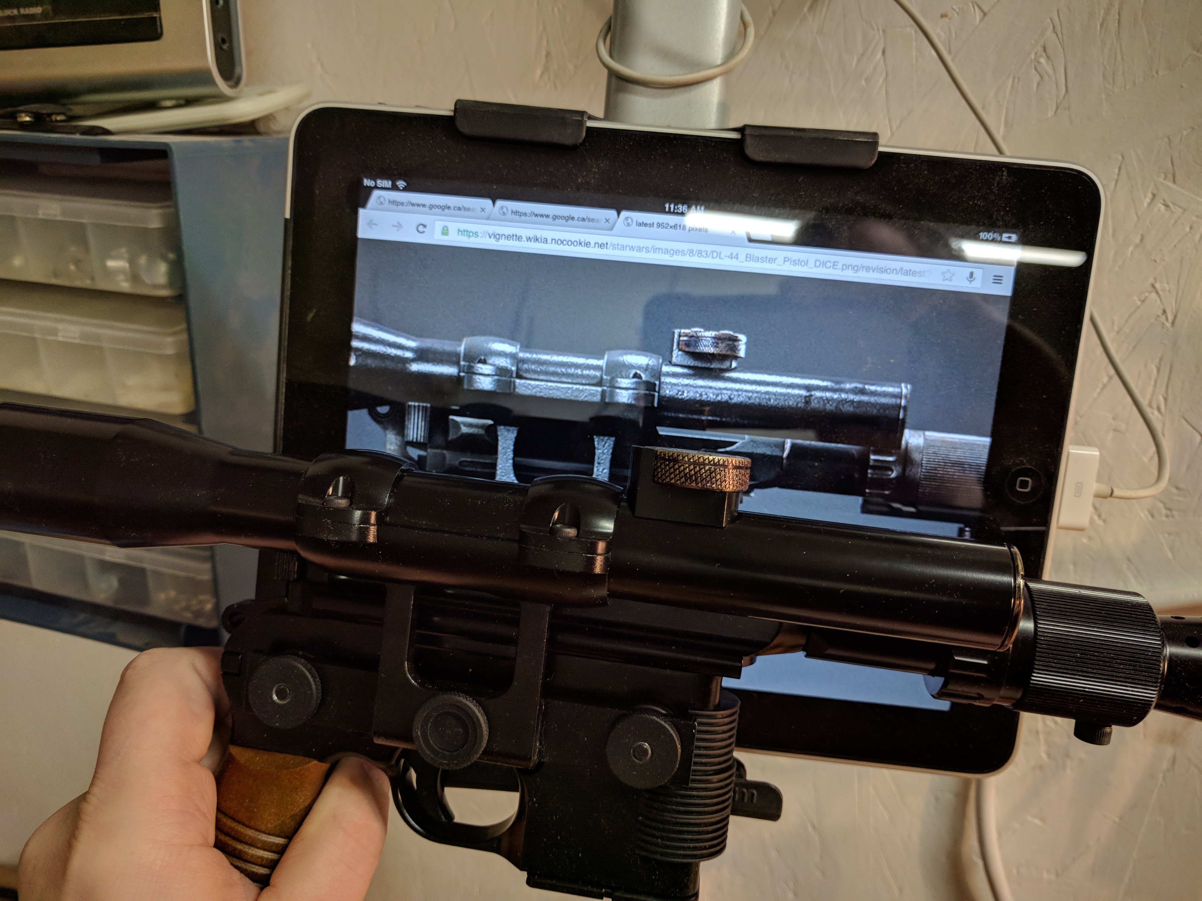

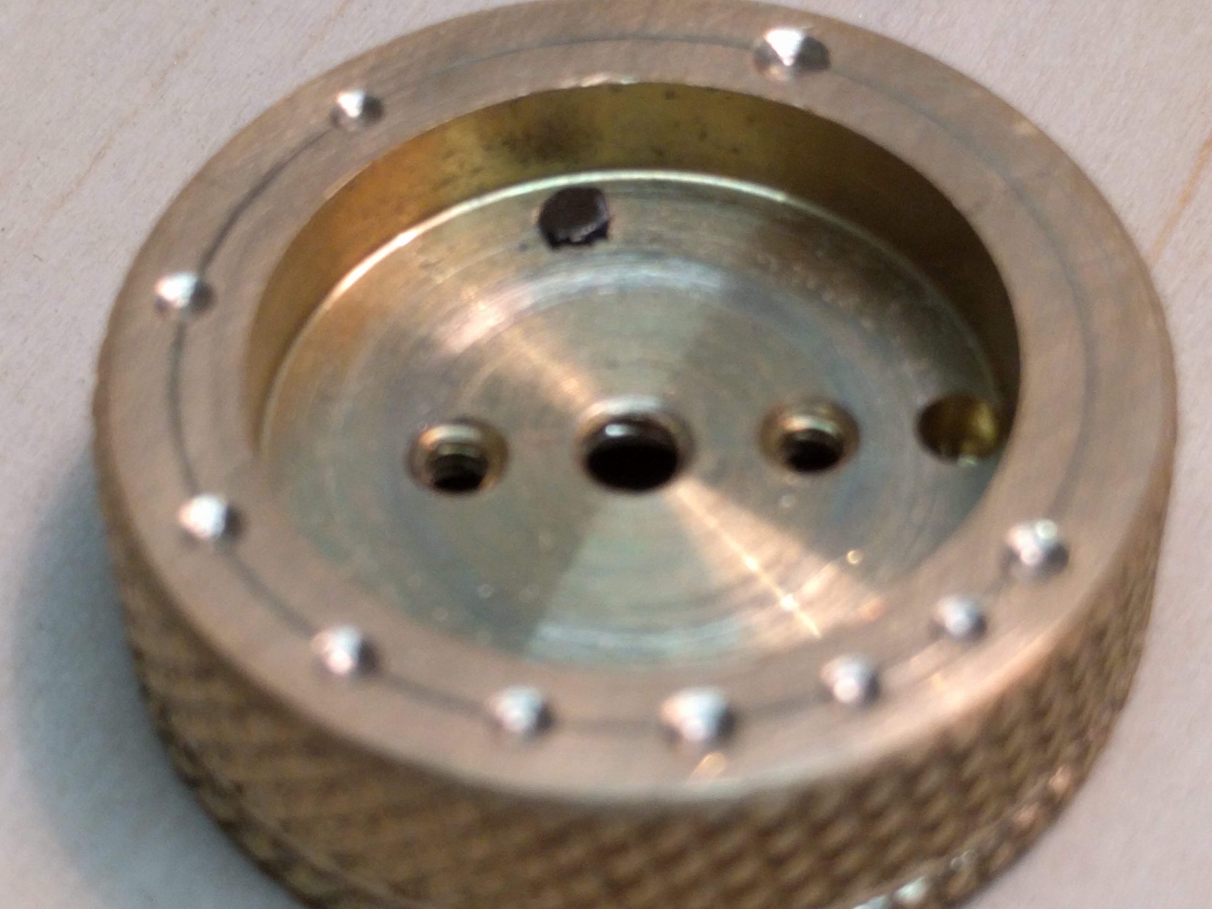

I modified the elevation knob on the scope. I sanded it thinner on my belt sander and filed the mount to match. I then re-made the detent notches.
Then I cut the groove and lightly sanded the knurling to take off some of the sharp edges and make it appear worn. The mount looked too thick to me, so I sanded a bit off. It turns out the scope diameter is the same as a 10 Gauge shotgun shell, so I wrapped some sandpaper around a shell.
I had to make a shorter stop pin.
I filed down the cross-hair bolt to fit the mount.
I blacked it out with a sharpie and weathered it a bit. I'm not totally happy with this and I think I'll paint and weather it again.
I'm pretty satisfied with the end result.
