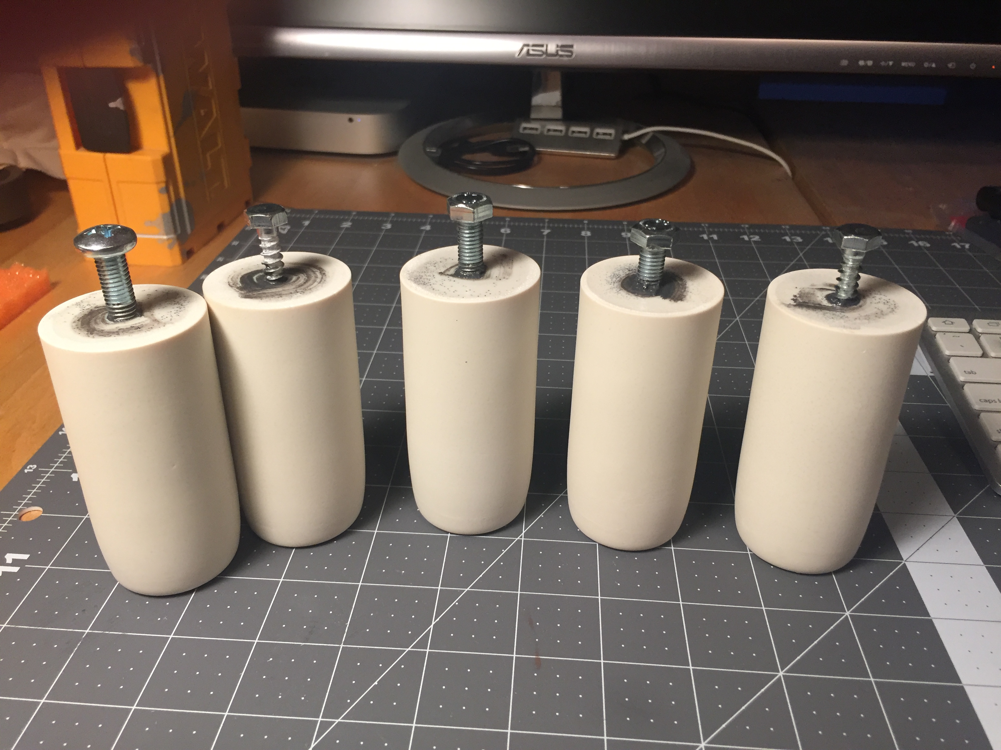

I made up 5 of the lower part and embedded a bolt so that it can be glued into the real top part. The top piece you see here is an altered CO2 spritzer. Very common on the bay. The side black piece is an altered CO2 screw housing that can often be found with a spritzer set. The lower chrome button was originally on the top and the top knob is made from the top of a vintage screwdriver. It’s the closet match I’ve found to whatever they used for the top. I will be painting the knobs and figuring a way to attach. I’ve painted this camouflage green. Looks to be close to screen used color.

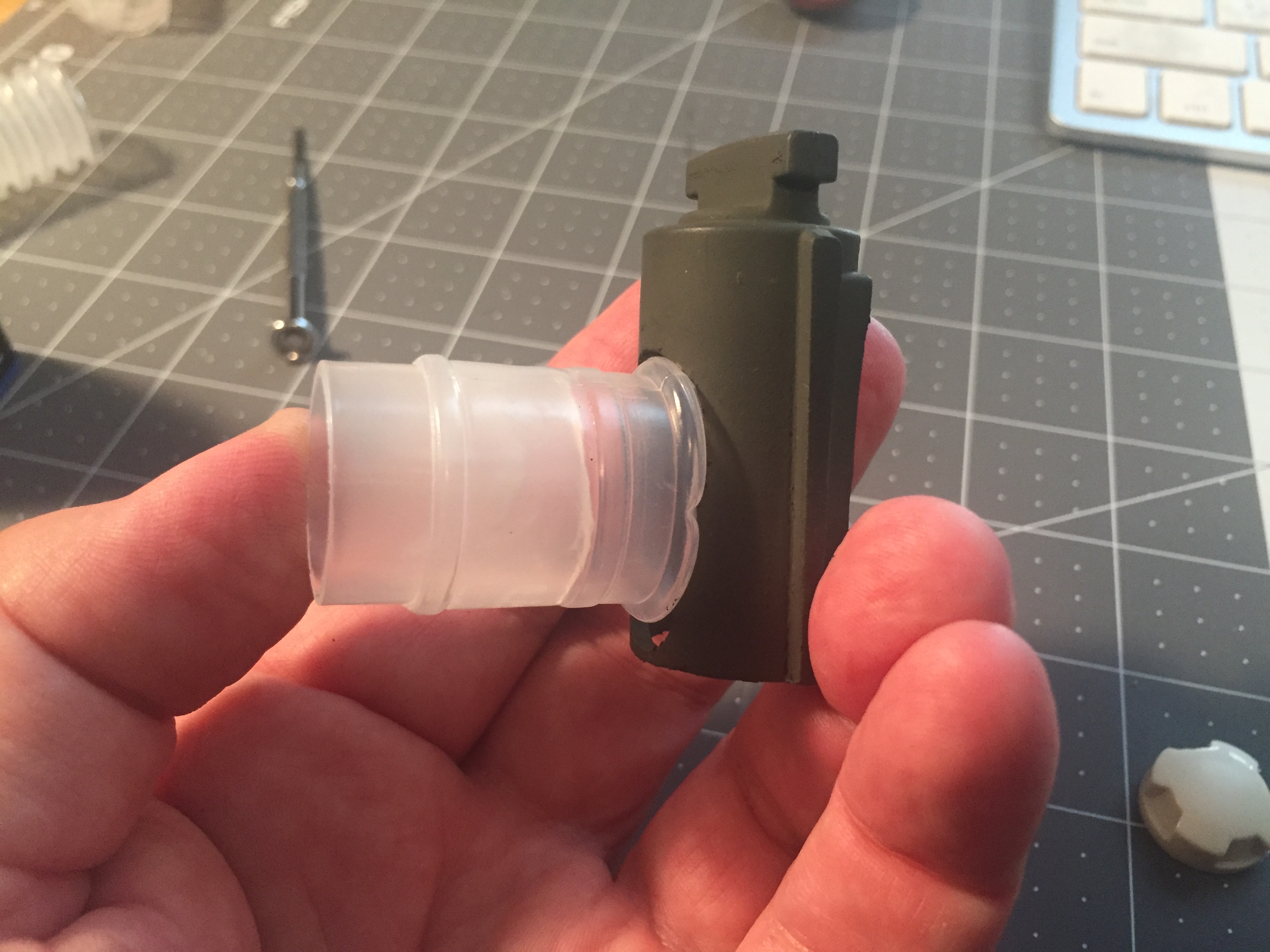

Here is how the 2 main parts connect.

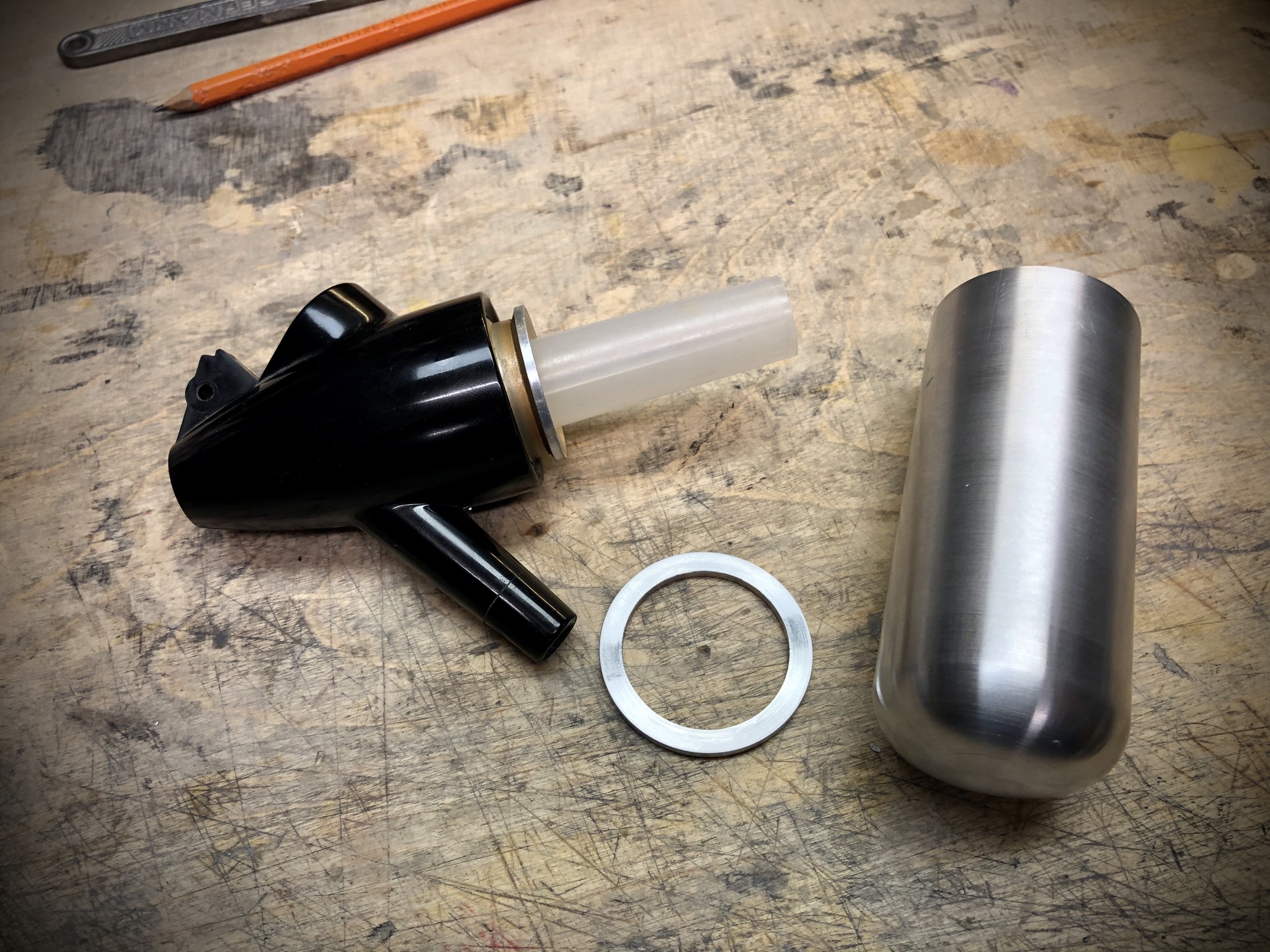

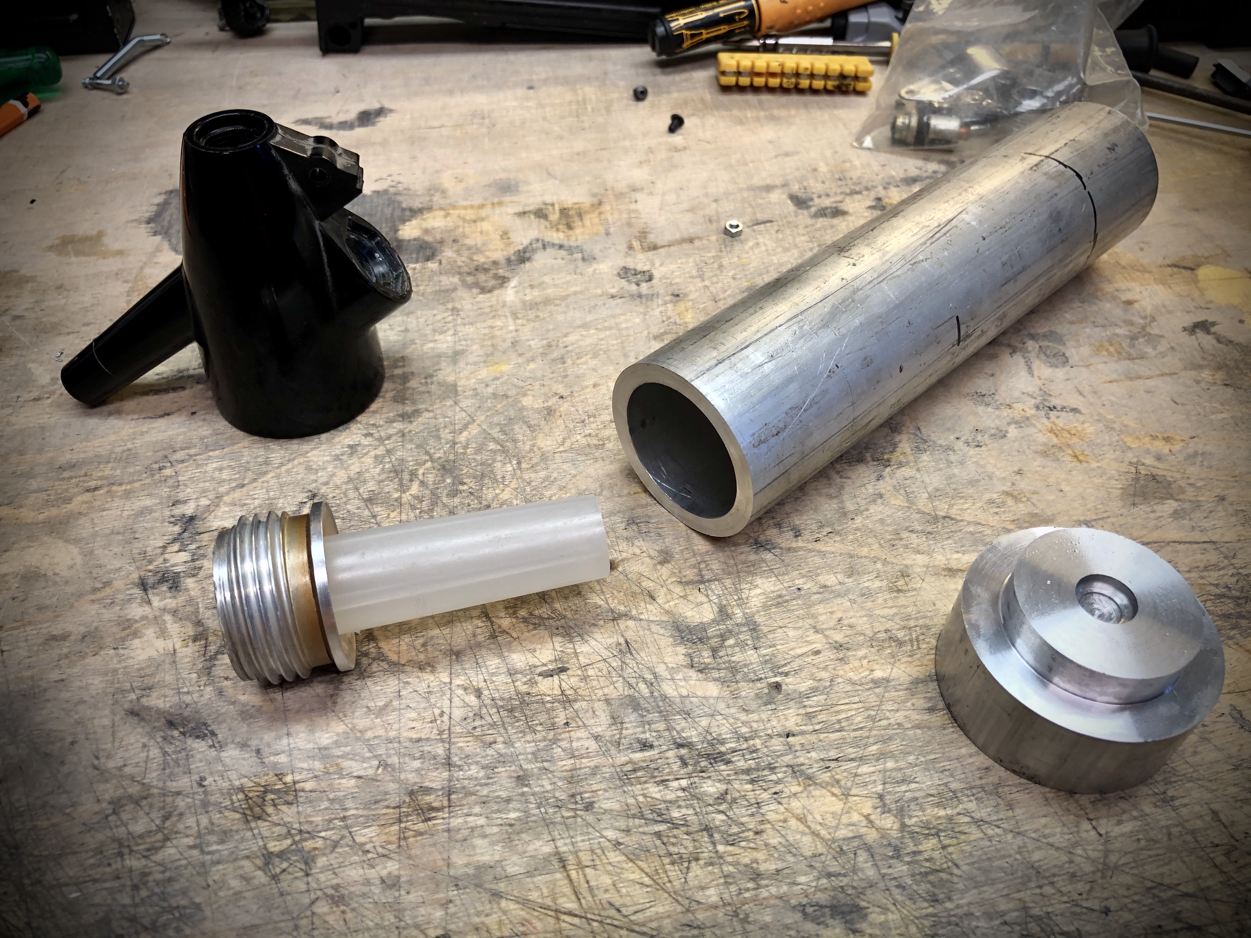

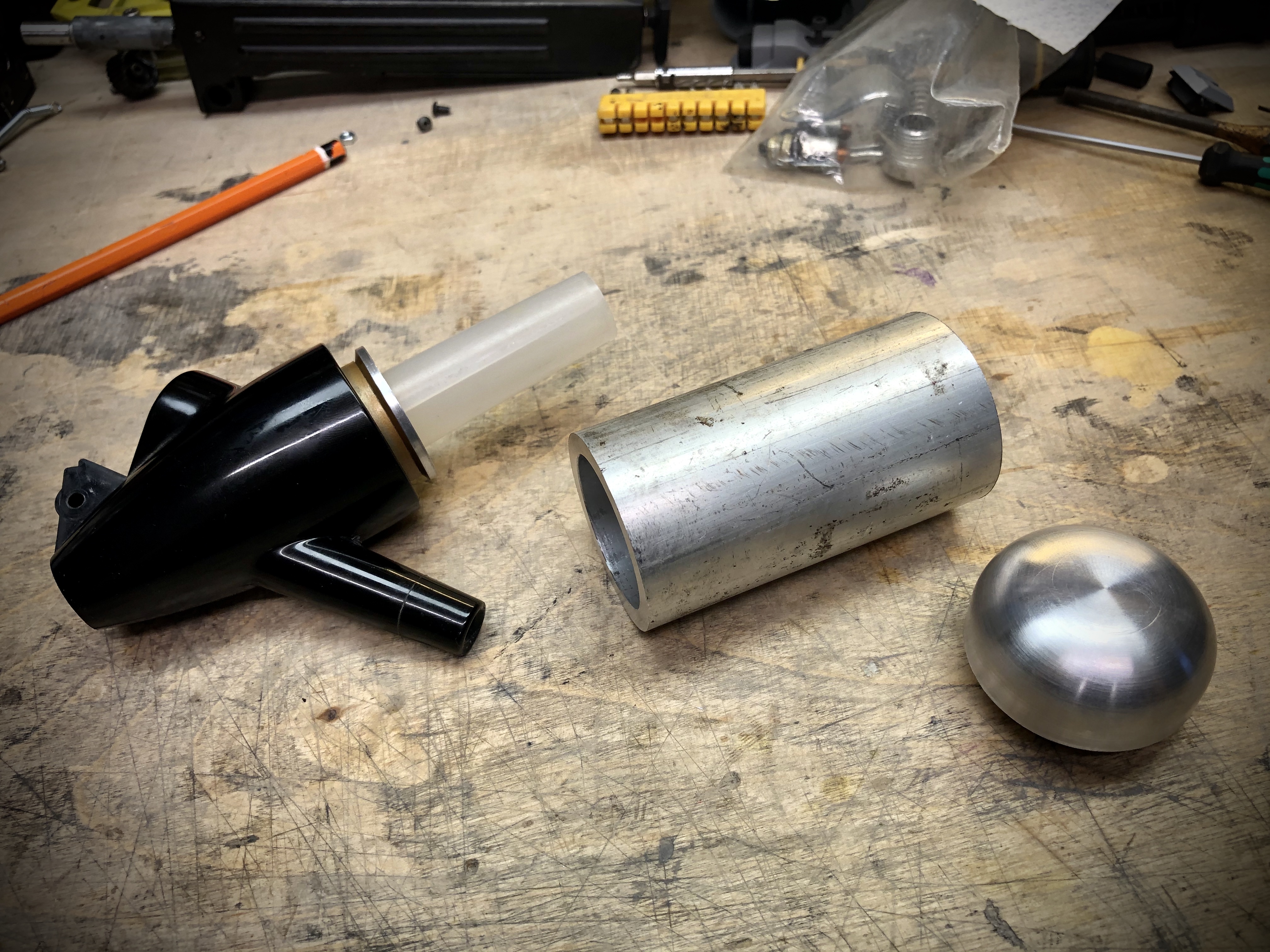

I just got one on ebay and was very lucky to find an aluminium tube with the correct diameter. So, as I always love to do, I will make the canister in metal.

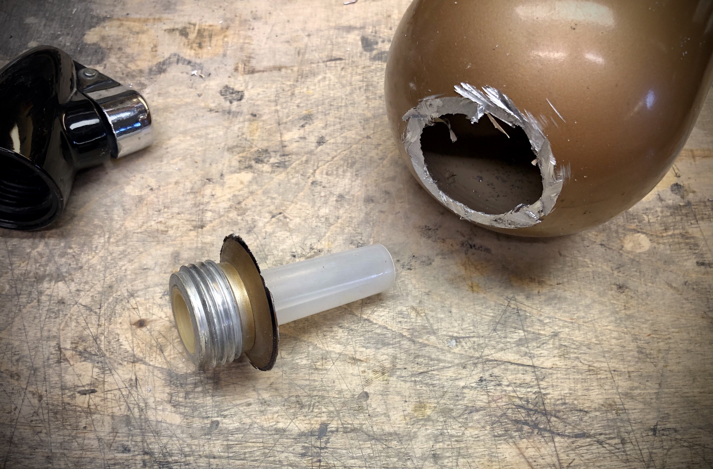

I cut off the threaded head of the bottle and milled it down to the inner diameter of the tube. I also put a massive aluminium rod on my lathe and made a piece for an end cap, so I can do the rounded edges.

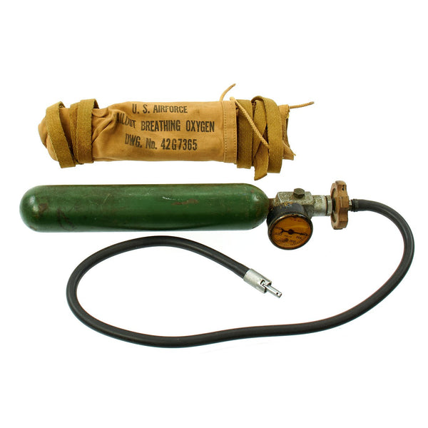

My fingers are tired from trying to find the mask strap but I’m a bit closer. Check out the writing in the mask strap. If we could only make that out.

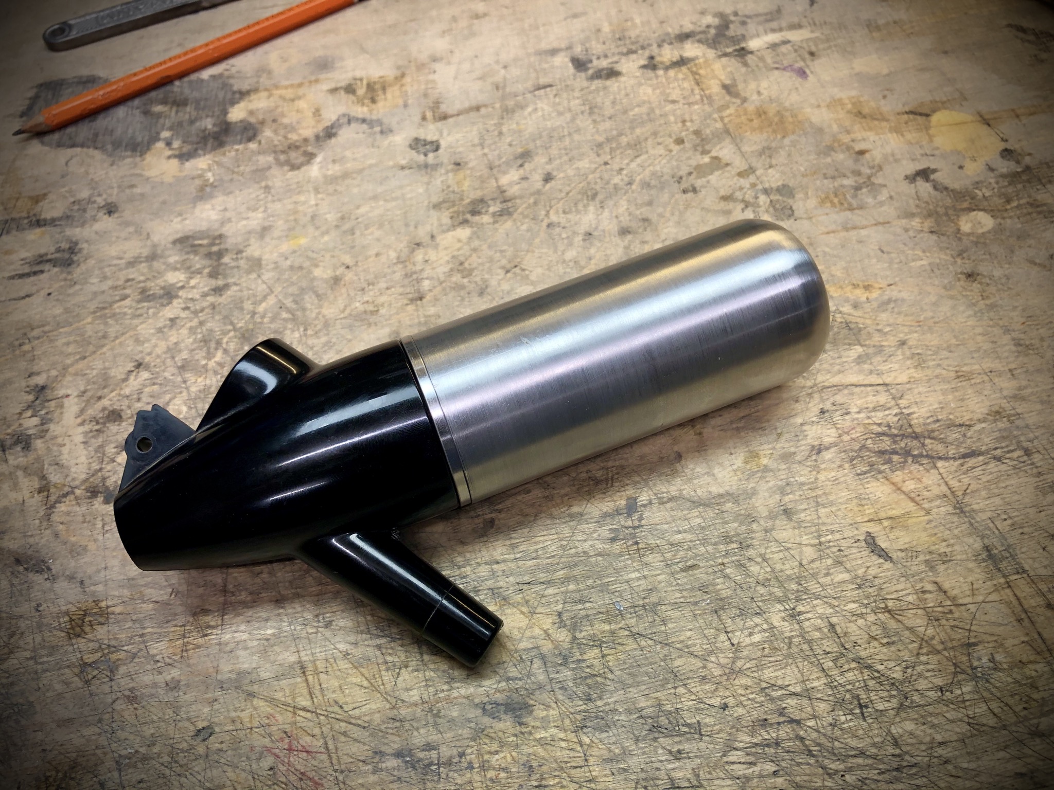

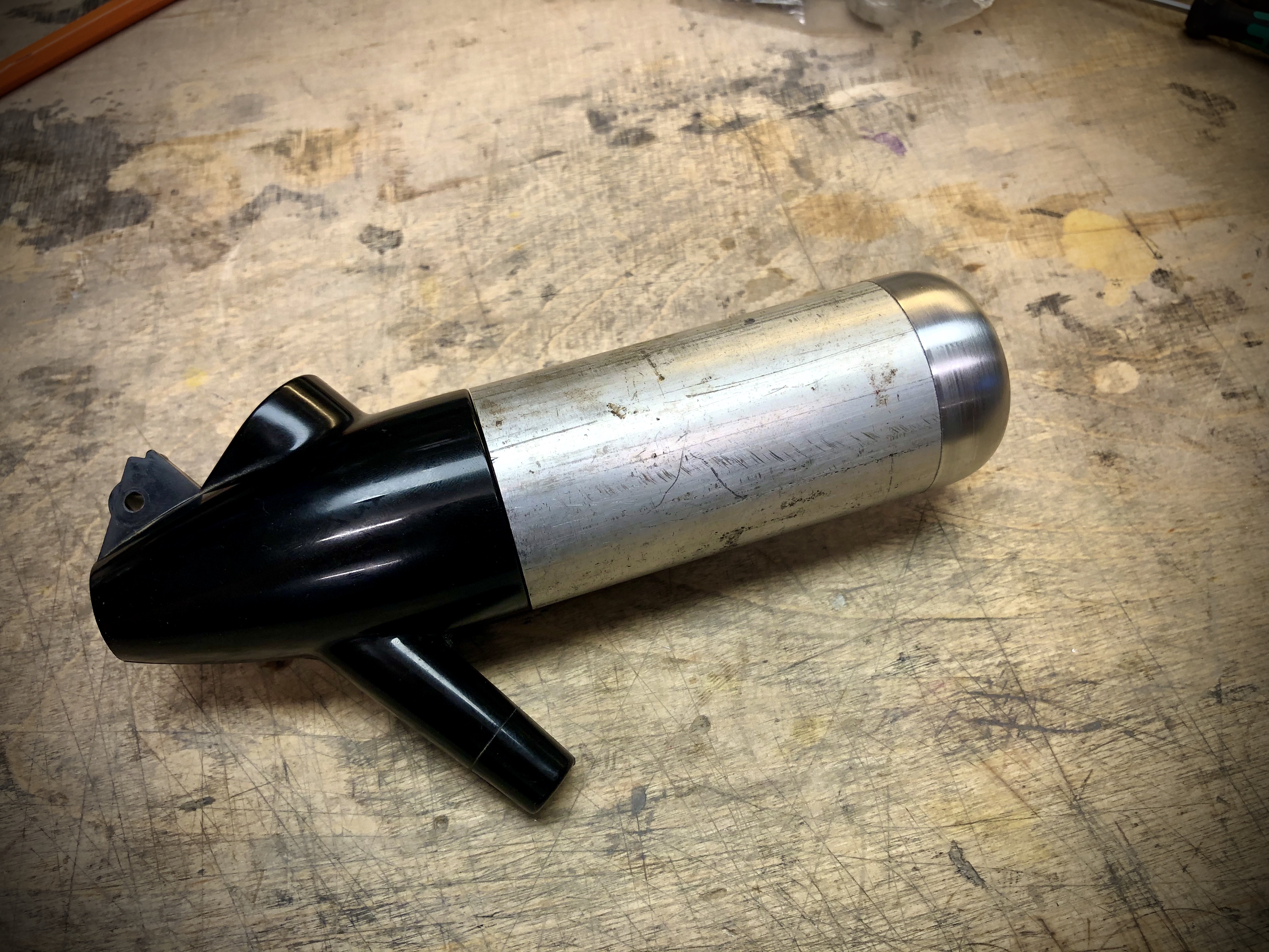

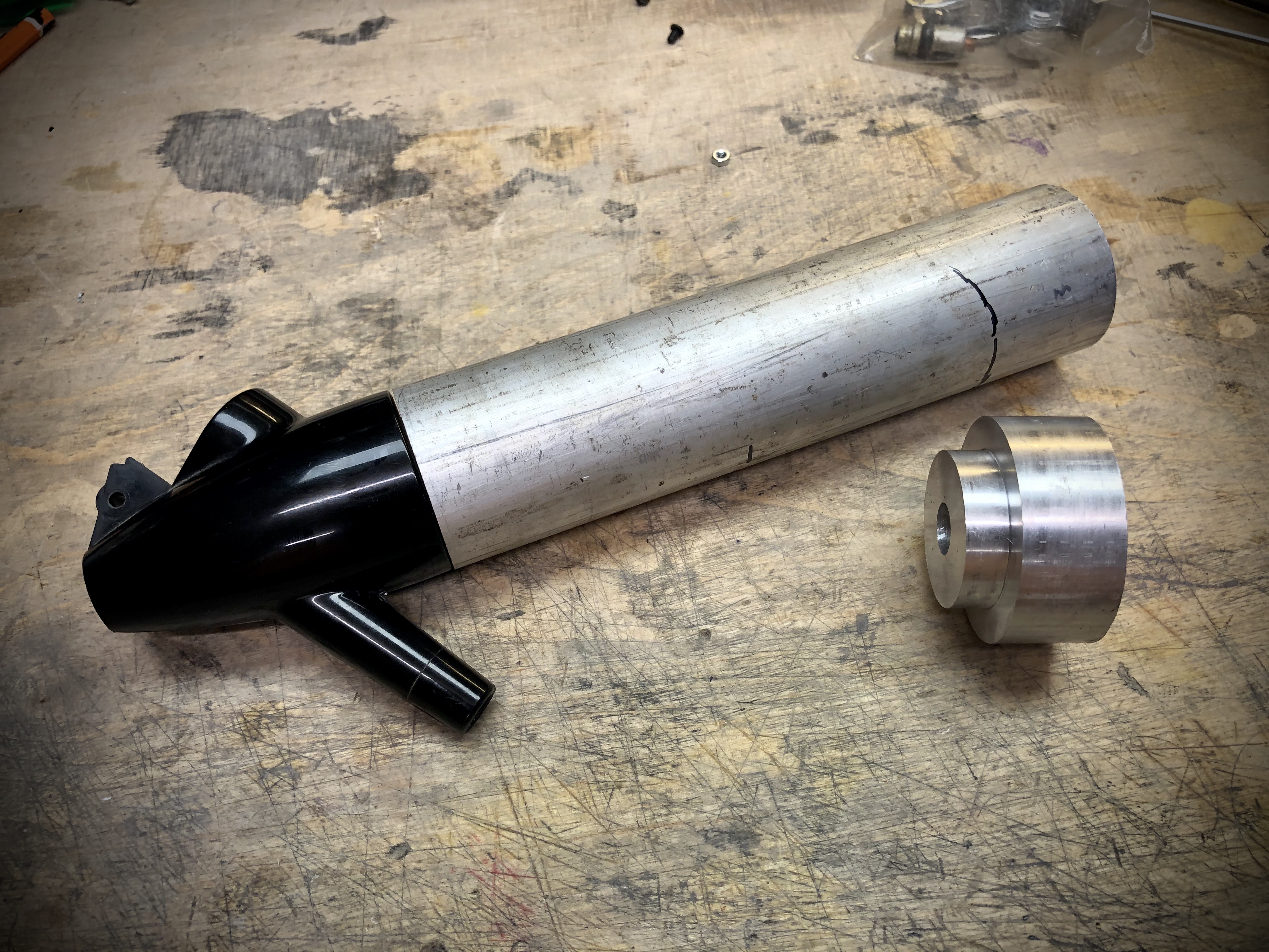

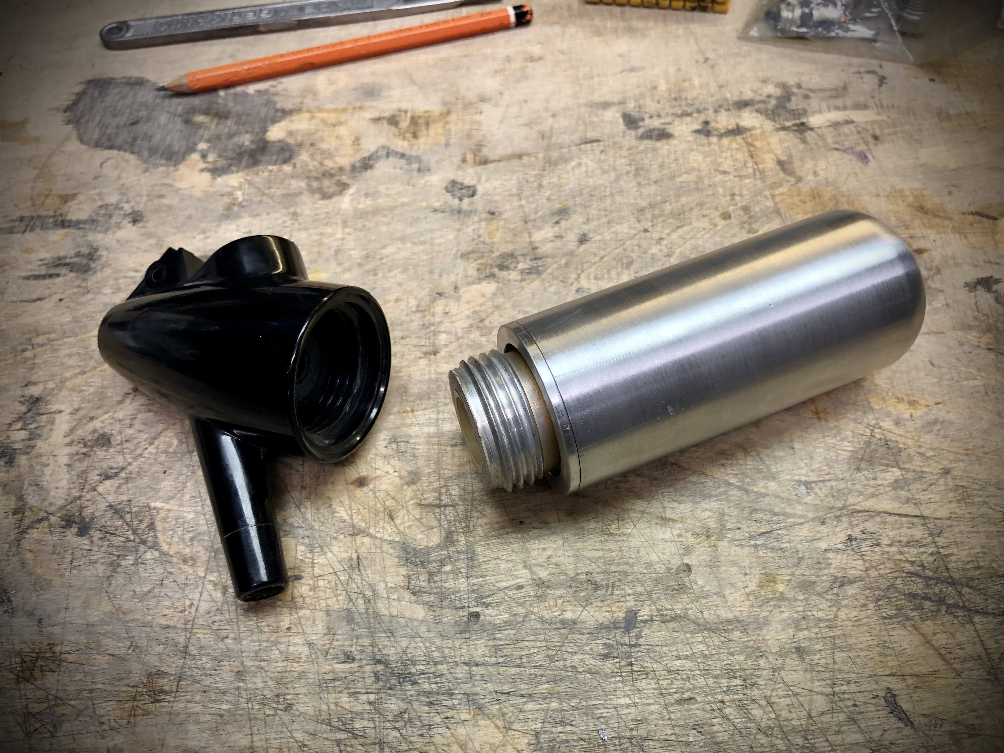

I rounded the end cap and glued it into the tube. Then I grinded all over to blend it in. I also did the slim ring you see in the original photos. I think it looks better as a single part.

Also working out some decals for the stripe and lettering and a clip. This one is from a vintage tape measure. It’s exactly what they would have laying around.
I have not read the entire thread, but I ran across this on IMA-USA, thought I would post a link for evaluation:
