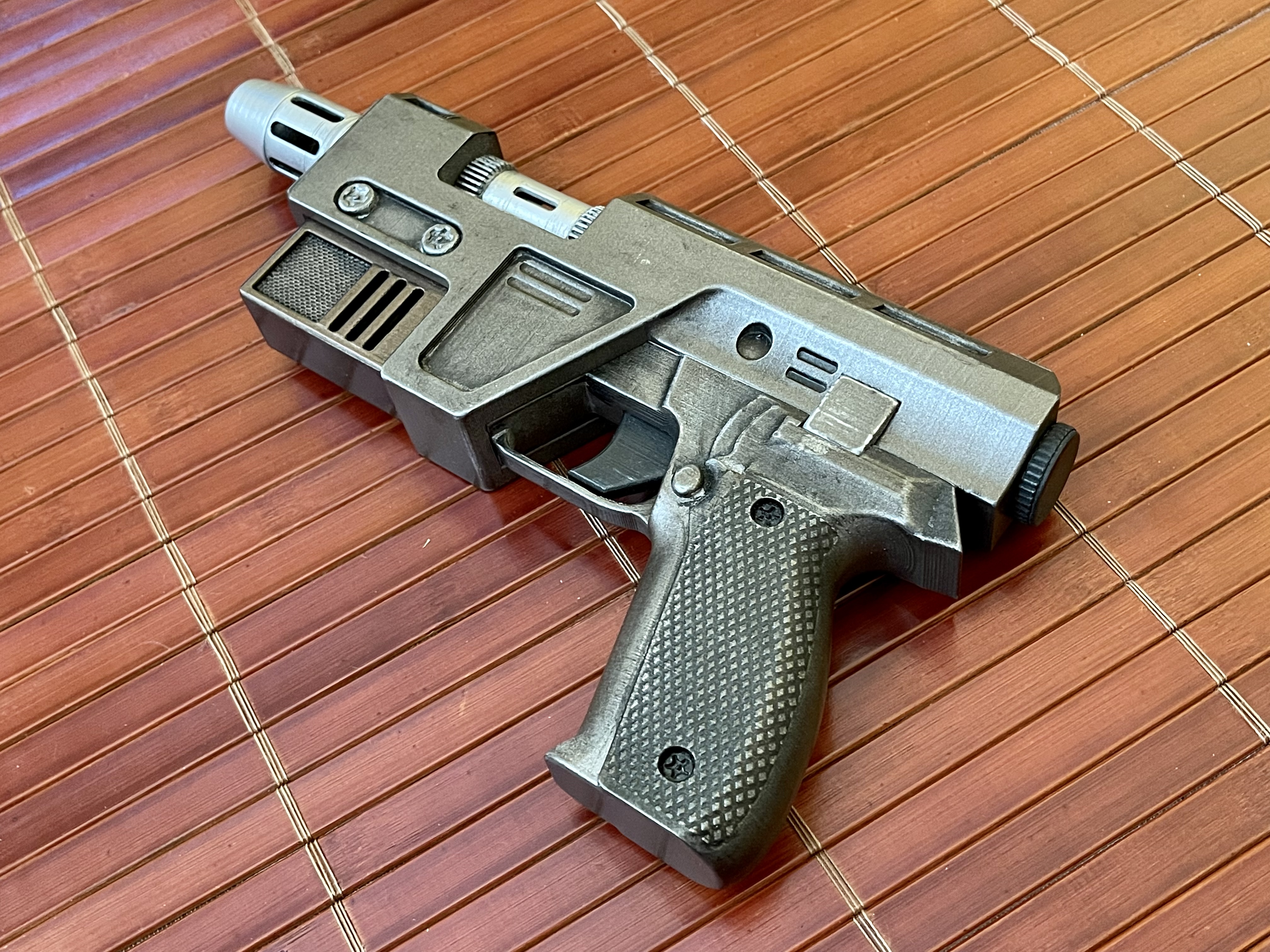

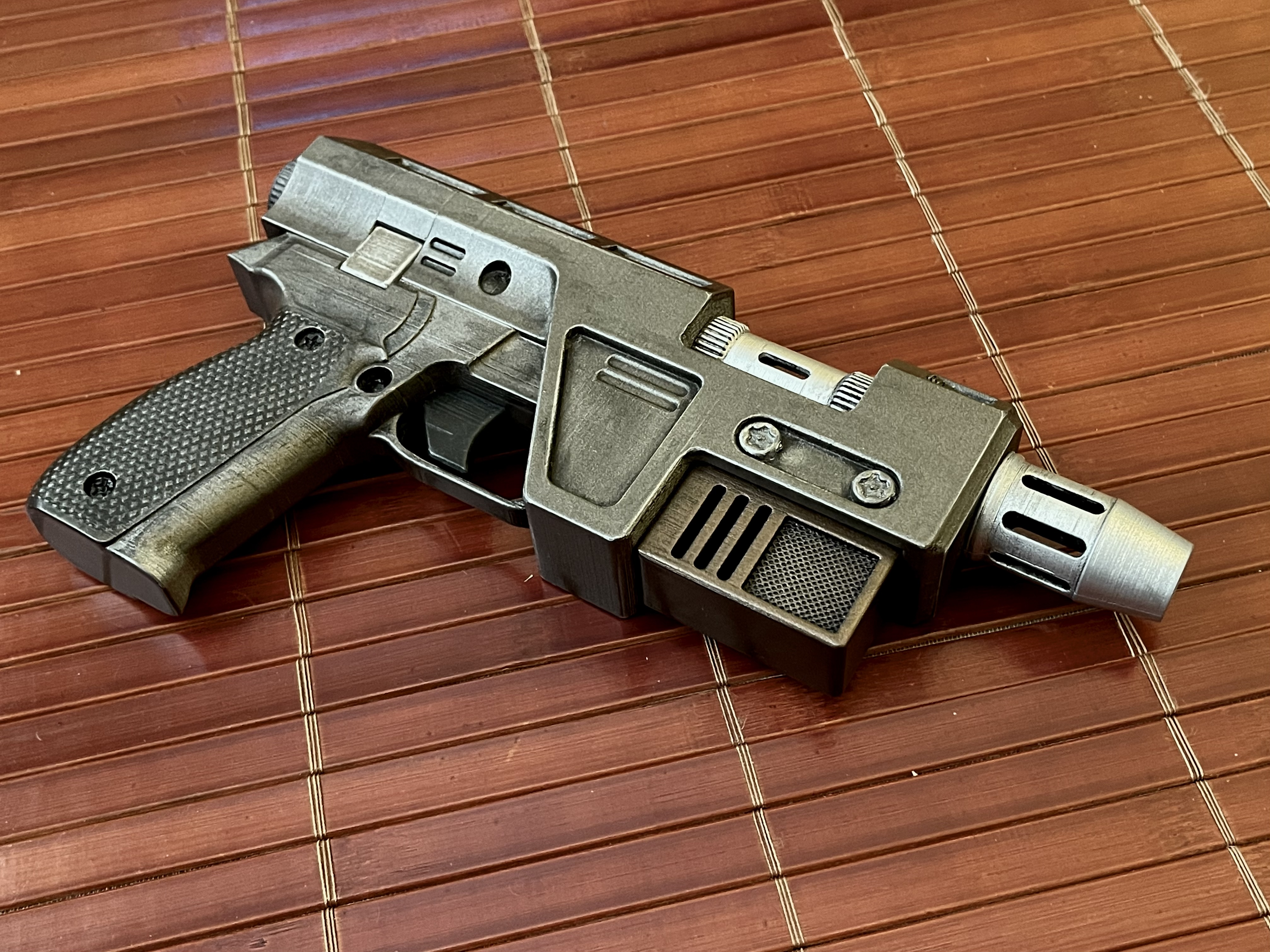

Finally had time an a good day to put the GLIE-44 blaster together. Prettty nice for a 3D kit. Probably could have dealt with the print lines better with a few more coats and sanding off filler primer but I really wanted to get this done. The weathering hides most. Really happy with my paint color choices. I was able to fine some good images where the main body is darker. So I used an aged bronze which looks pretty good. It might be similar to the real prop as I saw in some of the photos I took of my replica that in the right light appears more toward a silver tone.

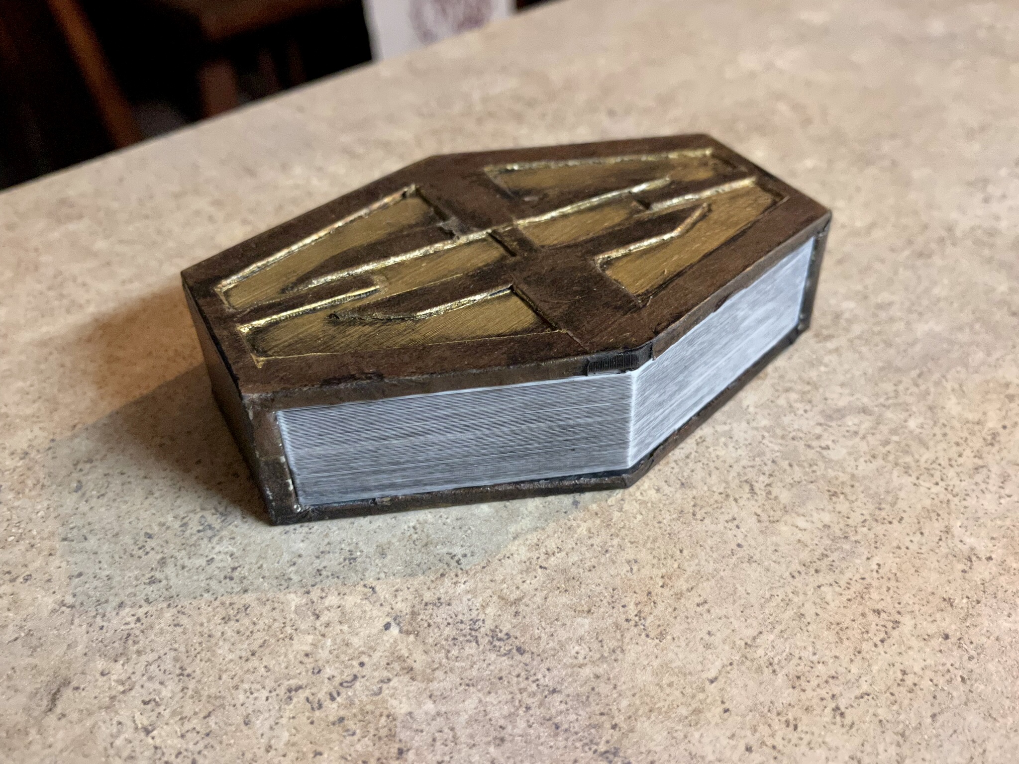

A few years ago I bought a 3D printed case for my fan made Sabacc deck. It was just black plastic. At the time I just used an old brown paper lunch sack to cover the surface and did a brownish rust weathered paint job and put the deck inside.
You can see it here:

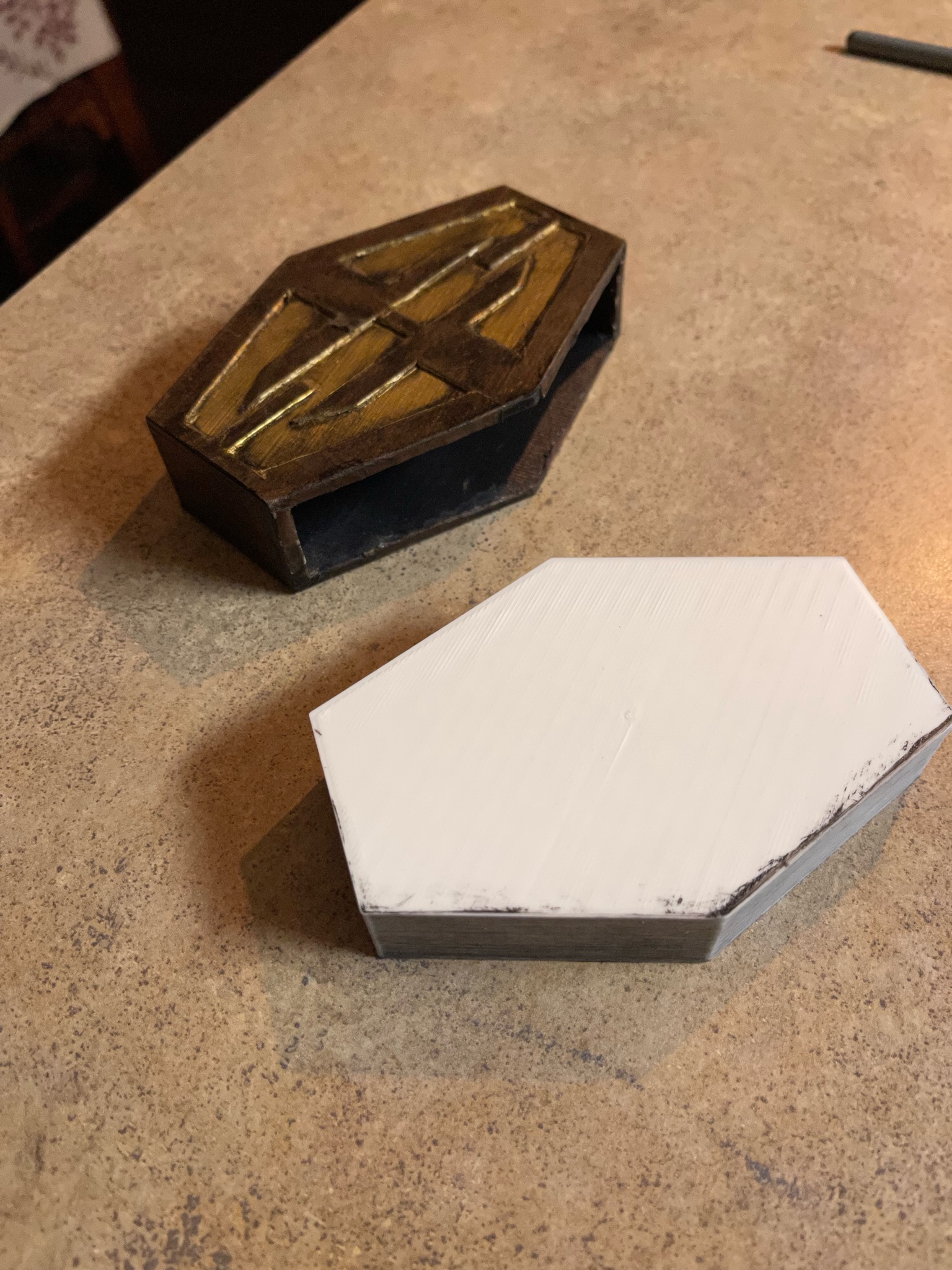

A few days ago, I was messing with my Sabacc display and realized the deck was very tight inside and it took some time for me to safely remove the deck. I determined that I would not to use the box anymore and even considered throwing it away. But I had an idea…
The first thing I did was to finish the case. I never got around to adding the gold inlay, so I painted the inlay and weathered it. Next, I had the idea of making a faux deck of card since the box was only for display anyhow. I decided to 3D print the deck as a single block at really low resolution so that It would have very visible print lines. For once, print lines would be my friend. Once printed, it was just a matter of a quick rubbing of black paint on one edge, and I was done with my display deck.

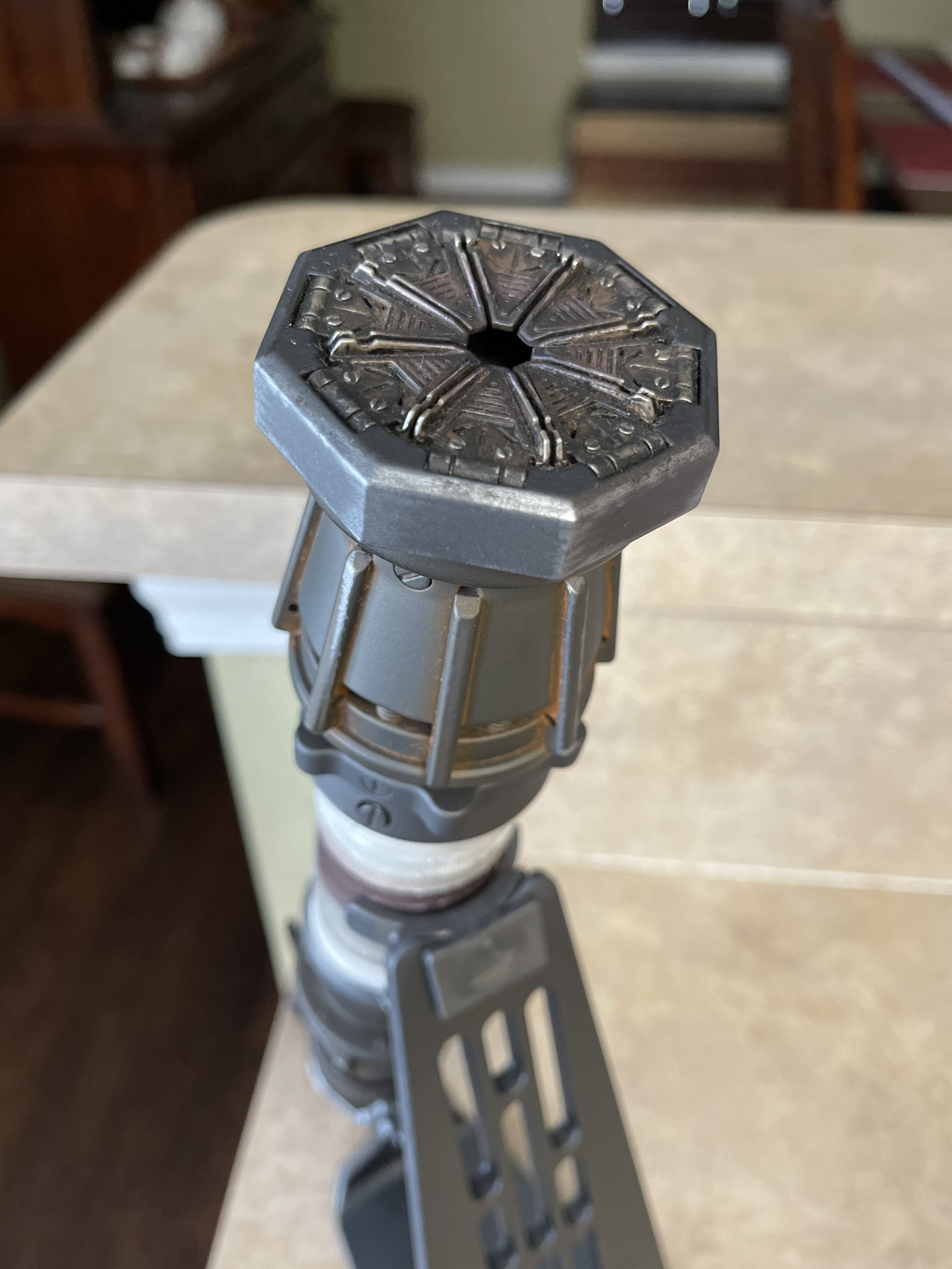

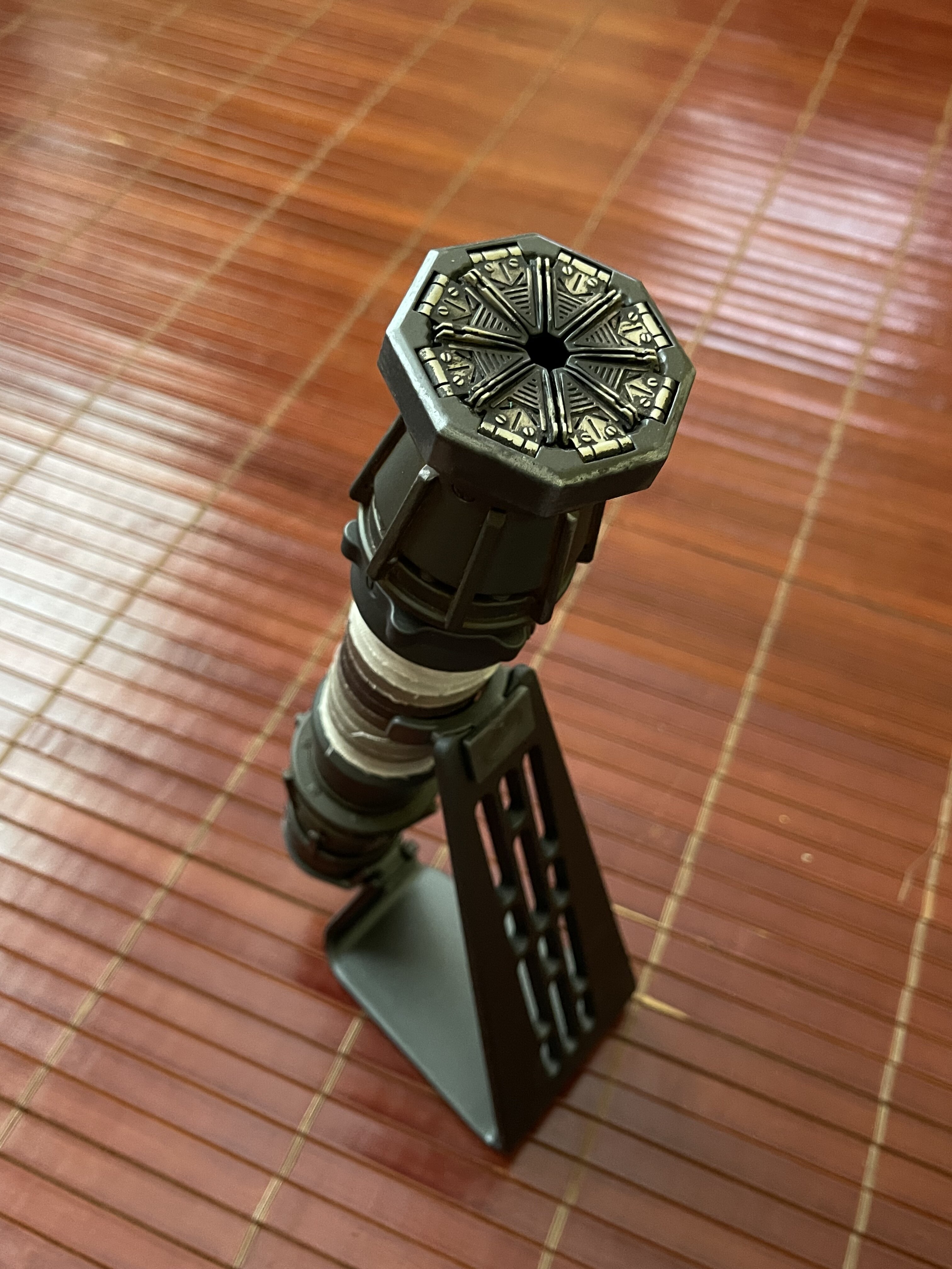

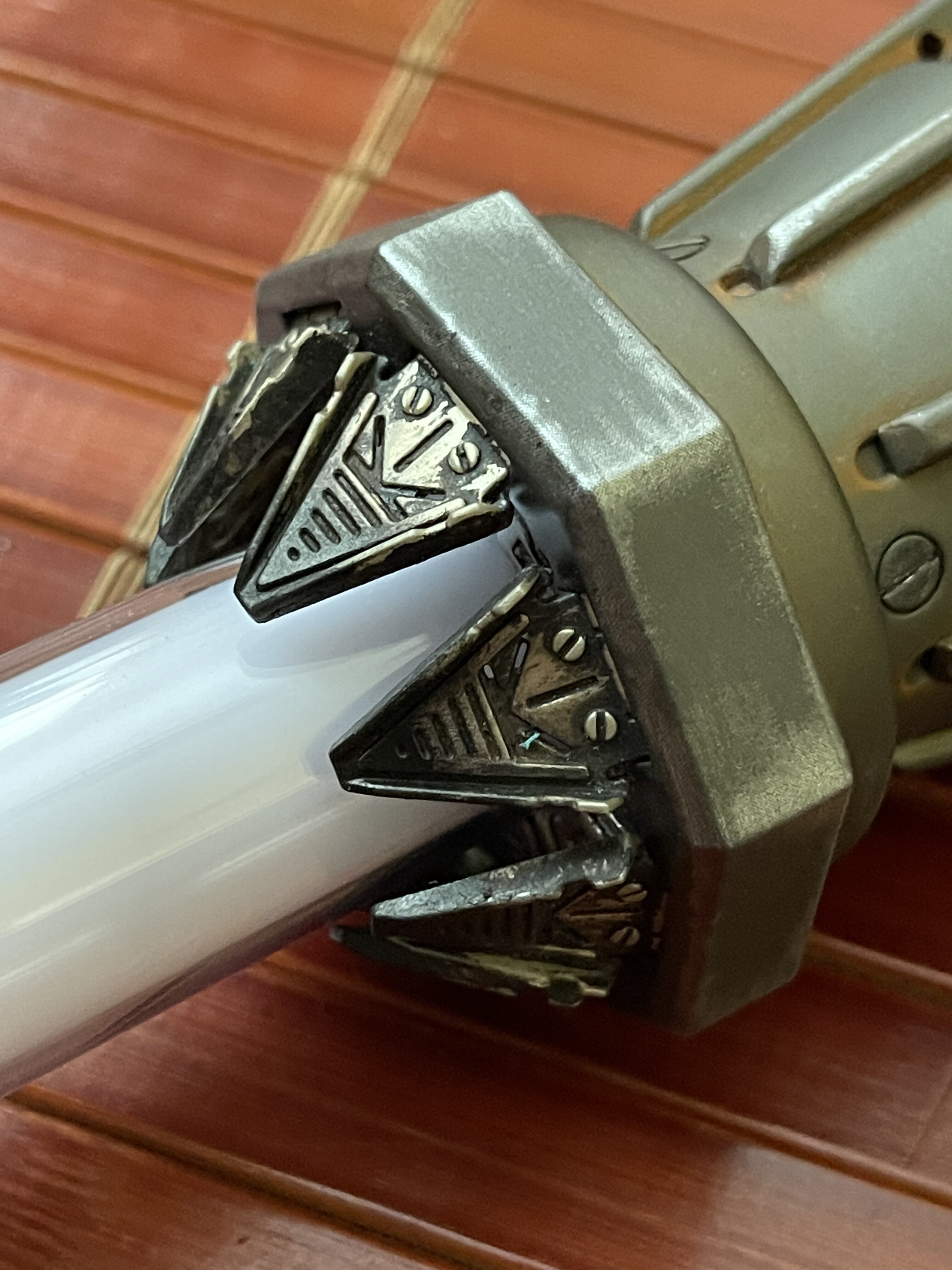

Got the Black Series Rey Lightsaber today and I love it…. Especially at 40% off.

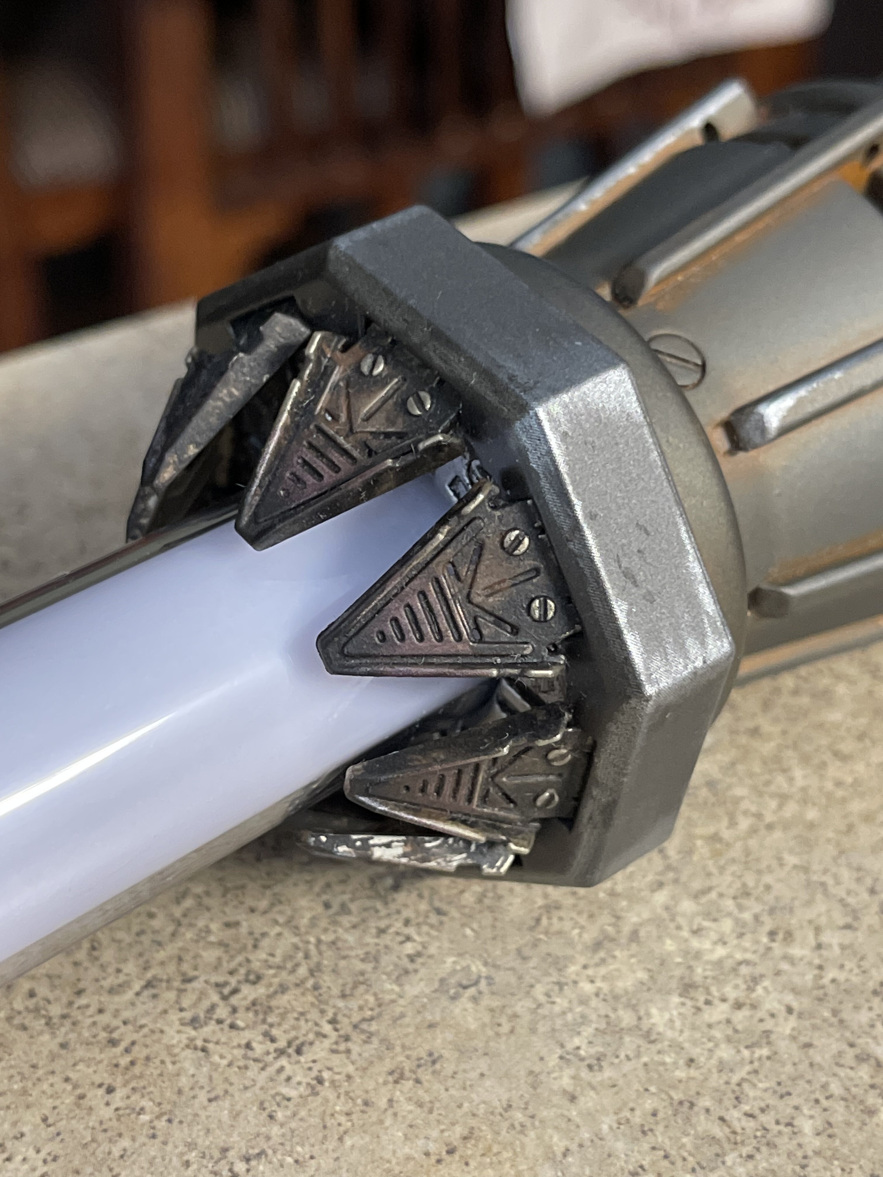

The biggest issue I had with the BS Rey was the plastic looking emitter doors. I took care of it with some black and brown acrylics.
Before
After

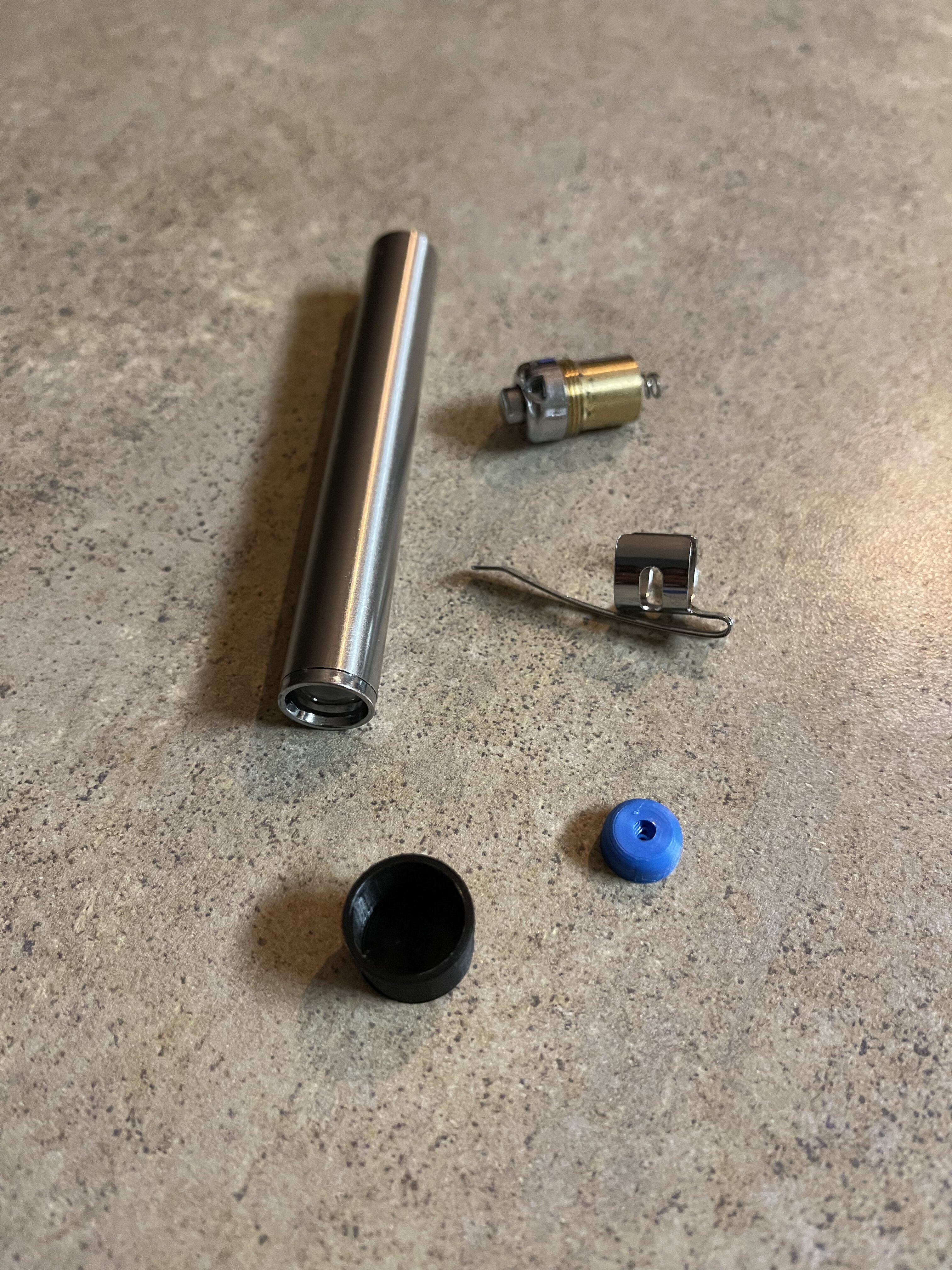

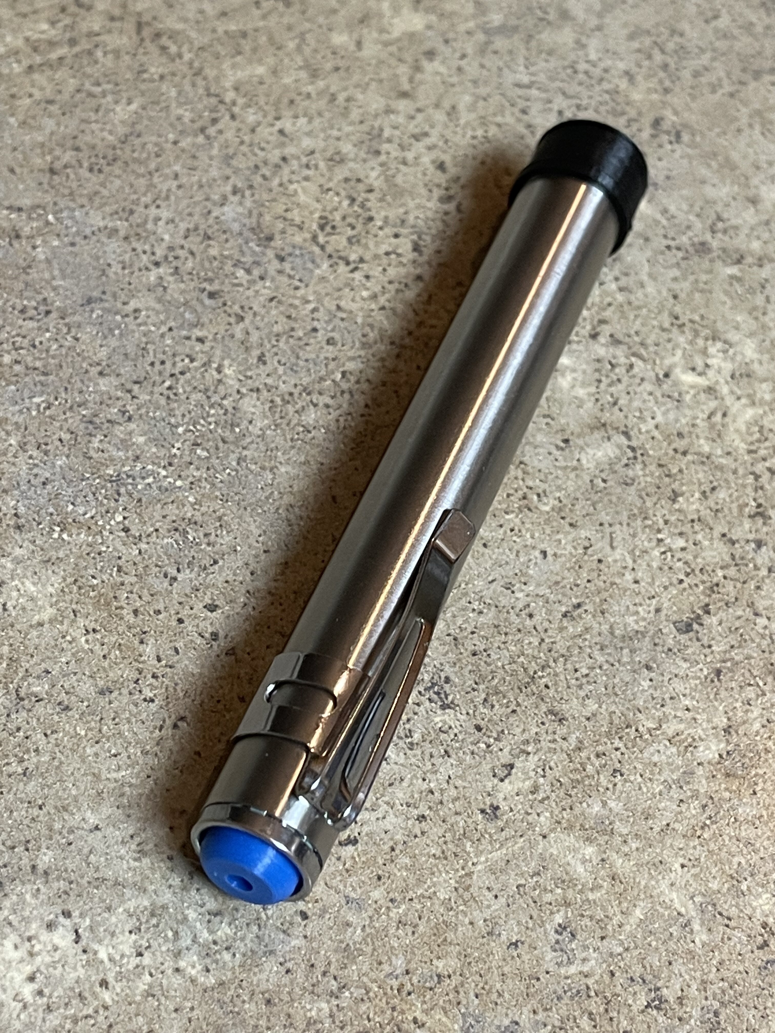

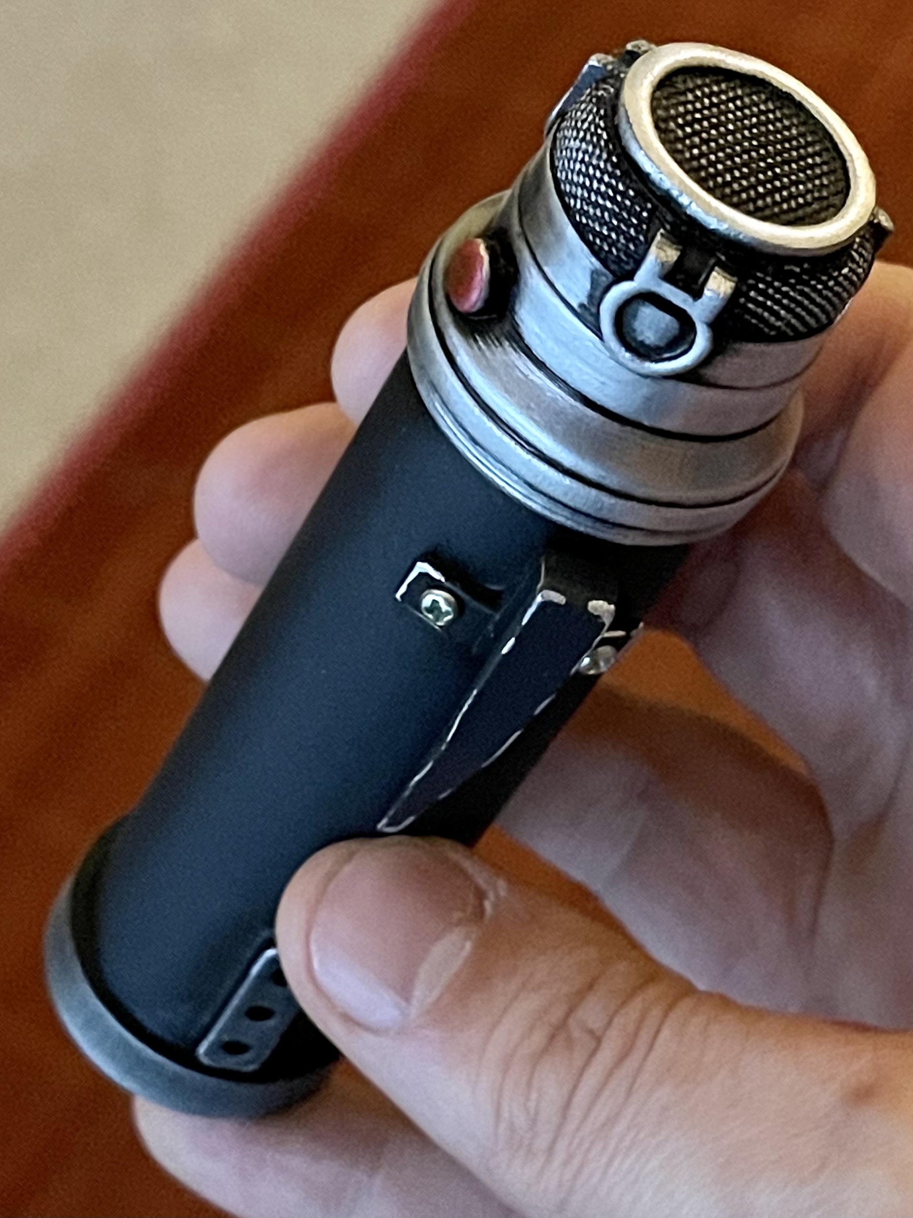

I had a broken penlight that I thought looked something like a Imperial code cylinder so I took it apart, made a couple of simple 3D files and assembled. It’s not meant to be accurate, just something idealized that I can stick in my bag I carry around Galaxy’s Edge as an accessory.

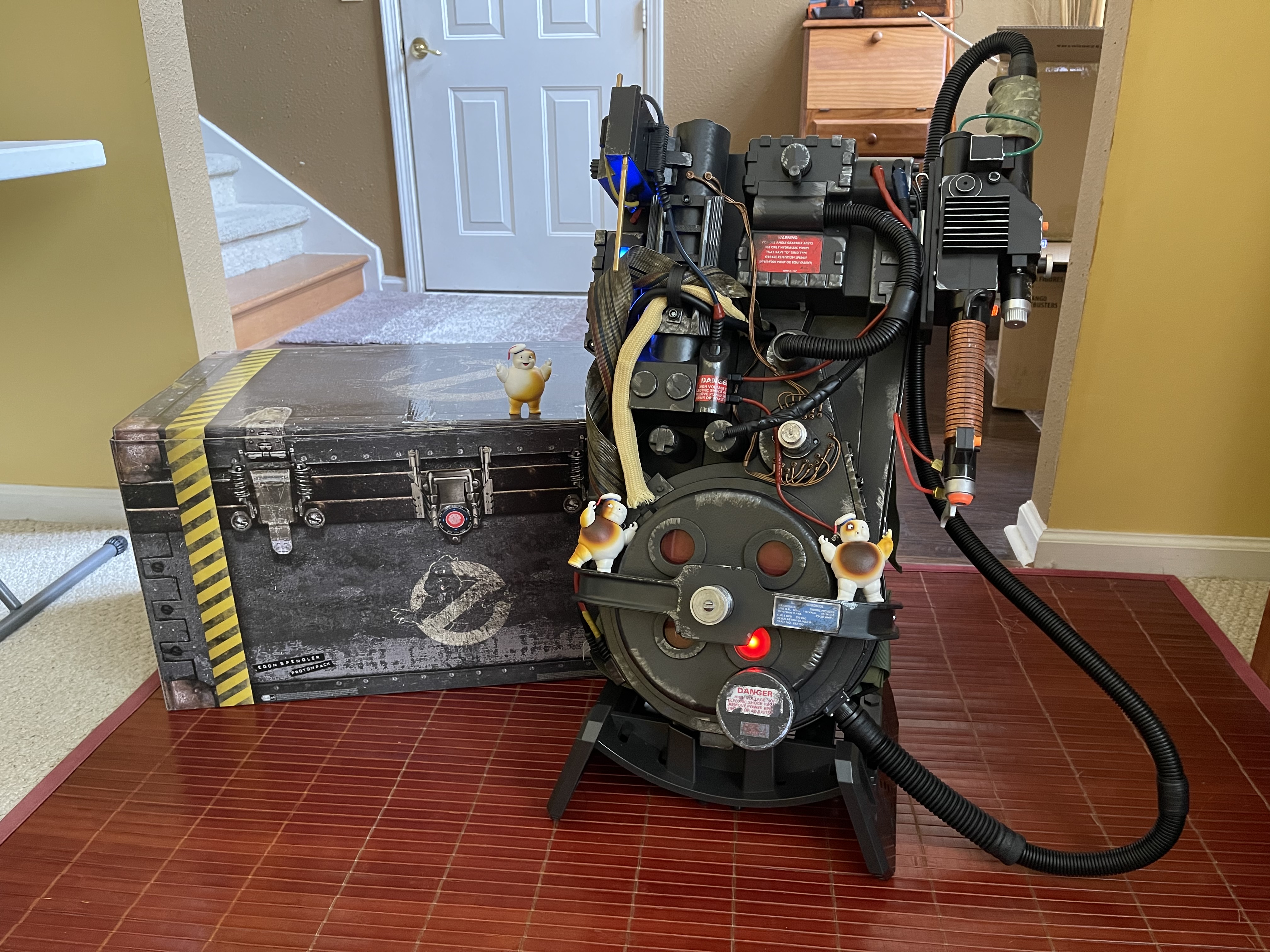

I usually try to keep my prop collecting contained to mostly Star Wars but when Haslab offered the Spengler Afterlife Proton Pack, I had to jump on it. Here is what it looked like out of the box with wand (not included) attached.
Of course like any prop replica offered from a retail production run, there is a community doing mods. Some very extreme. However, I am very happy with what I have so my mods are very minimal.

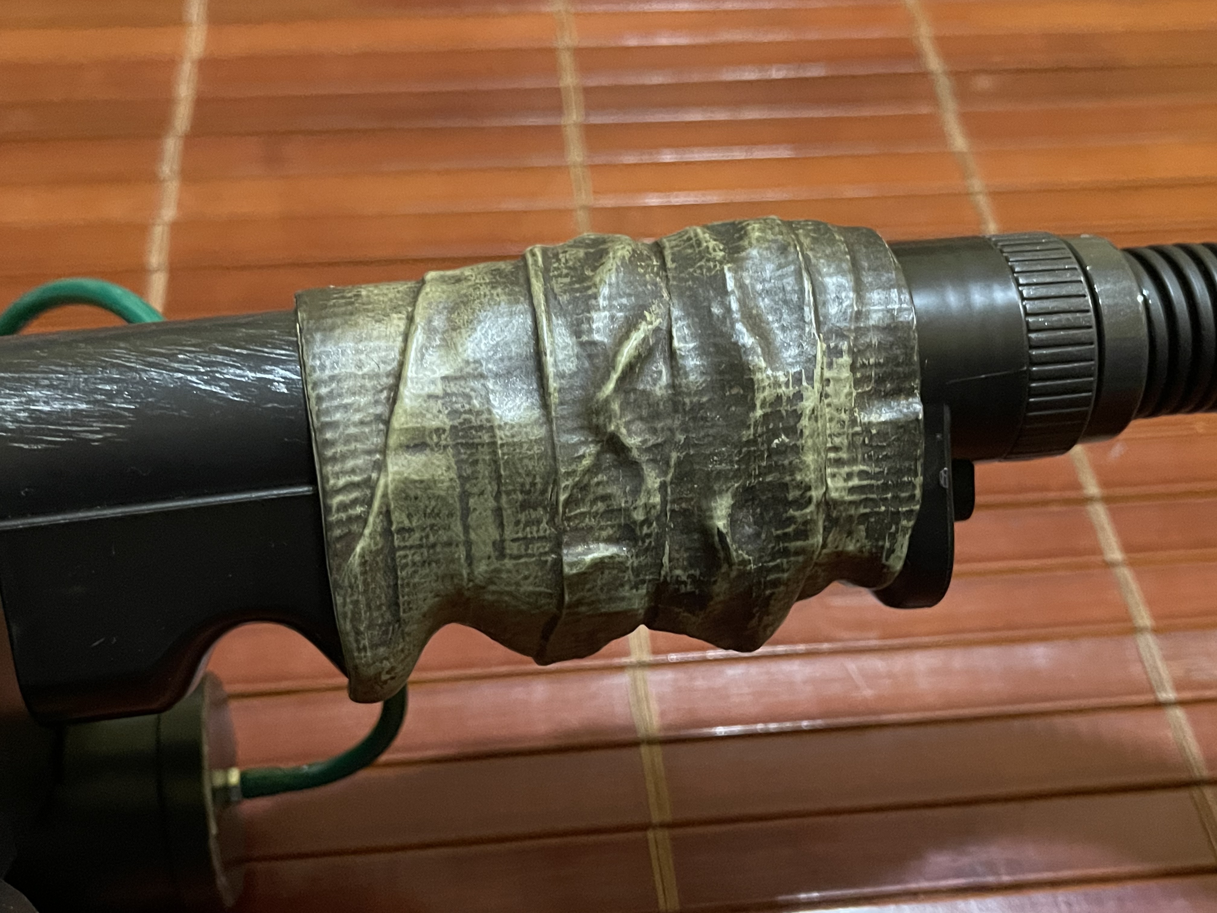

The wand grip has a faux rubber to look like gaffers tape wrapping. If you cut it off, there is a gap. Some have filled the gap with a #D print insert and used real tap to wrap it. Some have used a 3D print cover to mimic the 84 style grip. I chose to keep the grip as is but give it a a black and brown paint wash to reduced the faux look. I like this a lot better as I have seen some tape wrappings that look awful and I have also heard that the gaffers tape will get nasty over time.
I did a black wash on the copper wires to help the wire look separate instead of a solid mold. I also added the silver detailing with a sharpie.

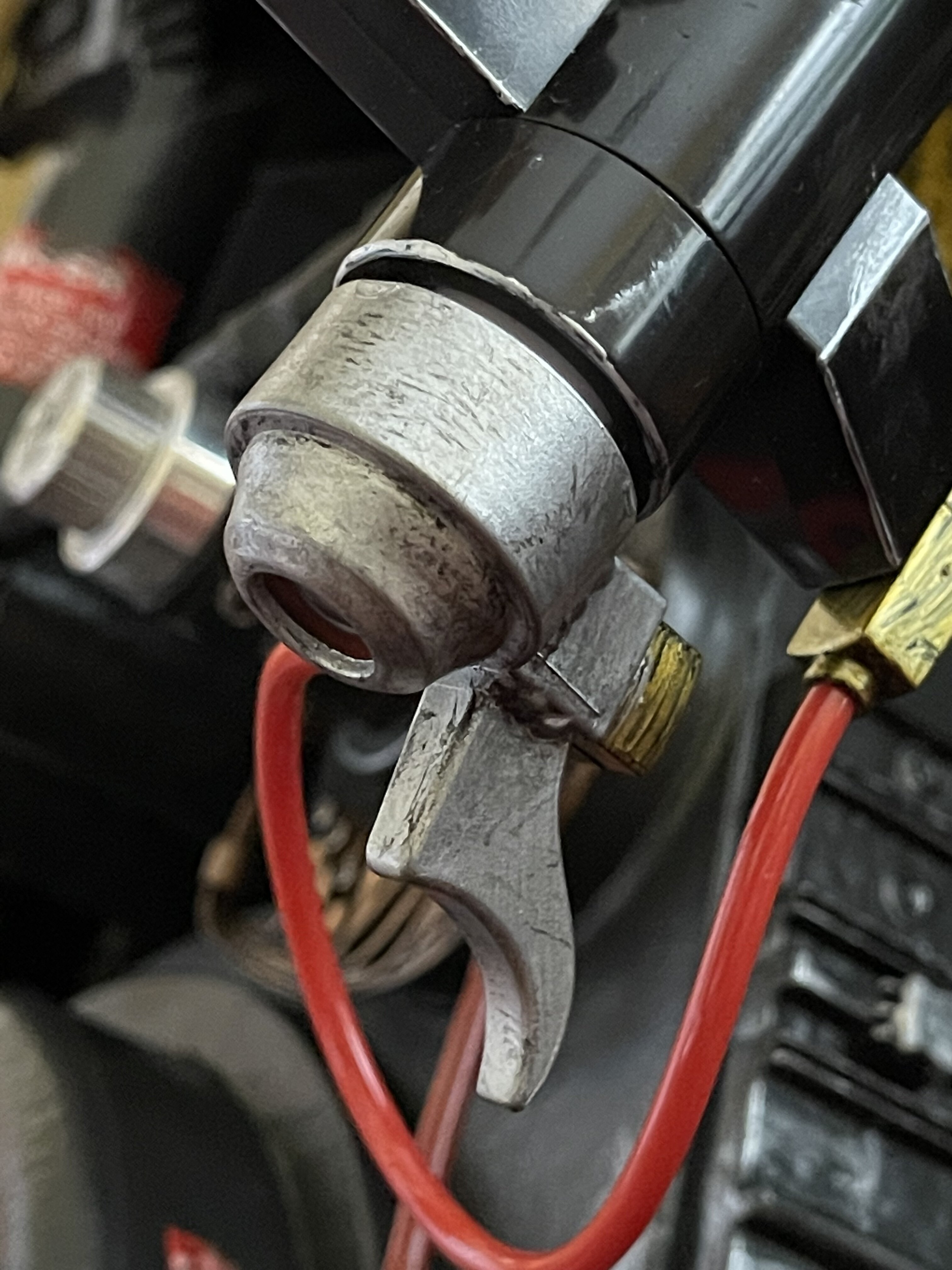

The most recent wands offered by Hasbro now have an orange tip. I painted and weathered mine.
I also removed the thick long yellow cable cover and replaced it with the correct cover. I still want to add some weathering.
Additionally I have added the military Alice frame. The Haslab has the straps directly attached but they provided metal clamps and screws so that adding an Alice frame was super simple.
There are still some tiny details I would like to paint but nothing major.

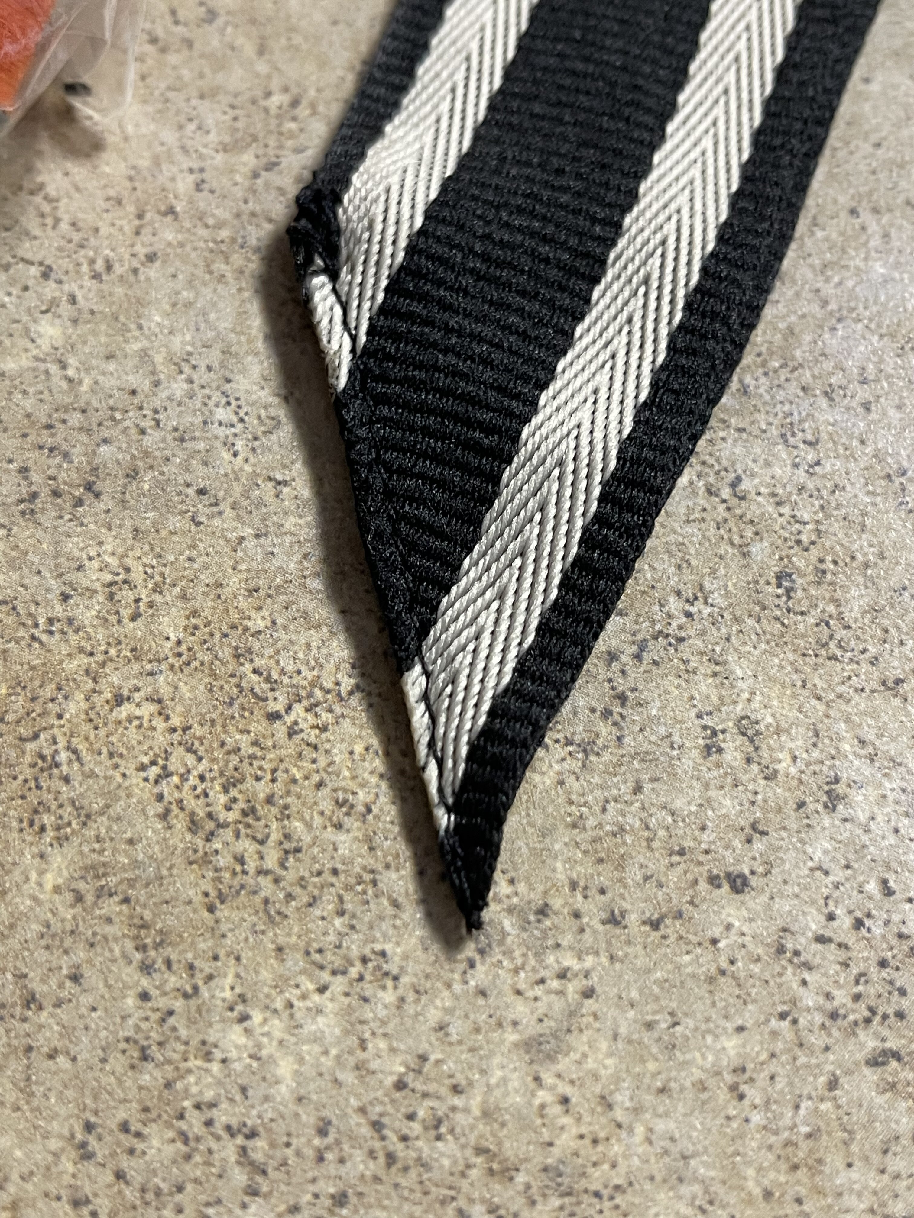

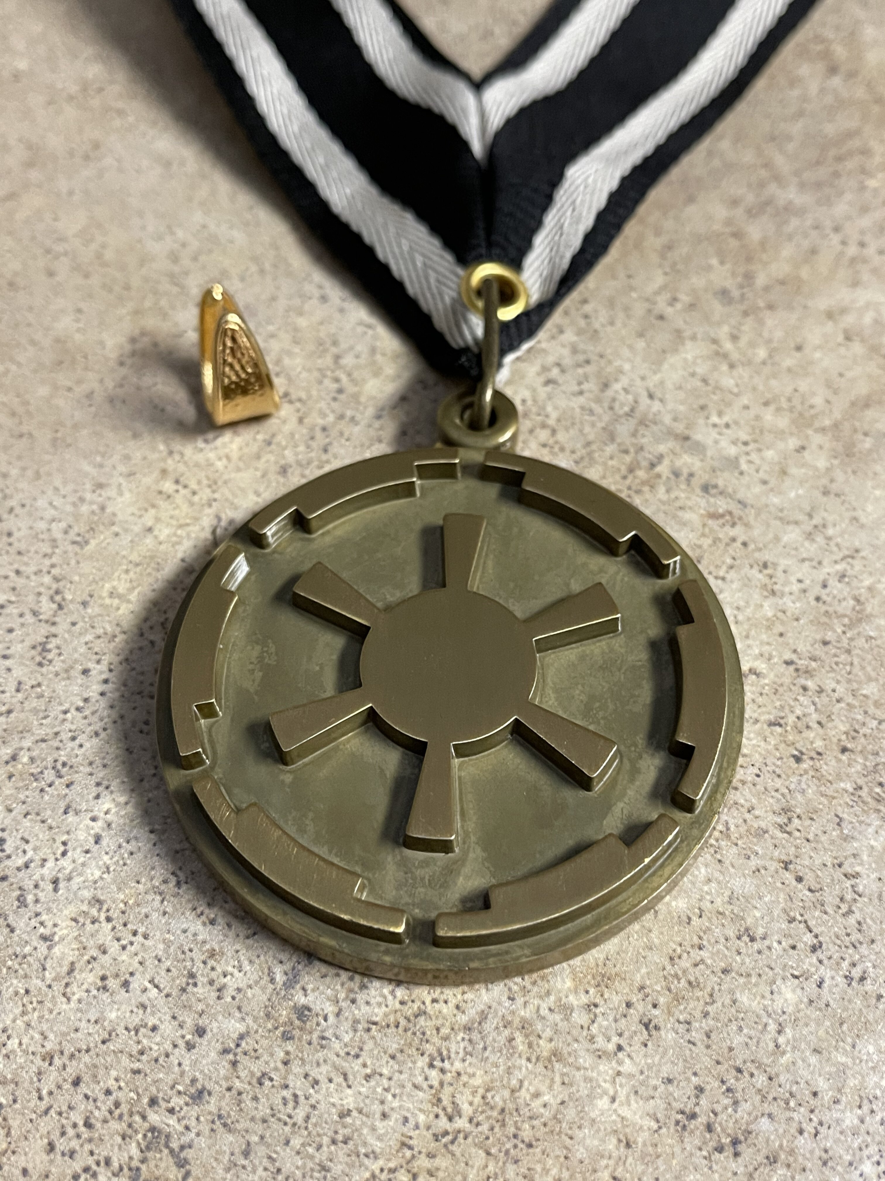

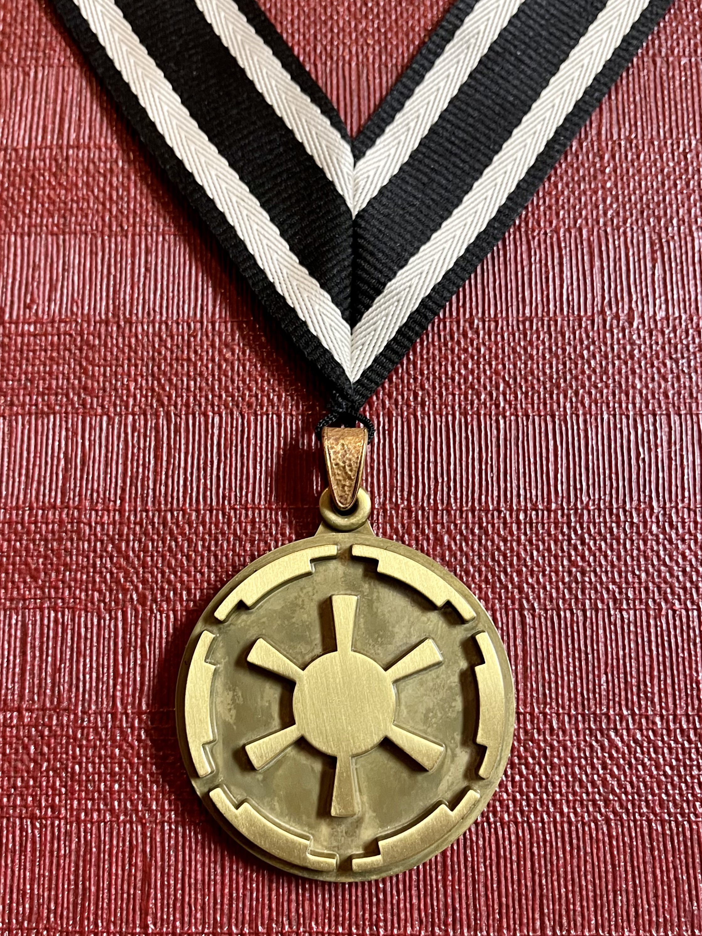

Picked up a Galaxy’s Edge Imperial medallion.
Removed the hardware with pliers.
Made a parallel stitch to the existing stitch, trimmed and sealed the edges with a lighter.
I cut a strip of nylon strapping and sealed the edges with a lighter.
I fashioned the strip to a loop that fit my new hardware.
I stitched the loop to the rear of the ribbon.
I added a little dark weathering paint to the new hardware and assembled.
Here it is….

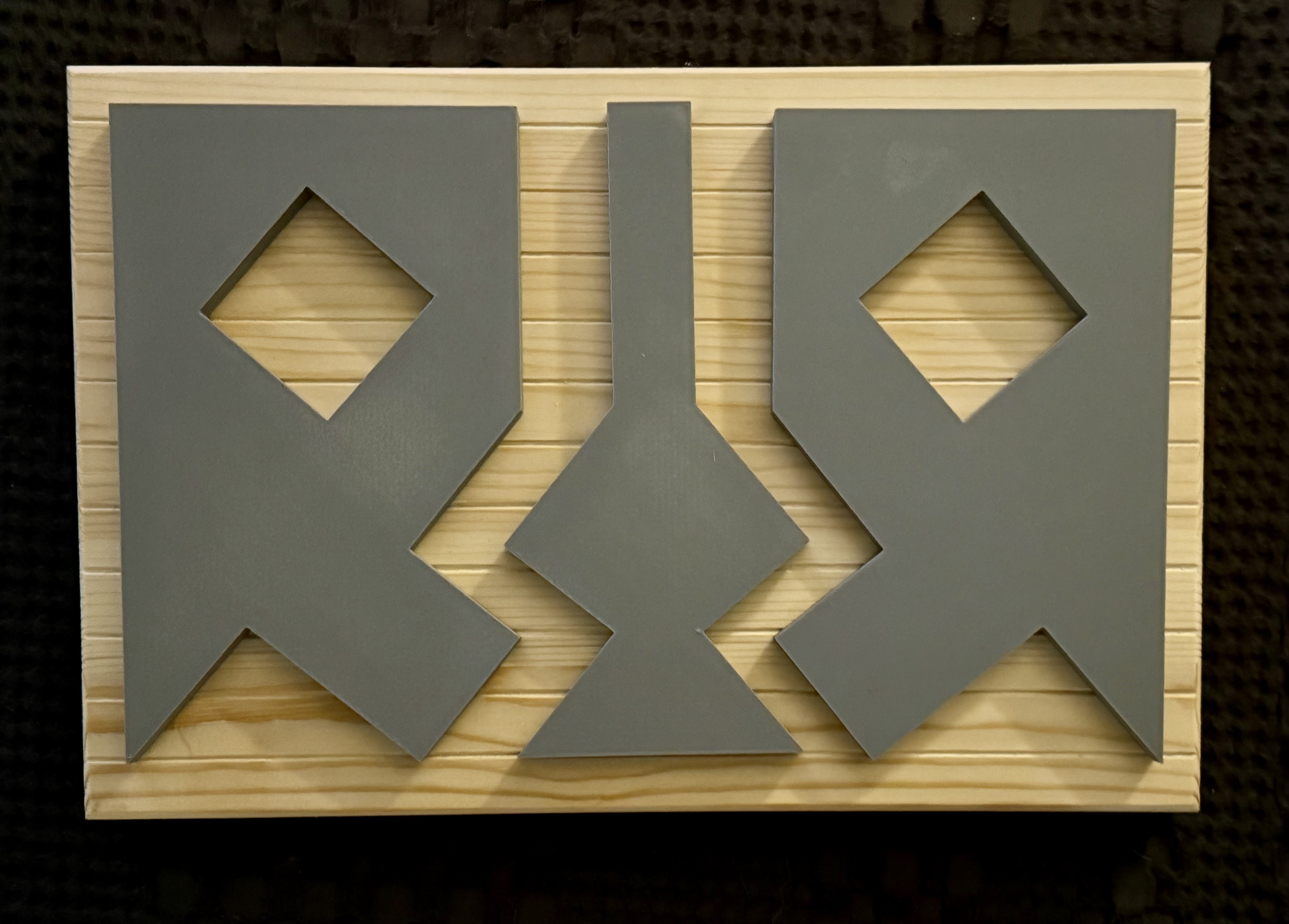

Got a new Prusa 3D printer for Christmas from my family. I had been without one for over a year now. This one is so much nicer and easier to use than my old Ender.
So I was able to do a couple of easy free files I have been wanting to do like the Ahsoka star map.

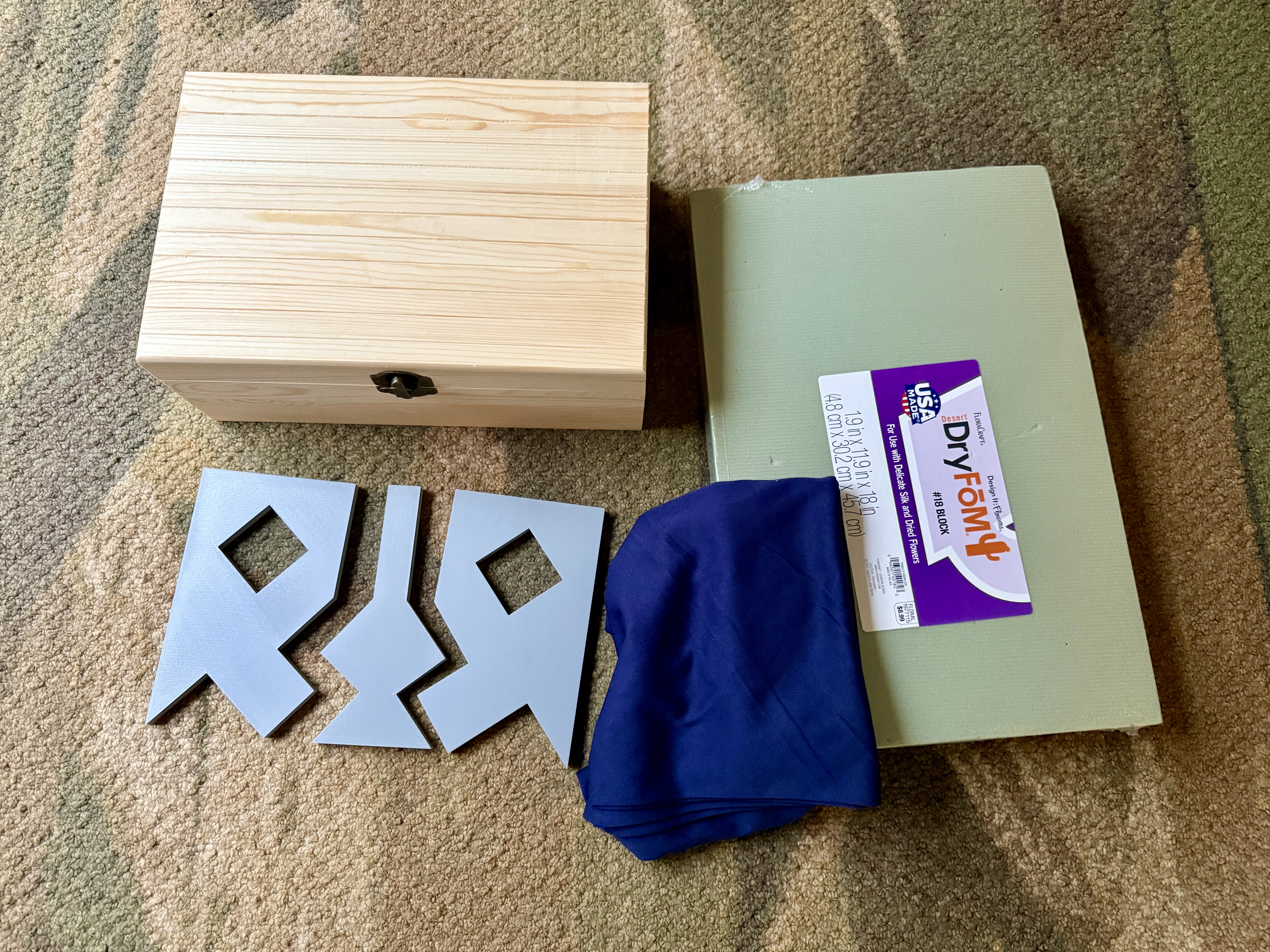

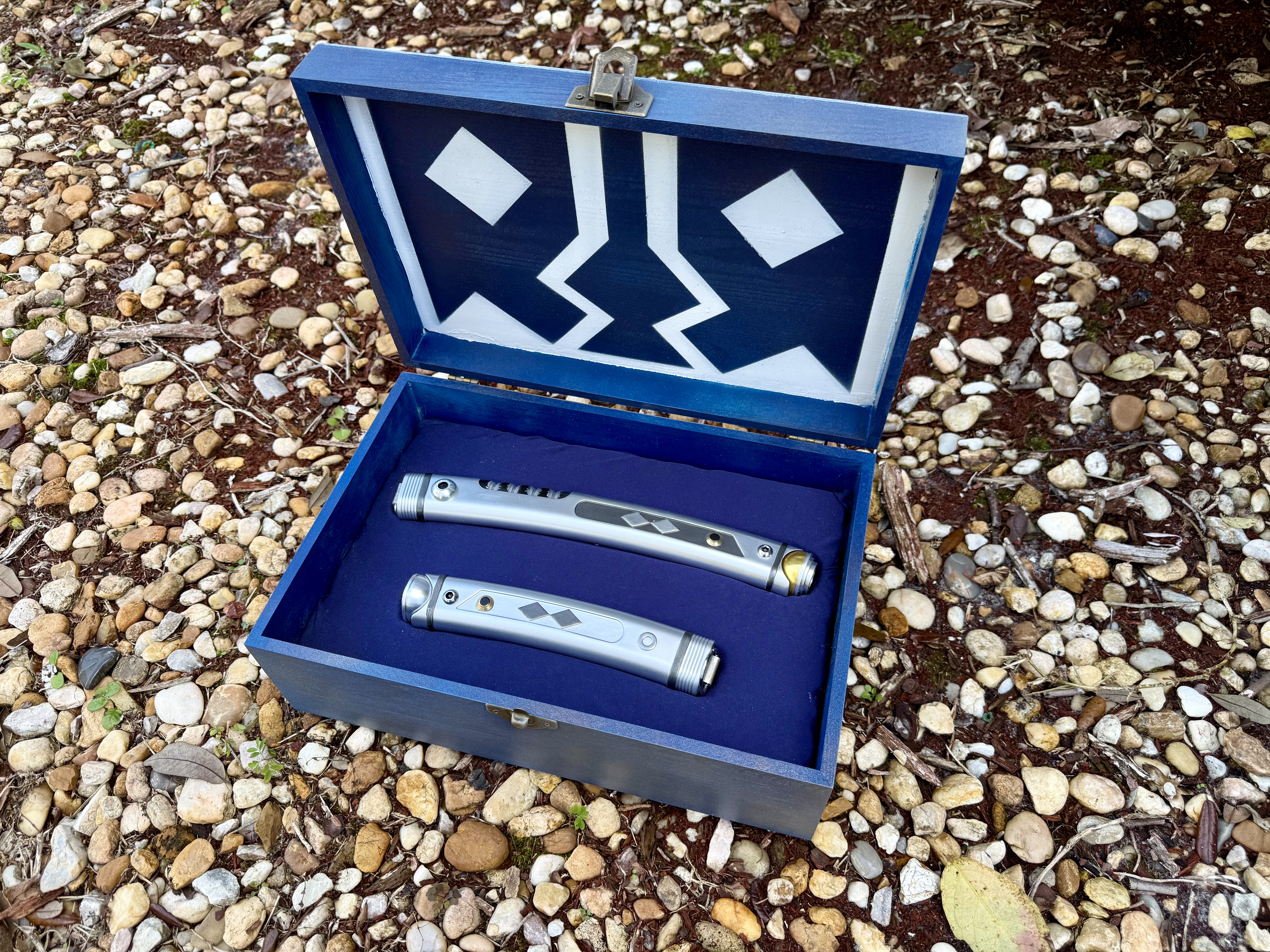

Mara Jade's Father - fantastic work on the display box! Did you use fabric glue to adhere the material to the foam block? I'm contemplating a similar project for a blaster, so I'm interested in your technique.
No, it is pressure fit. I pressed the box opening to the foam to give me an outline of where to cut the foam. I made it a tight fit. Then I cut the fabric with a 1.5 inch allowance and placed it centered on the foam. I then used a butter knife to work the edges and slack of the fabric between the foam and the box.
