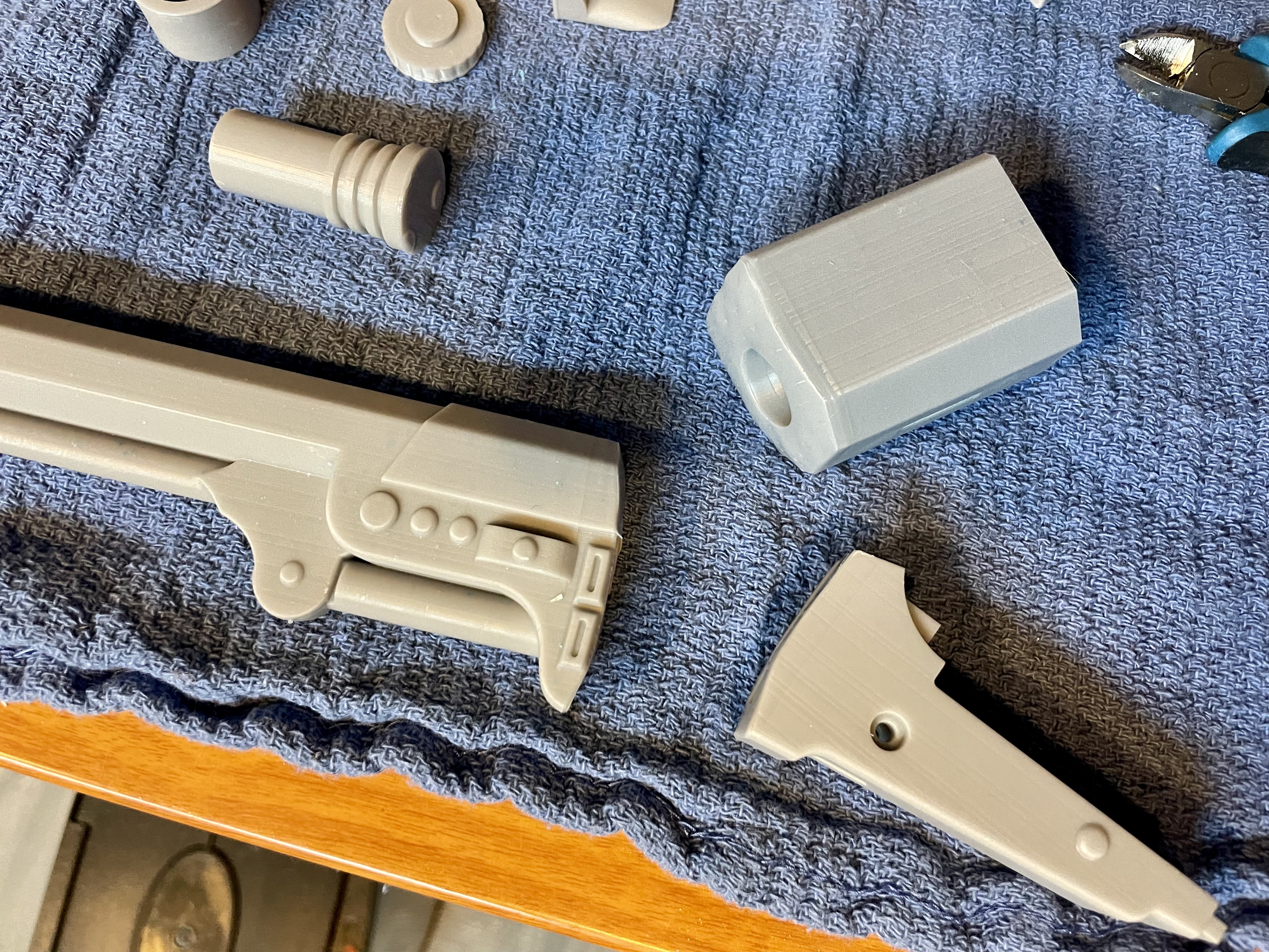

One issue I’ve been having with both my resin printers is the supported surfaces tend to have soft/rounded edges when printed.
Here on the Cad Bane blaster, you can see the edges of three different pieces are all dimpled from the supports, but also have rounded edges instead of being flat.
Any thoughts on what may be causing this…?

This is caused by two things,
1- You put that object bottom surface perpendicular to the build-plate, instead at an angle to the buildplate
3- To few supports for the whole surface.
remember when the first layer gets printed, that whole THIN partially cured surface is only supported by the few supports you have placed, and it wobles and flaps about when the buildplate gets lifted and lowered, it is only 0.05 mm thick (or even thinner)
That's why it is advised to put objects at an angle to the buildplate, this gets better support for the layers as it is build up :)
In addition, there is pull force. The resin likes to bond to the FEP. If the supports are thin or the pull force is greater than the strength of the supports, the supports weaken or break.
TazMan2000
If you object is solid then the pull force will warp your layers as it’s lifting, angle your object, hollow your object and put vent holes in your object, this cuts down on the pull force, the holes can easily be filled later
With how relatively small those pieces are in comparison to the build plate, I would even think you could put them right on the build plate. I dont think there would be enough force to pull them off. Depends on how much you trust your printer though haha.

Thanks! I had considered putting them right on the build plate, but there are some details on that surface that I didn’t think would work without supports.
