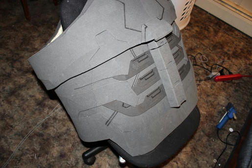

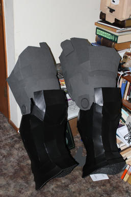

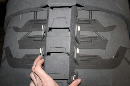

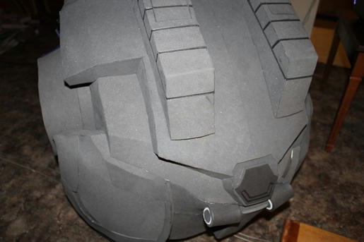

....A couple of progress pics... Got some more detailing done on the rear sections of the suit. I can't finish-assemble the spine sections until after they are sealed and painted, but you can start to get an idea of the direction I'm going with the pieces.
Rear muscle-work
... With part of the vertebrate covers held in place
Upper torso detailing started
Thanks for looking!

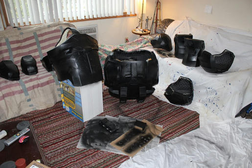

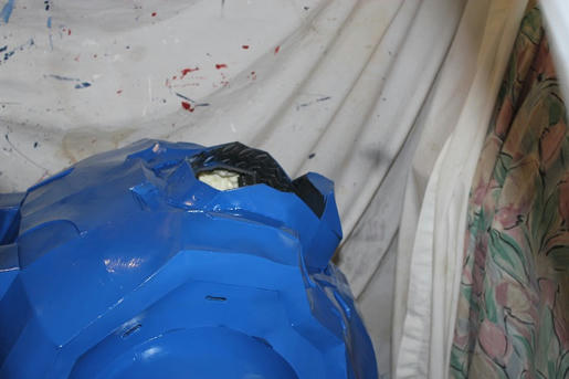

You know what's worse than parts all over the house? Three straight days of rain, so I've been Plastidipping IN MY KITCHEN. And priming IN MY KITCHEN. And test-spraying blue IN MY KITCHEN. It better not rain tomorrow... My living room yesterday:
Here's a horribly over-developed pic of the blue on the upper torso; the camera flash makes it a lot brighter than it is:
...what the blue really looks like:
I have final blues drying on the helmet and torso right now, Hopefully I can start some silver tomorrow weather permitting. It's either that, or I'm reinstalling some electronics. I'm rethinking the switch locations now, because when the suit is worn, your hands can't go too many places, but I would like at least some control available to the wearer without having to remove the upper half.

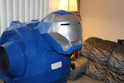

It's been raining for like a week it seems. Whatever I'm going to just keep breathing poison fumes..... Got some silver started on the helmet while working on the fit:

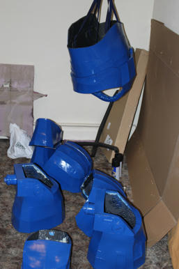

I'm hoping to have the eyes and such installed tomorrow. The helmet looks pretty sweet already, but the weathering on it should really put it over the top. I'm finishing up sealing on the thighs tonight, then tomorrow I should have all of the blue sprayed on the suit. I'm going to seal them while they are attached to the shins; that's helping a lot so that they keep their correct shape while they harden up:
The rest of the parts are predominantly blue already... The silver details will get sprayed over the blue once they are masked out.
Getting there....
