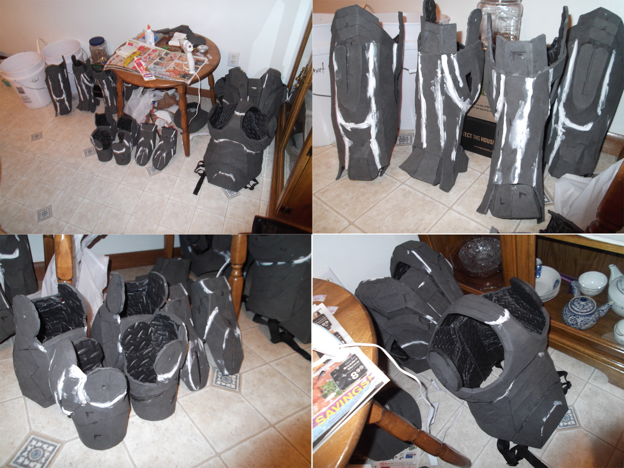

MK38 Igor build (04/29> Painting and detailing)
Guys, both.
The suit is both large and hard to carry, even for weighing 25 pounds or so.
**edited to note**
I refunded the money on this original commission build, and my guy has been more than a gentleman about the situation. I did not want to selling and shipping this for the full value unless I was sure he would be satisfied; you can't inexpensively ship a 3 foot cube across the country for modifications. :)

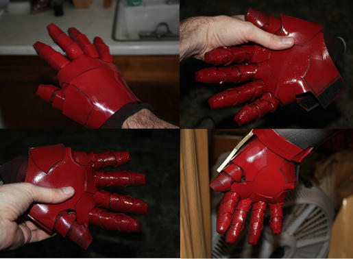

I build my foam gloves over a kind of neoprene glove base that they are glued to, but the actual palm has to have a velcro or elastic section at the side so your hand can slip into the glove without tearing the foam. If I use velcro, I make a flap (or strap) of foam that velcros across this opening once the opening once the glove is on. That flap usually gets flexed around a bent a lot, so if it had pva sealant it would likely crack and look bad. Instead, I just plastidip those areas and paint. YOu can see an example of the flap in the upper right pic here:
Thank you. :p
I can't see the pic because it's blocked, so can you either post it using the image function, or pm it to me. Or I can wait till later. :rolleyes
