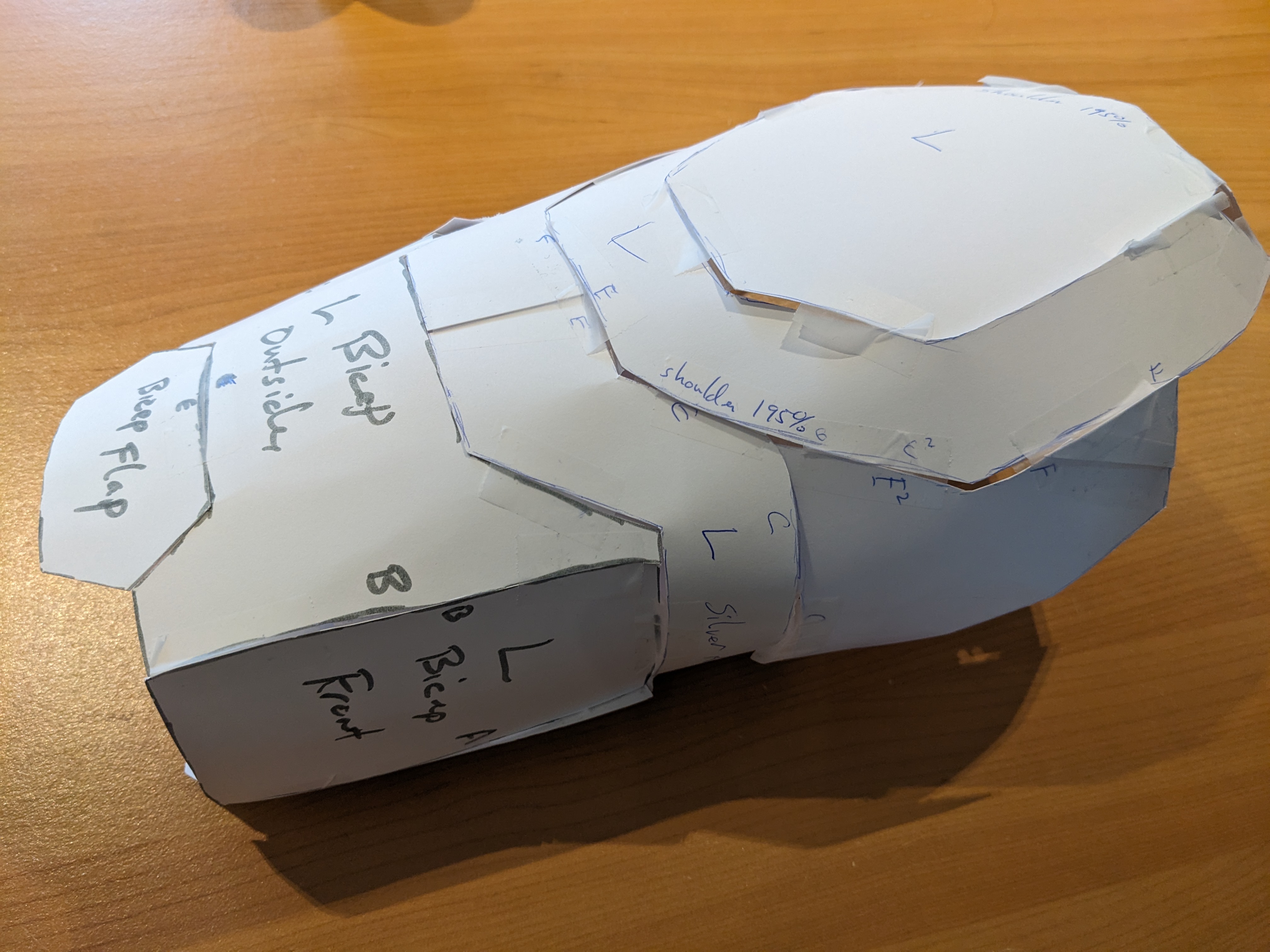

I also traced out BrutusWayne's Arm Components (left picture below) literally by scaling the image up on my flat screen monitor and tracing the outlines onto tag paper. It was very useful that he took a picture on his sewing mat. This seems a bit silly but it is easier then blocking the same thing myself and Brutus and I are close to the same size! The below might be too complex for my sewing skills, but it looks cool so I'm going to give it a shot. Thanks Brutus!
I'm a little shocked both things fit the first time, but I could use some luck given the setbacks over the past few days.

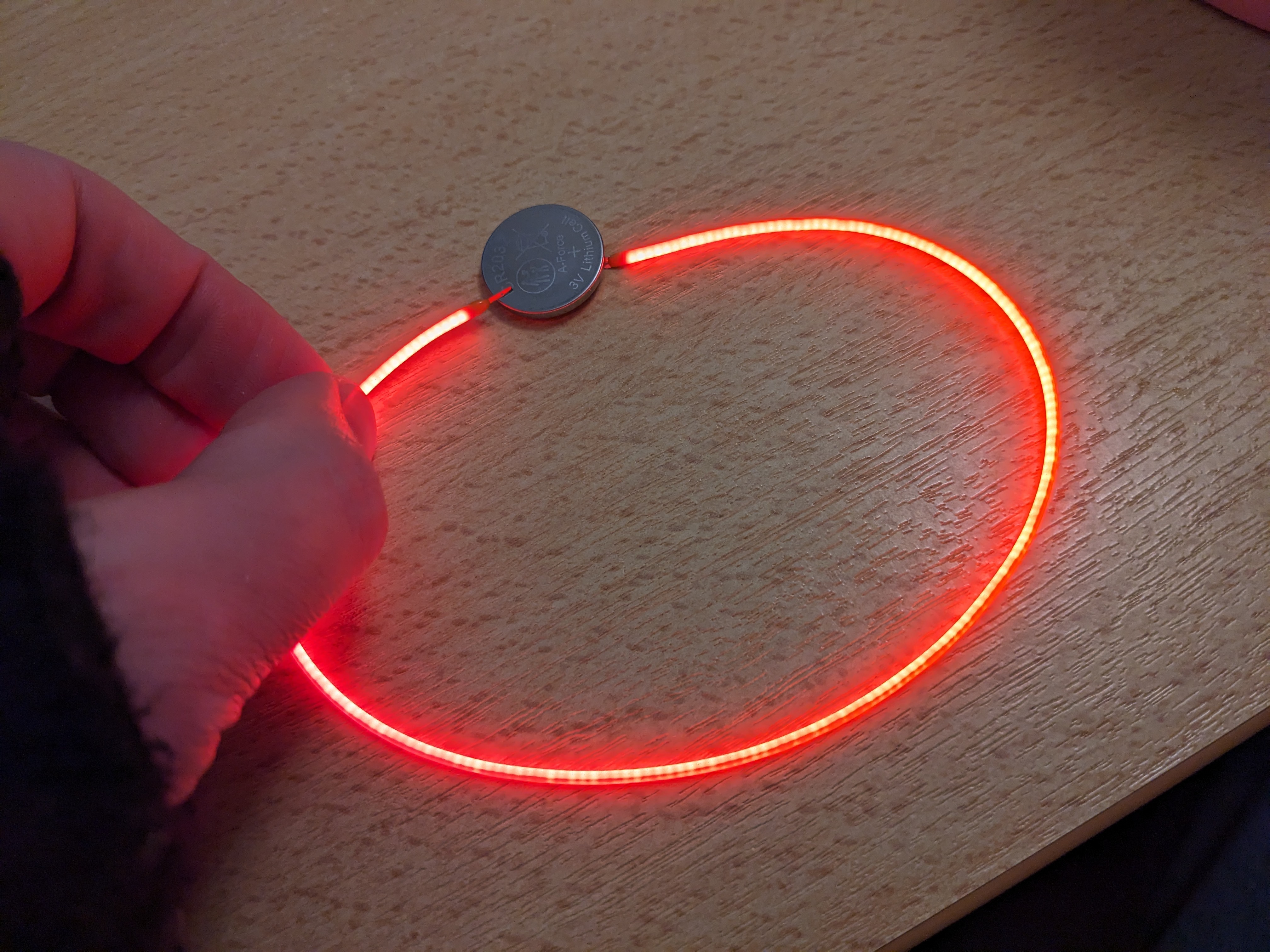

Much of my work though has been figuring out the lights for the corruption tentacles. A good friend who is an electrical engineer helped me put together a plan and made a diagram for me afterwards. I'll run two sets of three red LED filaments using pulse width modulation controlled by an Adafruit Gemma M0 to program a "pulse" the LED filaments. The idea is simple but the programming might be a bit complicated. I'm worried about how much testing time I will need and how to weather proof this all.
So, BrutusWayne took pictures of his arm blocking which I've used to make the shoulders and biceps, but he didn't leave pictures of the chest pieces. So this update includes blocking of the chest for which I used an old T-Shirt and newly ordered china markers which I was very happy with. I did end up going with a simplified Civil War pattern as I felt that might fit the best and it fit well with BW's shoulder pads too. I also added spadex along the sides so that it will breath better when I'm dancing.
I'm worried about adding a collar to the shirt but I ran across this lovely video and I'm hoping that will help get me there.
I have a new simpler plan for the lights as well. I ordered the Arduino, lights, wire, resistors and everything has arrived now. I tested the lights on a button battery and they are fairly bright though I was hoping for a bit more. We'll see what they look like when they get the full five volts and more current. Still, I'm going to wait on the lighting until next month and work on finishing the shirt and helmet.

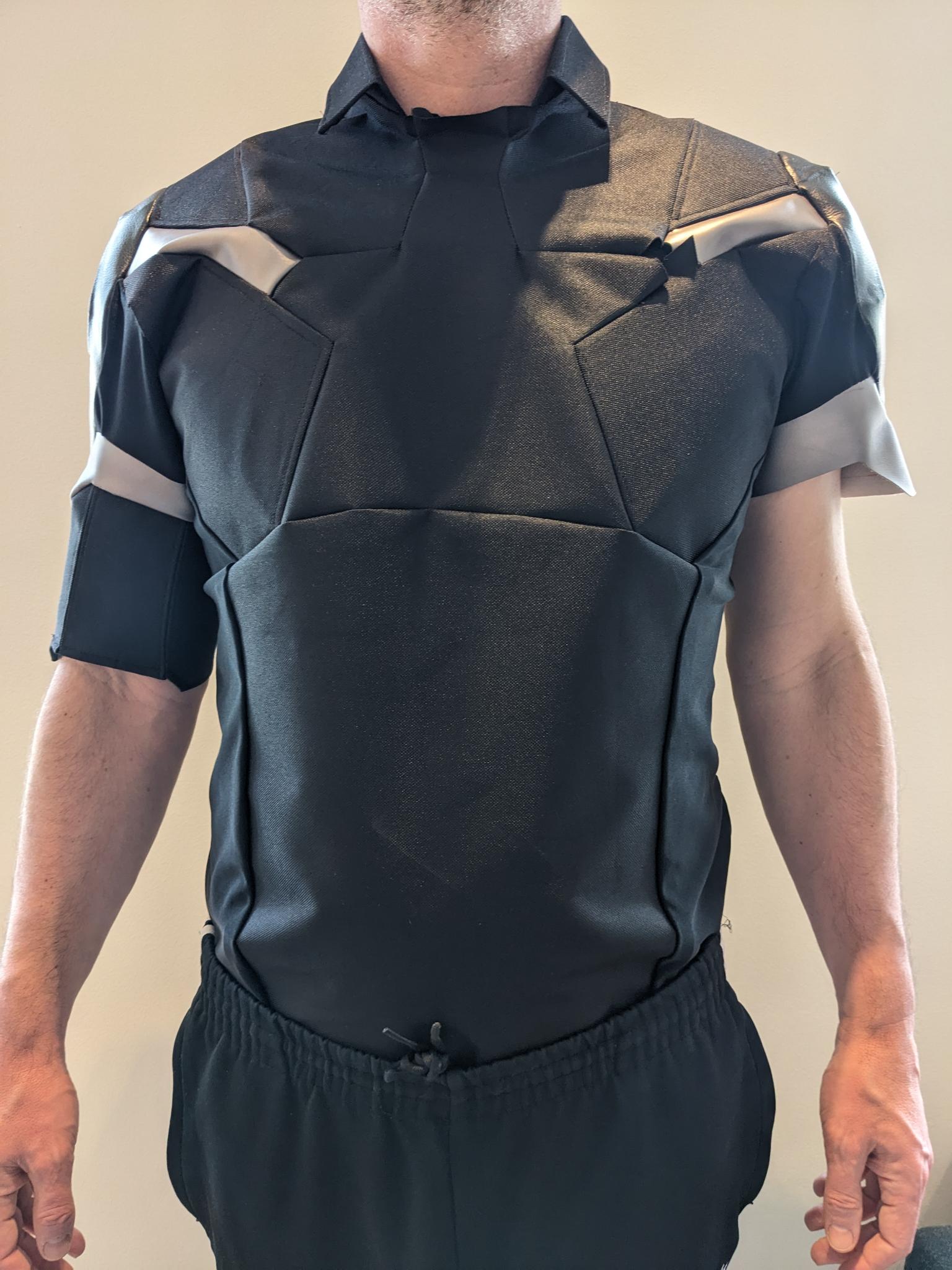

Ok the "uncorrupted" armor is about 90% done. As you can see I just have one more bicep to sew in, some of the trim around the neck, and a couple more foam pieces to add. I tested it out in nearly freezing weather with thermal underwear and it is surprisingly not too hot. The Cordura and Spandex lets the air through fine. I was actually a bit cold which is great because I think it will be fine for the summer.
signal-2025-02-08-141421_003.jpegsignal-2025-02-08-141421_002.jpegsignal-2025-02-08-141421.jpeg

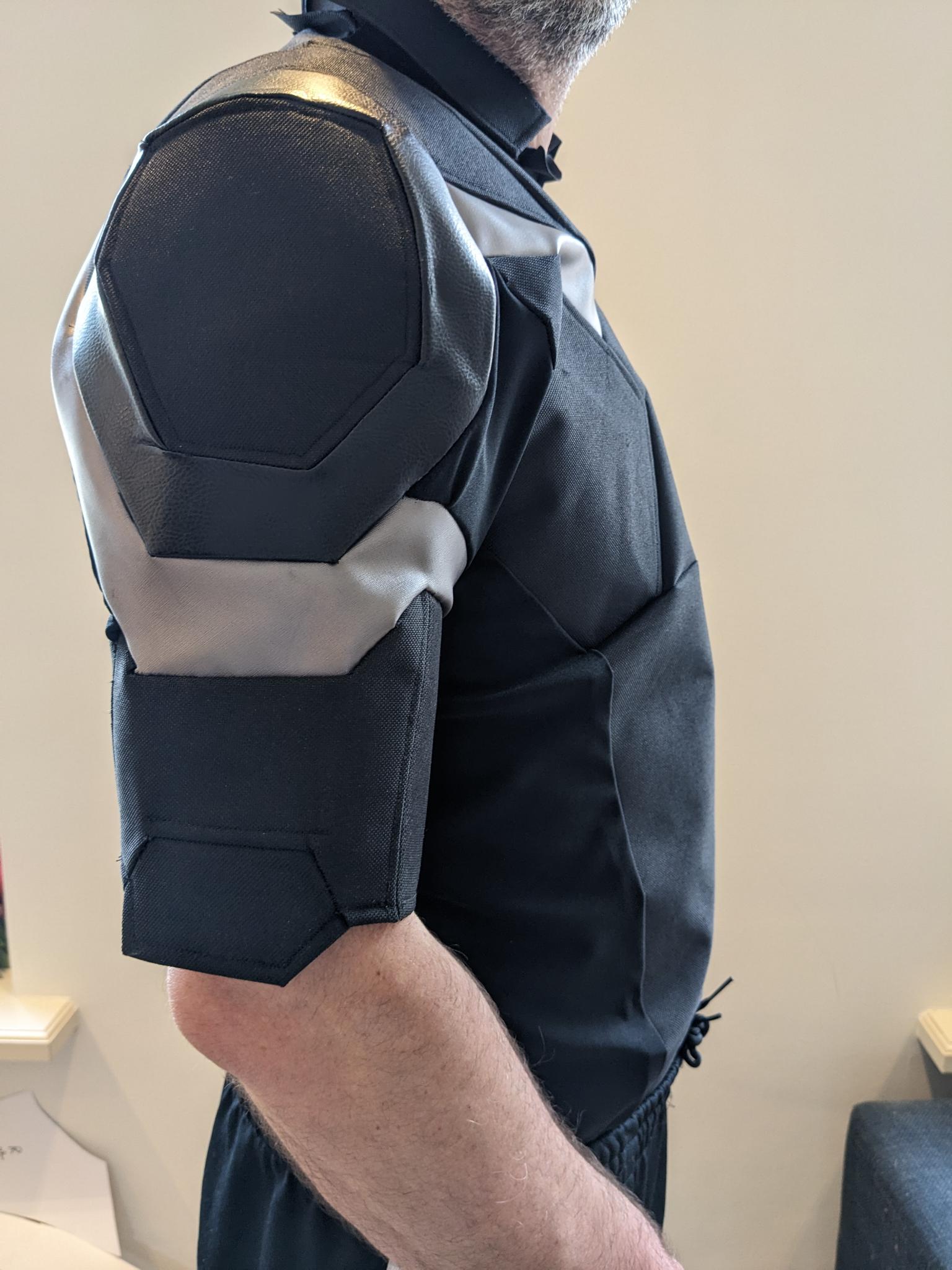

There are a few issues. I used EVA foam instead of headliner foam which is a bit too rigid. This caused a lot of trouble, especially making using the sewing machine difficult. I found the best working pattern was to first sew all the pieces surrounding the first piece an then gluing and top stiching the foam in the first piece before moving onto the next piece. Time consuming, but it is tough to sew pieces together once the Eva foam is in place and if you do too many pieces without adding the EVA foam then it can be difficult to top stitch using the sewing machine.
Also, because the EVA foam is stiff the shoulder pads stick out a bit awkwardly and the material around the shoulder pads bunches up a bit. Luckily I have the harness for the shield which hides some of the problems there.

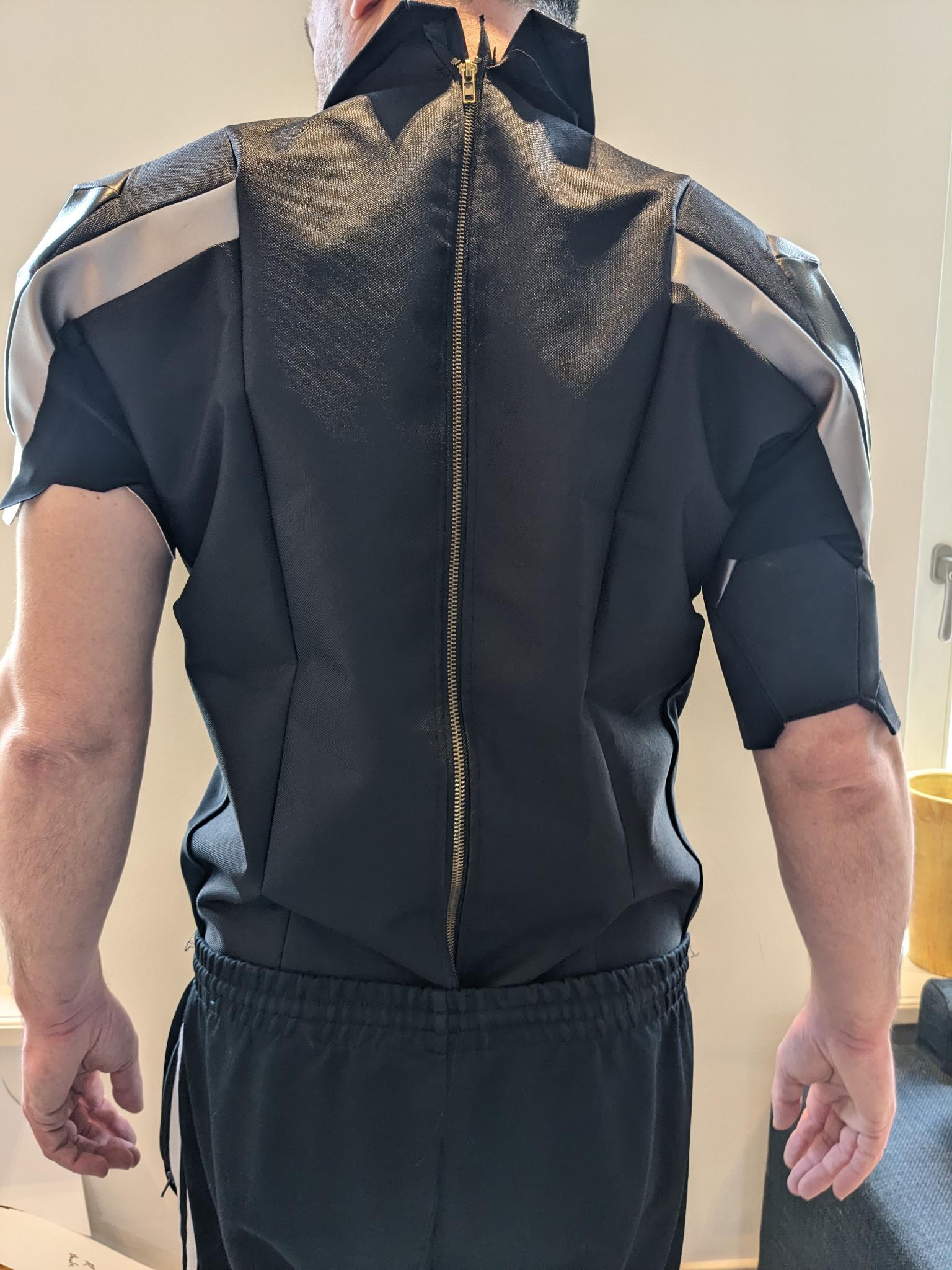

The costume is definately too big as you can see from the back and the side. I'm a little pudgy but not that fat :). I definately forgot to add in the zipper width, but even knowing that I'm not sure how it ended up so big. I might have time to take the seams in a bit. I might cheat a bit and have a taylor fix it :). We'll see.

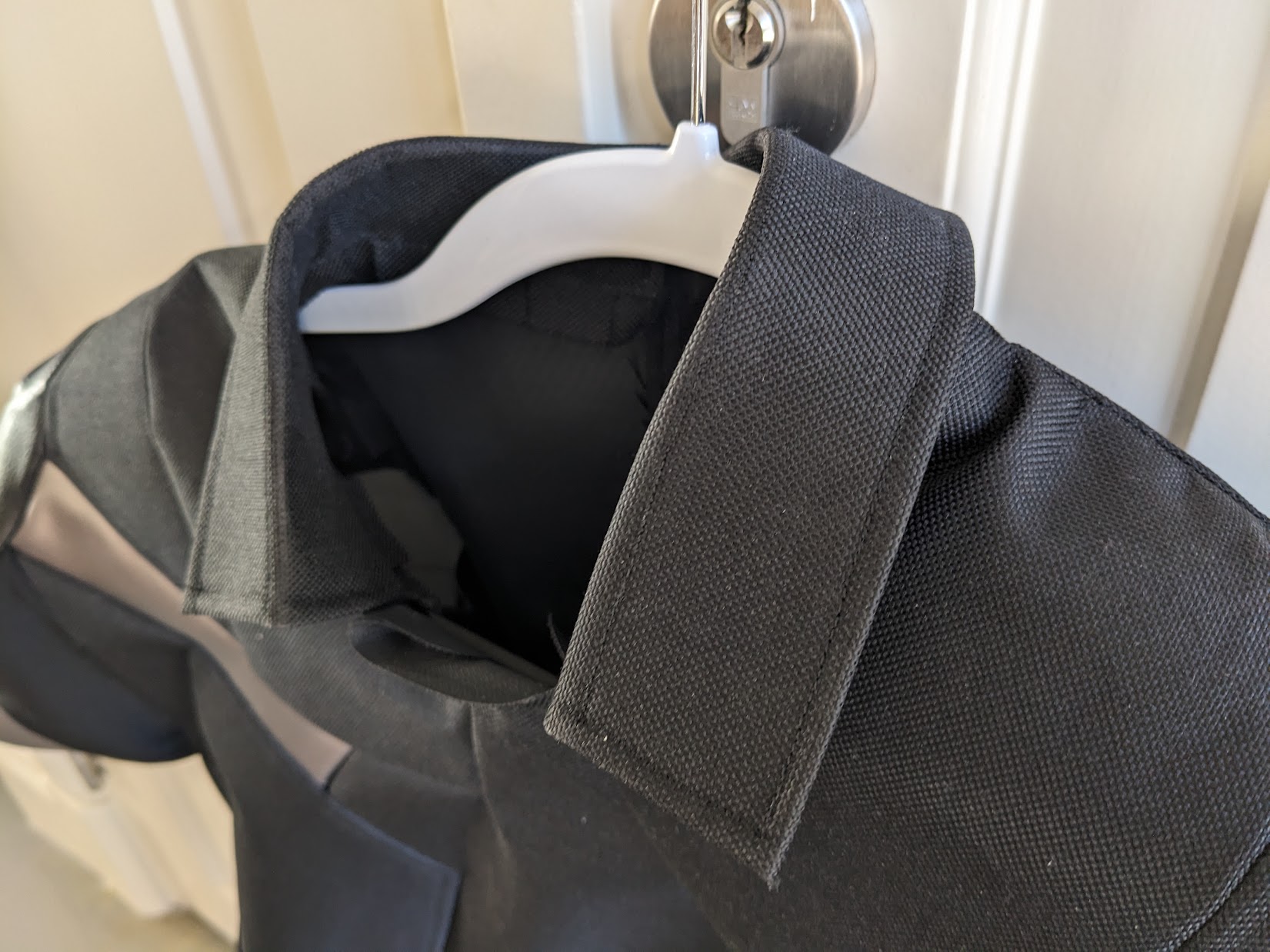

I'm proud of my collar hack. There are many videos about how to sew collars (my favorite), they are all nice but quite complicated. Because I'm stiffening the collar with foam though anyways. I just took one piece of Cordura attached it the wrong way (!) to the shirt and then topsitched in the foam and folded it over. I'm sure there are sewing purists out there that would be in pain right now, but it looks ok.
The only issue with the collar is I didn't sew the zipper up far enough in the back so I might have to add a hook or something as it sticks wide open in the back when I wear it as you see in the back photo above.

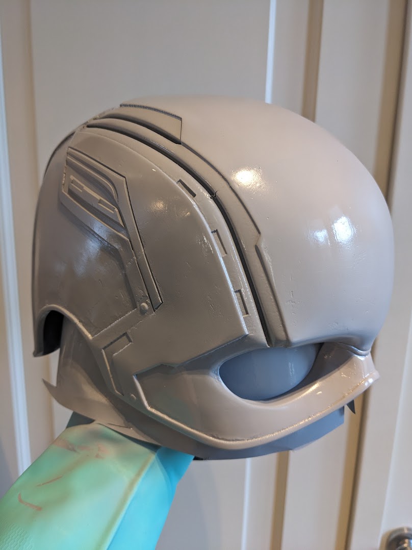

Helmet Update:
So the helmet is progressing. I painted a first helmet print that was too small to test the spray paints.
The matte color I was quite happy with but the gloss on the top was too much. I ended up buying a "metallic" spray paint for the final version that I'm happier with.
The biggest problem though is you can see the filament lines from the 3D printing even after a lot of sanding. So for the full print (below) I went the route of using wood filler to fill in the sanding lines, but the wood filler went on super thick and took a ton of sanding itself to smooth. When I put the second coat of wood filler on I used Acetone and Wood Filler Mix which I learned about too late. This was much better and would have saved me a bunch of time had I known about it for the first coat.
I taped the helmet to a weird stand I found at the second hand shop and this is what the helmet looks like after two coats of primer. You can still see some small clumps of filler which I think would have been avoided if I used the acetone/filler mix for the first coat. On the plus side though you can't see any of the lines from the 3D print and you can just barely see the line where the face plate print was glued to the top of the helmet. I think I will do one light coat of primer tomorrow to help clean these problems up a bit and start painting Wednesday.
As a little teaser, I've been testing the Arduino and the LED filaments. The "pulsing" works! There is a lot of soldering to be done later this week, but I think I will make it.

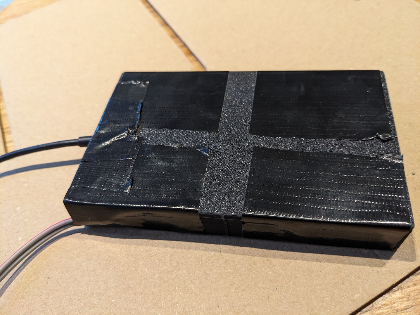

So, the electrical components are fairly straightforward in theory but were quite difficult to install. The Adafruit Gemma M0 is a tiny programmable microprocessor which uses pulse width modulation to control the brightness of the lights, but the port of the Gemma M0 that controls the brightness doesn't not have enough current to run all the lights. So, following this Adafruit guide I used hooked up the port controlling the brightness to a transistor and then ran a line from the main power port of the Gemma M0 to the transistor as well. So I had enough power and could control the brightness. I tested this all on alligator clips. This is all hooked up to the LED "eye" from Ali Express for testing and then eventually all the LED noodles as well.
The box I 3D modeled and printed combining a model from Adafruit for holding the M0 and a second model for an electrical box.

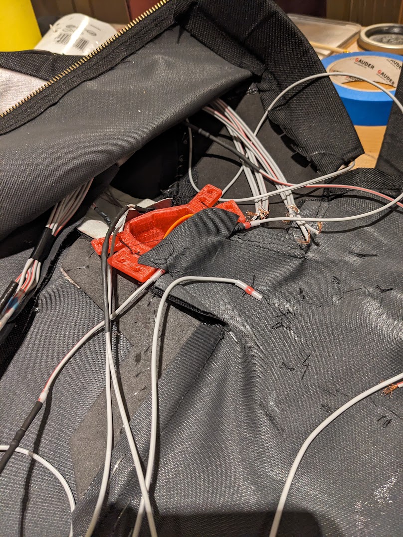

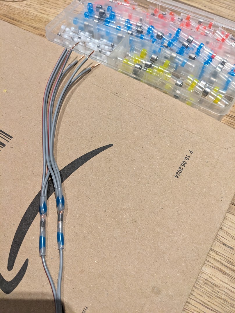

The real difficult part was the soldering. My makeshift soldering station worked well actually but the copper wires I bought were a pain to solder even with flux. I actually brought the Gemma M0 to a computer repair shop to help with the soldering. Super sweet guy there also had trouble soldering and said it was the wires but he managed to get it done. When I told him what it was for, he wouldn't take payment so I bought him some pastries. I eventually bought Heat Shrink Solder Connectors which was so much better than soldering! I wish I had bought them first.
Sewing all the wires into the armor (not too tight or too loose!) took a lot of time. Here it is about half way done. I had a loose connection too but I just used my heat gun on the solder connector that was the problem and it fixed up fine. I'm very happy with the results.
