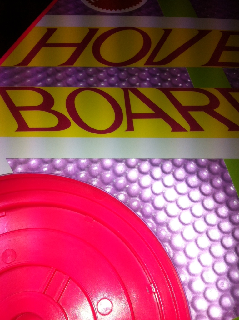

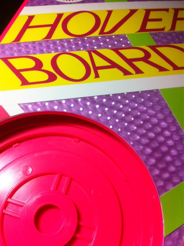

I think I will order some clear lenticular from Sommers and make a few tests. Who knows - maybe I can find a way to glue that material without losing the lenticular effect?!
Hi Roland, this sounds great.
Maybe the clear lenticular from Sommers can generally be glued without losing the effect. I think it depends on how the lenticular material is made. I found out that "my" material can be glued upside down (I tried to put glue on the upper side) without losing the effect, but the effect itself on the back of this lenticular material looks wrong. The honeycombs are tiny there and look dented into the material so this is not the solution. Maybe the Sommers stuff is made in a different way that allows glue on the back?
Roland, if you PM me your address, I would be happy to send you sheets of the PVC material that I have left from my order.
Even if you shouldn't find a way to stick any of the material directly to the board, the graphics really help to hide the sticky areas. The light blue color shows where I put double sided adhesive tape. It works very well, no bulging of the lenticular material or anything. Even the edges lay down flat to the board.

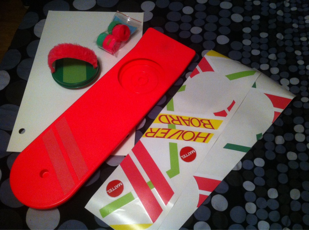

I made a stencil from Roland's decal just showing all outlines. Then I fixed the lenticular sheet on top of the print. The print stays visible through the lenticular sheet. You just need to glue your decals in place and cut the whole thing out at the end, always using the stencil underneath as a guide. Works really well.

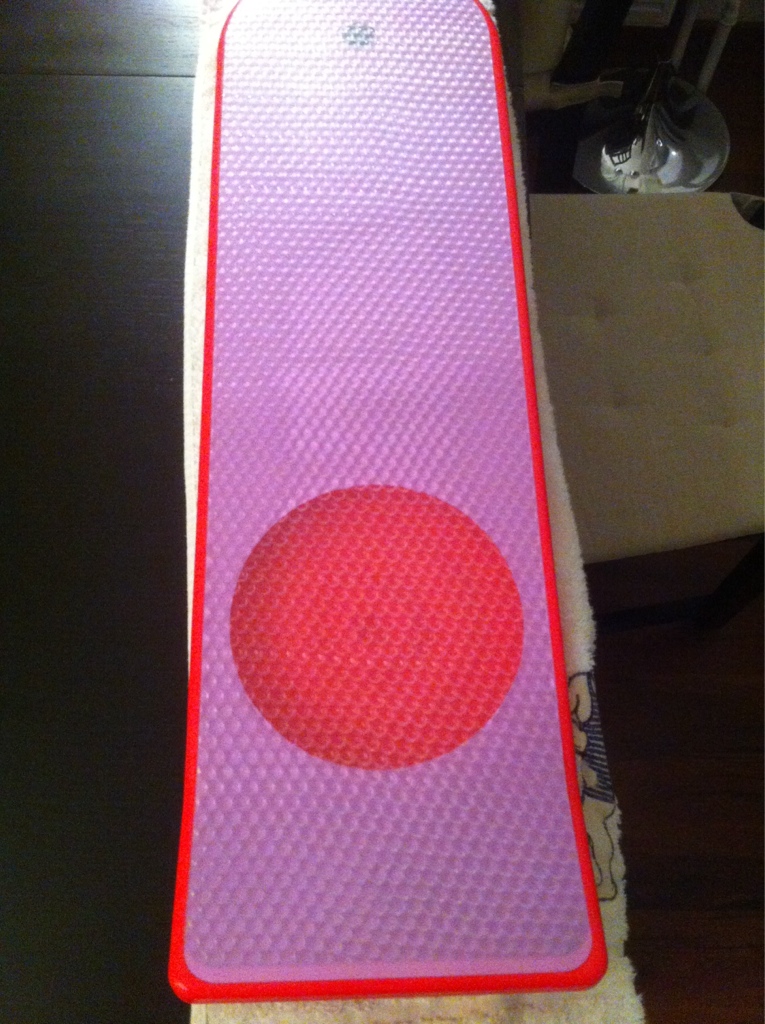

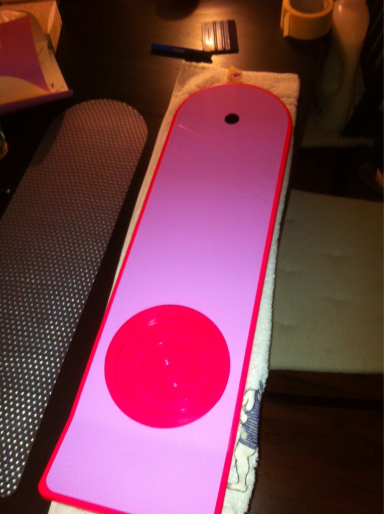

ImageUploadedByTapatalk1393008788.395206.jpgImageUploadedByTapatalk1393008800.699412.jpg

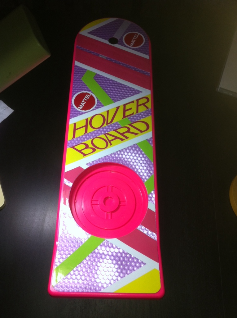

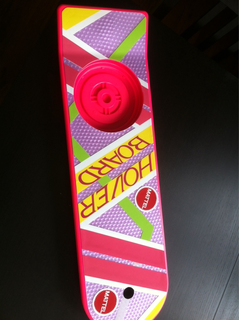

I give a try to a lavendar vinyl under the clear lenticular material.
The picture is from my phone but it's really close colour.
wow... I love your idea of putting vinyl underneath the lenticular as this allows you to choose exactly the color you want to see! :thumbsup
It looks really good, maybe a tiny bit too blue-ish as this lenticular adds a blue tint to any material underneath. But I know that these colors are very hard to capture.
The lavender vinyl also helps to hide the recessed surface of the board, that would have saved me hours of work. :unsure
However, it is really interesting to see how different the exact same lenticular material looks on your board. Maybe you can do some daylight pics when you're done.
Yeah, I figured it out this mourning, you're right. Maybe a little bit to blue, but well, I spend too much time to go back to square one ;)

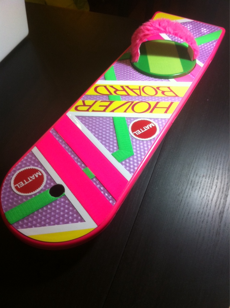

I've just finished to stick the velcros this afternoon and put the footpad back.
The daylight is gone, pics tomorrow.
