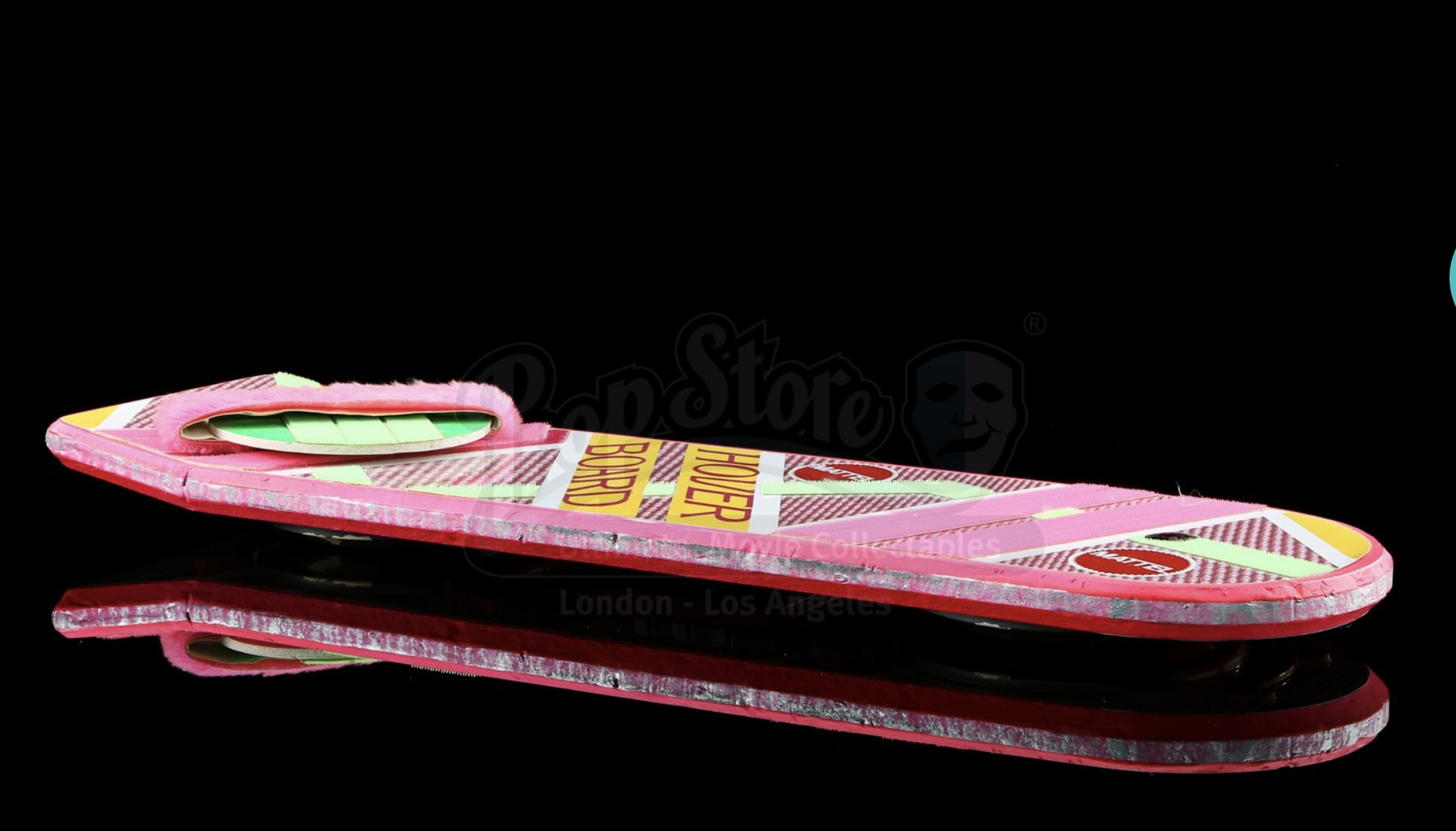

The screen used ones have a gap.
I did not notice that!

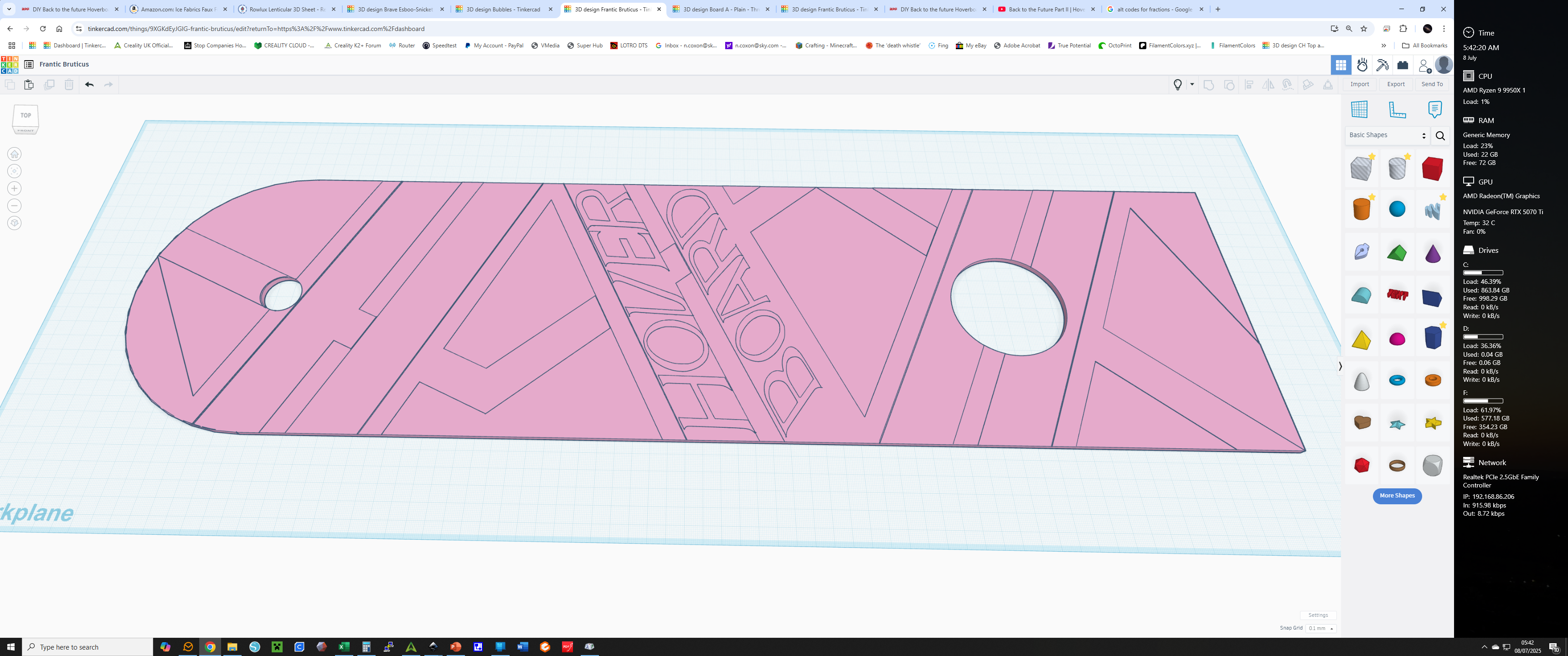

I could add a 1/8" (3mm) wide raised rim to my 3d printed board fairly easily if you like. If I made it just 1mm deep it would give you something to "butt up to" with your vinyl and even to cut against with that Xacto knife of yours!
After all I made a depression for all the pieces to fit in (which I'm thinking now was very clever, but a mistake) so a simple rim would be child's play.
If I get a chance today i'll design one at least and send you a picture. Can't promise I'll print one though, it's a lotta plastic and then I'd have to ship it to ya, and we've already had the conversation about UK/USA shipping rates....

I haven't added the "rim" you suggested yet as I've spent most of the day fighting with my lenticular alternative.
I've got this far, but not without issues. How close does it look to the original?
As you may see it's a silver background with a pink overlay. It looks okay to me, but it's complicated by the water-softening polymer layer on the top surface. I was going to get rid of it, but it's odd. Certainly SOFTENS in water and turns white, but as soon as it's dry, hardens and then simply can't shift it

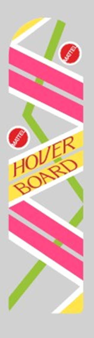

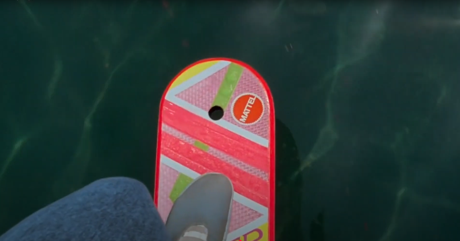

I've no wish to offend anyone who has put in the effort that is so obvious here, but I've come to the conclusion that none of the layouts for the decals are accurate enough for my OCD. This is my failing and no one else's, but I keep noticing little differences like;
Movie still - word "Hover" almost entirely fills width of board;
Design template; word hover is much shorter
And it's not central. *grits teeth*.
Keep looking at the above design. Now look at this;
Where's the suppose yellow flash gone off the back corner?
That's just a couple of examples. Add in lines that are not parallel, things that line up in different places, angles of anywhere between 15° and 25° ON THE SAME LAYOUT, and as Foghorn Leghorn once said

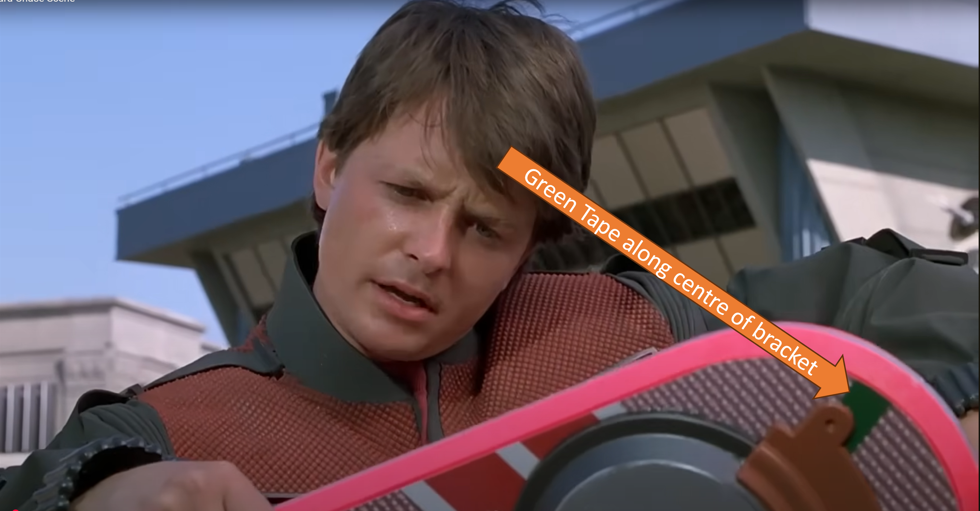

Might have been a tad ranty...my "grand ambition" is somewhat limited by the fact that even the movie doesn't get it right; here are three stills from the chase scene, covering a time period of less than three seconds...the orange arrows are mine (obviously)...
So yeah this "definitive guide" I want to produce is going to be something of a challenge when as far as the movie is concerned, there isn't even a definitive hoverboard!
It is NOT however, going to stop me trying!

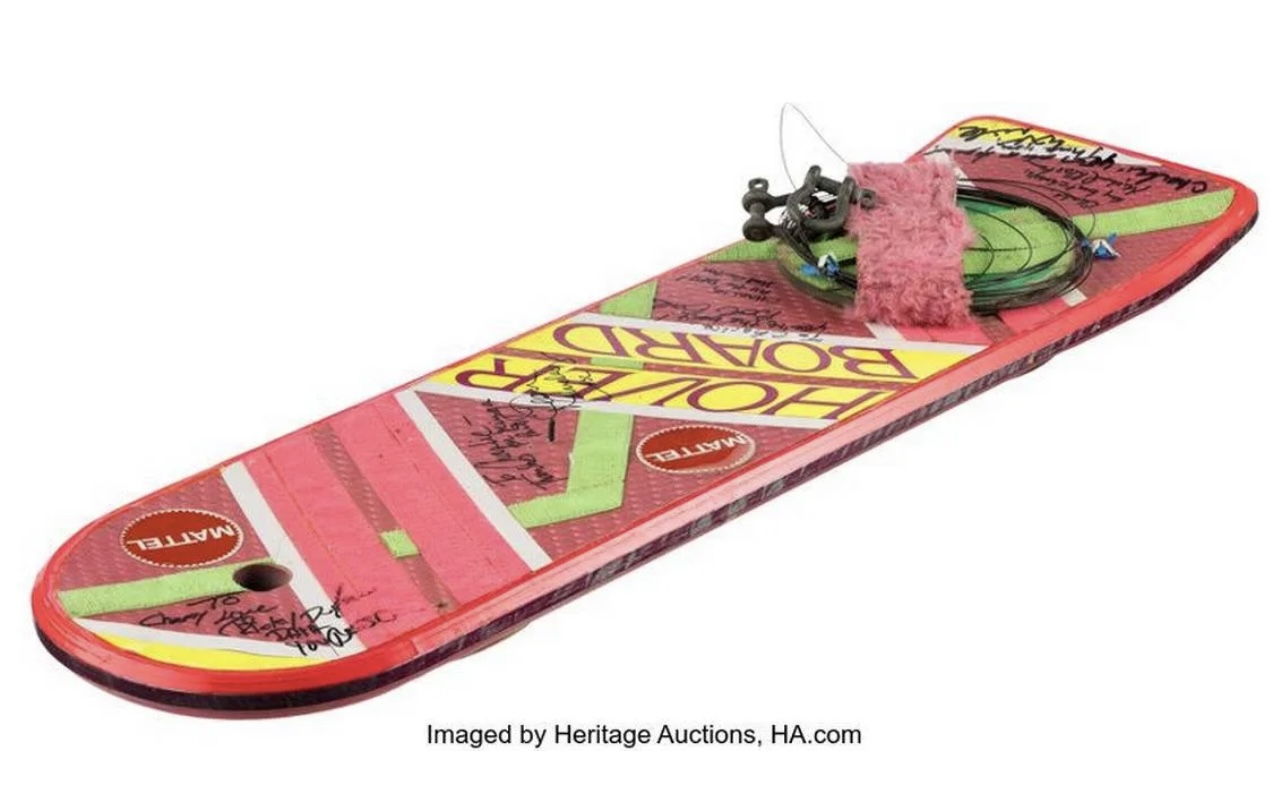

There were a number of Mattel hoverboards made for production, each made for specific purposes like stunts, hero shots, spares, etc. EACH ONE WAS UNIQUE. I found a number of really good photo references from famous prop auction houses that had a hero (wood) and a stunt rig board (foam) with cable and harness along with it.
I based my graphics layouts as much as I could on these, but again- the dimensions of the board I have are all wrong so that messes with the layout.
I look forward to seeing what you come up with! When I get board #2 done, we can swap stories!
Here’s the references I used as much as I could:

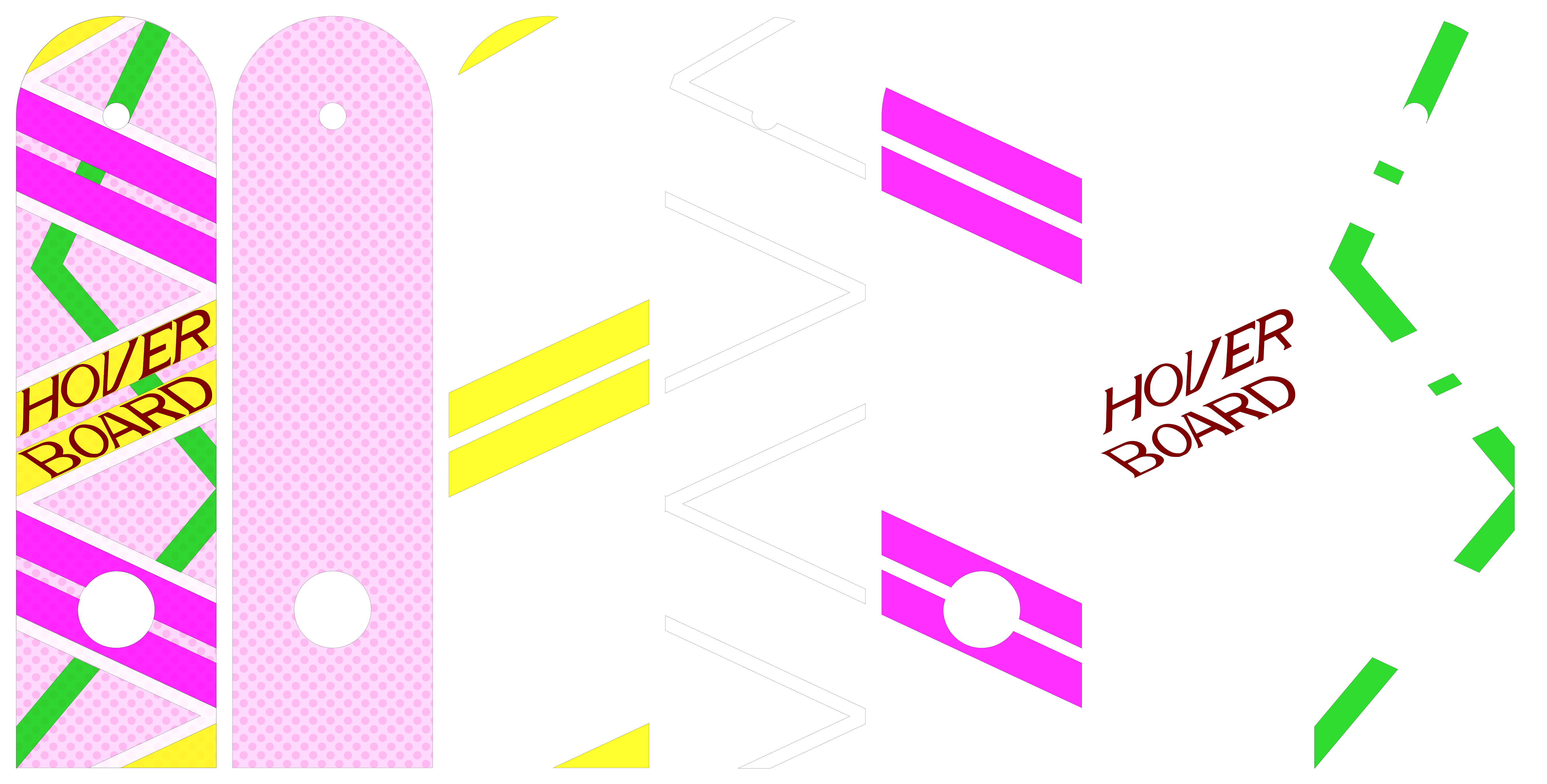

Well for now, this is how my brain works...it's 5am, but...totally worth it!
I started off with the yellow flash at 30° and went from there. Since it seems we've agreed there will always be a board that's different, I based most of my choices on aesthetics. Things like making the white lines meet at a point...consistent widths of colour bands at either 25mm (~1 inch) or 12.5mm (~½ inch) for ease of decoration.
More by luck than judgement, this particular design fits perfectly into my 200x710mm board (allowing for the 7.5mm lost all around to the chamfer, the dimensions of each of the above elements is 185mm x 695mm, Except for the 0.2mm outline, which I only added to the shapes so you can see the white one!)
Will see if I can get the back decal done the same way tomorrow. I have a second printed board now, in three sections that dovetail very nicely, largest part about 250mm. I left the indentation for the other pieces off this time just to give people the option. Next board (probably my last for a while as I'll probably use up the last of my pink PLA) I am hoping will feature your requested 3mm (~1/8th inch) raised surround on the upper side.
I just realised now that I have accurate svg files, I could add guides to the actual printed board to show where the decals should go...I'll investigate that at some point....
By the way I know I've not added any "Mattel" stickers, but that's because I'm working on a modified version for the wedding. Please have alook at the image and point out any mistakes - I'm bound to have missed something!

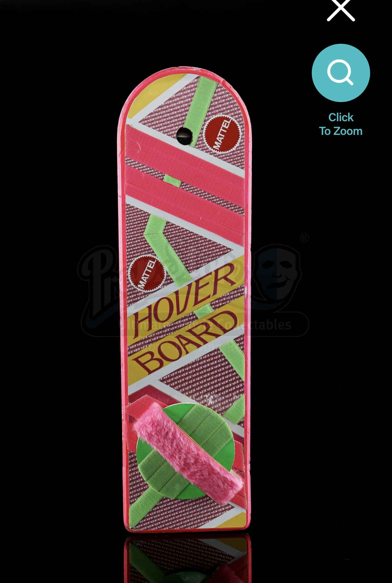

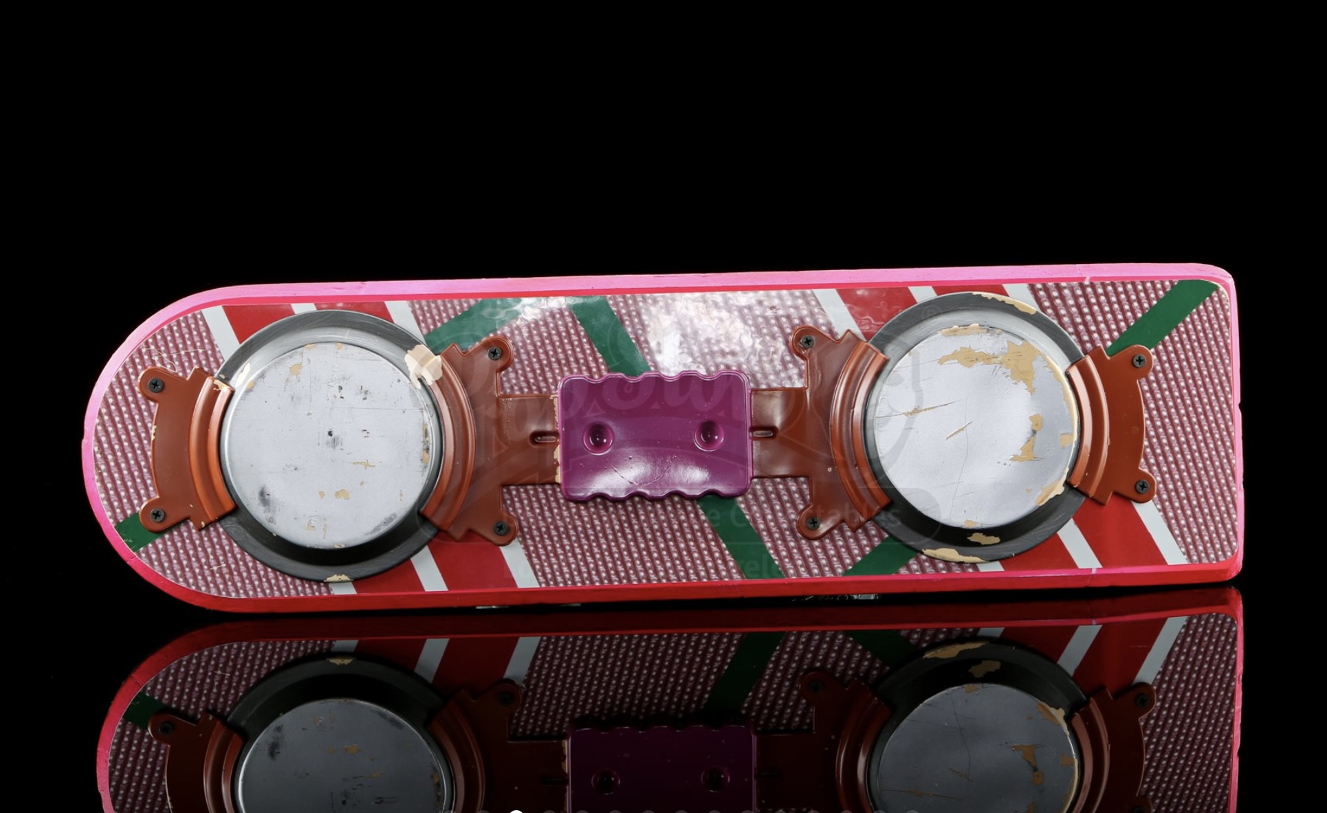

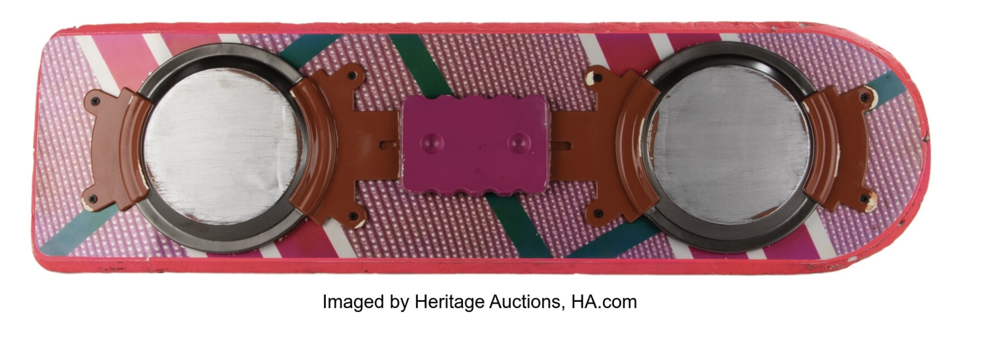

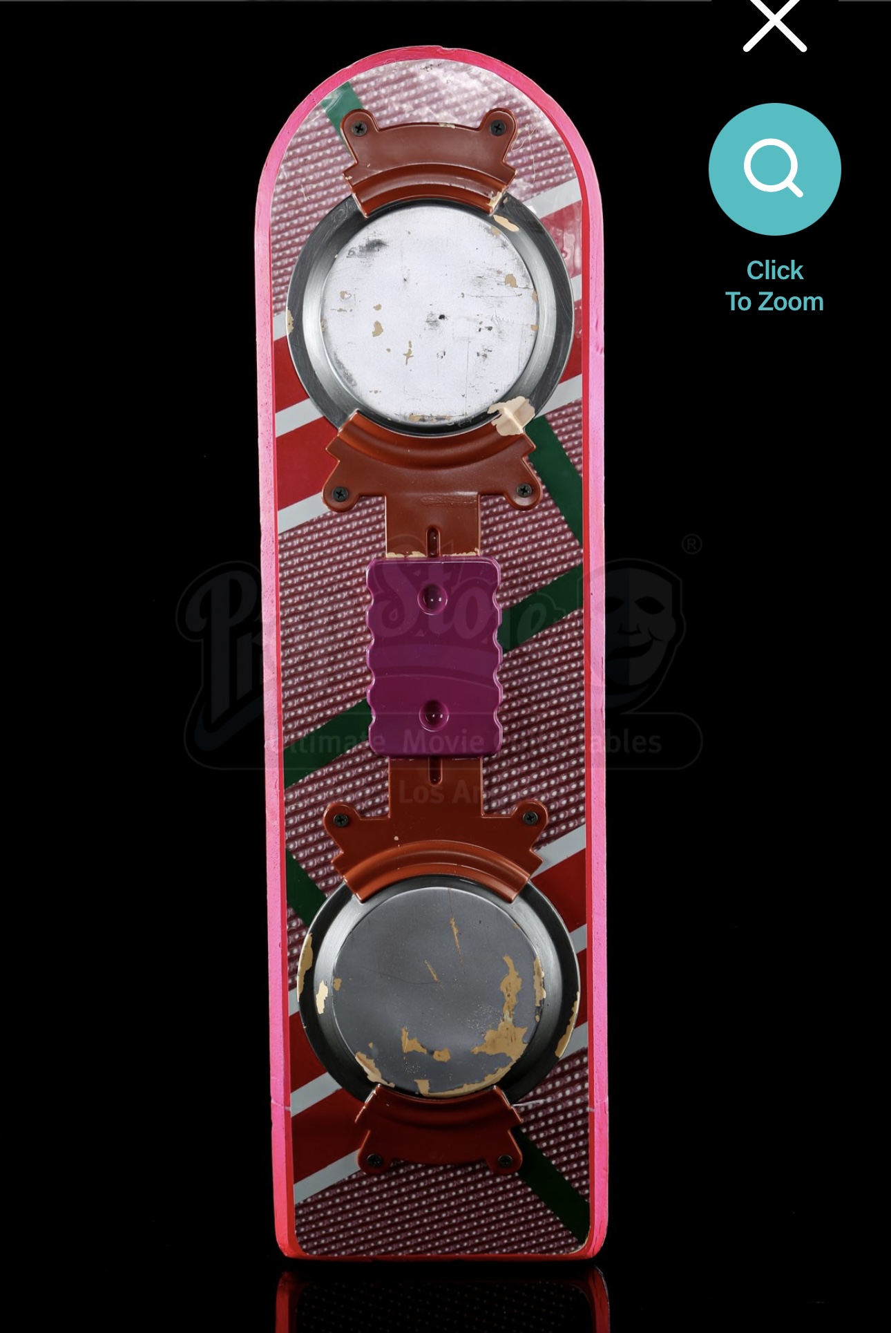

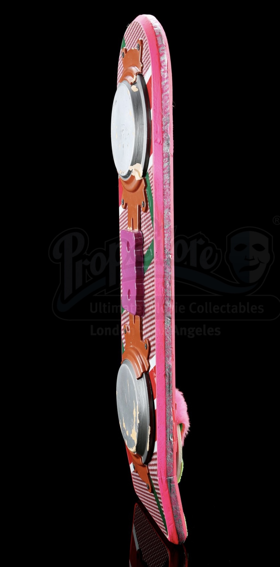

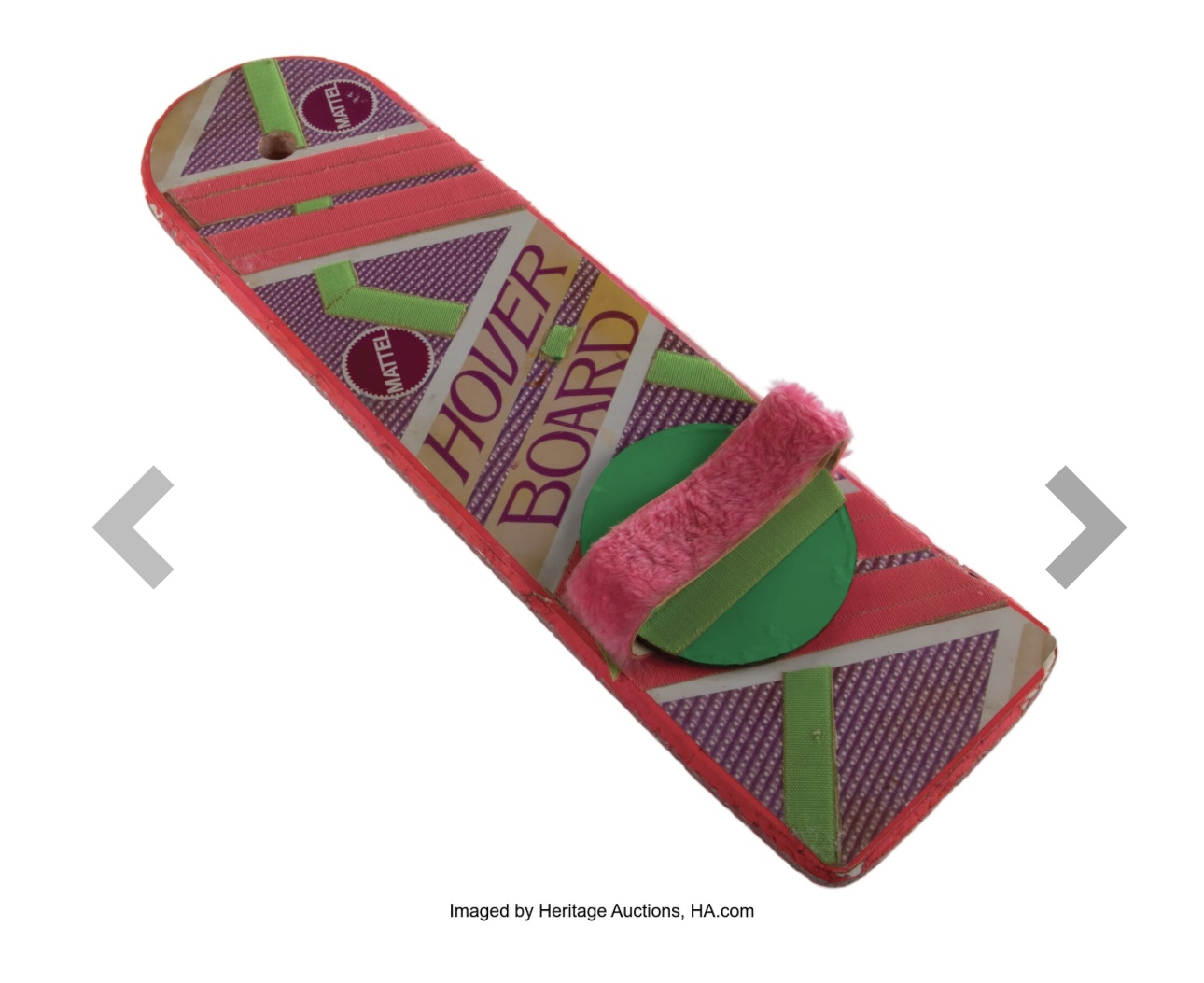

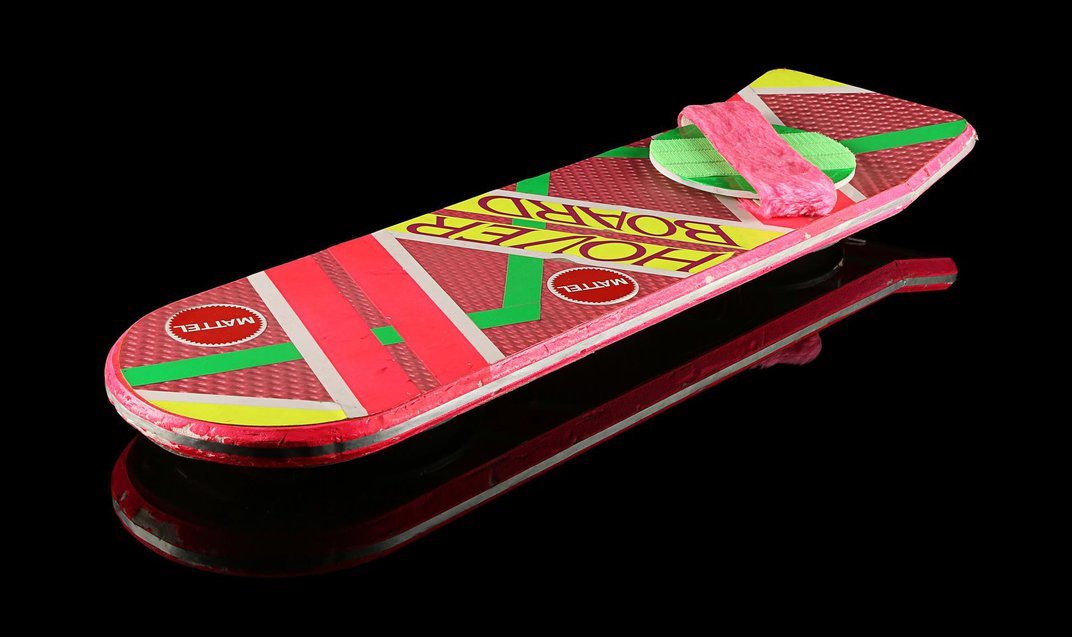

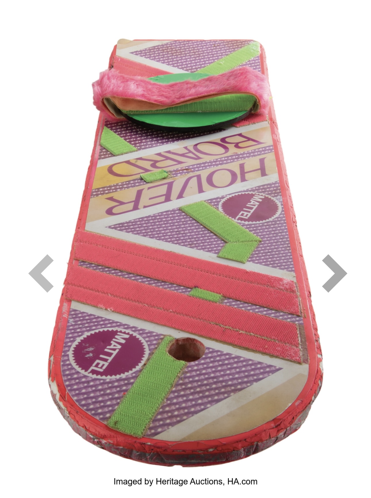

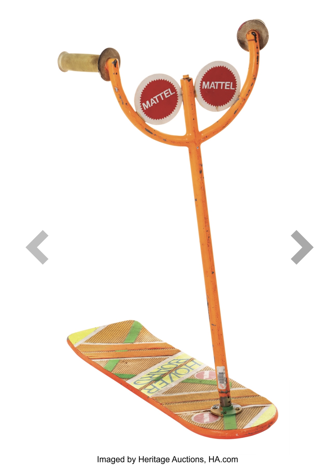

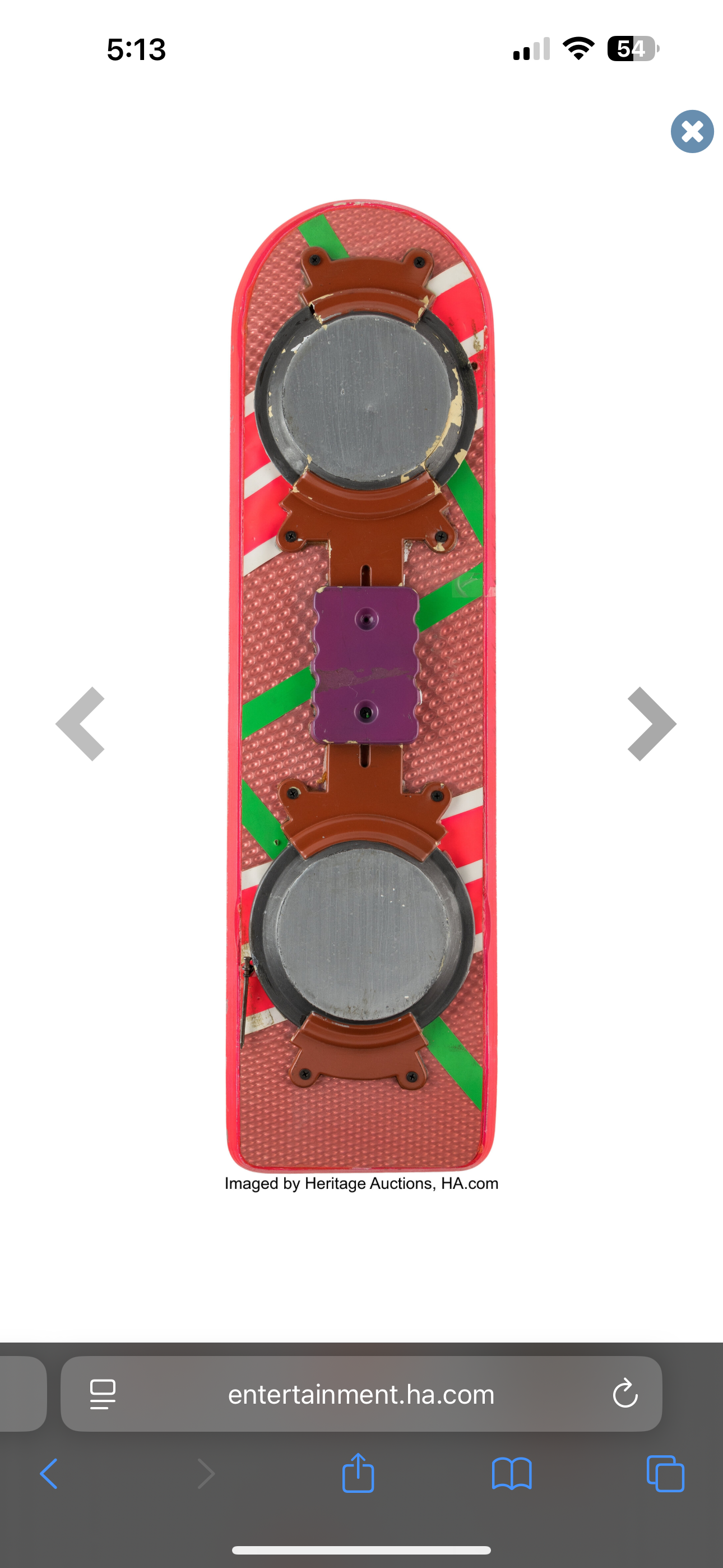

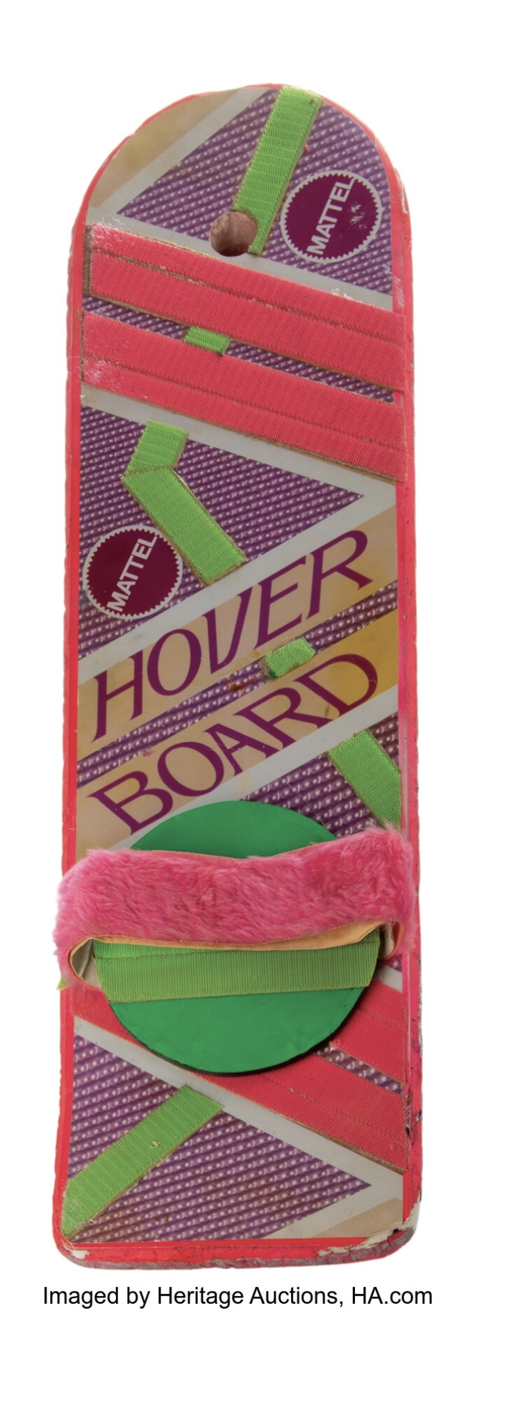

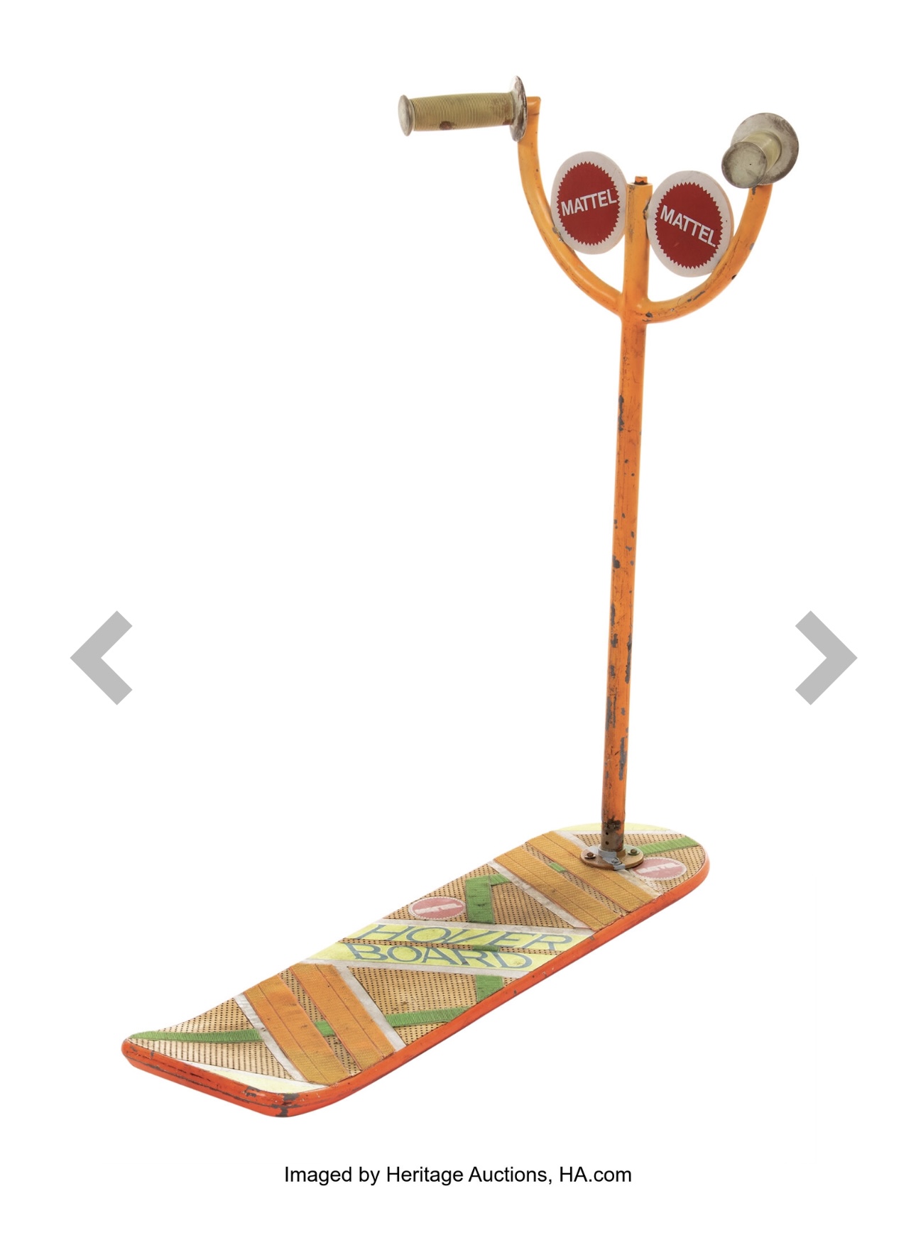

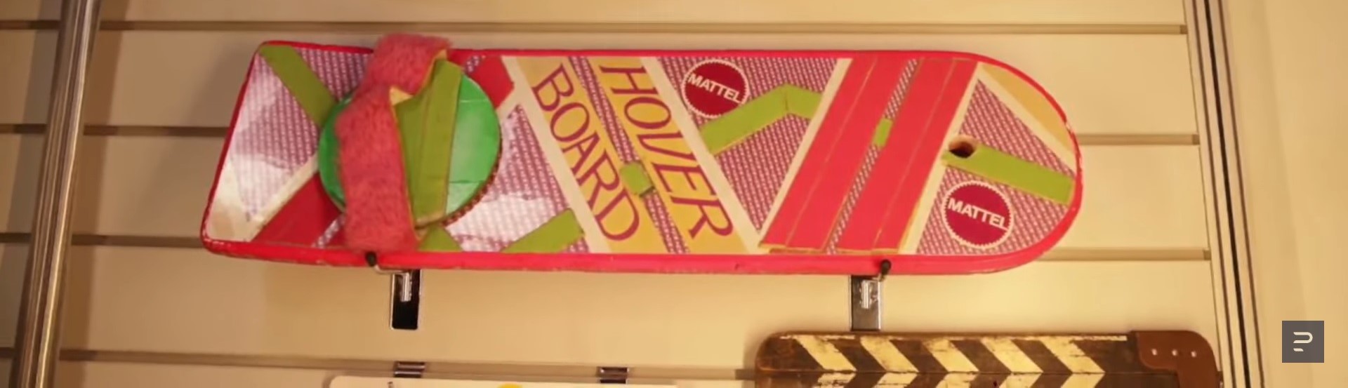

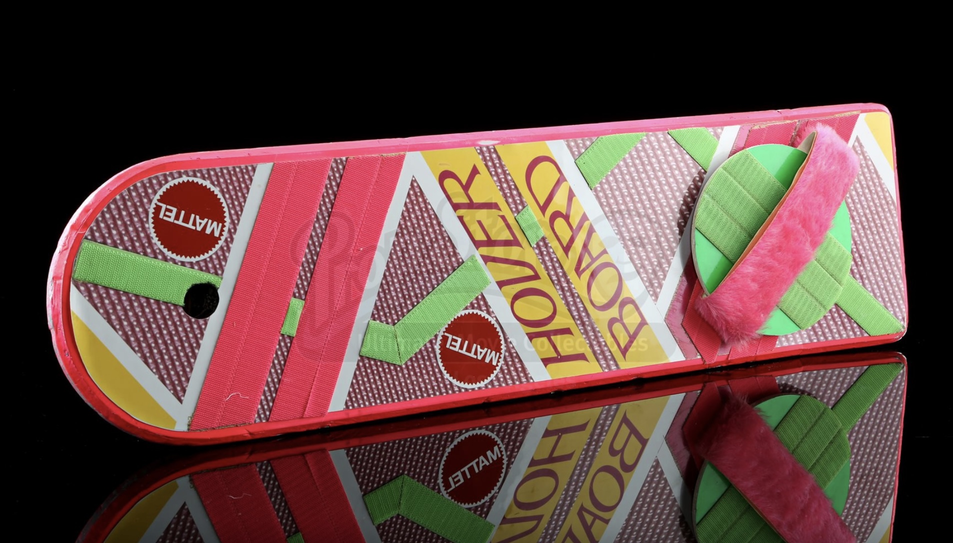

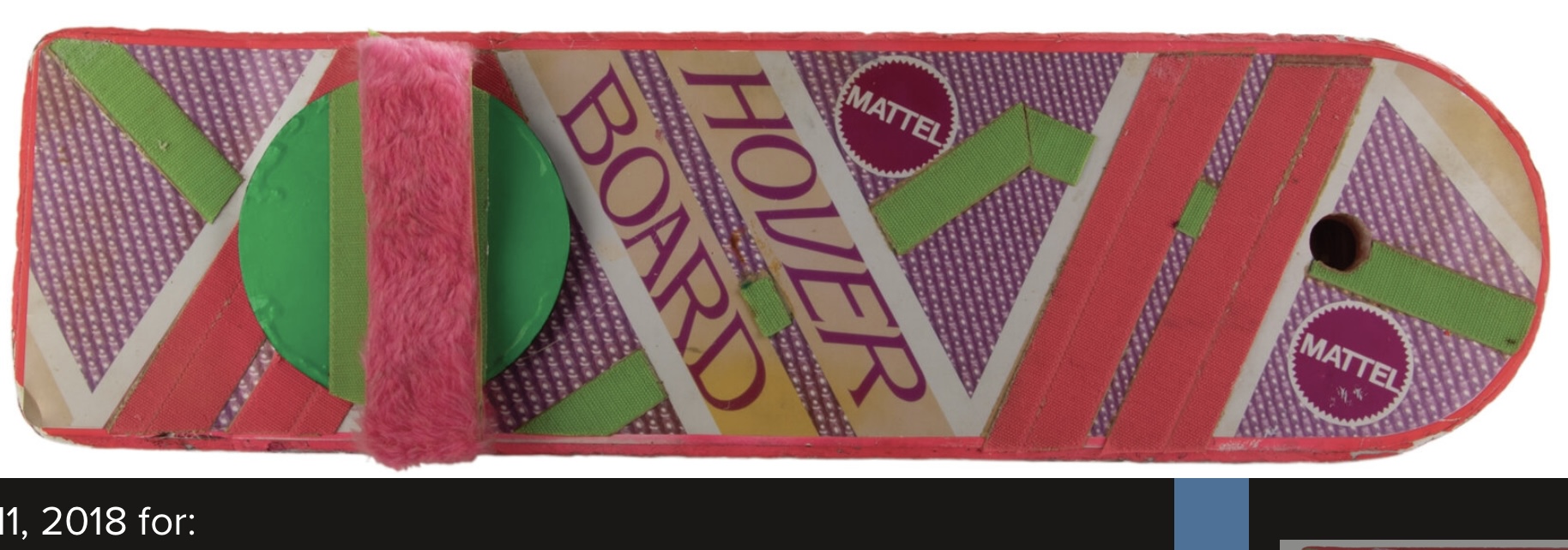

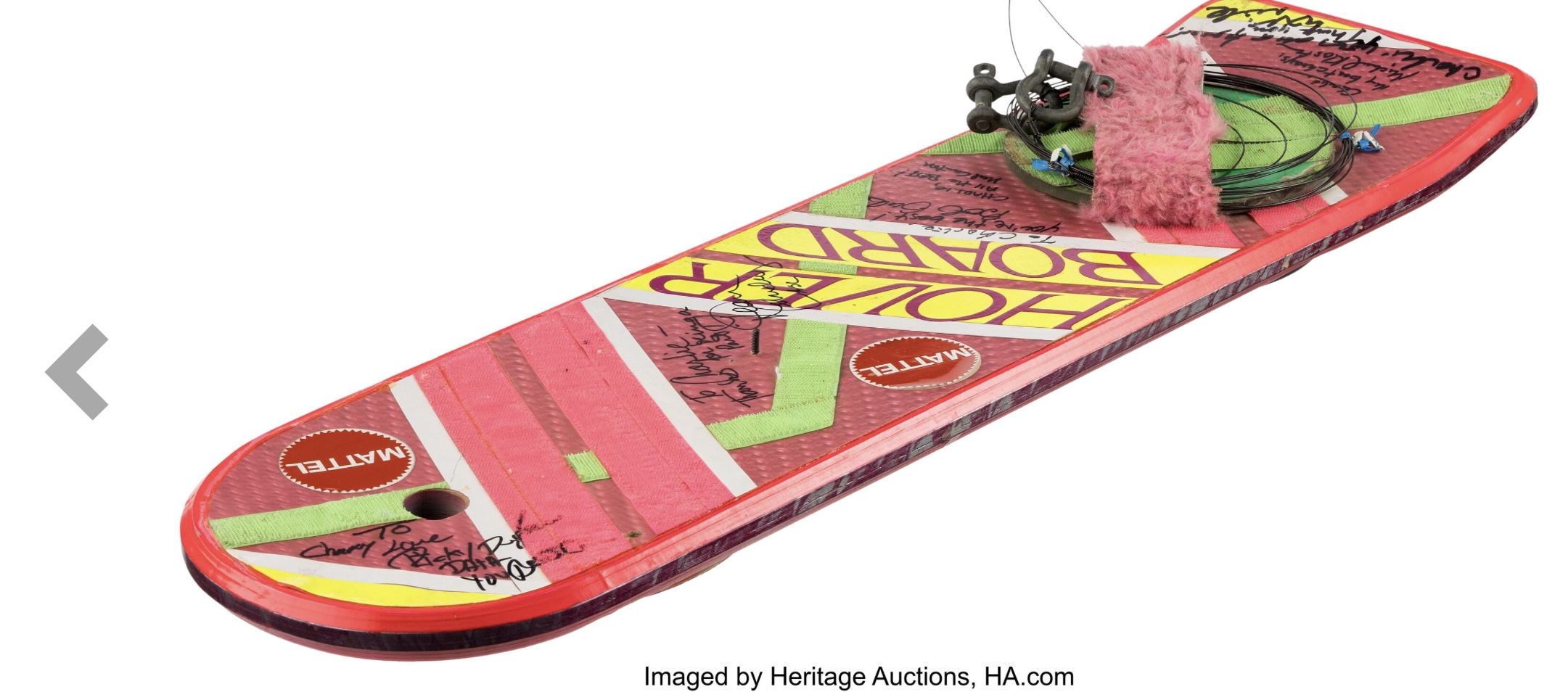

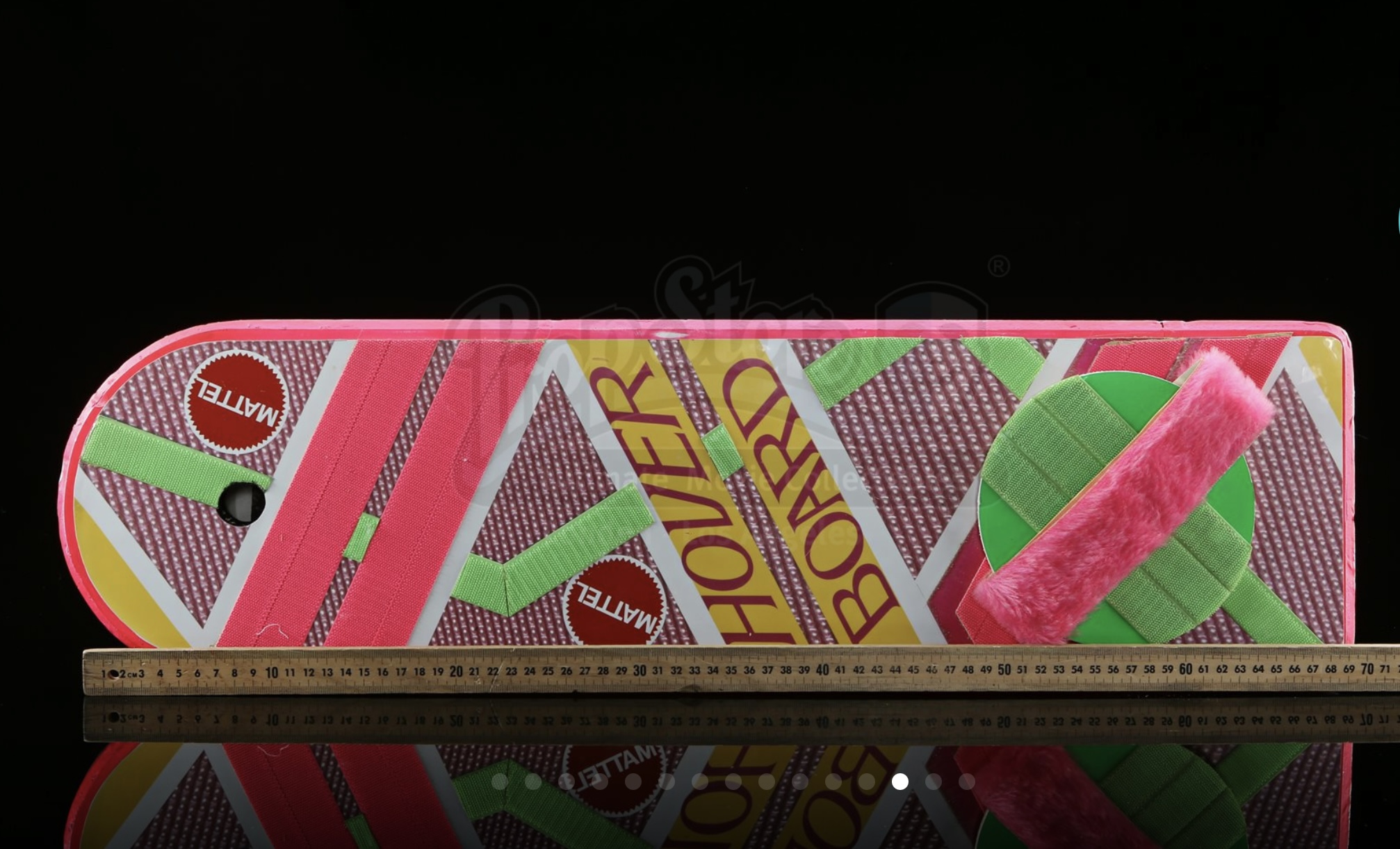

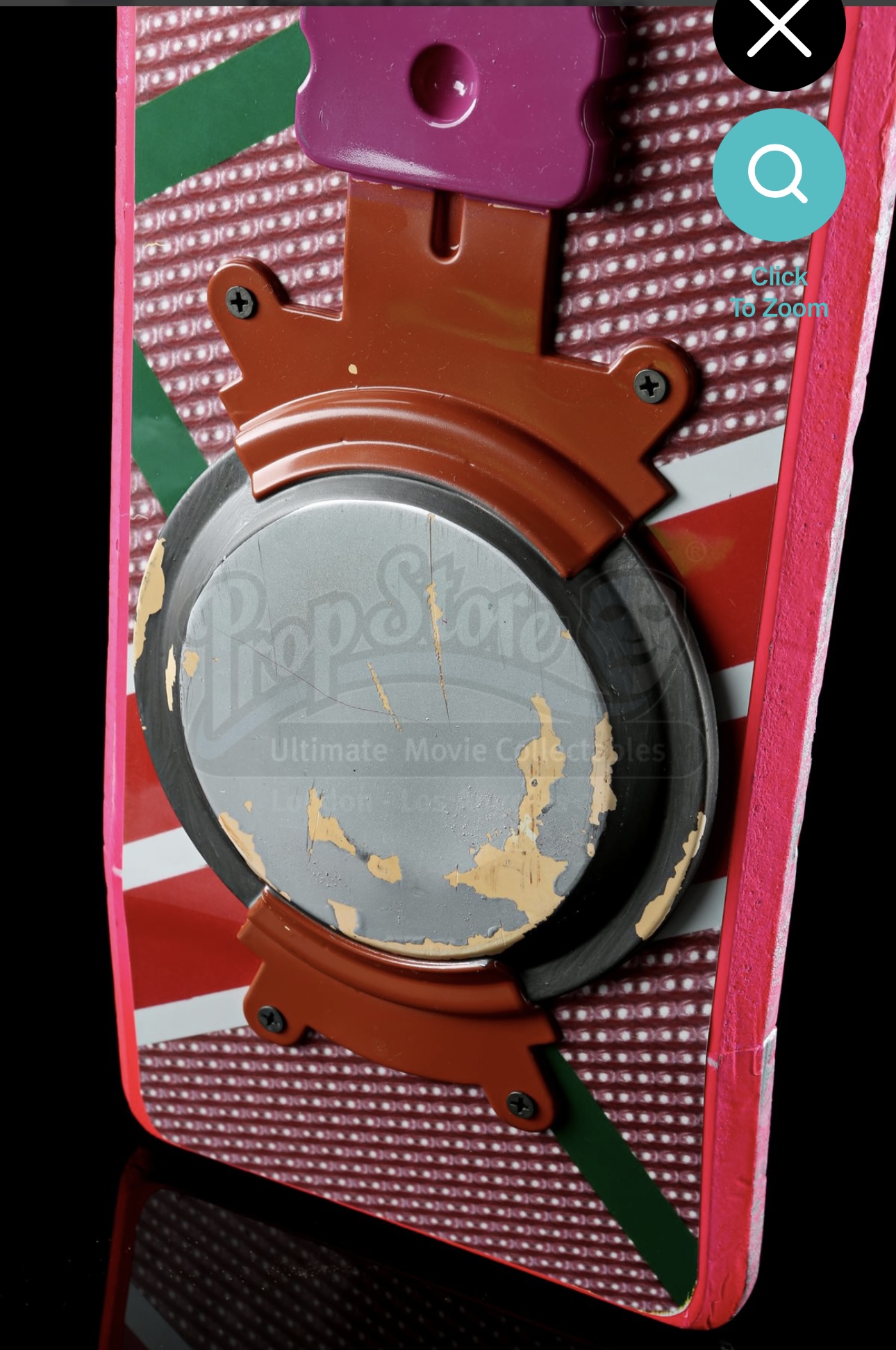

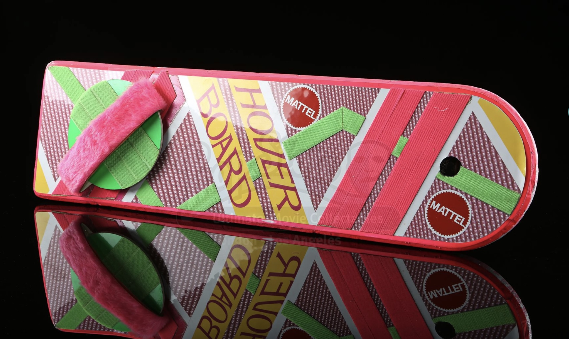

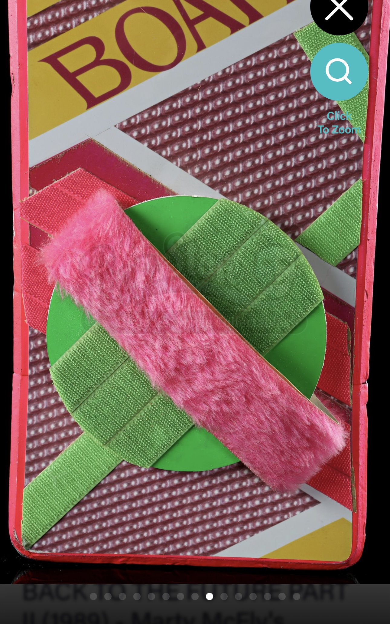

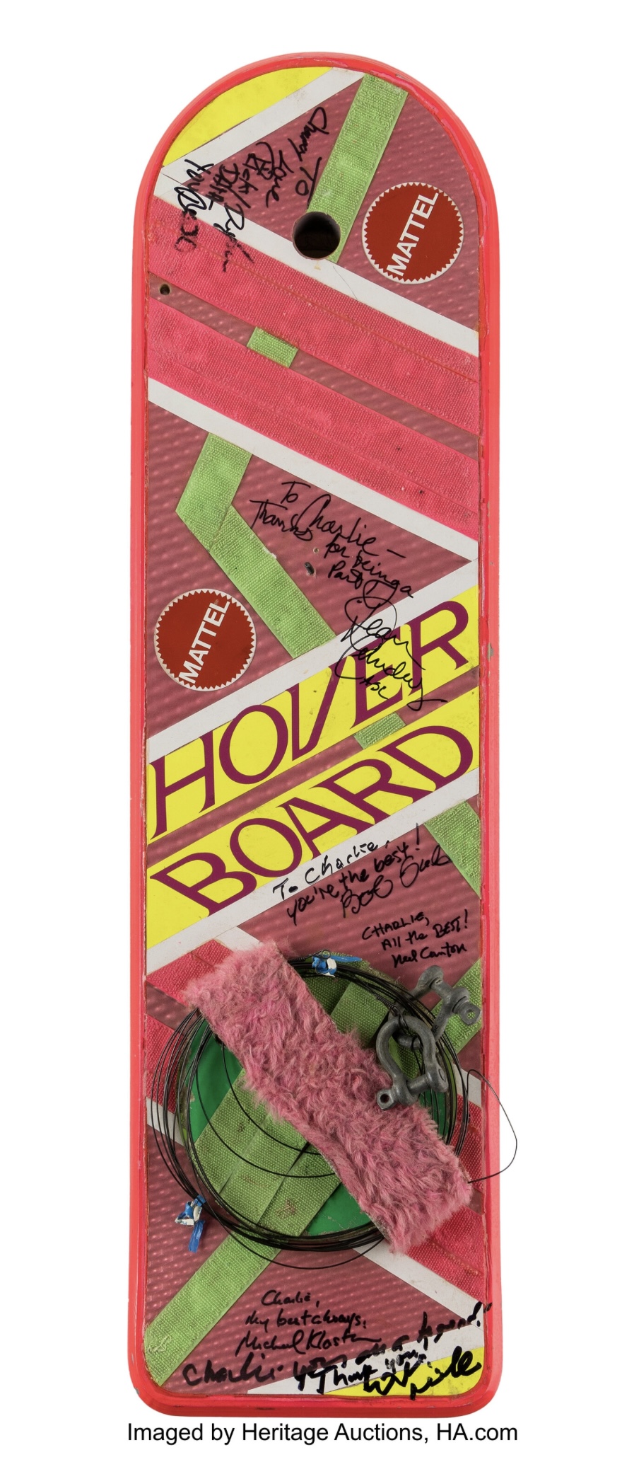

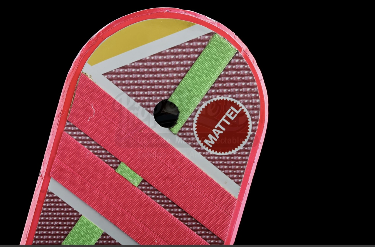

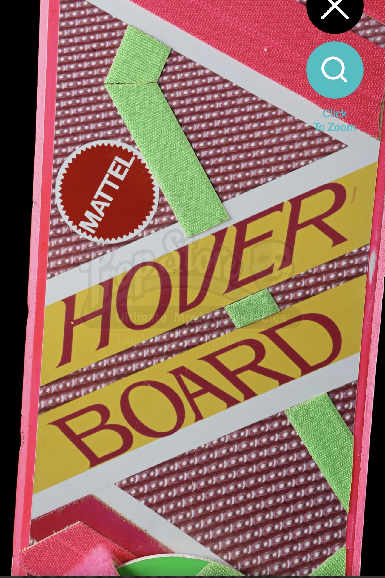

More auction/display photos of screen used boards:
Thank you SO much for all the photos, that's really clarified things for me.
That said, I have a question. Velcro (or hook and loop, if you prefer) has two parts which I will refer to as "spiky" and "fluffy". I can see (thanks mostly to your superb high res photos) that the movie props use the "spiky" part on the boards.
I understand why it was necessary for the movie, but at a Comicon, someone wandering around with a prop that "snags" on any woolly or fluffy material is going to be two things very quickly. 1. Annoyed and 2. Unpopular.
Do prop makers switch out for the fluffy part to avoid this problem?
I’m not a con guy, so hard to say without having been. For me personally, the Velcro isn’t that much of a pain to clean out. I have two dogs and two kids under 11, so finding a clean surface to even work on is a challenge. I can’t sweat the Velcro in my house.

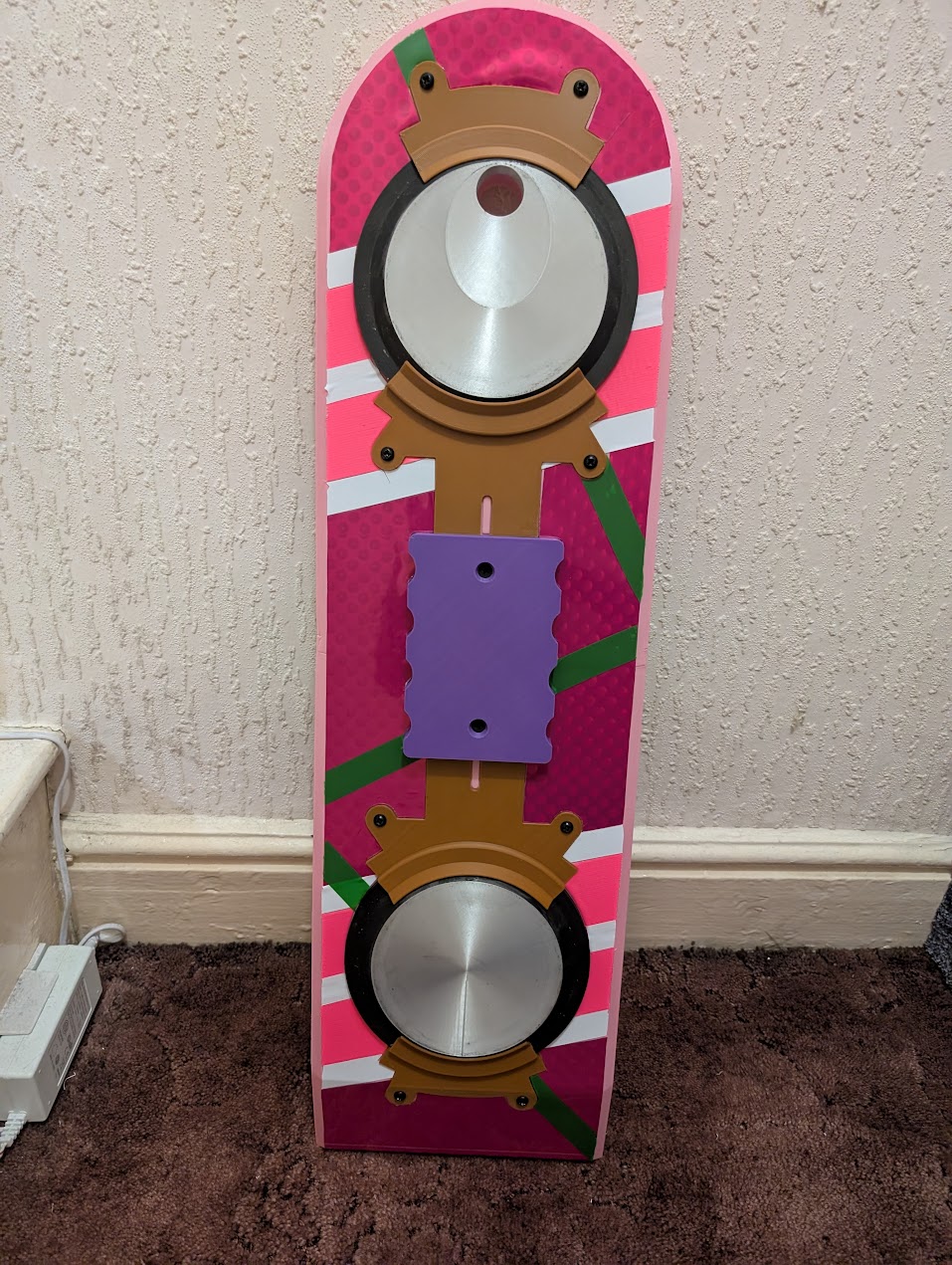

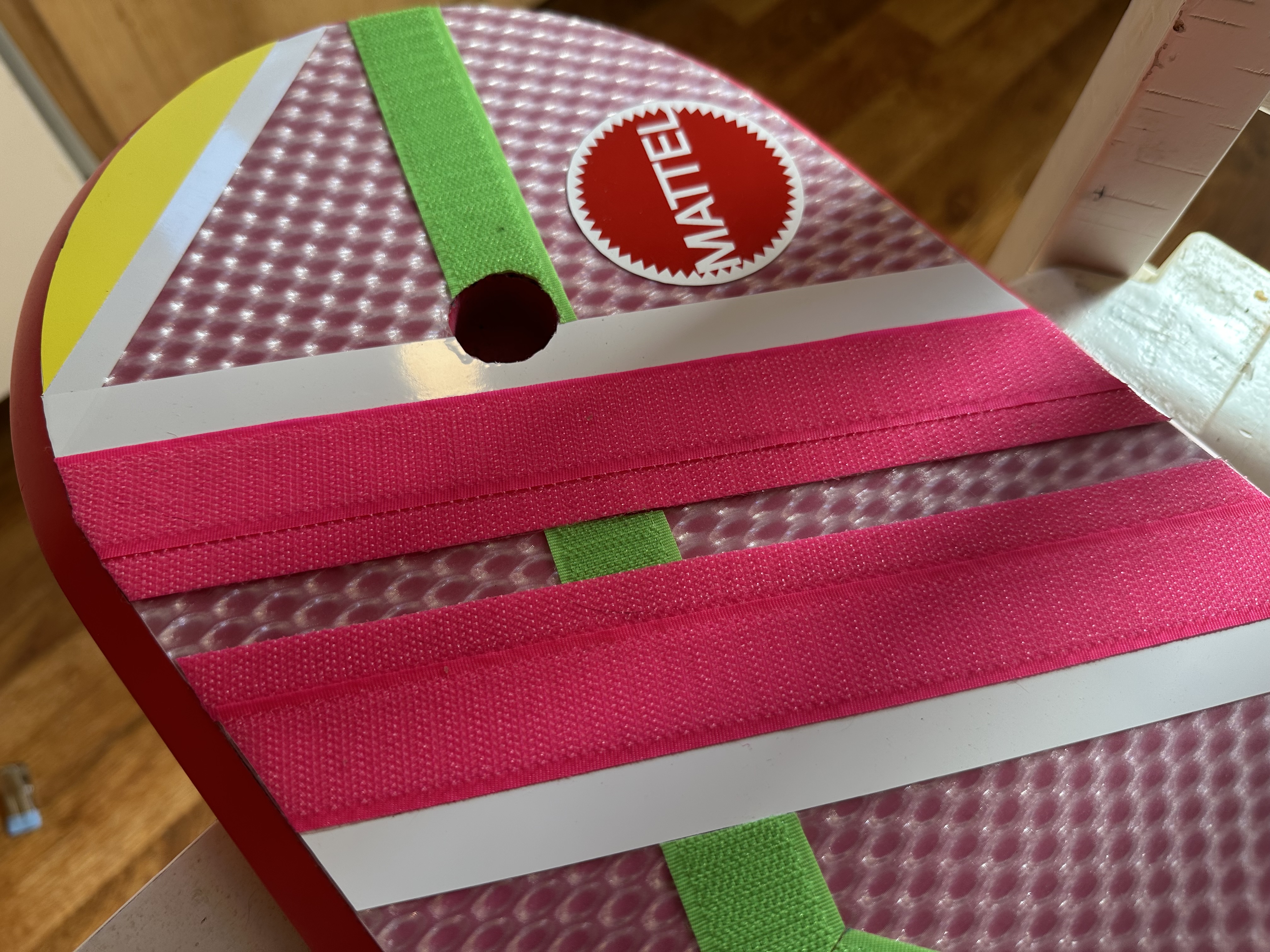

Not bad for a first try. Still a few things to add on the other side - Velcro in 1.5" width and coloured seems very hard to obtain...

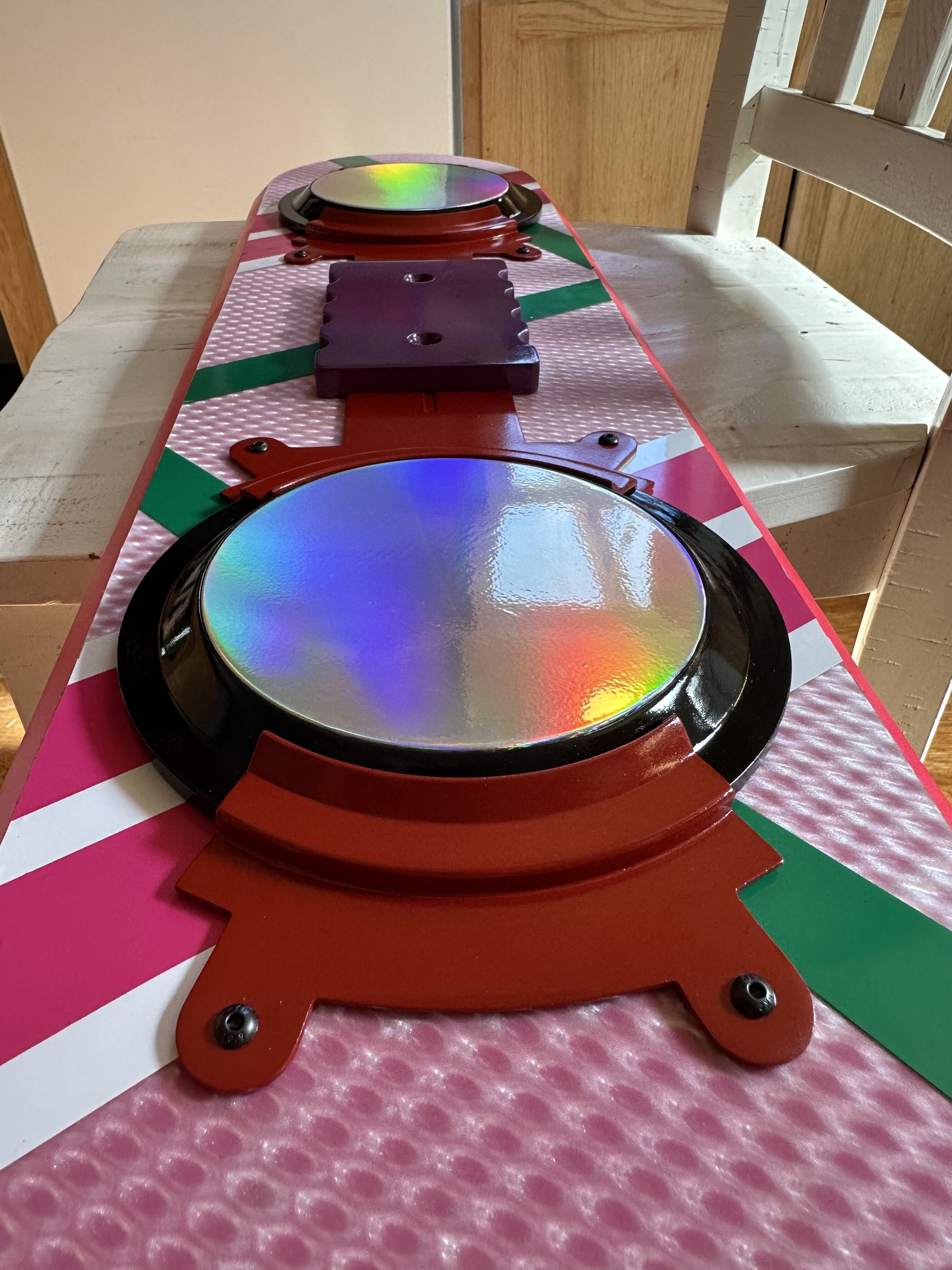

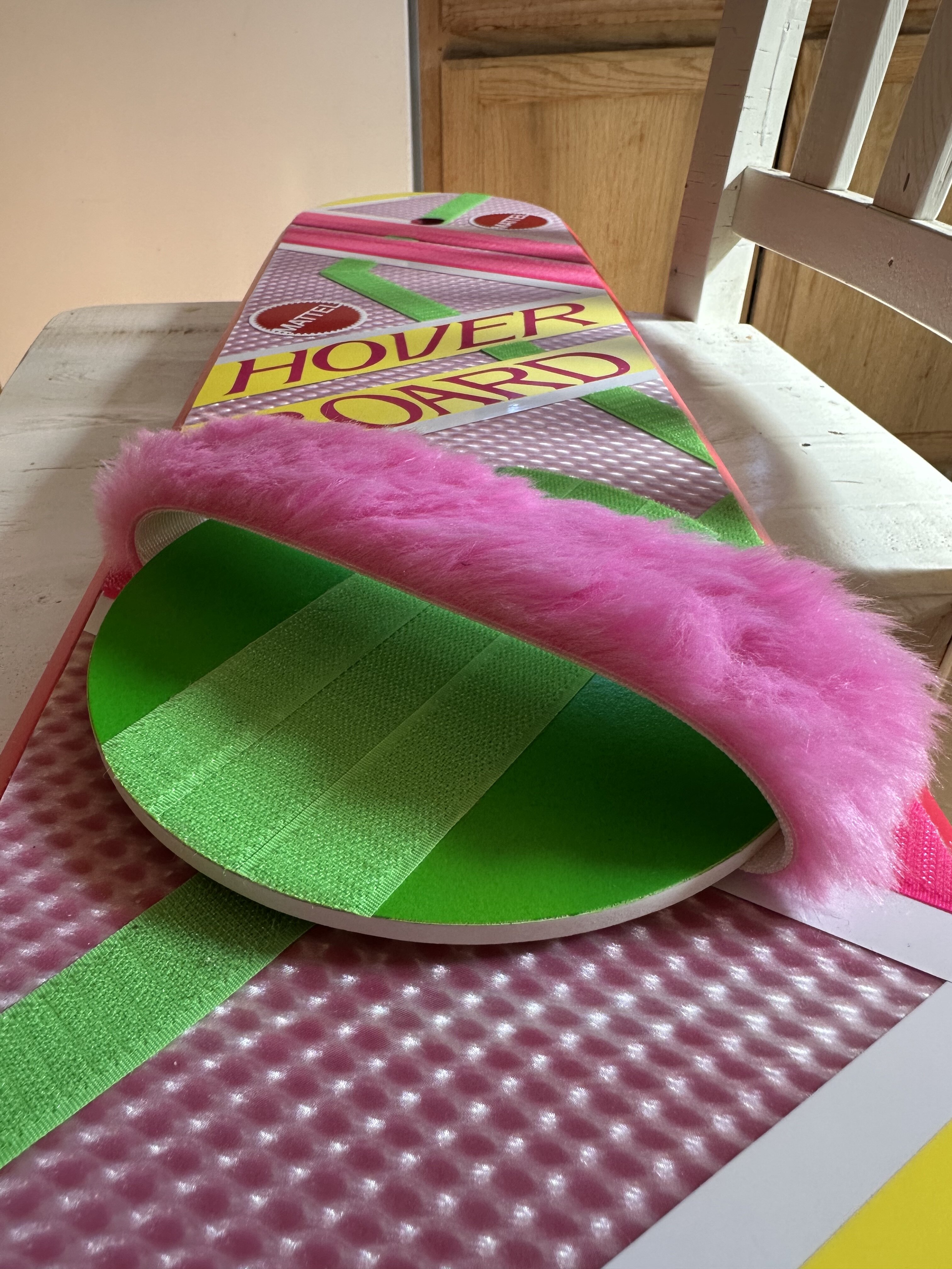

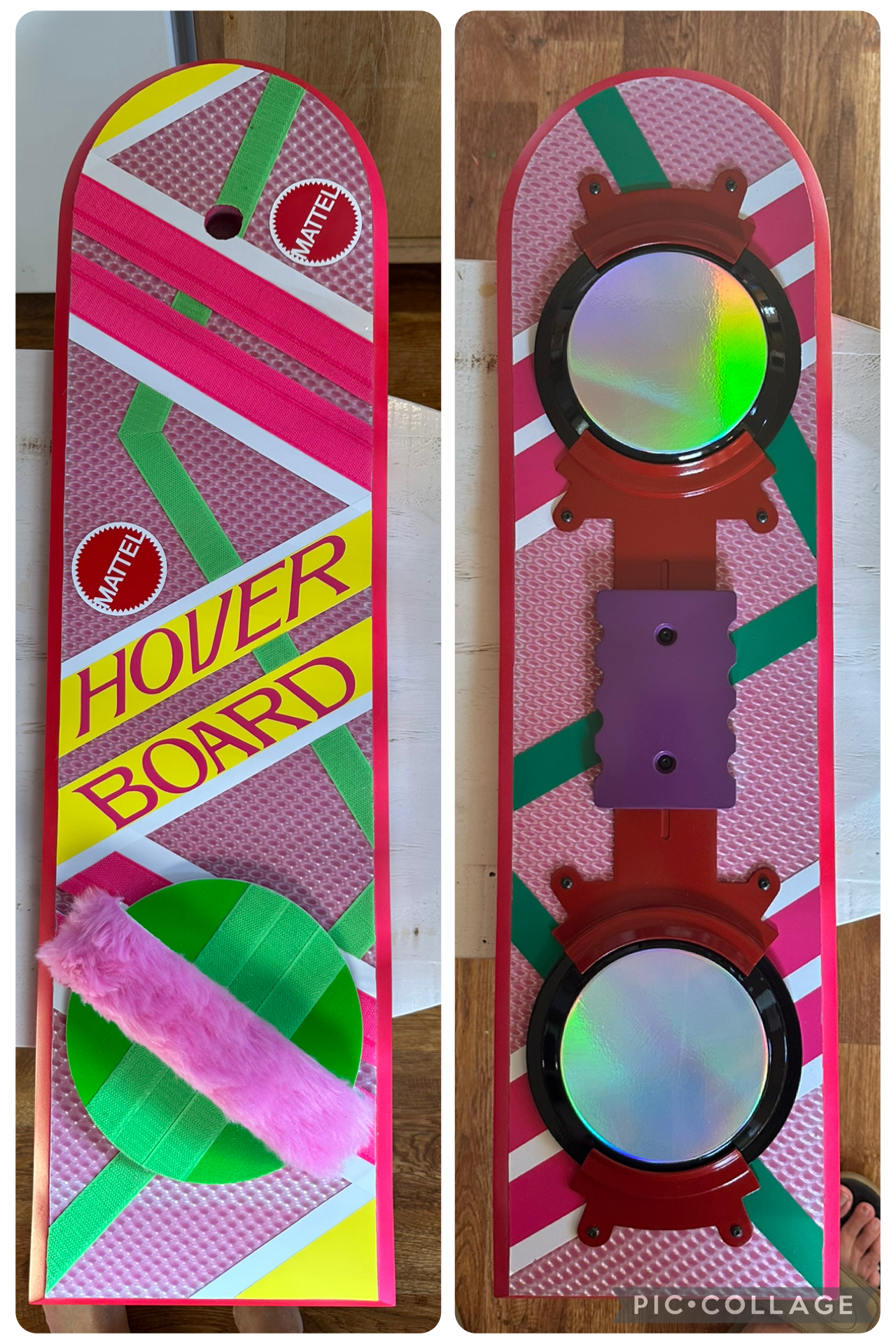

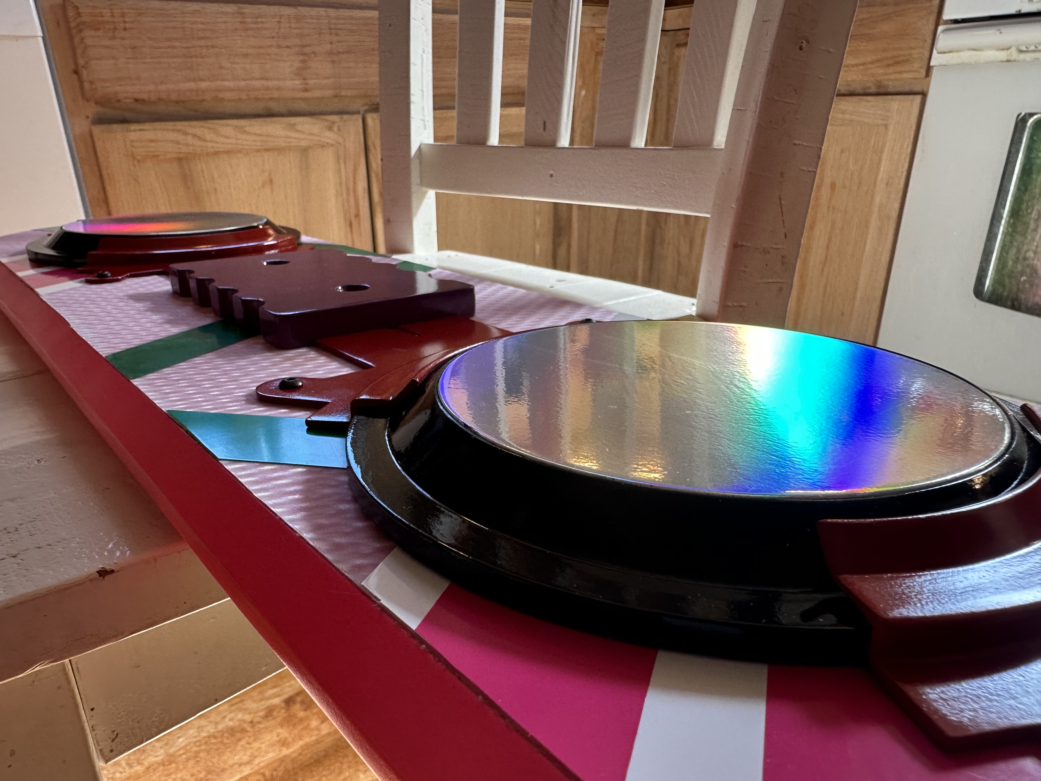

I finally got “hover board” added. The only thing I have left is the lenticular trim around the outer edge.
