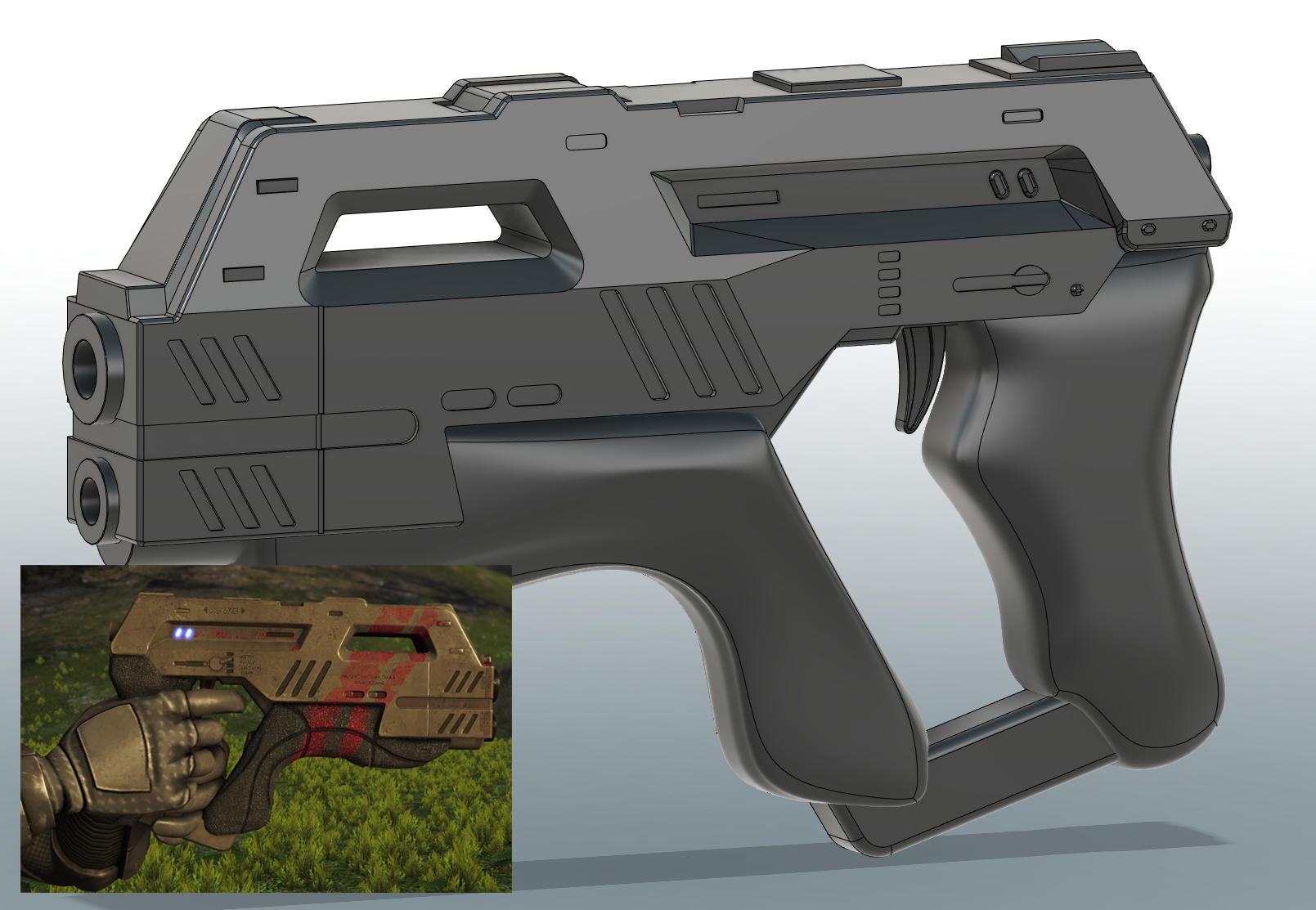

First step was to learn the Fusion 360 environment (quite comfortable coming from a 3D Studio Max background) to build the main design of the gun, the grips were moved to Z-Brush for molding and texture.

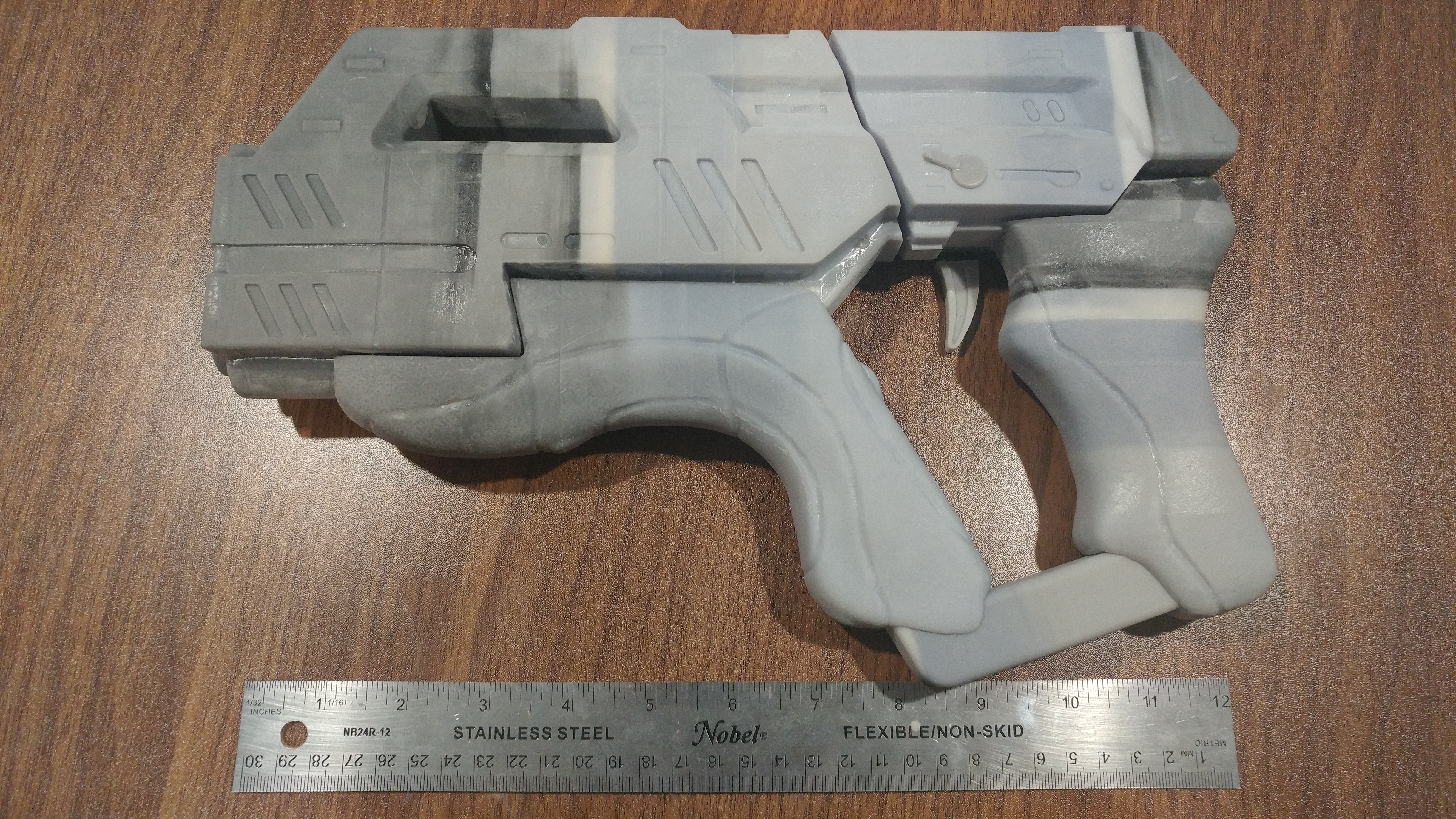

After a 20 hour print, cleaning and dry fitting, so far Very Happy!
Next was to Glue, Bondo, sanding and Basecoat.

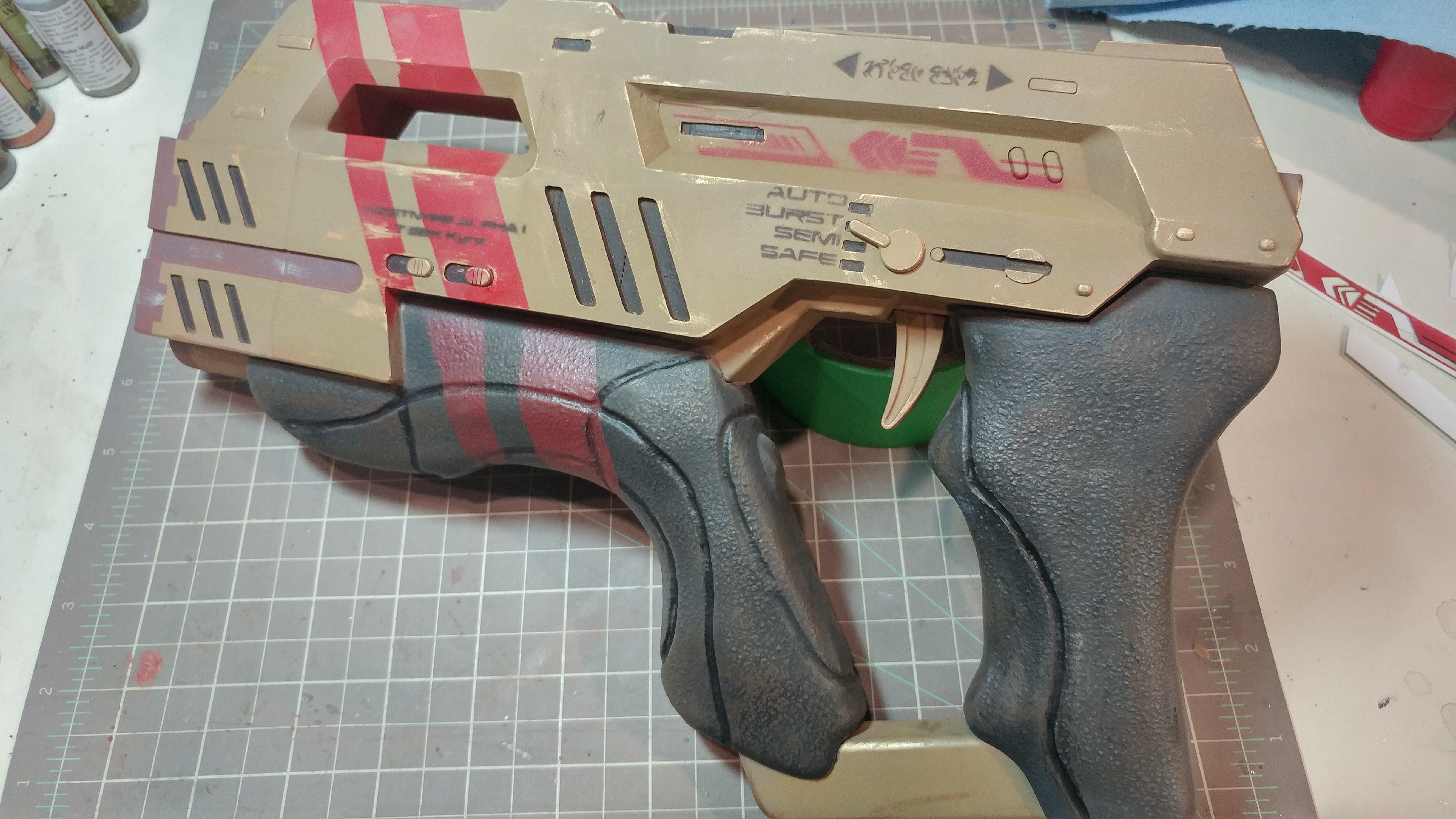

[EDIT 1] Raikou #1 Finished, well worn and used.
Very cool! Will be following! Out of curiosity what scale are you making this at? I own one of the Project Triforce Raptor replicas and I can tell you that thing is huge!
I can attest, It's a Monster of a gun, I can see why they turned it into a "Hand Cannon" for ME2. 314mm x 202mm or 12 3/8" x 8"

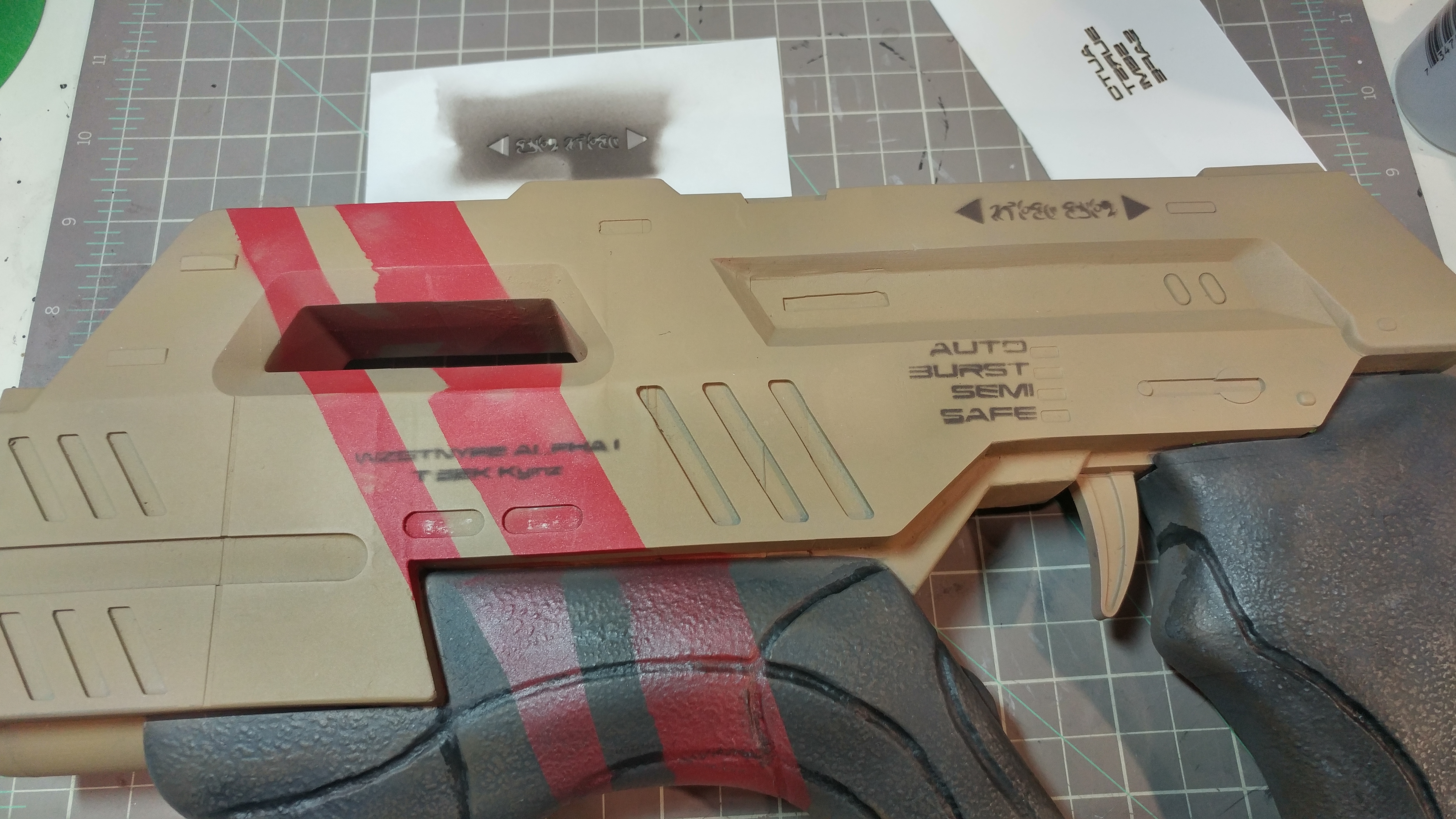

Next is to laser-cut some decal masks for all the text.

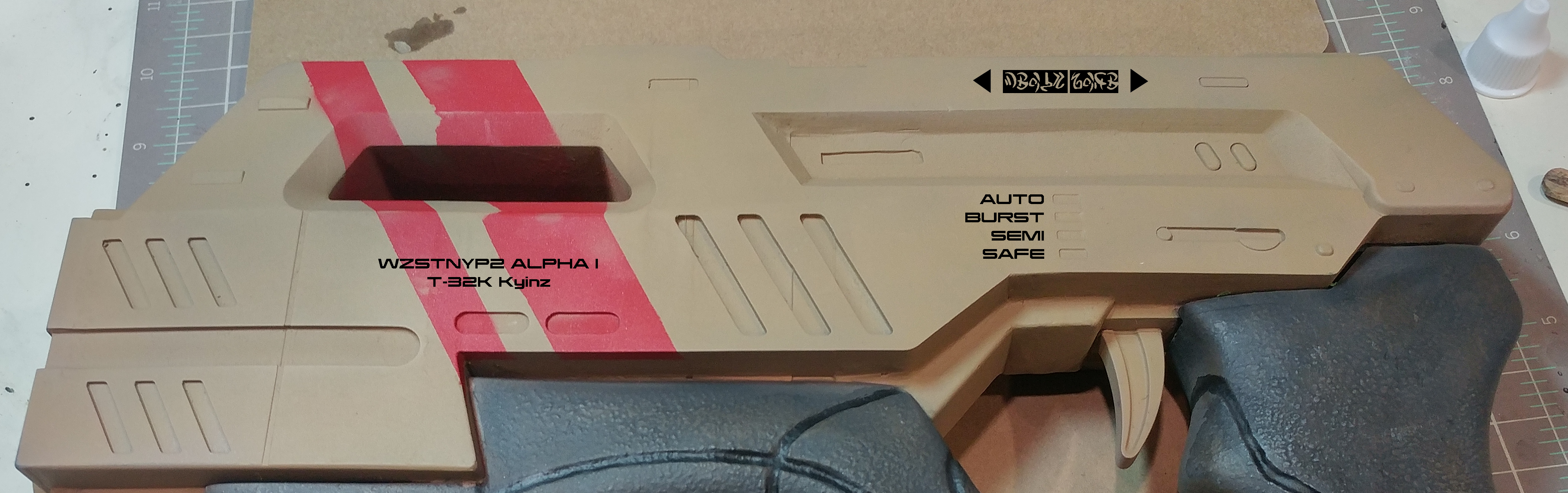

Working on masking for the text work and I NEED YOUR HELP!
The top Rail is completely Ineligible and I wander what you wonderful people would think it should say
as well as the text above the selector toggles it looks like "(W-STNYPX unknown) ALPHA 1 T-32K Kyinz" but I wonder what you think it is.
Any help would be Greatly Appreciated to make this feel authentically in universe.
the mode select is Auto, Semi, Single, Safe. but I think I should make Single into Burst as the Raikou is a 3 shot burst pistol and the Spectre version is a Semi-auto.
Well, Since the wording on the "rail" already looks like alien language, I decided to rebuild the Quarian language into a Font for future uses and made a <SAFE DEATH> label for the guns... Why is it in Quarian?:unsure:.. *shrugs*
Last update for tonight, Just the heatsink and the barrels left to mask.
I've already learned so much working one this project!
Gun 1 of 2 finished! So much work and so much learning!
