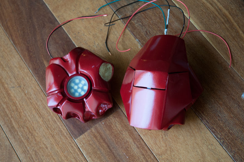

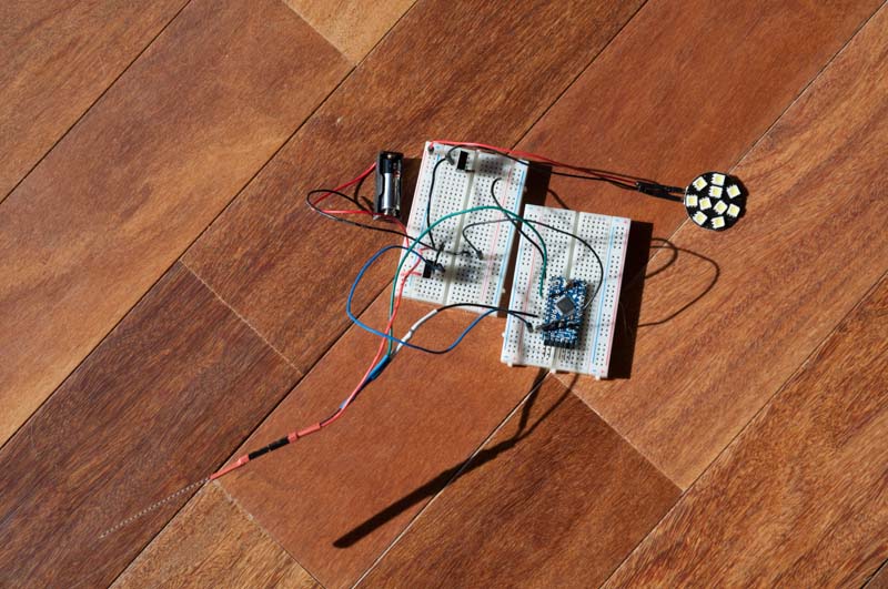

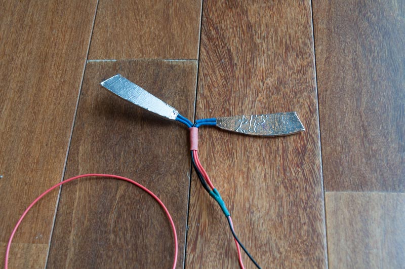

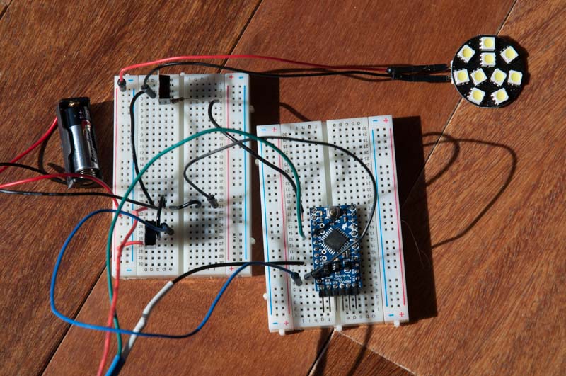

Got new eye circuit wired up using a small reed switch. Will use the 12V A123 battery to power it...smaller than the 9V and more juice! Yeah. Also got the wiring all figured out for the repulsers thanks to Honus. He is a lifesaver. Still think I will add the Adafruit wave shield like Honus did, so am not hard wiring anything yet. Anyone know where Honus put the speakers for those? I assume somewhere in the arms and I probably need 2 shields/speakers...one for each arm??
http://youtu.be/x3ND5lTlEdw
Shows the eye light set up
Repulsor wiring protype - YouTube
Shows the repulser set up (just on the breadboard), still need to figure out how long my wires need to be:p

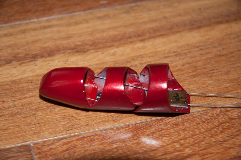

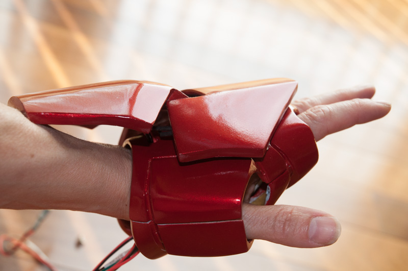

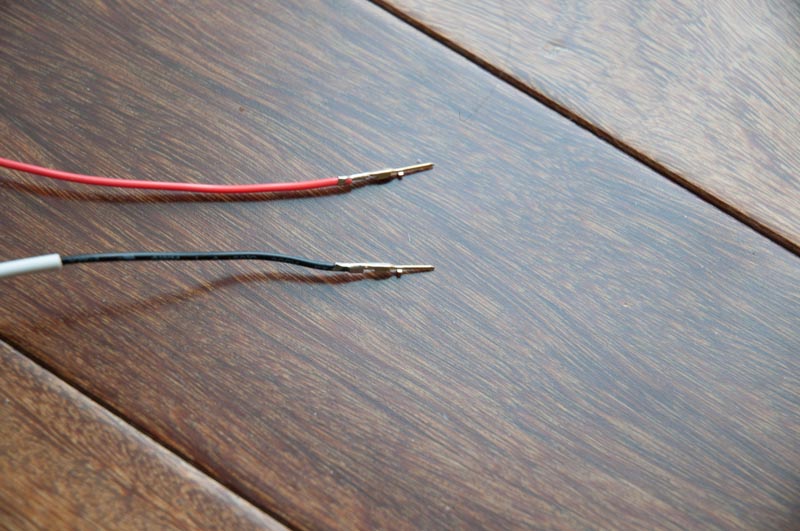

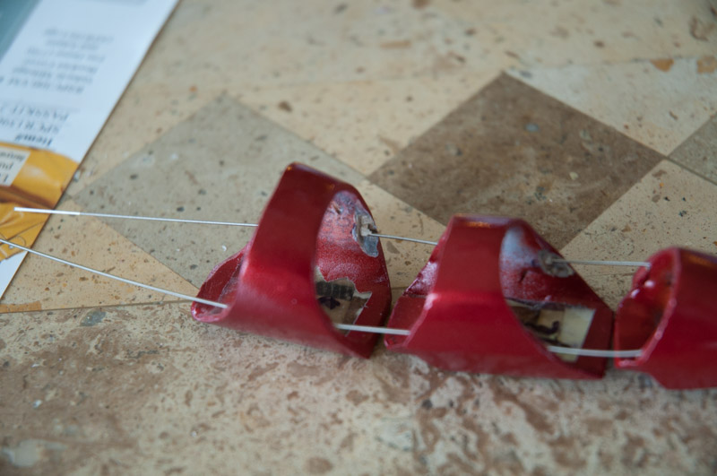

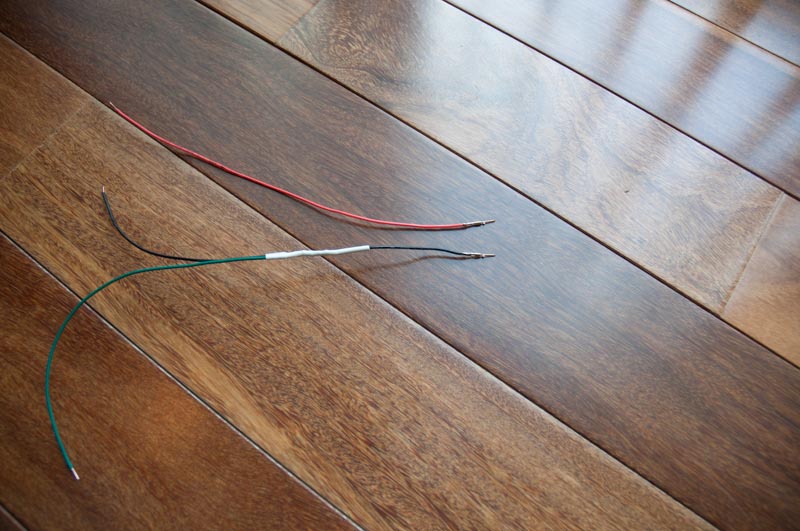

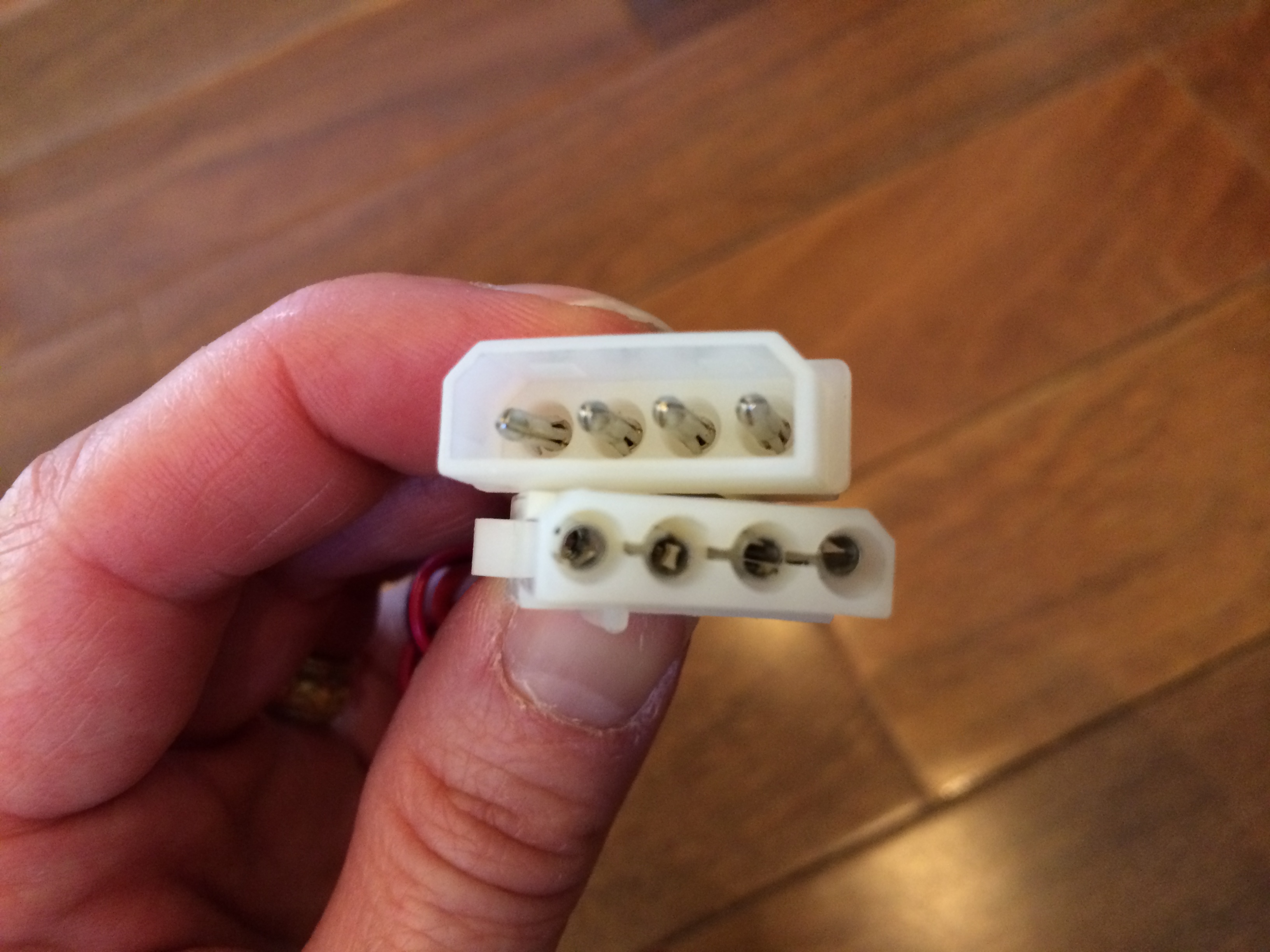

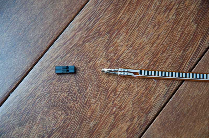

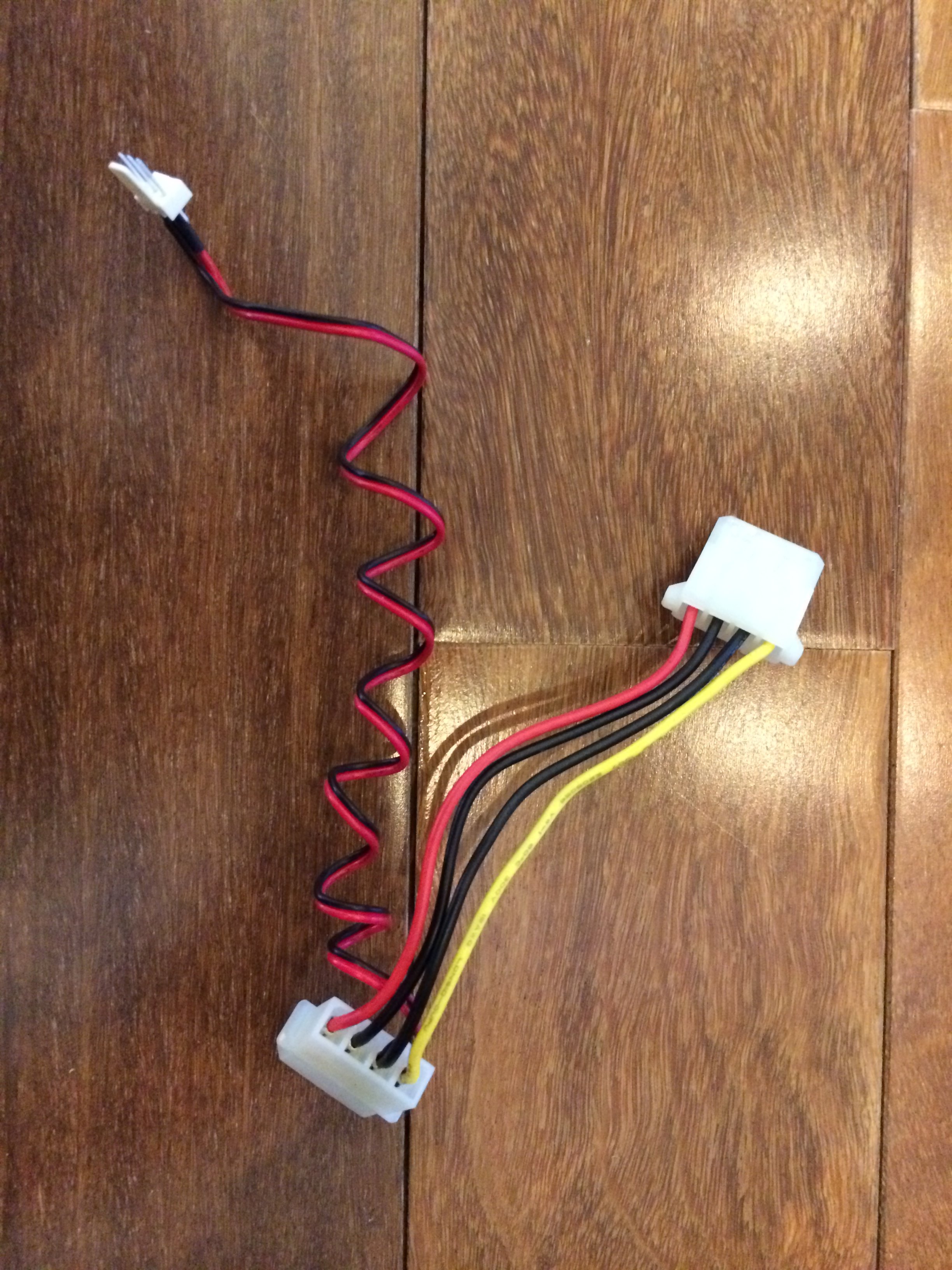

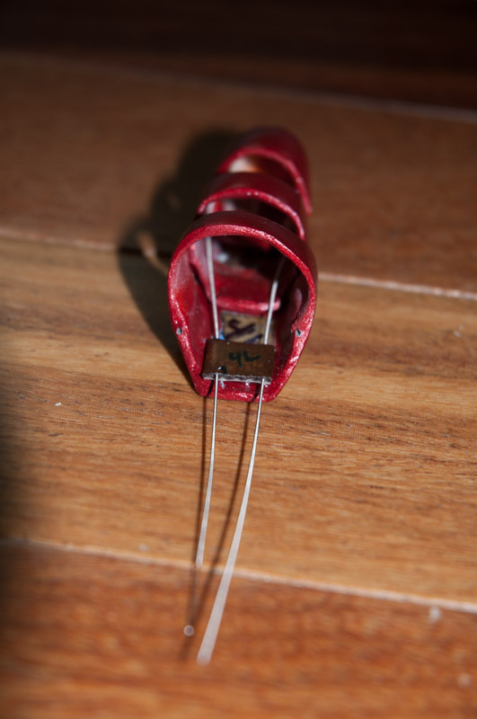

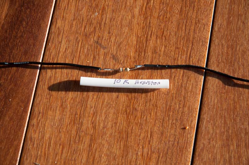

Trying to get my repulsor wiring all together, but am wondering how other folks made it so the cables running from the glove into the arm pieces were easily connected/disconnected, yet stayed together while the suit is being worn? Anyone use connectors like these? Think they would work if I cut and soldered my wires onto these? My wiring is 22gauge and the wires on these connectors are 18 gauge. I don't know enough about electronics to know if having two diff gauges would affect performance. I cannibalized the connectors from some old computers. My fear is using something that will come disconnected while wearing the suit.

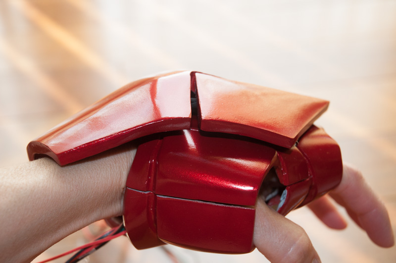

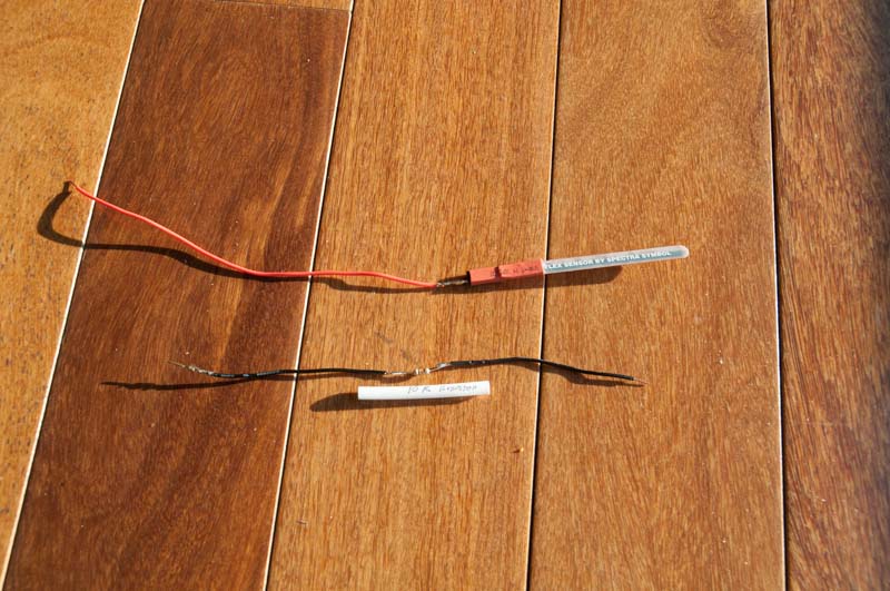

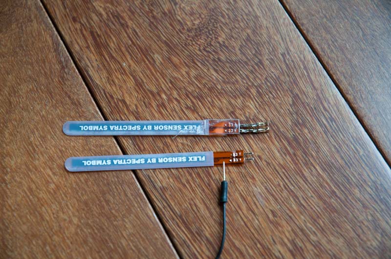

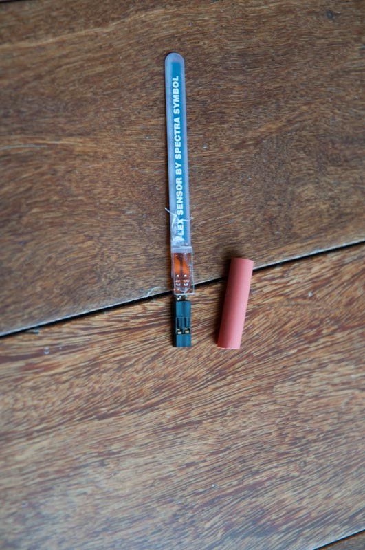

Still working on these babies. Uploaded another video with the light/flex sensor inside the glove (though all the other wiring and bread board and pro mini are all in my right hand...lol :$). Here is a link to the lights in action. Video is kind of dark since I wanted to be able to really see the light. And I still need to order those wave shields to add some sound.
https://www.youtube.com/watch?v=-qE3hzxG90E&index=21&list=PLjnxhotbeEgTZSetIpDJaPlaJ604-4YWn
Molex connectors like that will work just fine- the difference in wire gauge won't matter. Make sure to leave your wires long enough so you can take the gloves off without disconnecting the cables since it's hard to unplug connectors while wearing the gloves. :)
For speakers I used two small rectangular speakers from an old monitor and mounted them in the back just under the arm opening. On Greg's suit the sound setup is a bit different since the WaveShield only outputs the walking sound and the hip pod flare sound. Greg already had a repulsor setup with a sound board that fit in the gauntlets and for those we mounted small speakers under the hand protector that sits on top of the glove on the MkIII suit.
Thanks for the input Honus. Greatly appreciate you sharing your knowledge. I would need a round speaker about 1" in diameter if was going to fit it under the front of the stationary part of the hand plate. Good idea as it keeps the sound where the action is. Hard to find a speaker that size though so I may end up doing what you did or put them in one of the arm sections, but that means more more wires to connect/disconnect each time the suit is put on.

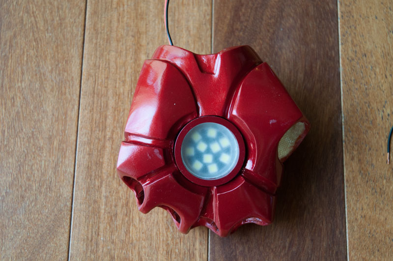

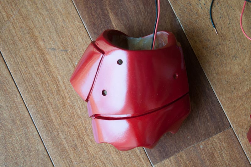

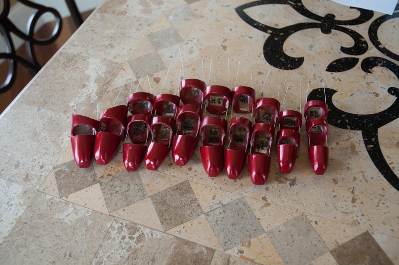

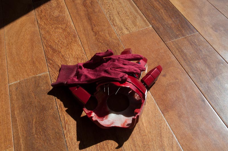

Been busy working on redoing the gloves, fingers and hand plates. Was having a hard time getting cloth gloves inside the gloves and fingers and since I resized the gloves, the hand plates an repulsers had to be redone. Yes those are milk jug caps on the back of the repulsers...gotta love recycling! I used Darkside's mods of Zabana's gloves so the repulser ring wasn't in the pep. I just used the thick walled PVC pipe and acrylic pieces cut with hole saws.
Worked and reworked the fingers to get them to align correctly. What a PITA. Used 90 pound test to keep my channels free as resined/bondoed/painted and that worked pretty well.

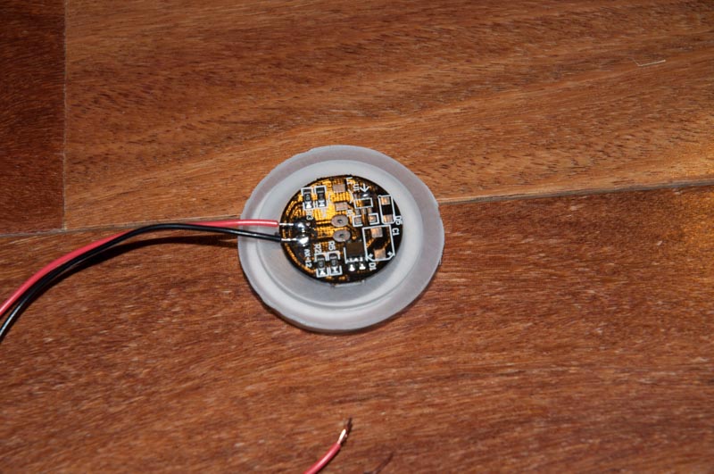

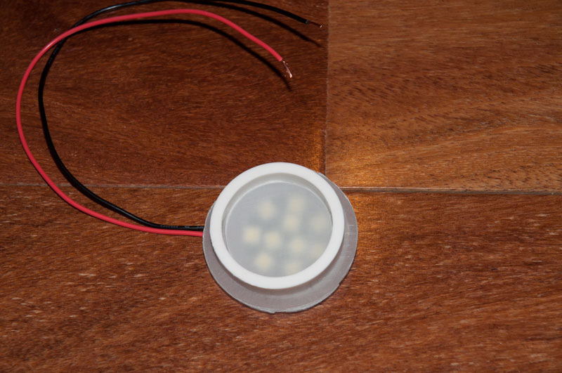

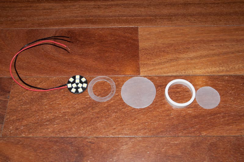

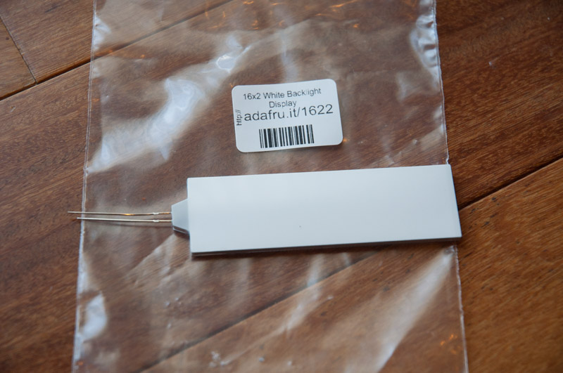

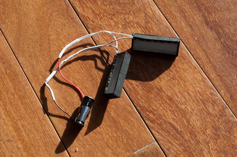

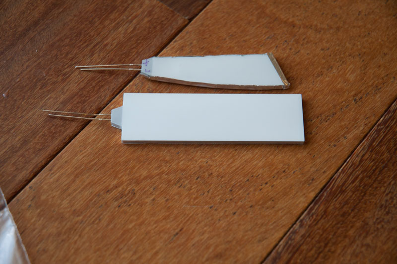

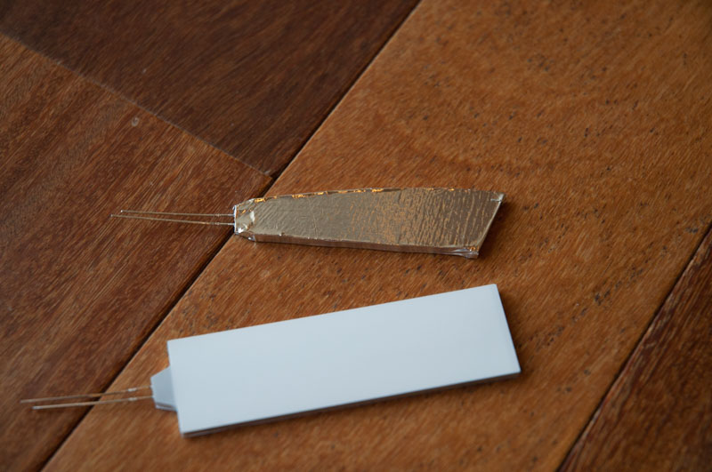

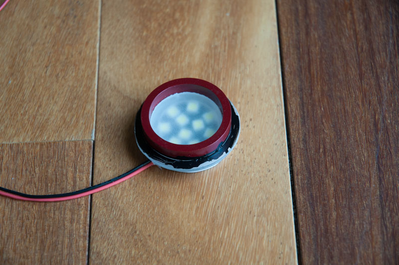

The original eye lights were too bulky to fit inside the helmet with the repositioned servo, so I redid them as well. Someone had asked about the Adafruit white backlit displays on another post and I decided to give them a shot. Only take 3v per "lens" so they take much less power than the LED strips I had cut out and are only $2.50 a piece. I just cut them to shape, soldered the leads together, used foil tape on the backside to block the light and hot glued them in. They are super thin (about 1/8") and plenty bright as you can see by the video. Only downside to them was the leads were kind of hard to solder to and I didn't like bending them like I had to.
