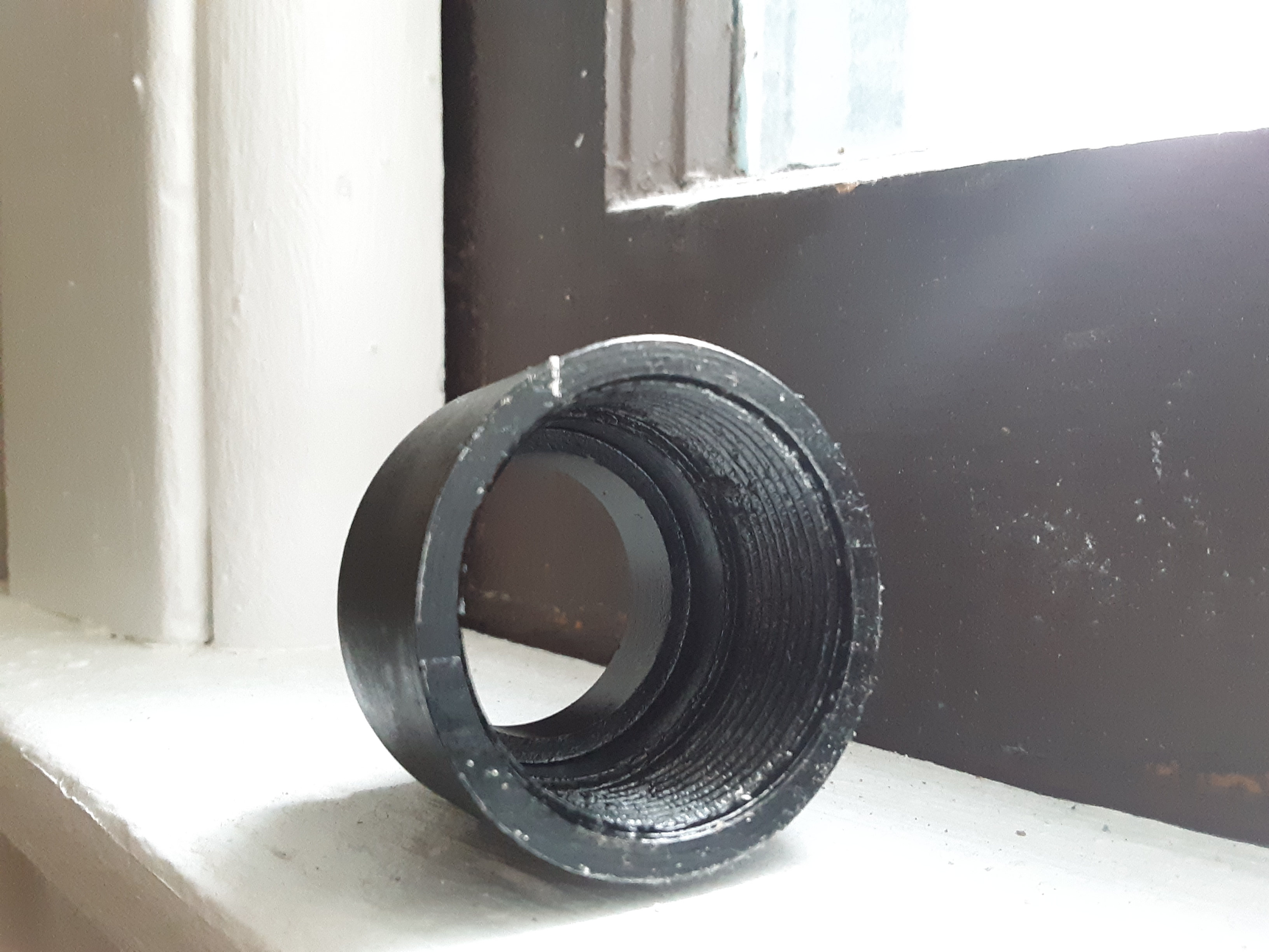

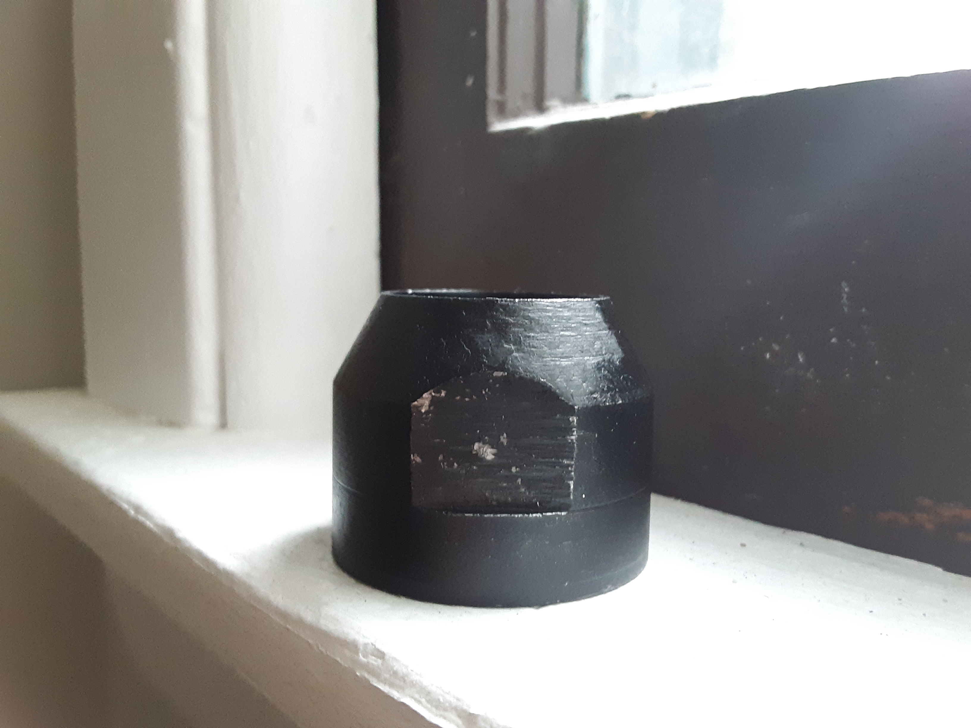

I'll measure up my barrel nut asap
40 mm diameter at the base
32.3 mm inside diameter (technically including the height of the threads, I can't measure to the base of the threads)
Most of the inside is the base of the threads but there is a step after that raises up to a little more than the height of the threads __^_^_^_I
Then after that there is the reduced section
26.4 mm inside diameter
It is 9 mm in from the tip of the nut, or in other words, it's 9 mm long and goes all the way to the front
i'll doodle it
Thanks so much for that!!! (I hope you are feeling better, BTW)
Those measurements were SUPER helpful, but I'm afraid I've come to a bad conclusion. I think they machined their own barrel nut.

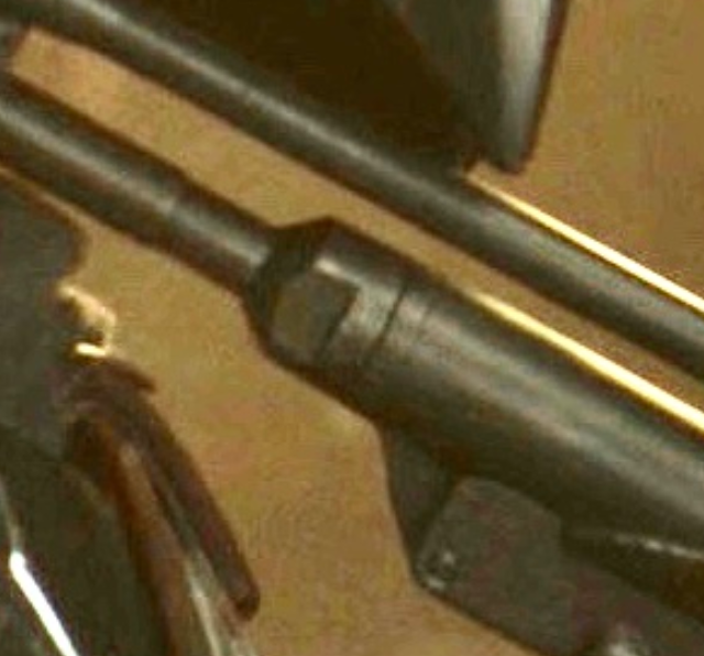

I work in a photogrammetry environment for a living and I realize that we don't have focal lengths for any of the photos online or screen captures, so it's impossible to know for certain, but I've taken 4K screen captures of the episodes along with pretty much every "near orthogonal" view of a Sedgley flair gun that I can find. I've done measurements in photoshop and compared the ratios of the lengths of parts and as best as I can tell, the MP40 barrel nut, which should be 40mm in diameter, is coming in more like 32mm on the screen used blaster.
If the barrel nut were indeed 40mm, that would make the entire pistol approximately 415mm in length. I did a test 3D print of the grip at that size and ended up stopping it. It looked REALLY big. Like not a pistol anymore but a hand cannon.

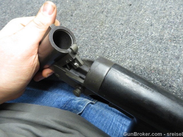

The barrel nut needs to have almost the same diameter as the barrel of the Sedgley, at the end that opens and takes the flare. As a sanity check I looked at this photo:
This is the Sedgley. It takes a 10 gauge flare cartridge. This cartridge has a bore diameter of 19.69mm, not including the lip at the end of the cartridge. Assuming maybe a 2mm lip at the end of the cartridge, measuring the ratios of the diameter of the hole and barrel, you again come in around 31 to 32mm.
Also, if you look at the photo near the beginning of this thread where he's holding the gun to Din's throat, the barrel nut looks pretty tiny compared to Din's helmet.
So my opinion is that they machined their own smaller MP40 looking barrel nut. :-(

So, this is interesting, maybe they took the idea of an MP41 barrel and made their own too. The sight just doesn't look like any airsoft or real sight hood out there
Editing this comment. the milled flats are HUGE compared to the rest of the nut which is not the same shape as an original
