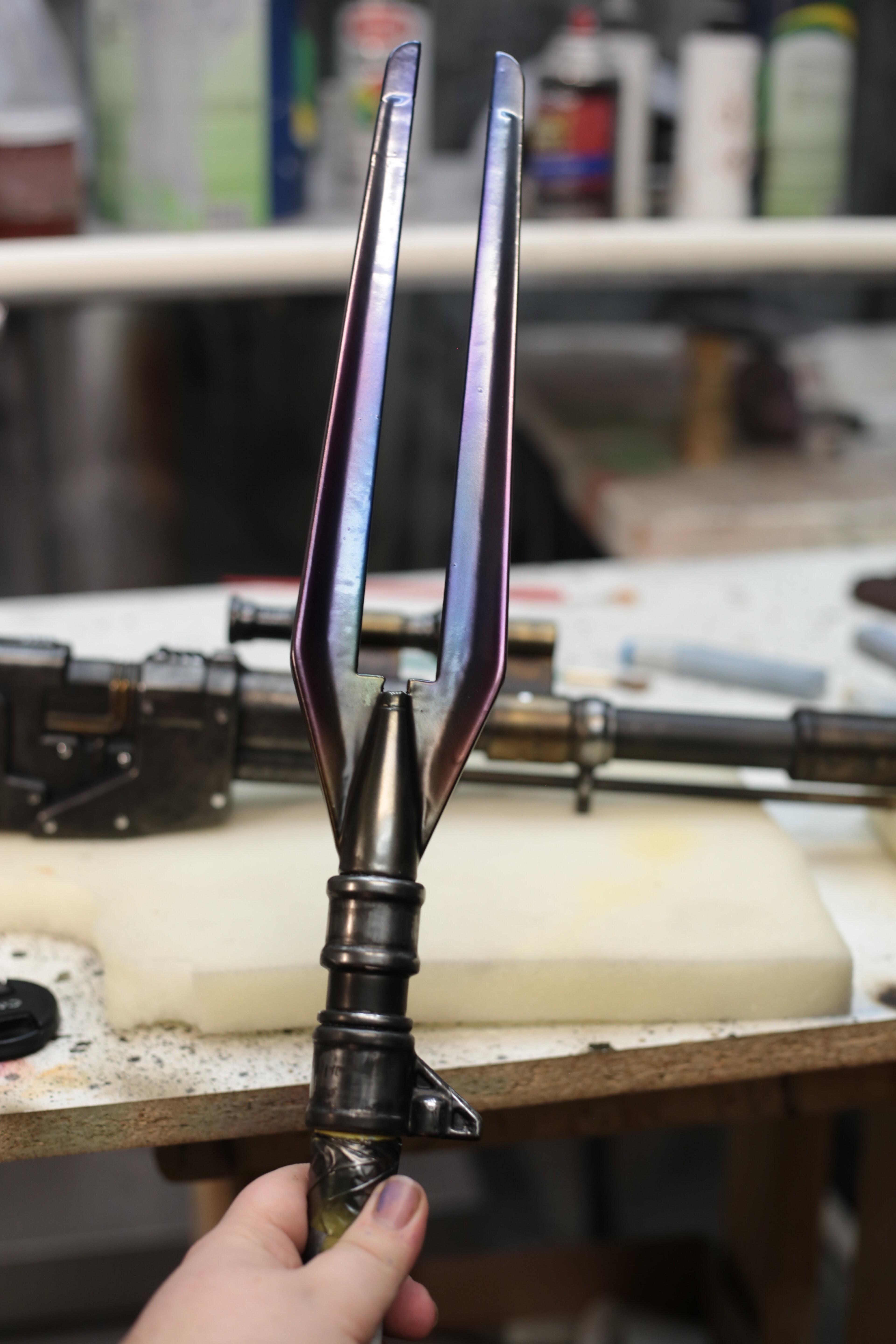

Today’s work was a Mandalorian Rifle. Thought I’d share as I’ve been posting my other work here anyways.
This is Rob Pauza’s file to the best of my knowledge. Painted with Alumaluster and Oils. Unfortunately this beast came to me all in one piece, barring the end. I had to drill a vise into my table to hold it and it ended up higher than my lights! It was a very interesting experience clear coating it on a step stool, haha

This looks INCREDIBLE. I want to work on the rifle so badly - but I convinced myself to do the Blaster first to ease into it. The heat-weathered prongs at the end look so good O_O

Yeah... These photos are going in my reference.
