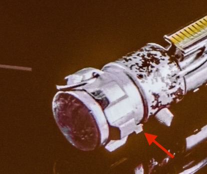

Can someone please repost the known photos of the mystery chunk if they have them saved? I'm trying to go back and find them but these threads are getting really big.
Re: Luke ROTJ V2 lightsaber- based on the new info from SWCA (UPDATE PG 12)
I've only read about it being mentioned by BAlinger15 , I haven't seen a clear photo of the chunk.
Edit: Here we go, it was in the V2 thread.
I based my known list on what I was told directly or can see for sure.
The chunk I was referring to is where we thought a filister screw went. Brandon said it was a chunk of aluminum and not a screw.

Is this it?
attachment.php

Casting sprue? I've seen reports that one or more of these things were cast aluminum, but :shrug:
I still wonder where the power cable exited the saber.
