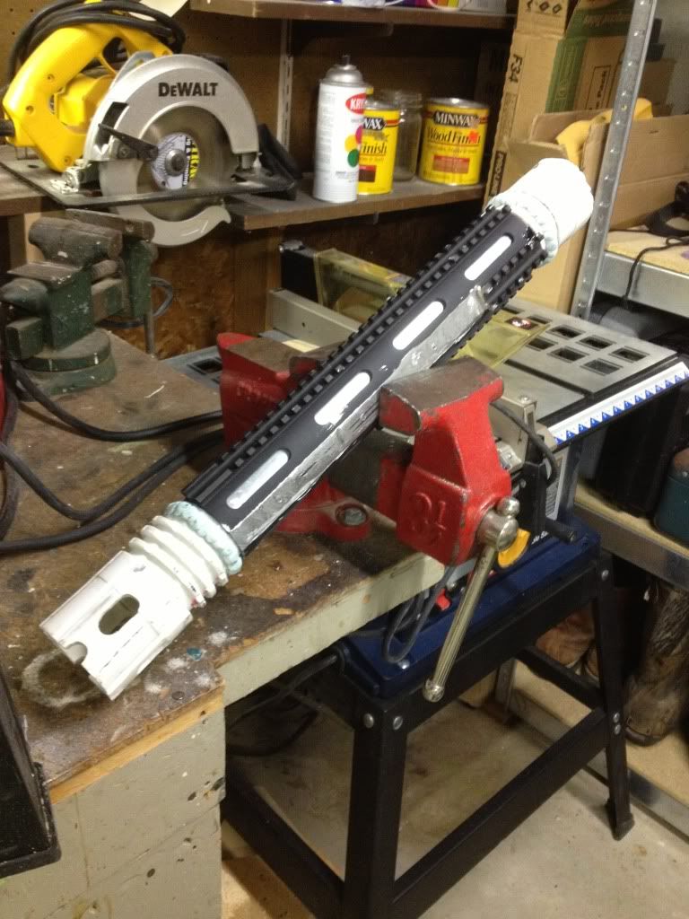

Worked my butt off today and got quite a bit done.

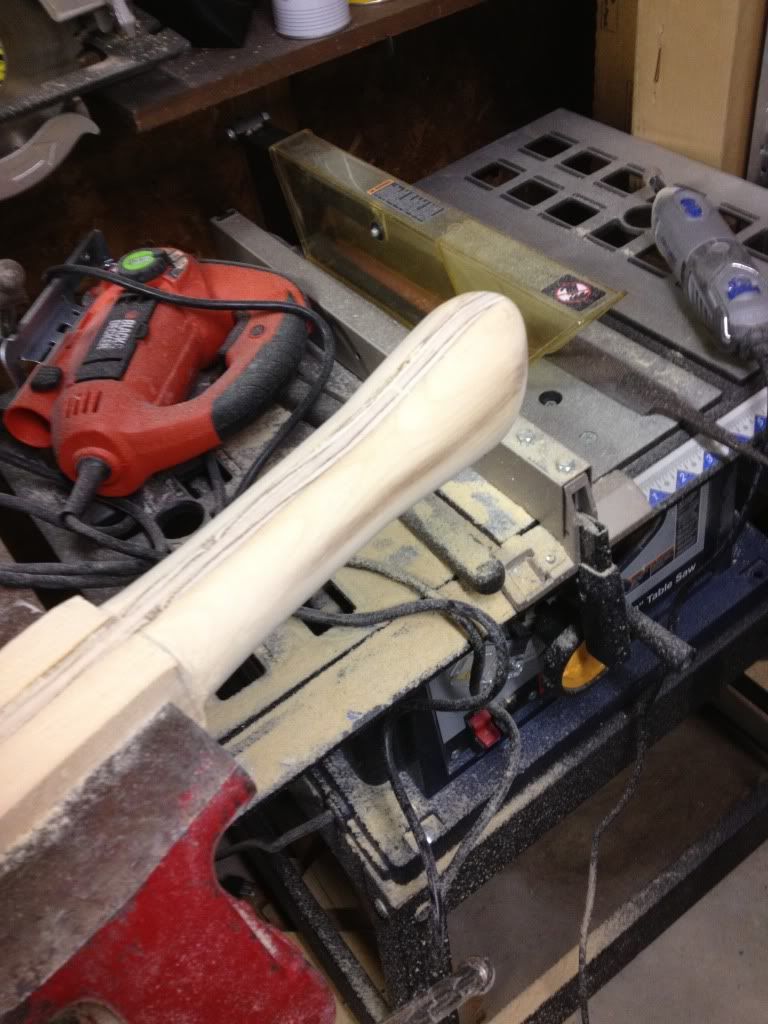

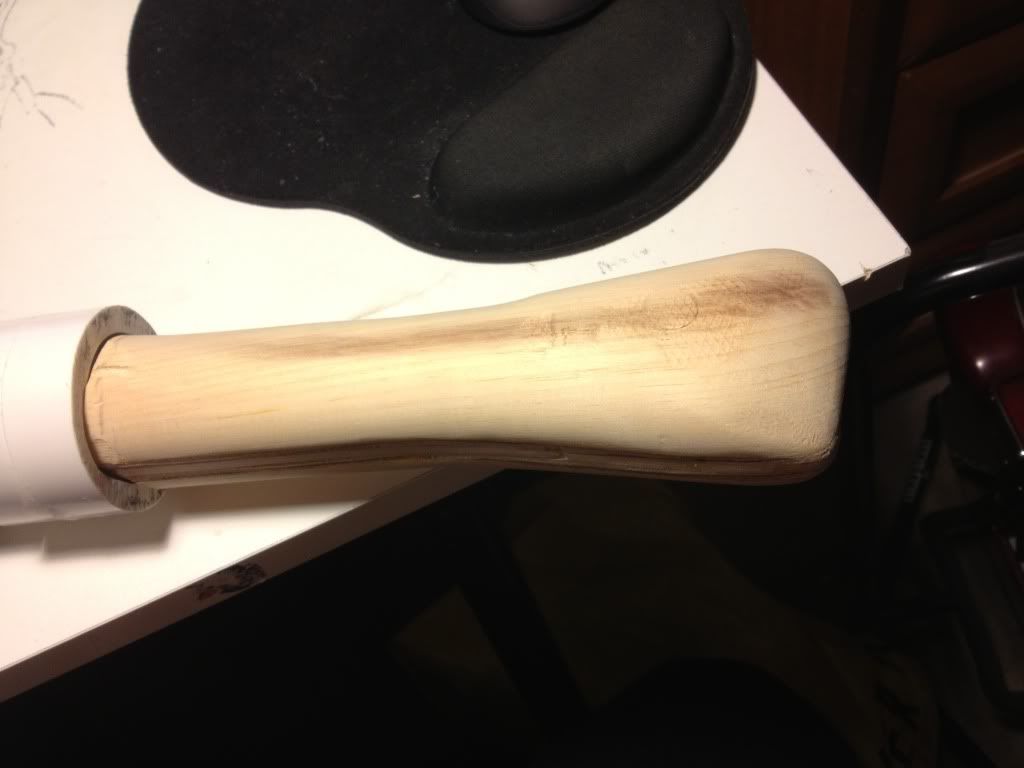

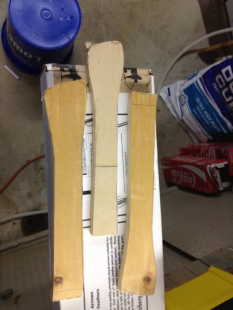

Used three layers for the grip.
Glued them together and sanded them for probably three hours straight...mostly with my bare hands and sandpaper.
I really like how the grip turned out. It sits flush with the PVC coupler too.

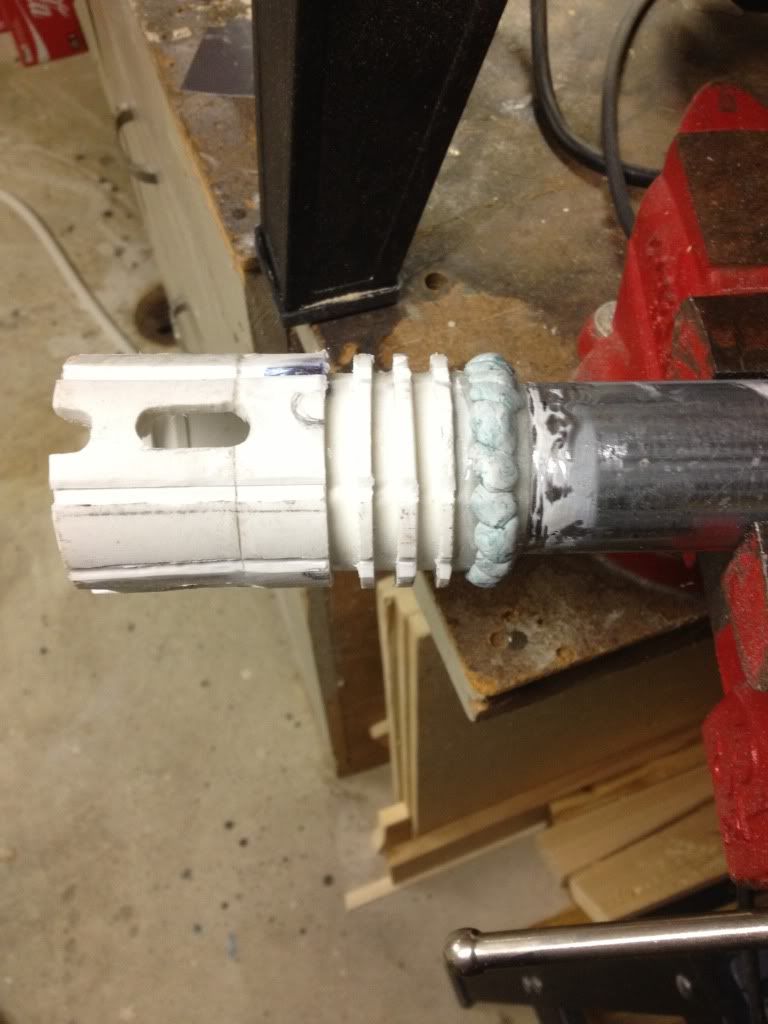

Then I etched straight lines on the front endcap with the tablesaw. That made me super nervous, but it worked pretty well. Still have to sand them down.
I got the back endcap pieces cut as well. All in all, it's turning out okay.
(Sorry for the crappy picture quality, final pics will be taken with my canon t2i)

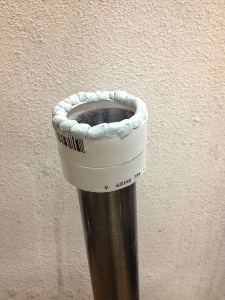

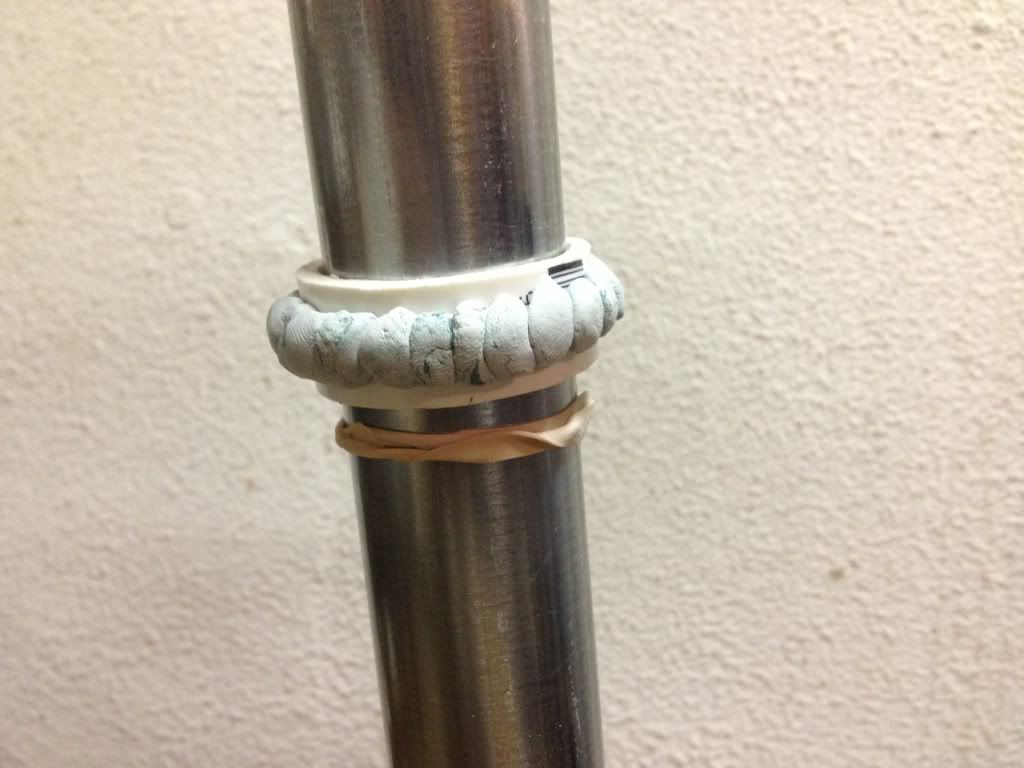

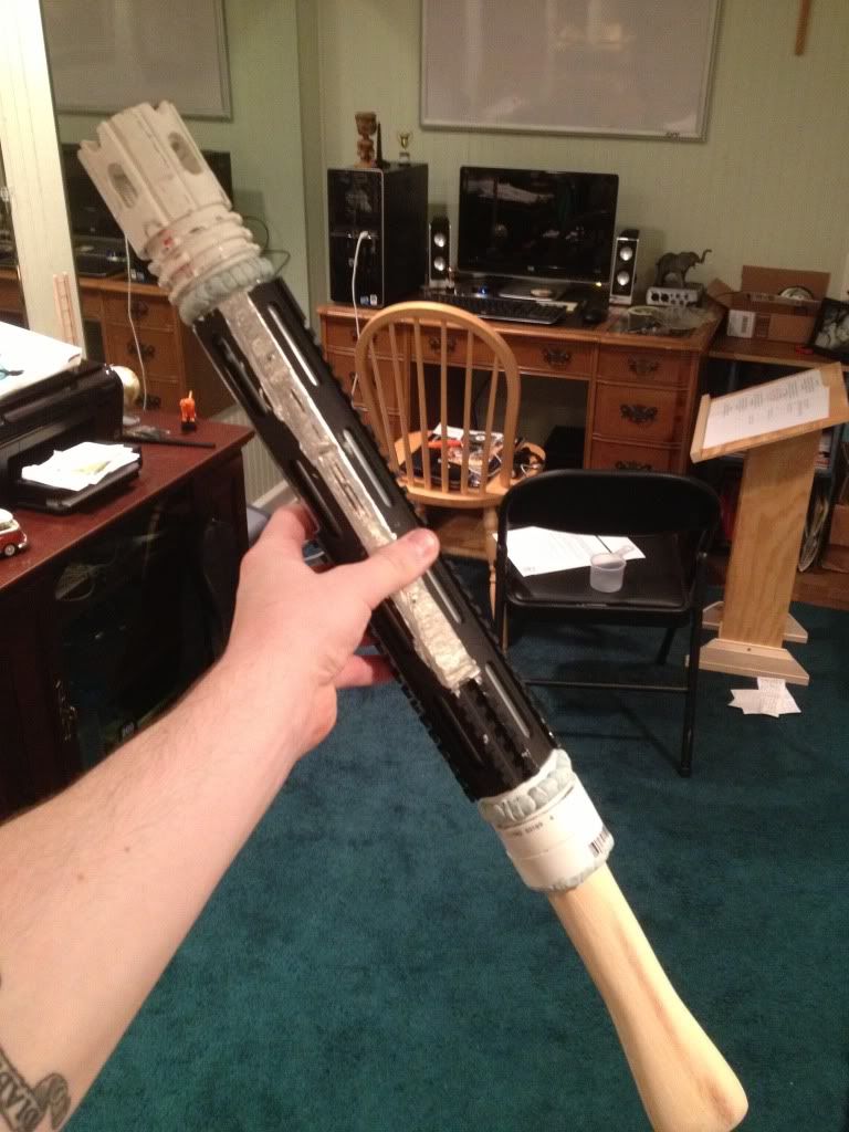

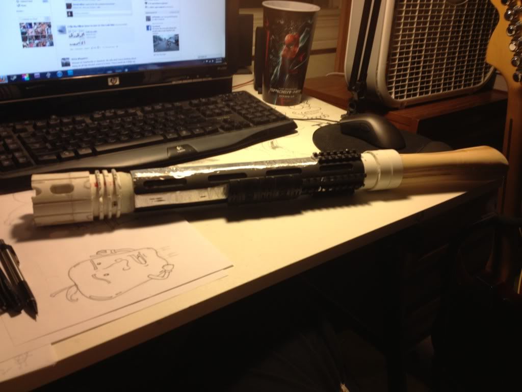

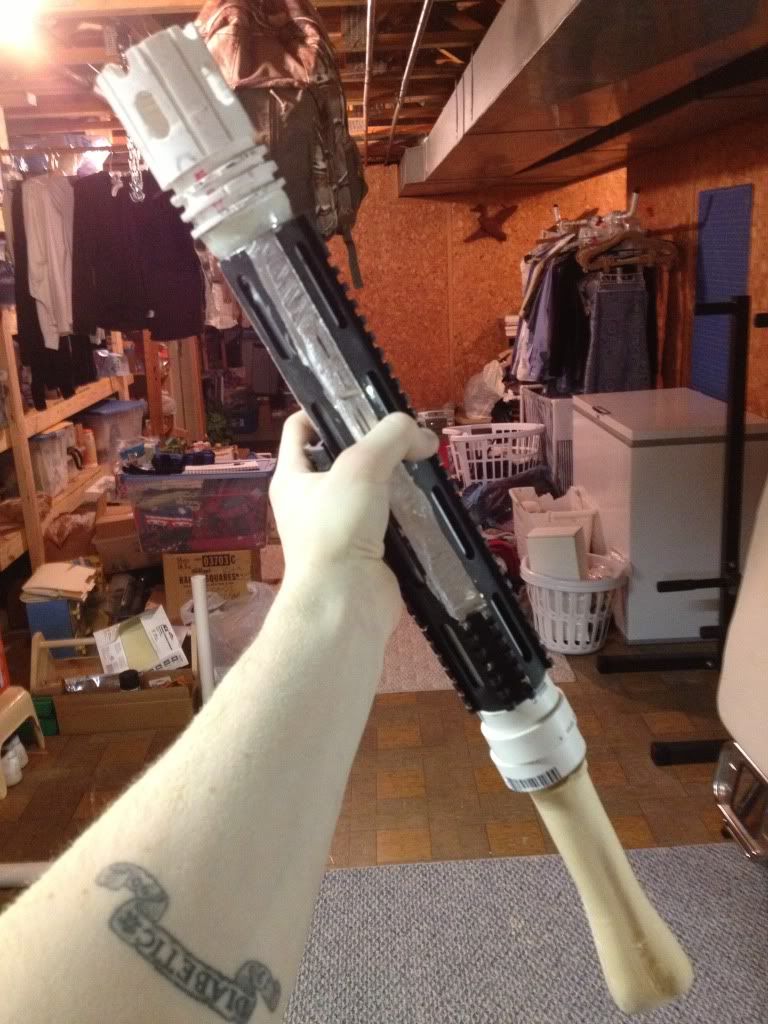

Few updates dudes!
Made the fake weld lines out of plumbers epoxy. They didn't turn out very pretty, but this entire build has been a little less than perfect anyhow, haha.
Attached the rear endcaps and inner tube do the handguard. There's no turning back now.
Here it is almost ready for a first coat of primer.

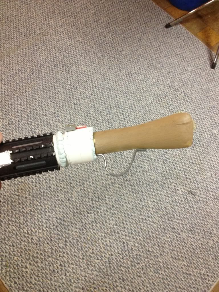

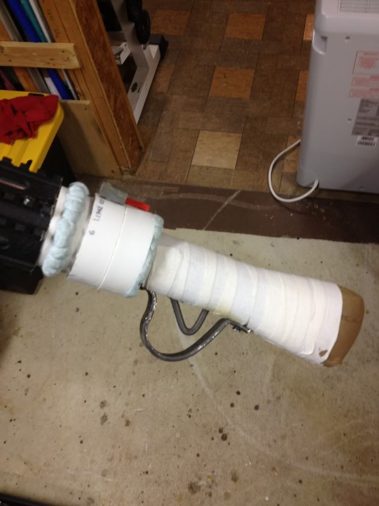

I have some UPDATES for you fine fellows!

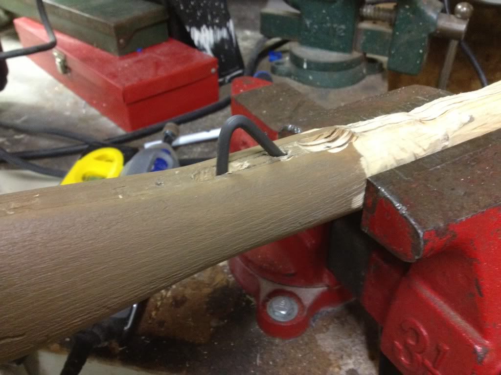

I worked on the grip for about four hours today and I'm extremely happy with the results. The wood grip went from being probably the worst looking piece to the best, IMO.
I reshaped it and then spent about two hours bending the metal to shape to act as the triggerguard. Also painted on a few layers of Nutmeg colored paint.
Then I spent about ten minutes shaping the trigger itself. I drilled a few holes and secured it with wood glue.
I then wrapped the grip in hockey tape and screwed on the triggergaurd.

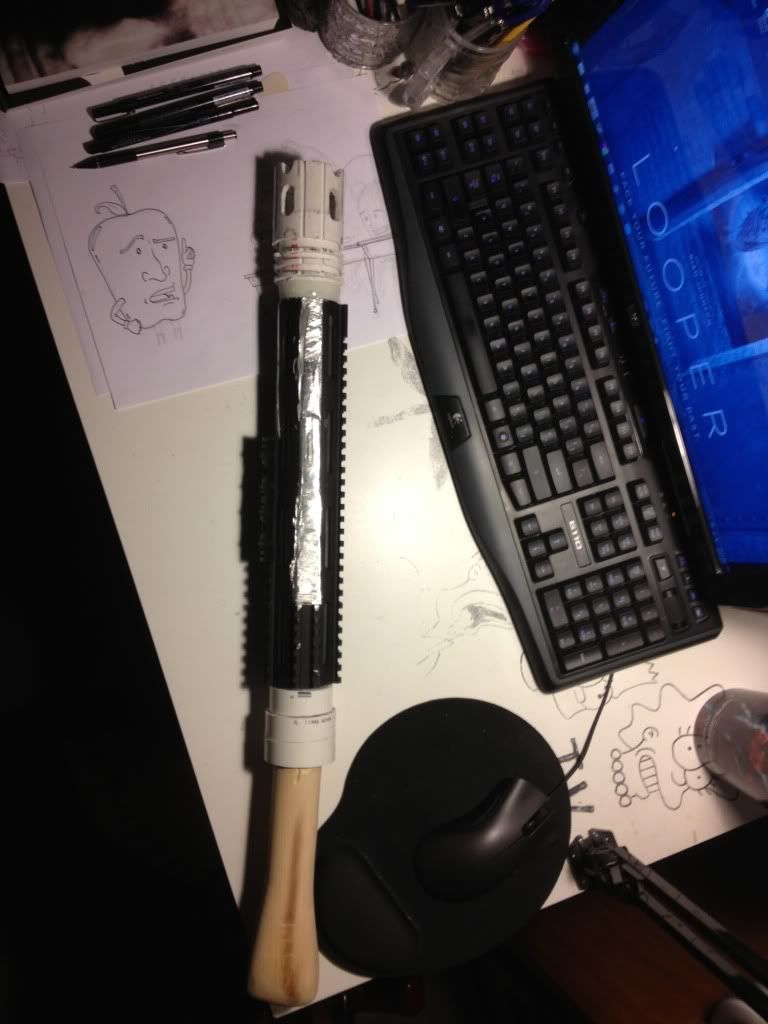

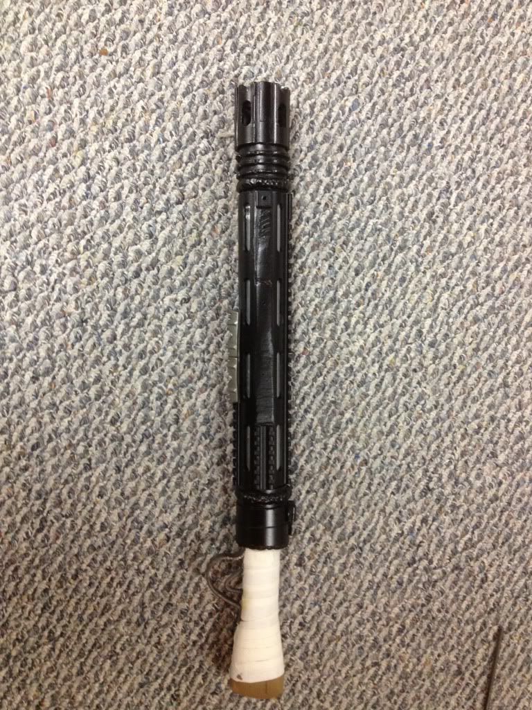

More major UPDATES!
The blunderbuss is about 90% complete!
I still have to add all the detailing and clear coat. Also have to add the screws and such to the grips. Need to fill in the "UTG" logos on the slide as well and repaint, oops.

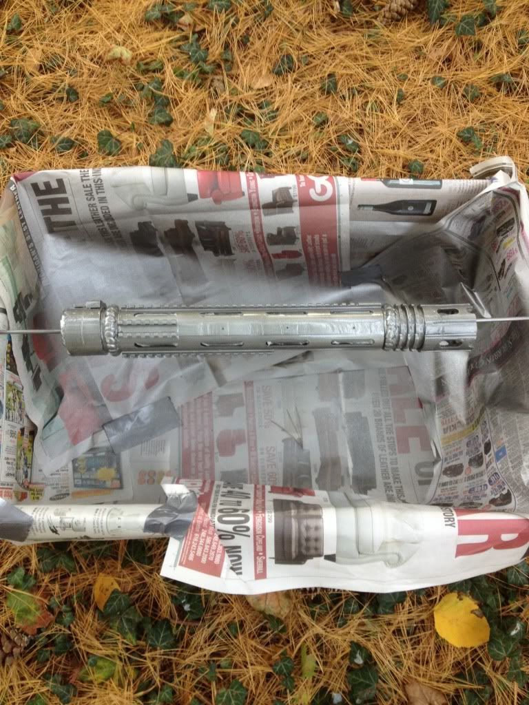

Here it is with a coat of primer.
And the first coat of textured flat black. Also added the little square tabs to the front just before the front endcap.
Here it is with the grip frame plugged into the back.
Actually pretty happy with how it's turning out so far...minus the few inadequacies.
