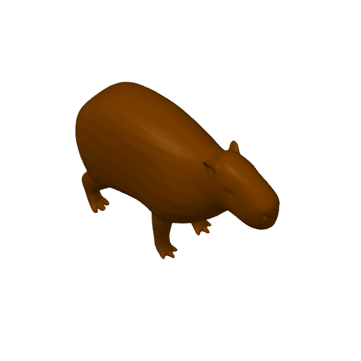

That's a good point another thought was that sometimes I print direct from the Bambu Studio app on my phone which is a pretty much click and go experience where my computer has much more control and ability to check the bed adding multi pieces to the table etc...
The xeno print was printed via computer and had no issues and filled the whole plate, the capibara was printed using the phone app.
I will say the tree supports were crazy thin so maybe it needed thicker support they were prolly 1-5 mm in places.

In this specific failure we have a non bridge. This floating section is attempting to print the belly attached to nothing at all where a bridge means horizontally attaching items. This scenario is failing to create a support structure underneath the belly (pieces that will not be part of the final print) in a correct way. It could be a coincidence and simply be bad codinging coming from the phone app, which IS entirely possible but having the settings for the trees a little funky could do the same. I believe that there are 3 settings we need to check due to the tornado/vortex shape that need to be created in the tree structure. The x-y distance between the supports and the print, the distance between the supports and the objects touching the bed plate and the "top z"distance which should not be more than 2.5 in our current print.
I would suggest lowering the numbers in all 3 settings to allow the trees to be larger and stronger. But also, in the slicer it should sllow you to view layer by layer as it builds and check to see if the trees have an obvious failure likely.
I really think this will come down to the numbers currently set are forcing the trees to a non existent central support point. Because there are 4 legs and if the settings tell the trees to be too far away from print parts during their rise, it might be strangling the trees to a miniscule stalk half way up. This is easy to then knock over with the print head before it ever gets to the belly.

I checked and Loaded the print from the laptop and the tree settings had changed I guess it's the model makers pre sets?
Tree was usual but instead of Auto it came up with something else which I've completely forgotten as I type this..
The Trees were super small on this print plus something Taz said earlier reminded me that instead of being central it printed bottom left of plate and kept cleaning nosel, maybe this affects the print due to traveling distance on such a small model?
I think I'm going to draw a line under this it's not an important print just something for my daughter but there are others available.
I re printed yesterday via the laptop, I centralised the print and rotated it to see if there was less travel and..
It came out the same.
The top of the tree looks too thin and also thinking back to my chrome casting days think it needs more Spru/trees..
I printed other things since and they are perfect!
