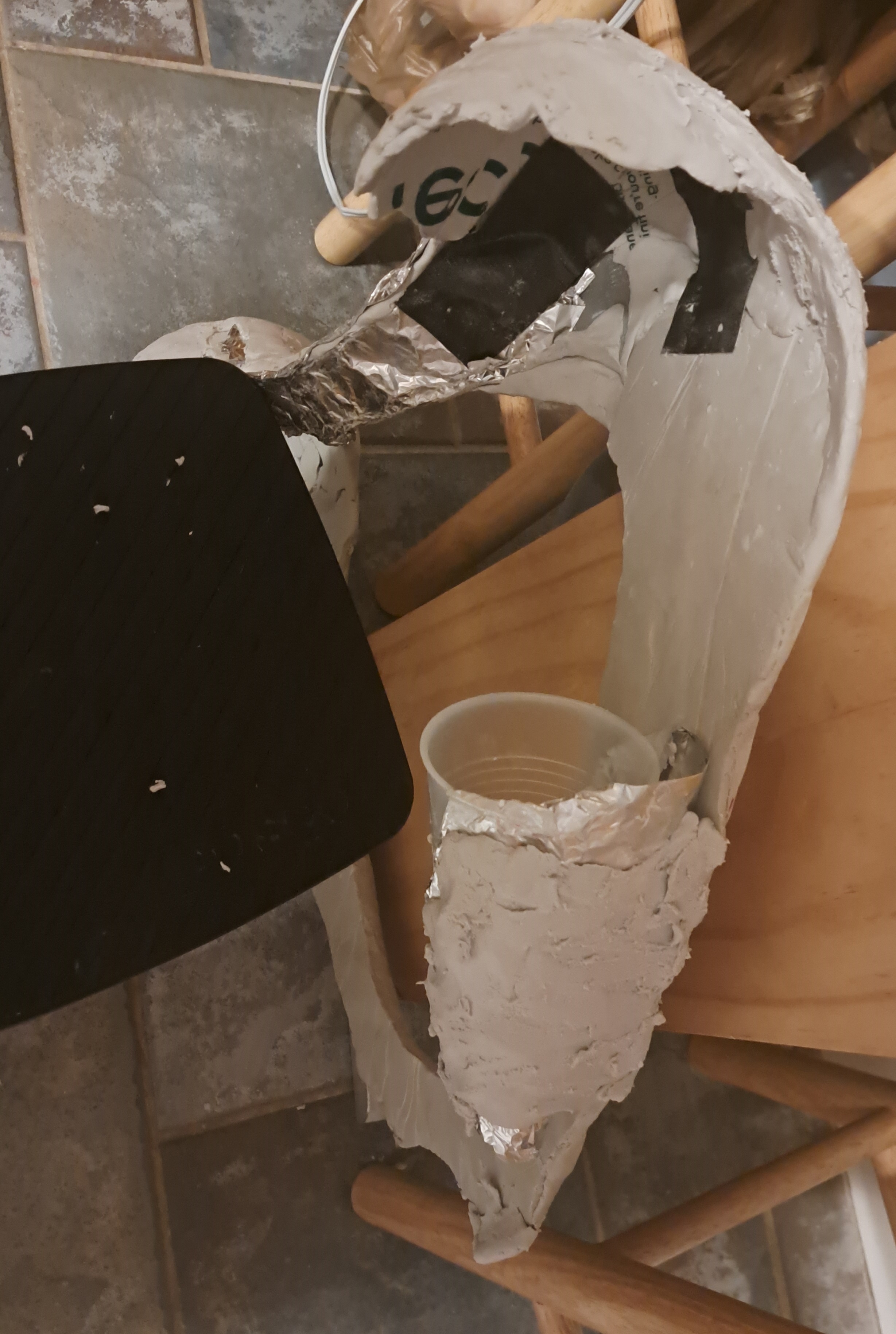

I used drink cups for the rounding support on the sides. Once I have an anchor on the sides for the curve, I can tape aluminum to bridge the rest of it over.

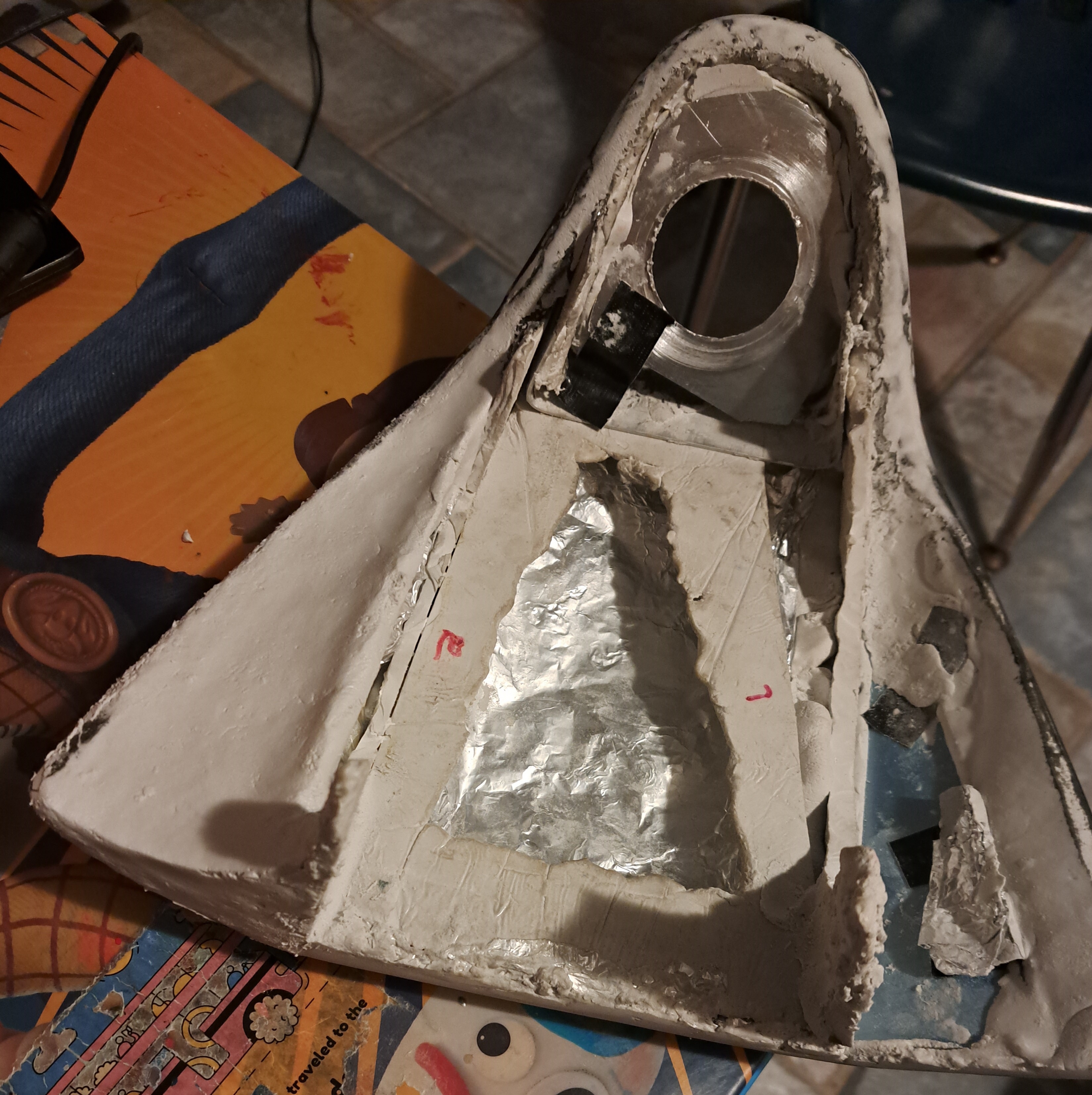

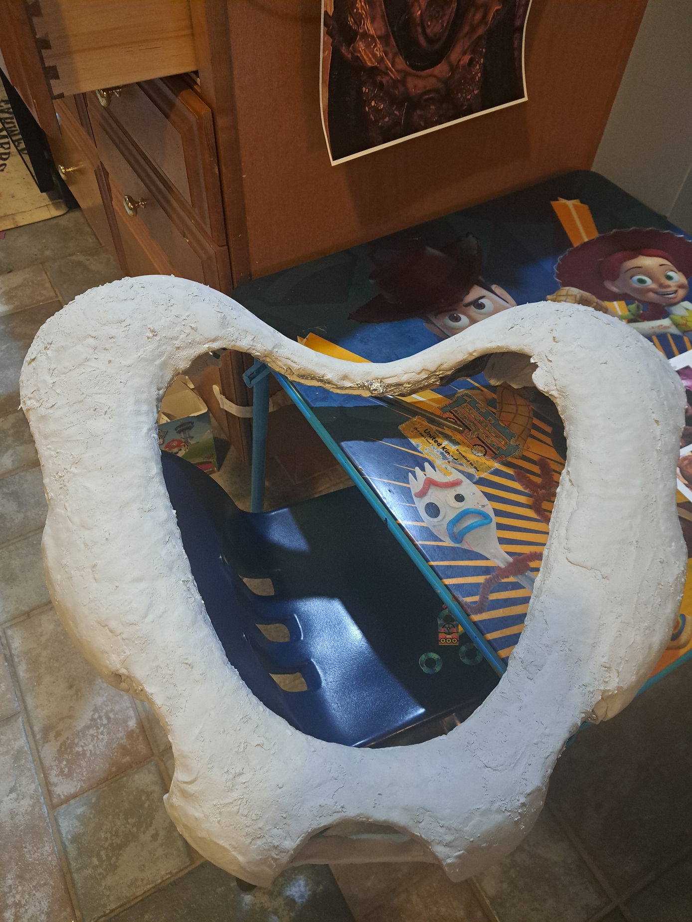

Secretly I have been adding more n more to the body to make it rounded. Now that I have the side cup/support areas I can work on a true 3D model. The pic I used was at an angle, so recreate the angle, and then round everything off

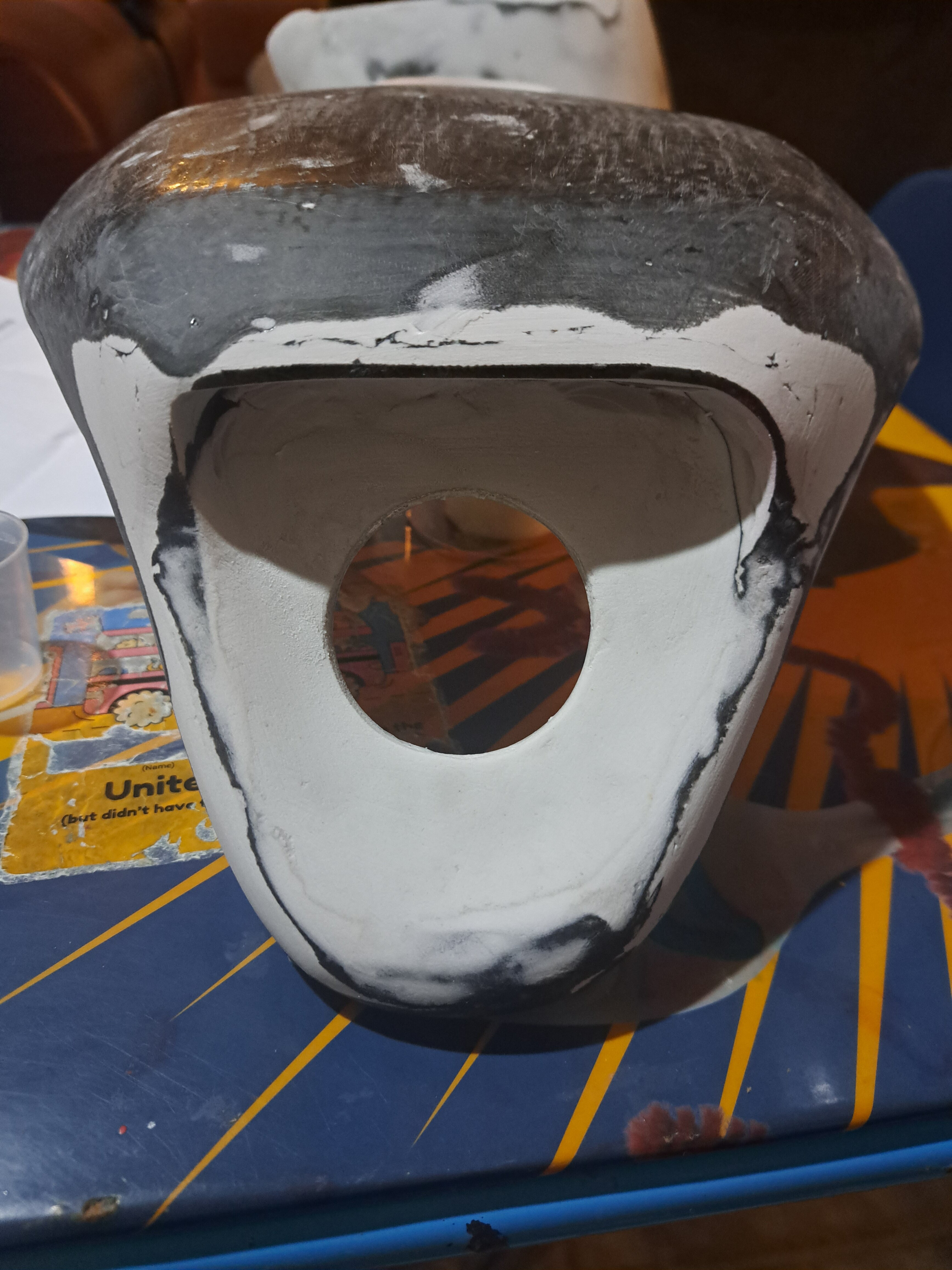

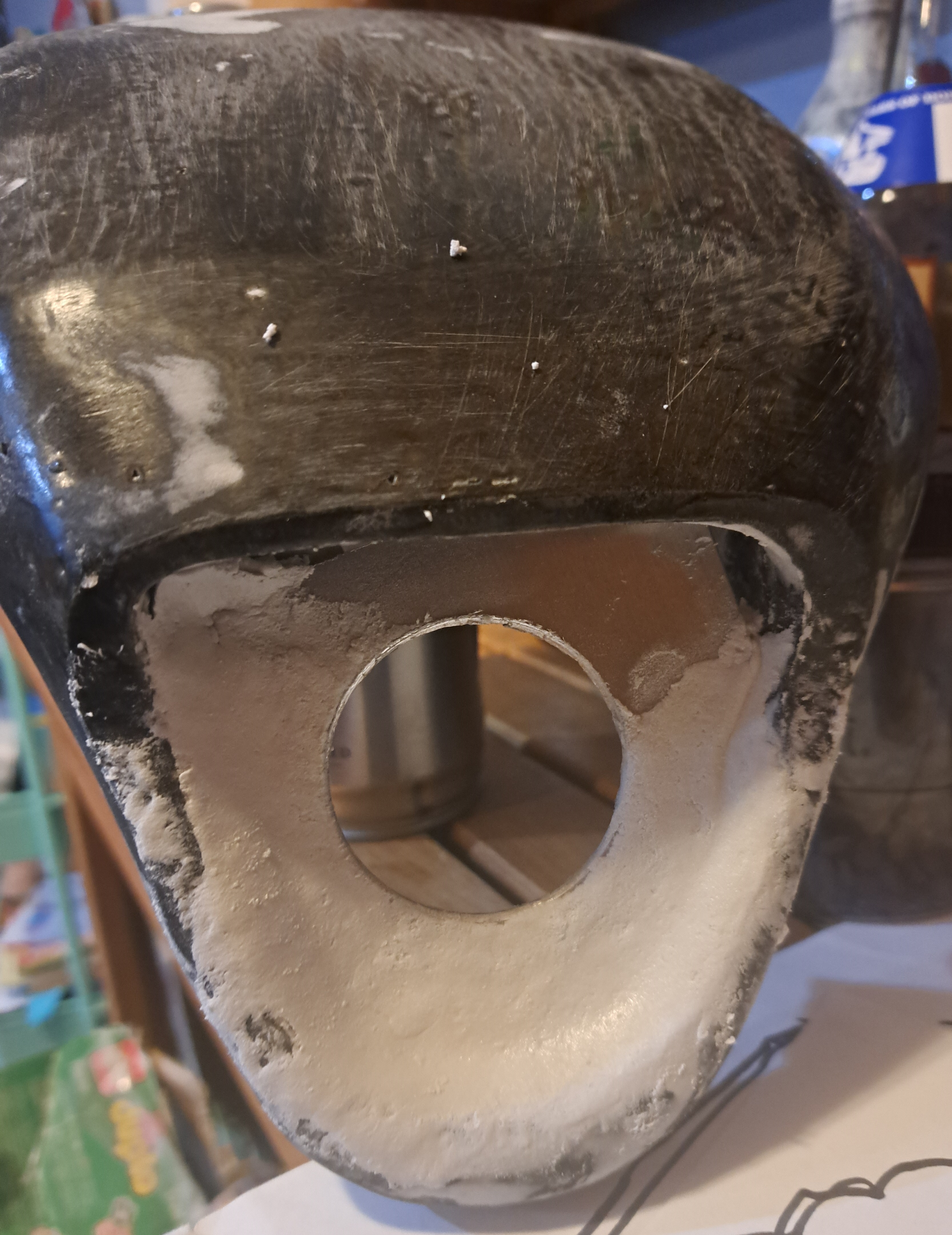

The head piece and fun with a hole saw for the eye.
Then make the hole saw eye piece part o da FACE!!!
Now Kosh can ask, "who are you?"
who-who, who-who?

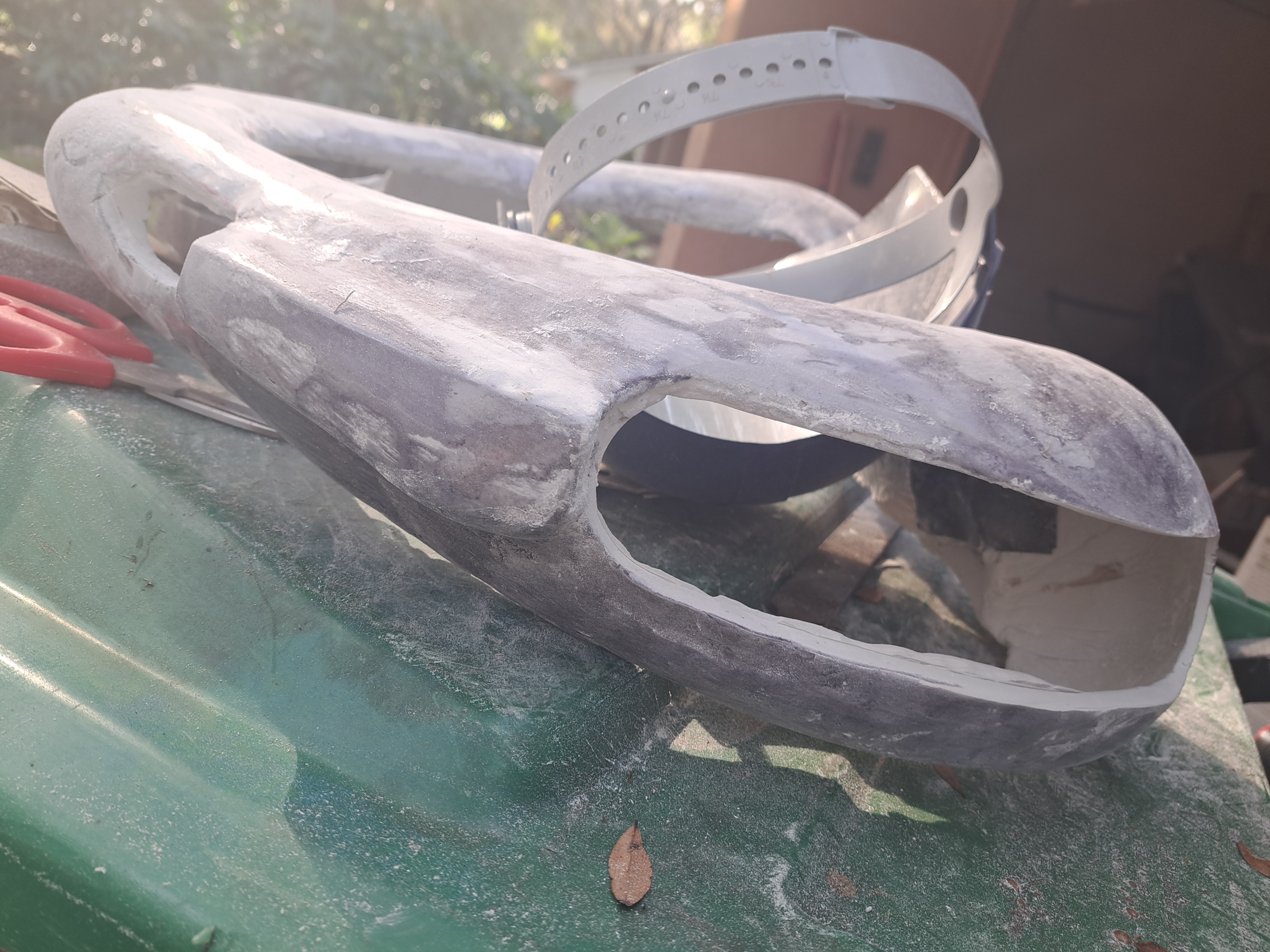

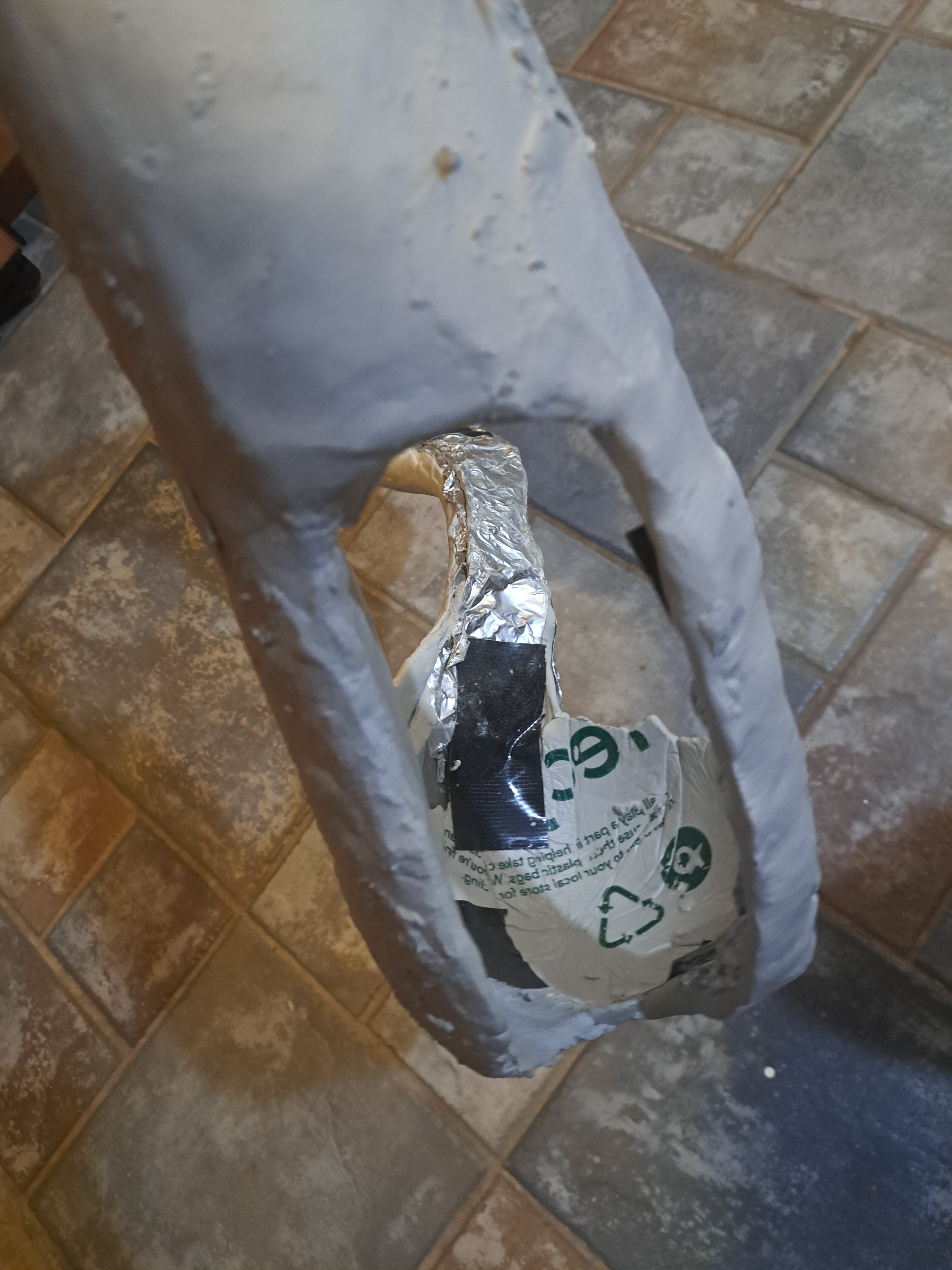

Used foil and stirrers to bridge gaps between sections and meet where I placed a plastic cup.
You can see the ink from the plastic bag that was the protective layer between FreeFormAir and the 5" ball I used to make the shoulders. I guess the bag's creators wanted them to leave a lasting impression on anything they touched. ;P
Kosh lookin more like Kosh.
Also, RedBulled to the bottom of the helmet where the aluminum was, I gave it wings
more terrible puns to follow

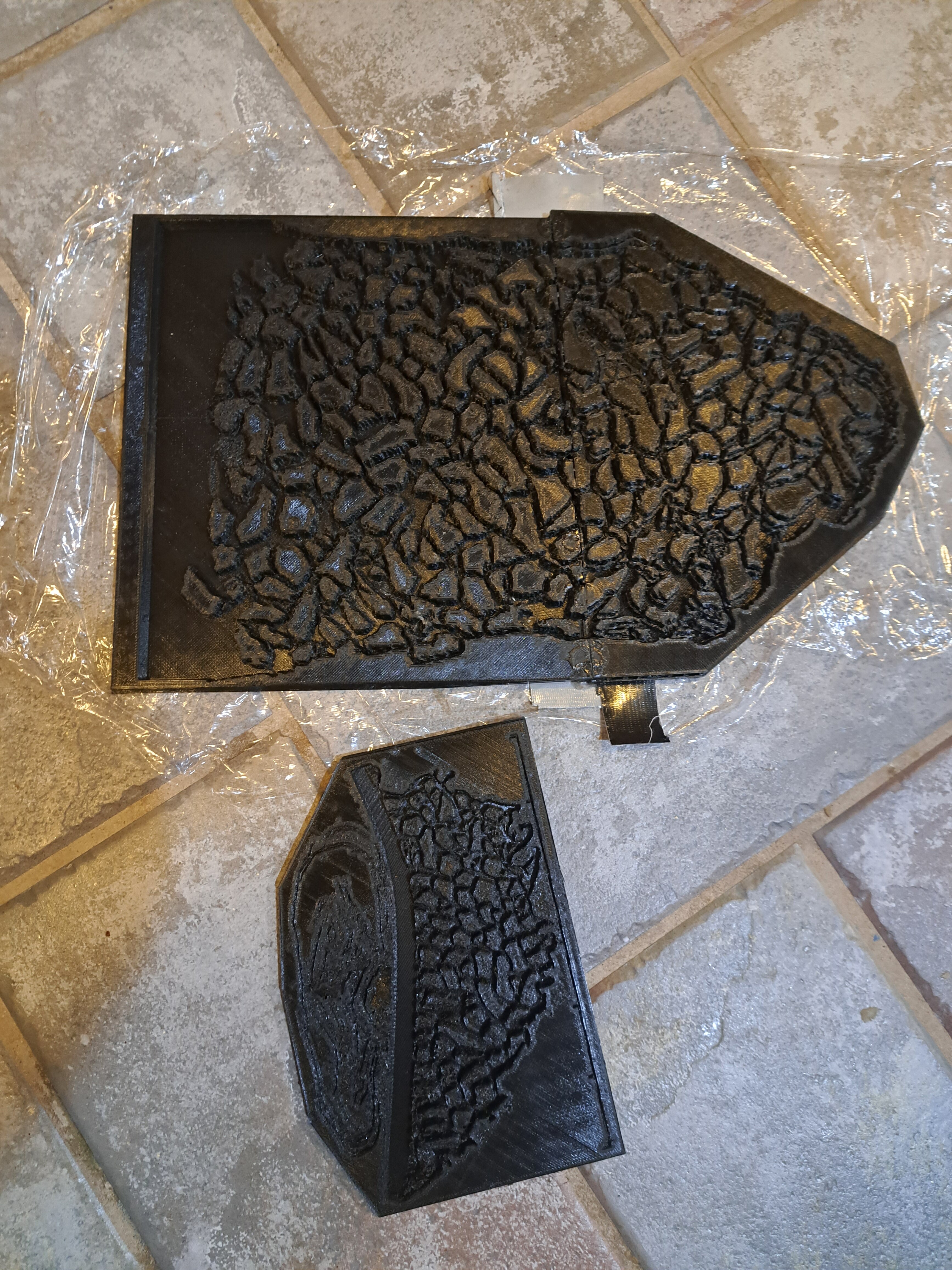

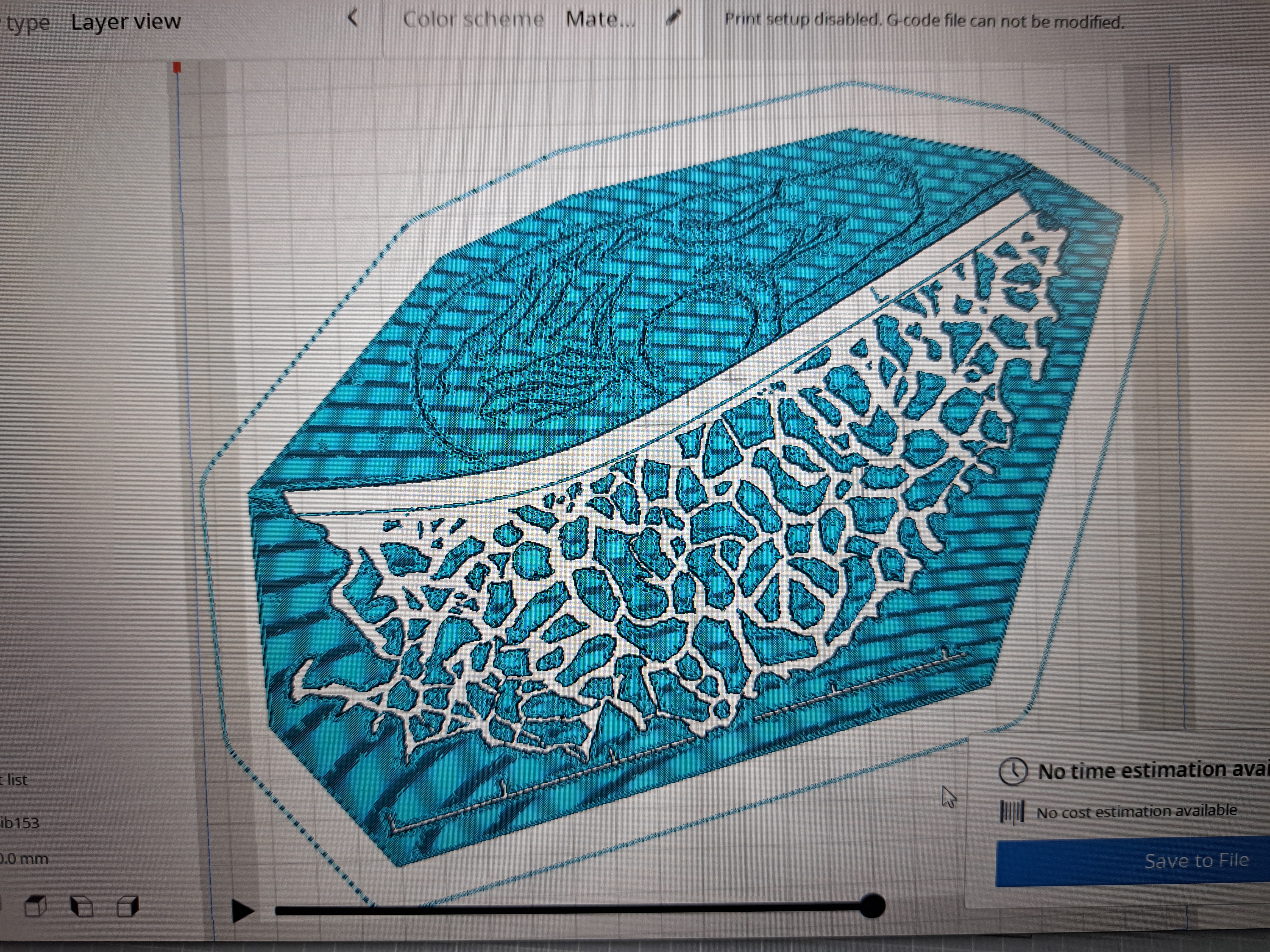

What ever happened to that crazy blackening out details for a 3D print ?
Just clean em up. Put some xtc 3D on them so the casting material doesnt get stuck in them, and I will have perfect stained glass

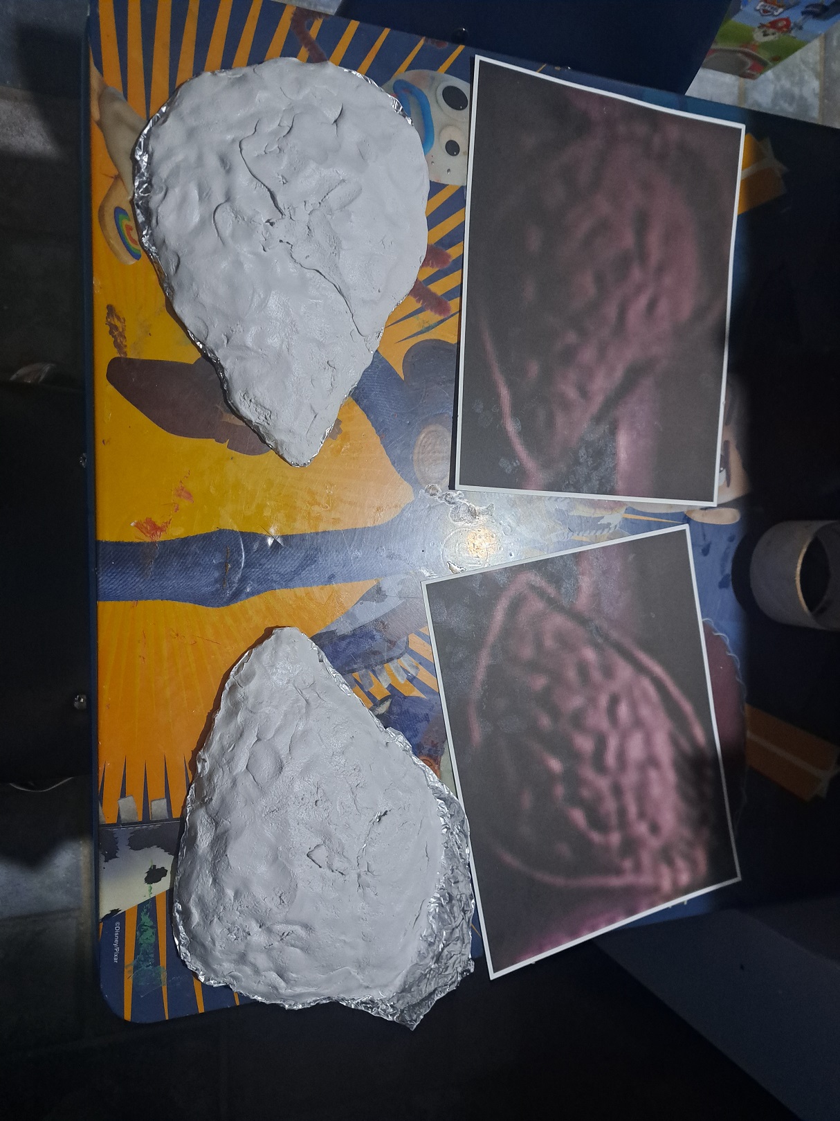

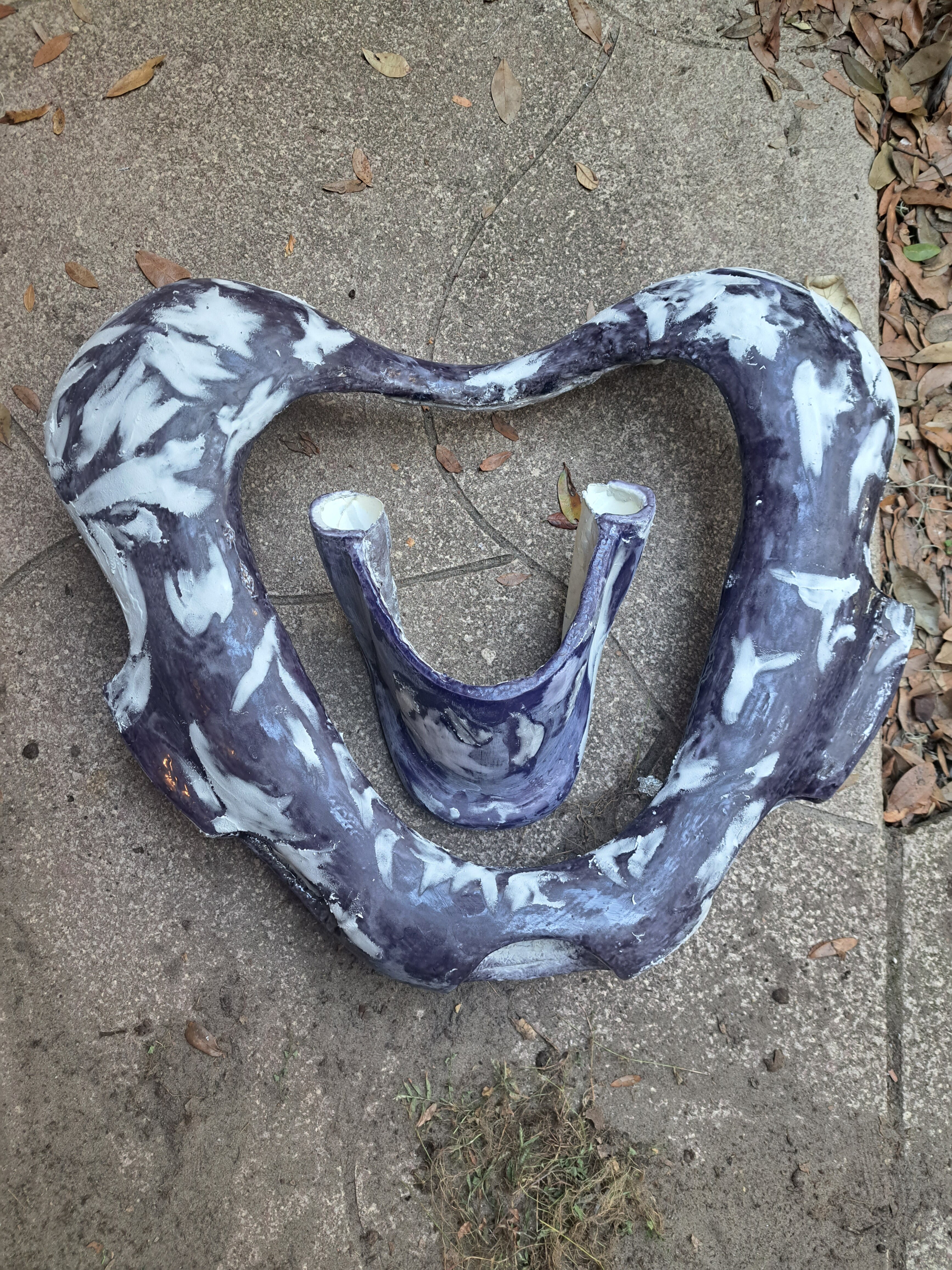

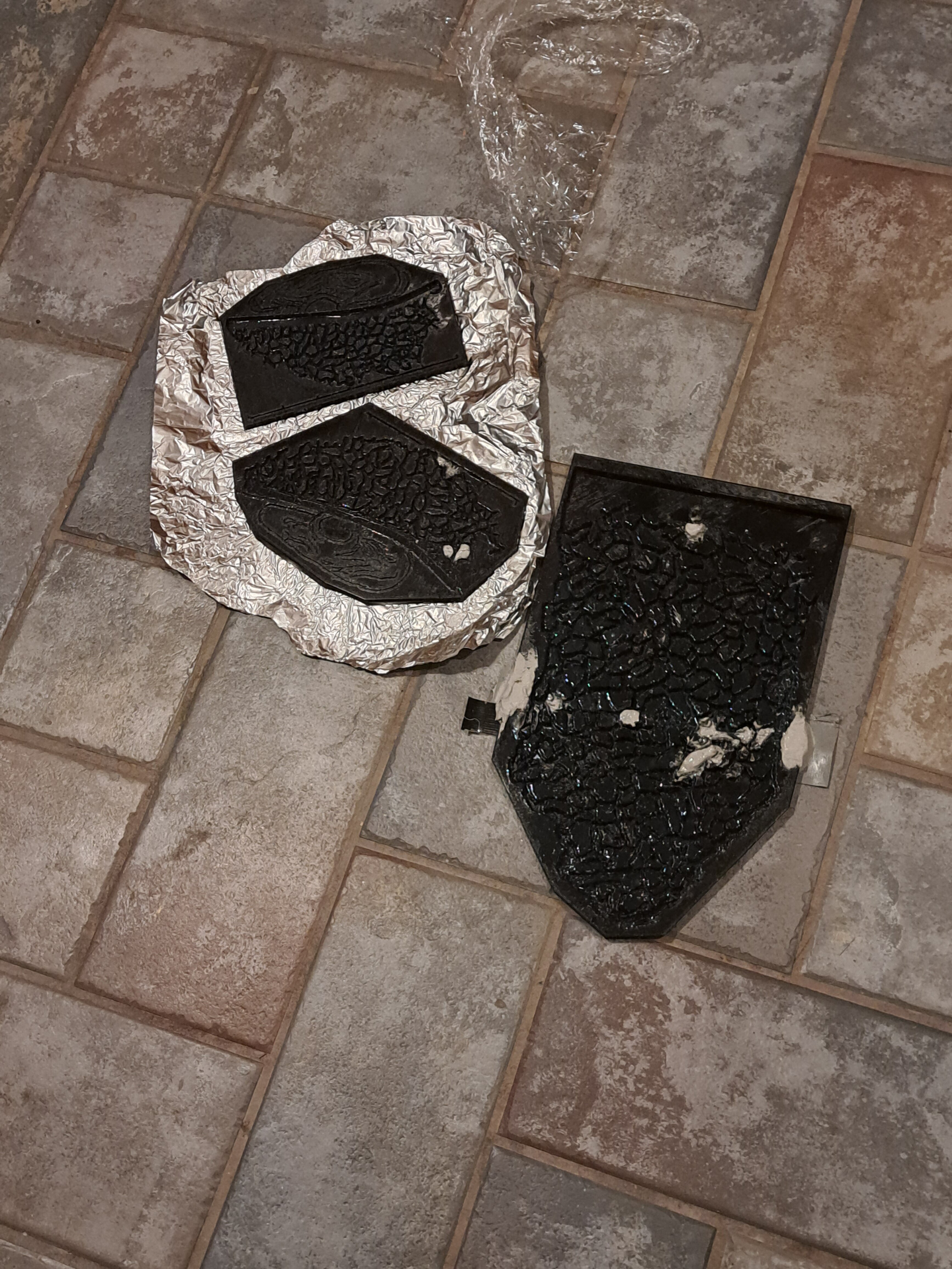

Broke down and did the left bib.
Originall was just gonna do two right bibs (one mirror image) but Dark Pope has a perfect shotbof the clearly larger left Bib.
Coated the bibs with xtc 3d. Couple of reasons why:
To make it stronger.
Less nooks and ridges to grab onto when demolding. I still want ridges and nooks, but no enough to tear it apart while de-molding.
I have also been purdy-ing up the other parts.

New part designation, the back pieces will be called "Scapulas' or "scaps."

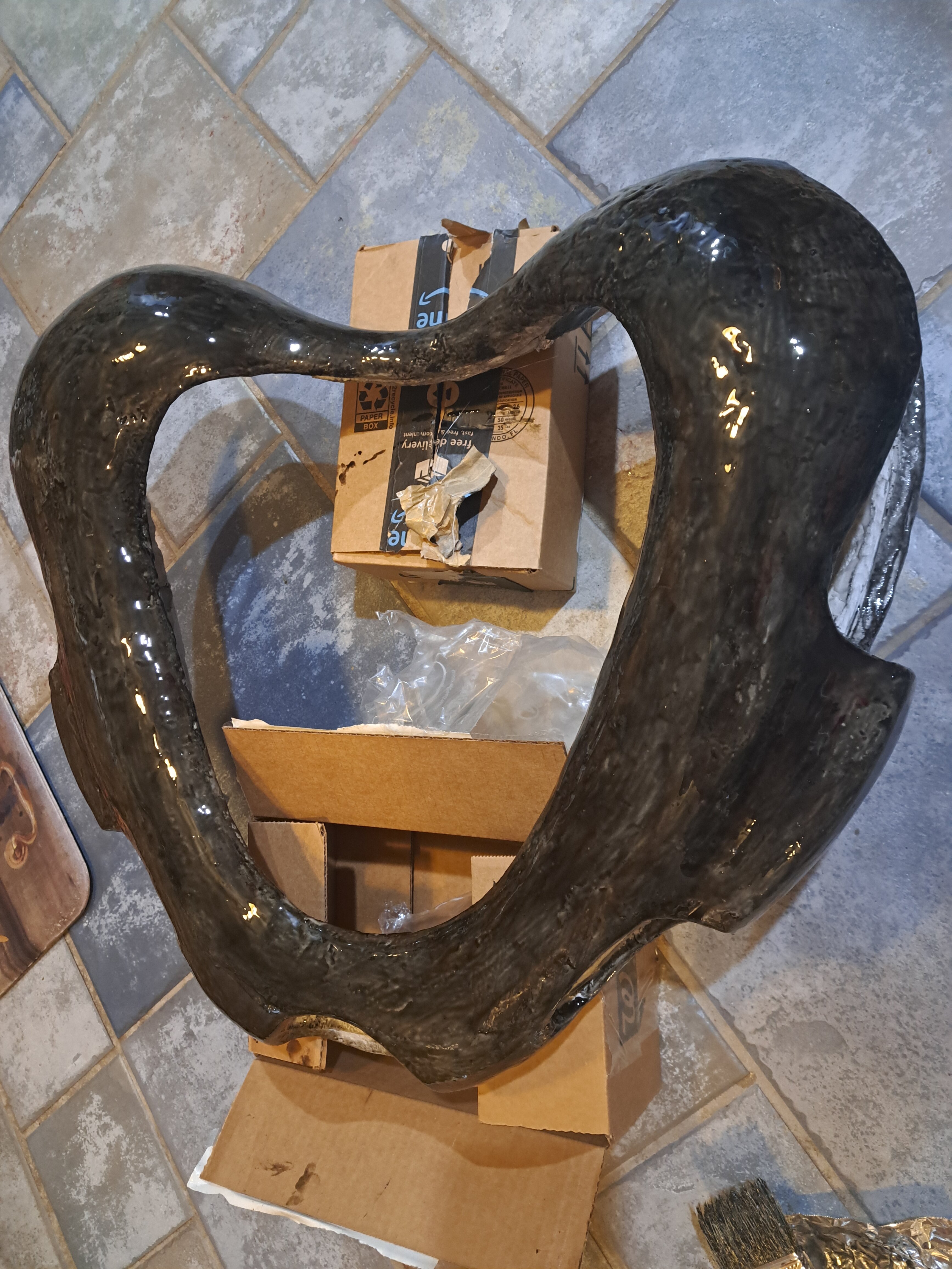

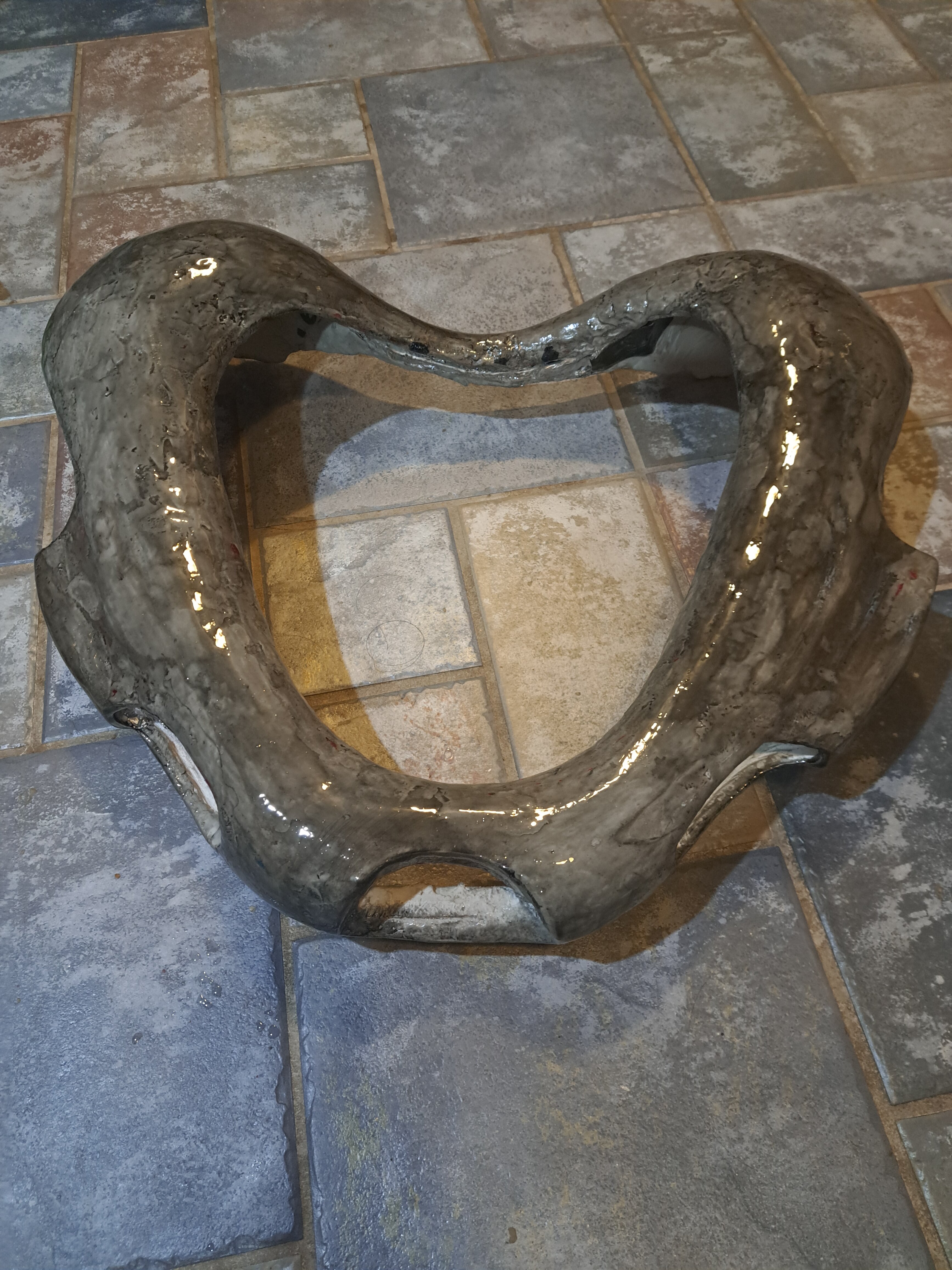

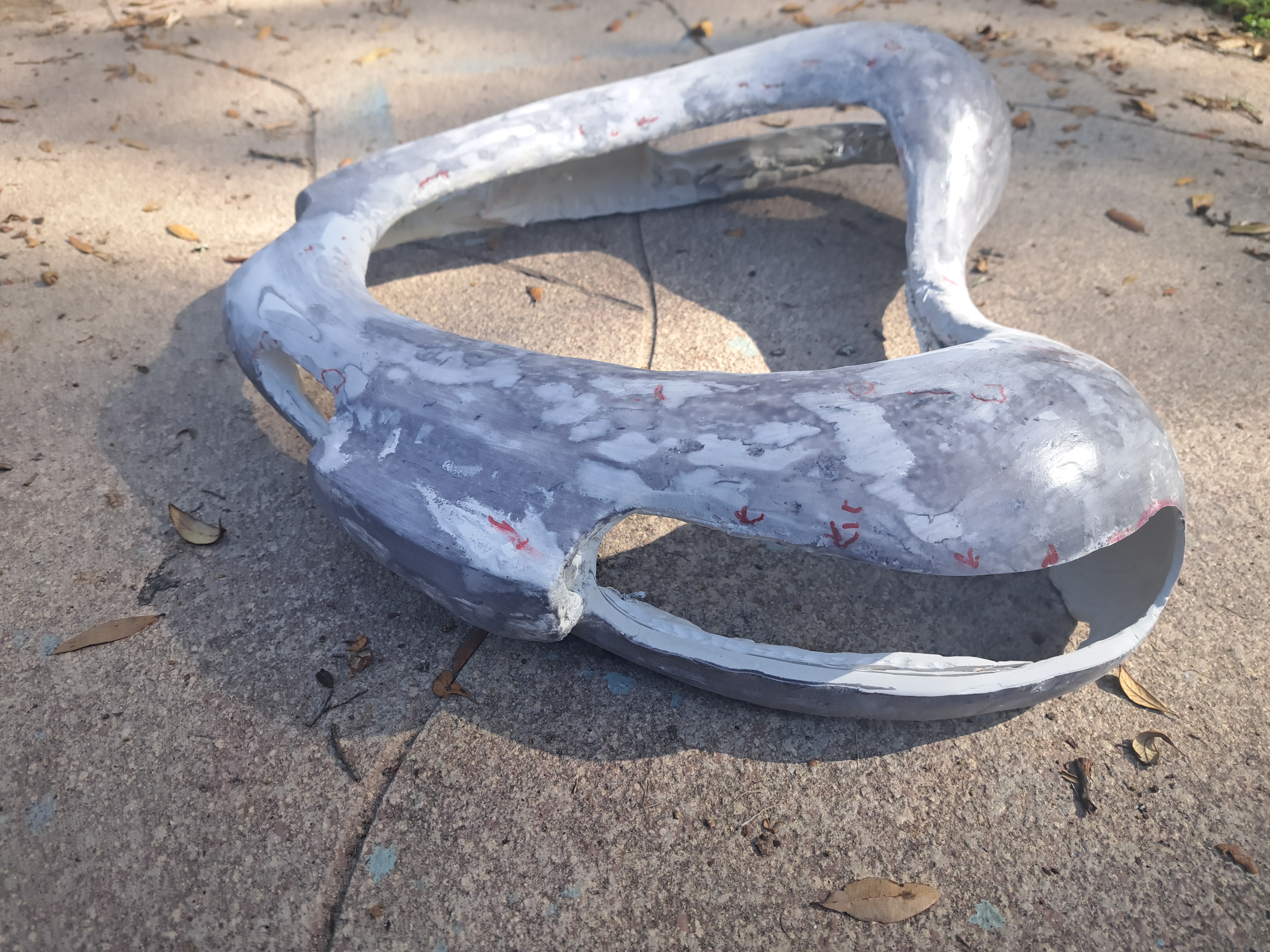

Spent the past few days reviewing reference pics and trying to make things slightly above the projected 37% accuracy.
Fighting the urge for perfect copy of asymetircal prop vs symmetry that seems pretty implied.

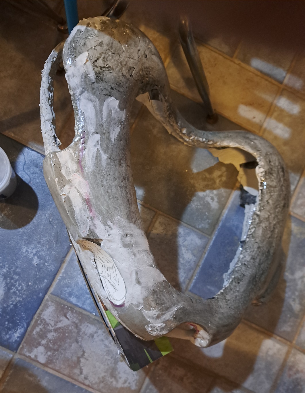

Lots of touchup. I like that I can sculpt with sanding, it is a slower process than clay, but with a rigid sculpt, I can sssllllooowwwllly cater it to the design I want. Harder to overshoot what you want.
I like applying the XTC with a pigment that stands out, it pools in cracks and makes peaks and valleys come out with gloss. I know, the stuff is getting pricey, and to sand off some of it seems wasteful, but a little goes a long way.
Also, thanks to TheDarkPope 's reference photos with a ruler, I can make templates for things like vent openings that are, atleast, a good 43% accurate.
You see this stuff on tv, and you get a rough idea of size, but the ruler really, really helps

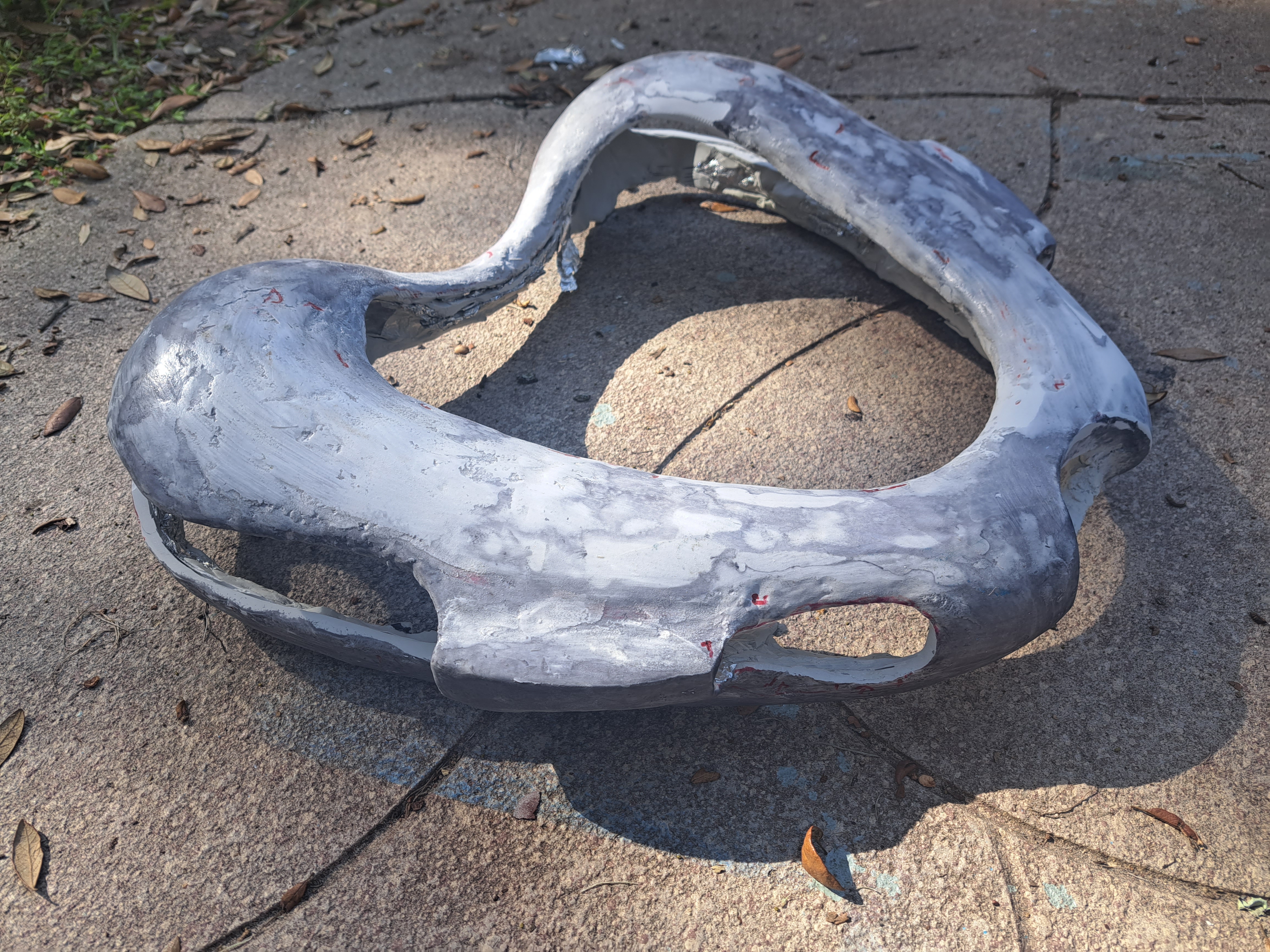

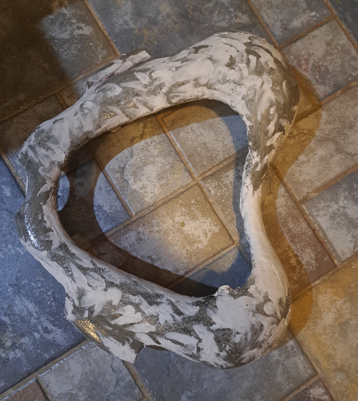

The next step will be to add the Greens - the green, side thingys- so, I have been adding crap, then sanding/filing. Adfing more FreeForm Air, then sanding/filing.
Not very exciting, but the Greens will be based on what is already built, but if I build on crappy foundation, it compounds the inaccuracies.
Sand, add stuff, repeat
