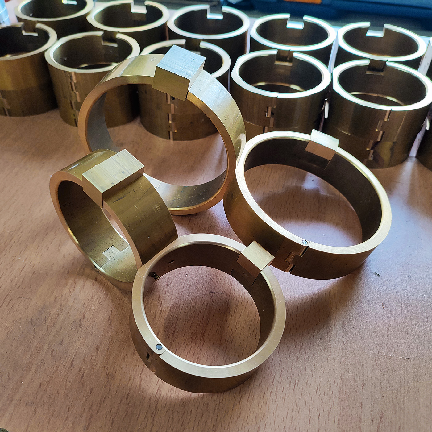

I took a long time cleaning up the fit on each Leia cuff, I had to build a new jib and meticulously worked on all of them to get the fit as good as possible, it took way longer than I hoped.
I have now moved on to milling the bevels on the hinges, which is a good progress step I guess. There is still a lot of work to be done, but I'm looking forward to installing the hinges axis to have each cuff stuck together before doing the final steps.
Just like mentioned during the prototype, the bevels are milled just a little bit too far to get the same step visible on the original cuffs.

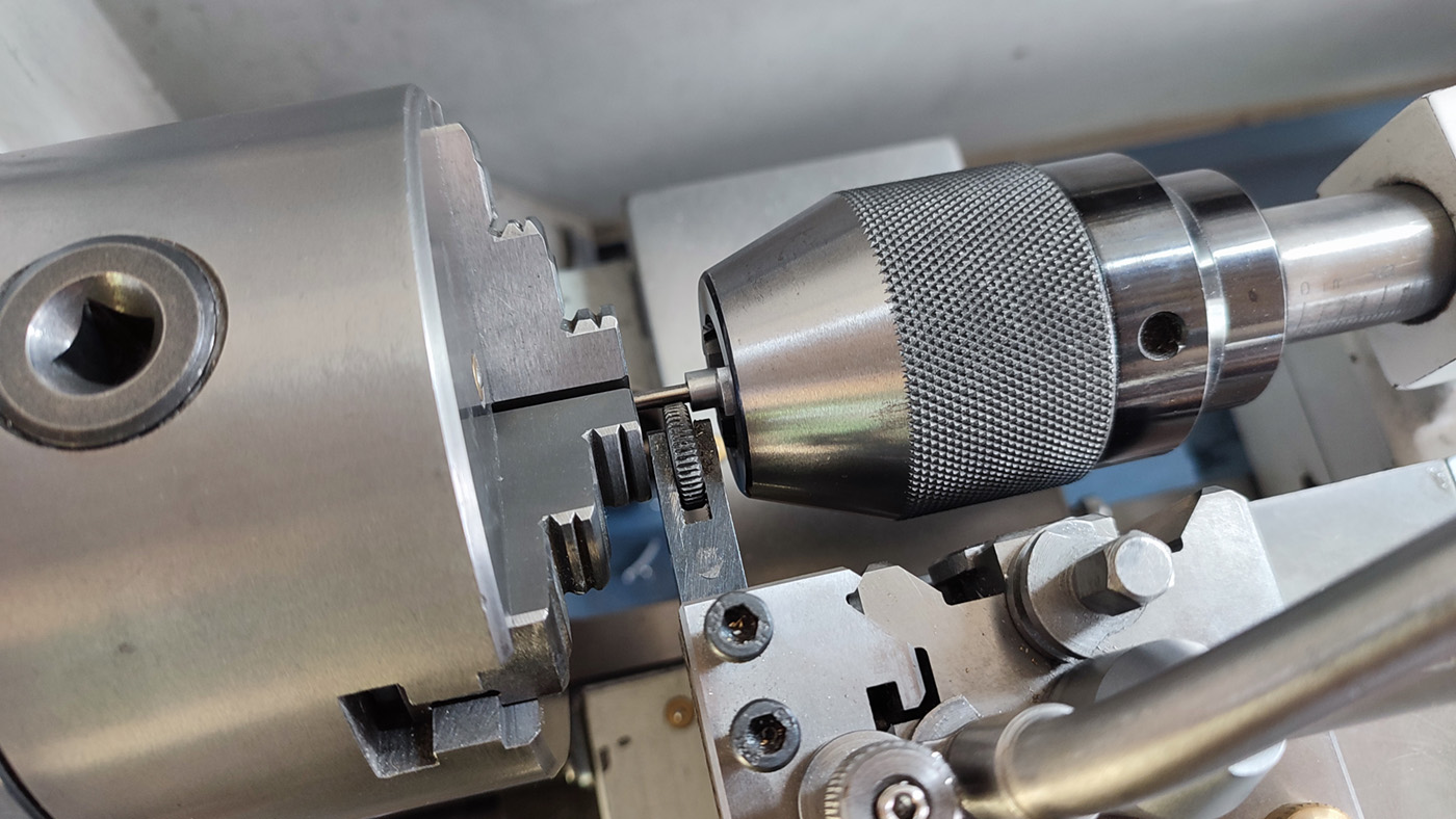

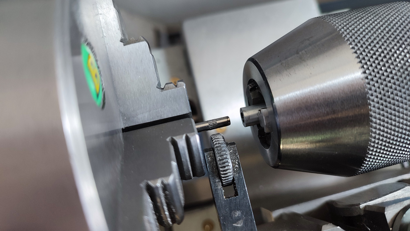

I tested several solutions/tools to get the cleanest countersunk screw heads to attache the cuffs together. Seems straightforward but the countersunk bit was too wide to get the screw to the proper depth and wasn't looking clean enough. Very happy with the final solution, 5.2mm drill bit, cleaned up screw head on the lathe to get a perfect mating of the hole and screw:
that gives a clean look I think :)

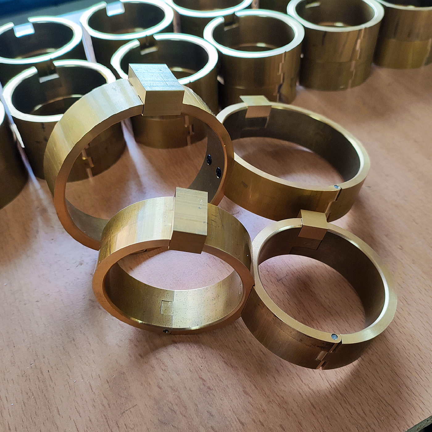

all holes are drilled and tapped, cuffs are now paired so the holes lined up perfectly for each pair.
time consuming step as each pair had to be test fitted, halves separated, drilled, tapped, put back together.
sorted by pairs now:
