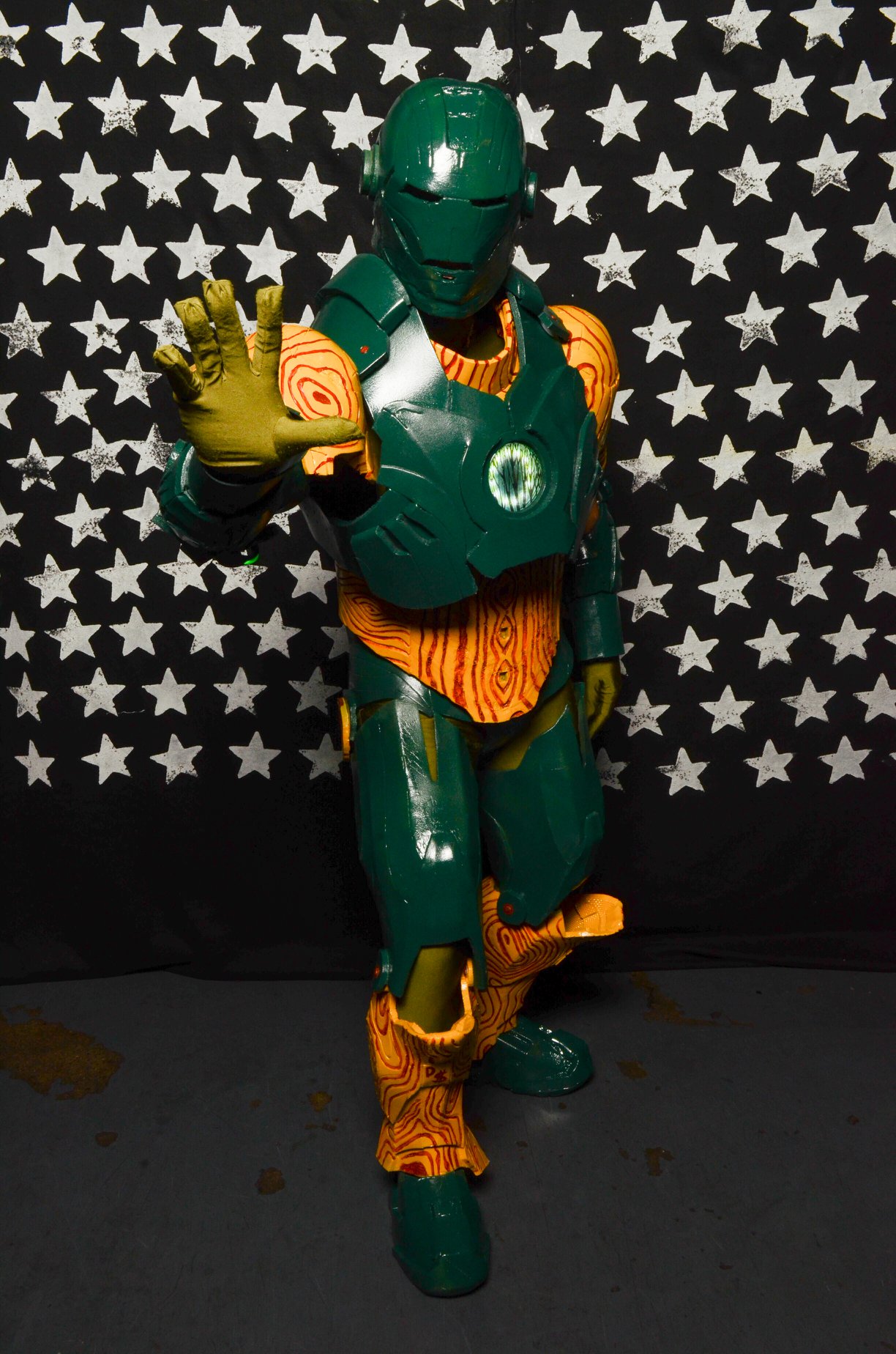

Halloween went well thanks to stumbling on the JFcustomized robo3687 MK4 foam files!
Big Thanks!
