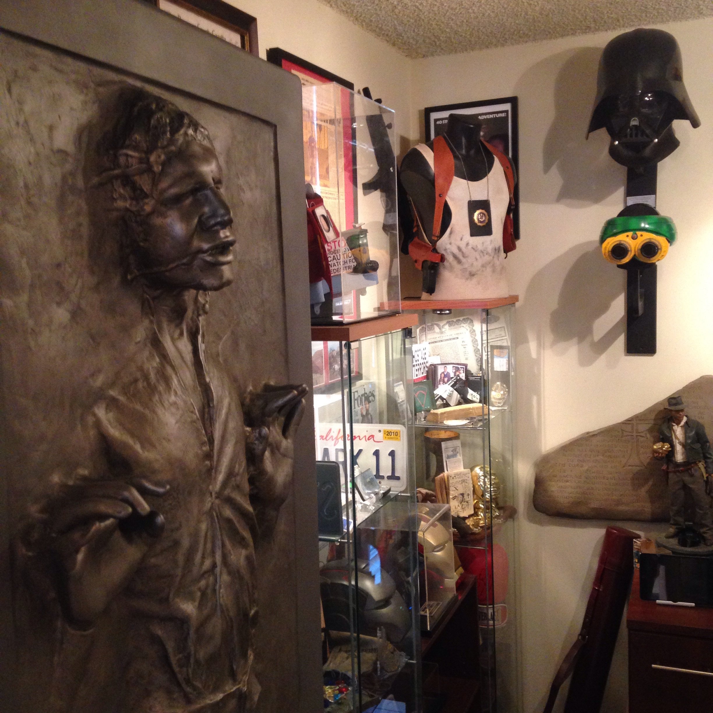

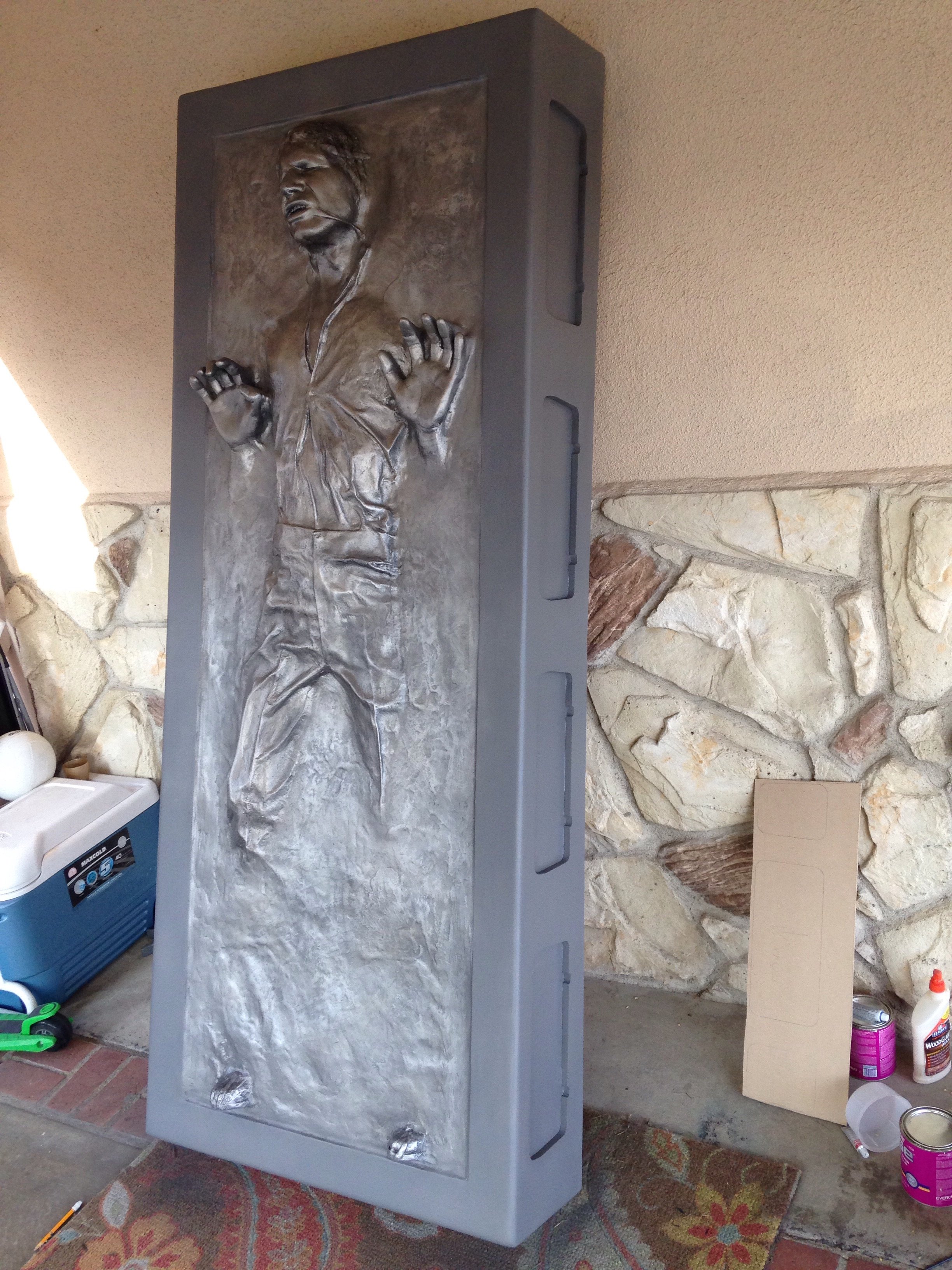

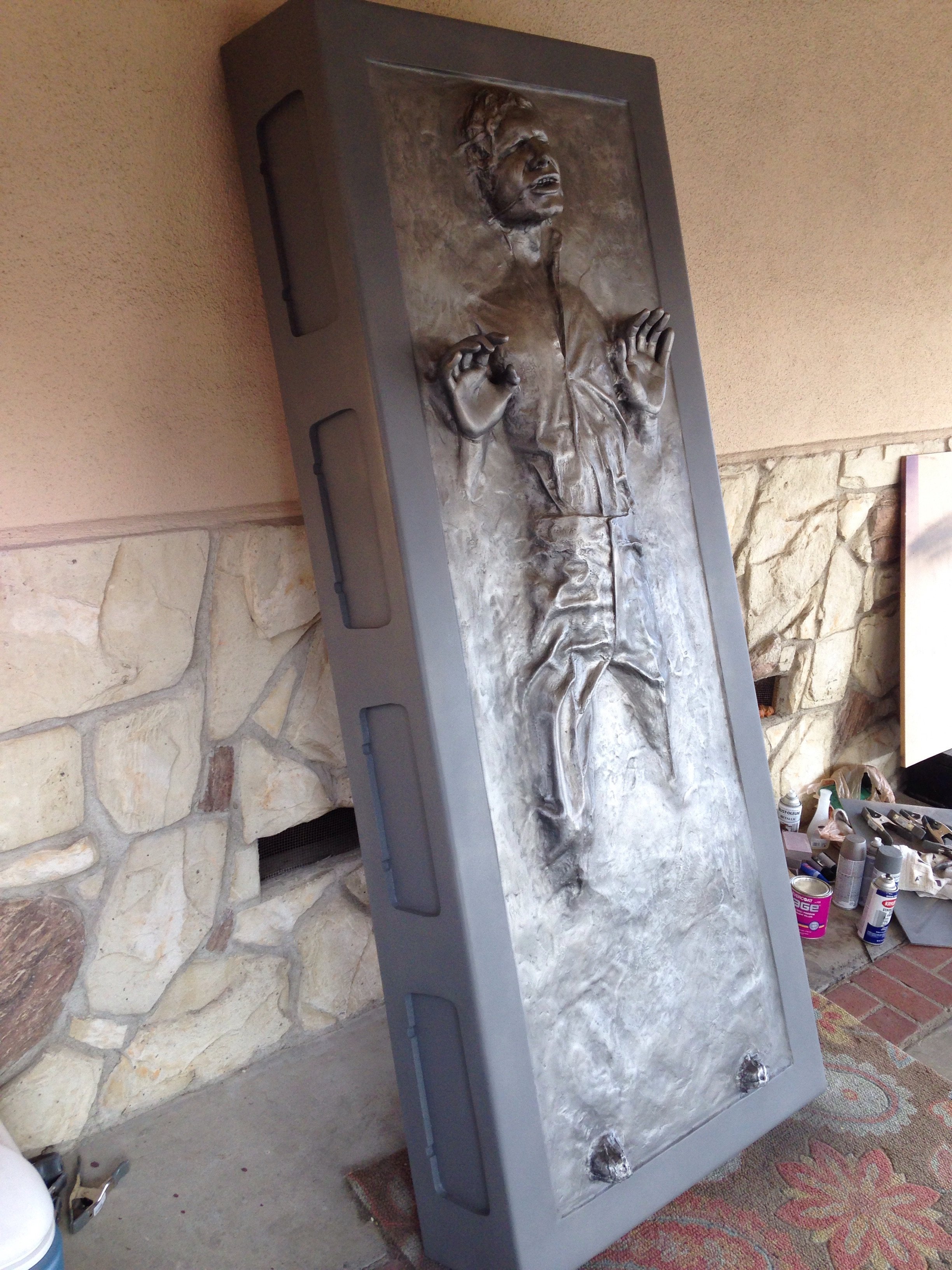

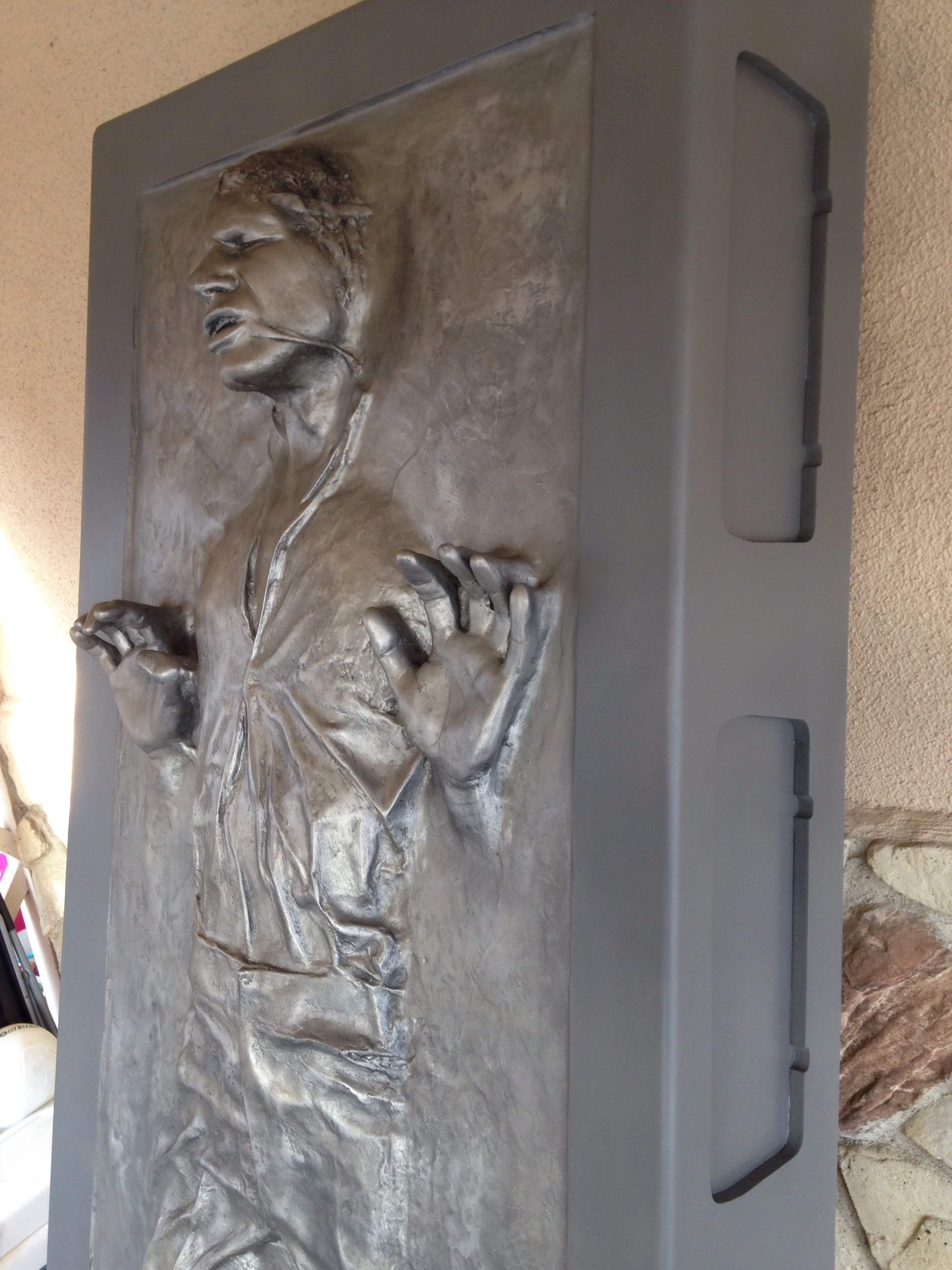

Thank you. It's just one of those iconic props from Empire. It's a piece of art along with a prop. It also makes me feel like Jabba the Hutt. LOL
Rustoleum Matte Nickel as a base
black acrylic wash (rubbed in really well)
mists of Krylon Stainless Steel, Krylon Brushed Caramel Matte
the frame is Matte Nickel base
Mists of Rustoleum Granite primer, Krylon stainless steel

First I sprayed a vase coat of the Rustoleum Nickel and let that dry for a day. Then I took acrylic black paint, thinned it out a little with nail polish remover. Using a paper towel, I rubbed the black acrylic all over Han. Rubbing it into all the crevices and pits. I let that dry for a few minutes, then took a clean paper towel and used the nail polish remover to wipe away the excess. As I was doing that I would keep rubbing the acrylic washed areas until the black was less pronounced. I had to repeat it on certain areas a little more than others because of the varying textures of Han and the carbonite. Then I would hit it with light mists of the Krylon Stainless Steel. Lastly I would mist it in various areas with the Krylon Brushed Caramel color. I would step back and assess it every so often to make sure it was looking even. I hope that makes sense.

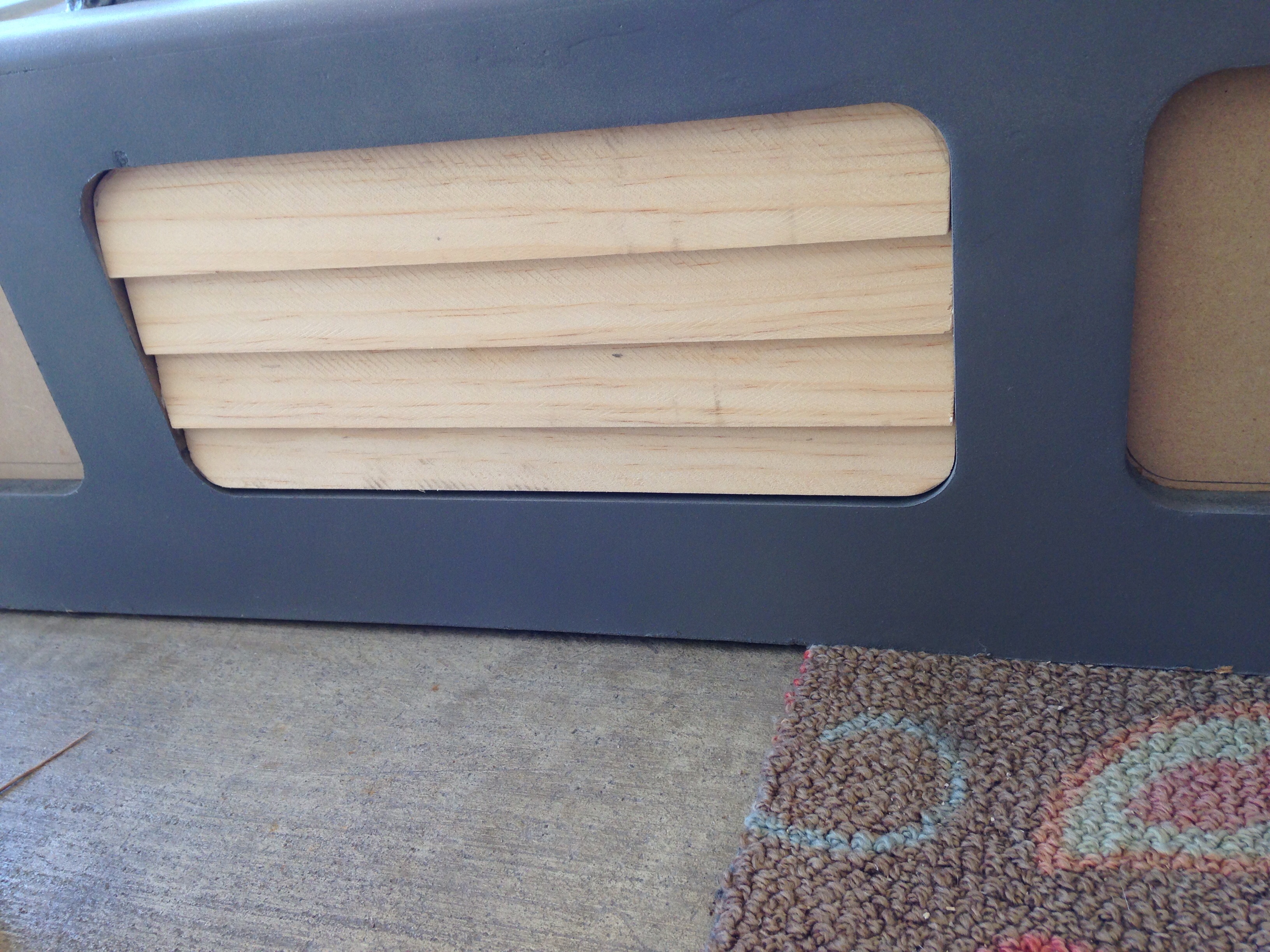

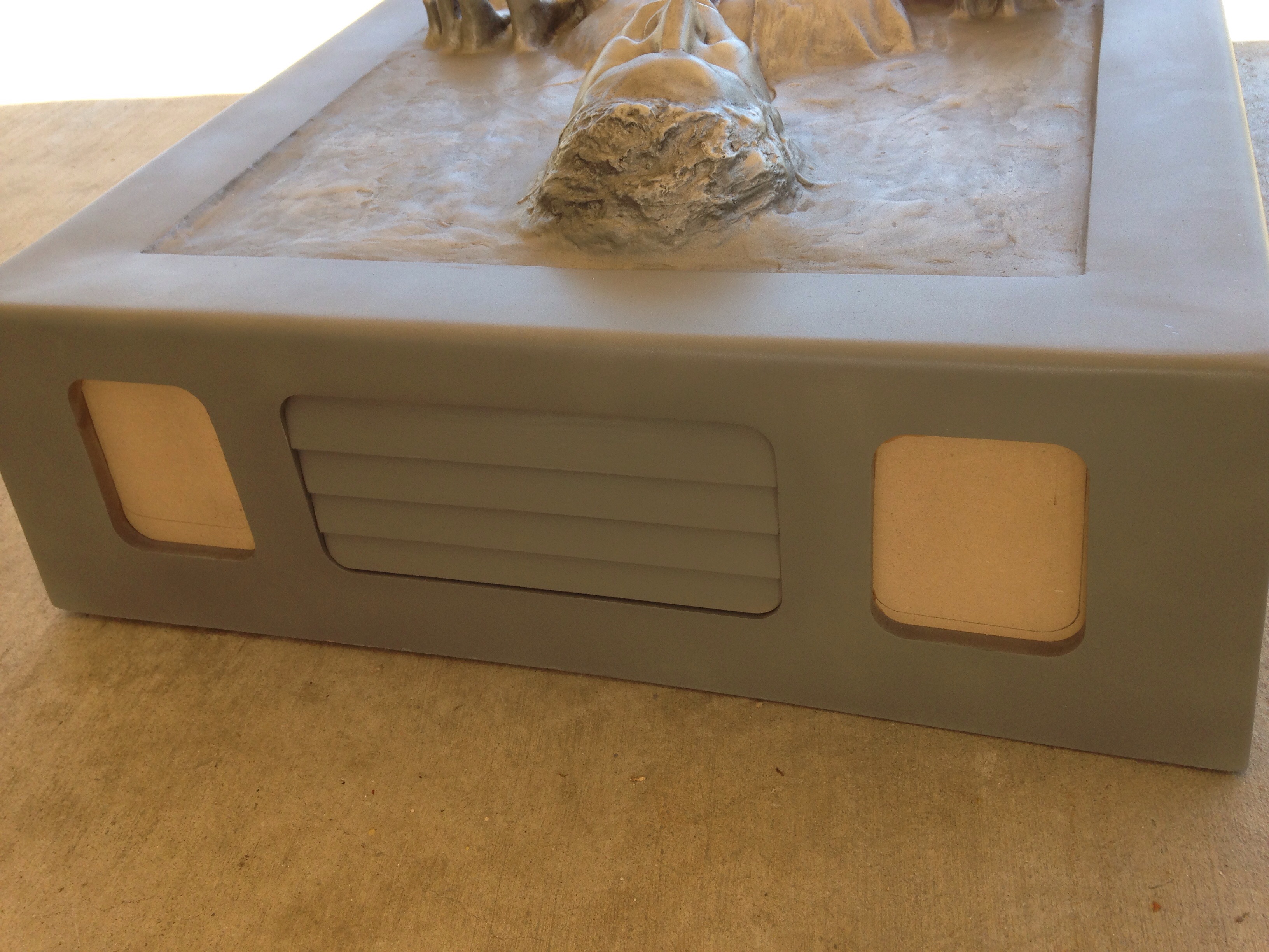

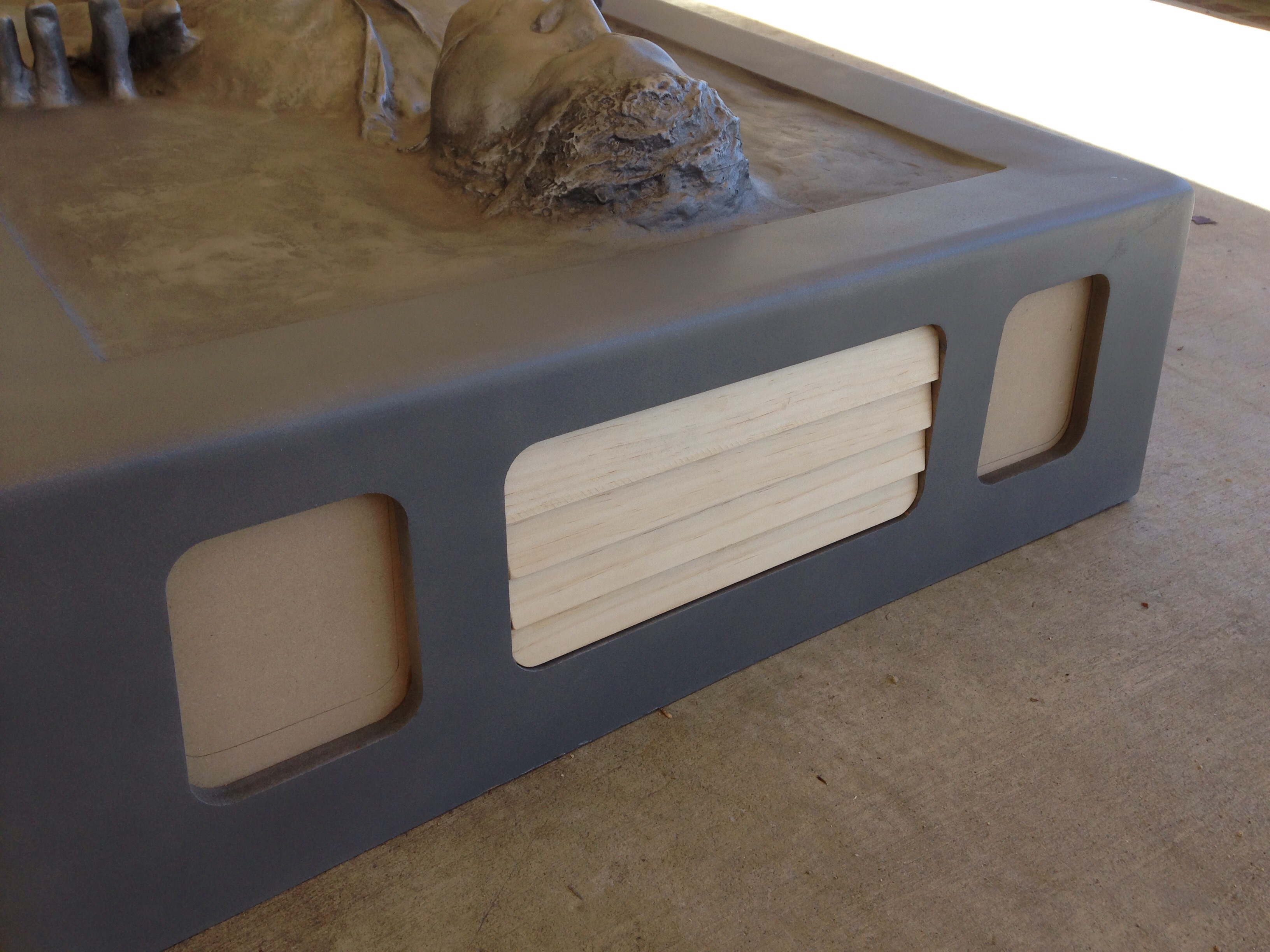

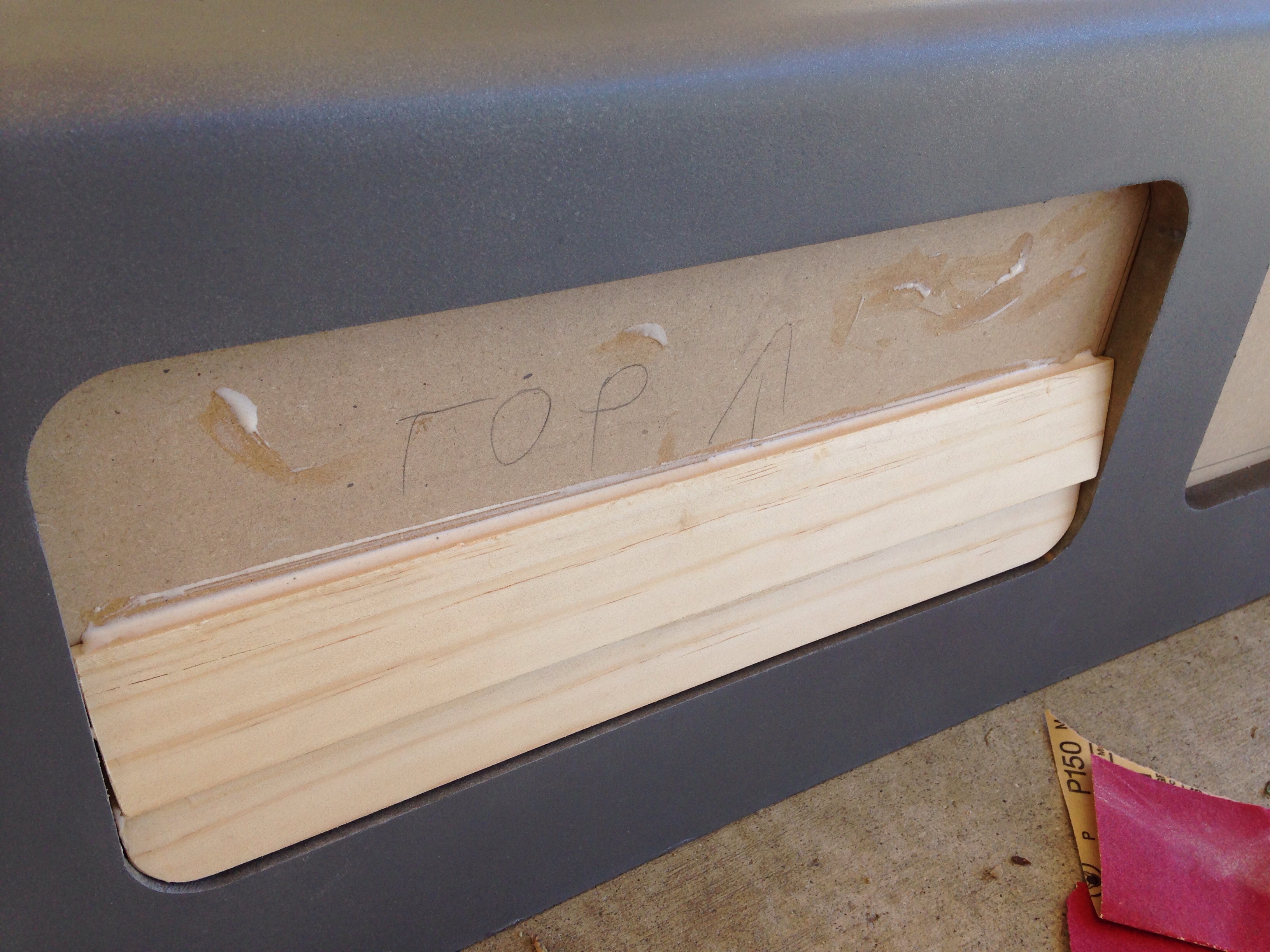

Today i glued the interior wood side panels in place. I will be copying another members bottom and top recesses with center vents and jet repulsor nossles.

Thanks Buddy. I posted what I did with the paint. The texture is a mixture of bondo and wood glue layers.

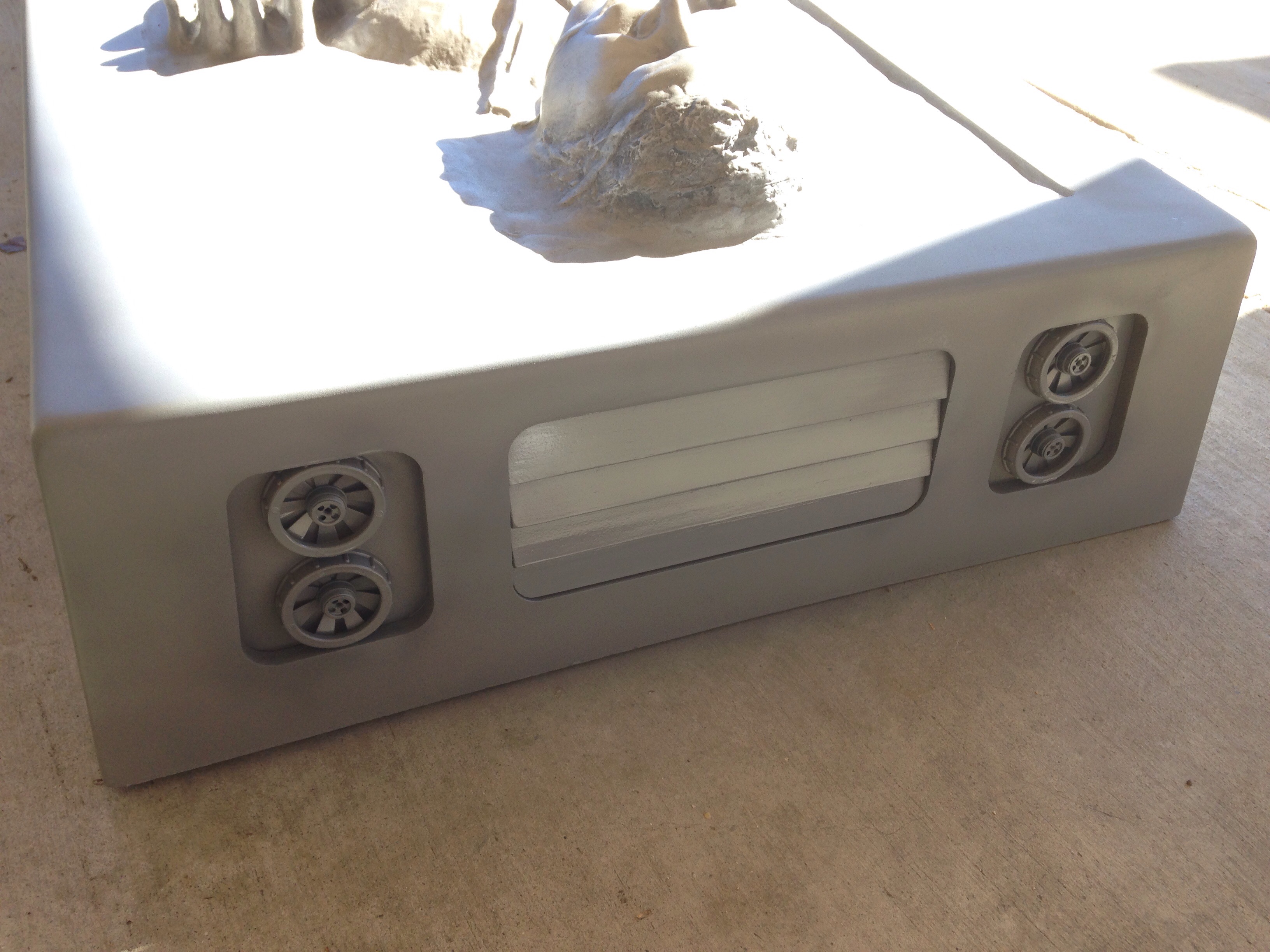

Center vents and repulsors are done. I will add some black paint for weathering. The idea for the vents and repulsors goes to azheat01

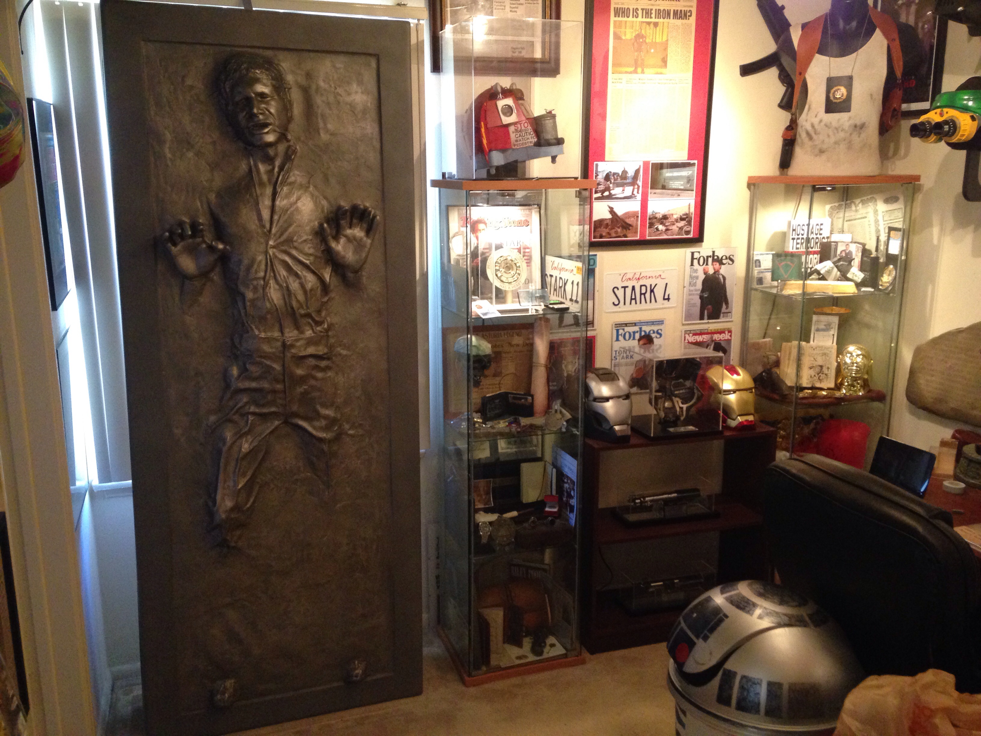

Han's final resting place. Side panels and electronics will finish him up.

The round outer rings are insulating bushings from Home Depot. The inside "fan" is styrene that I cut and the center piece is the top of a sprinkler head.
Is this top section SA or made up???

That looks awesome. Ya don't need a window anyway. I have never had one in a display room/office not blocked. The wall space is too valuable.
