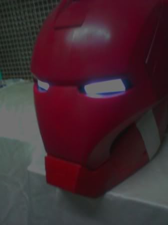

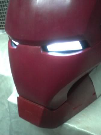

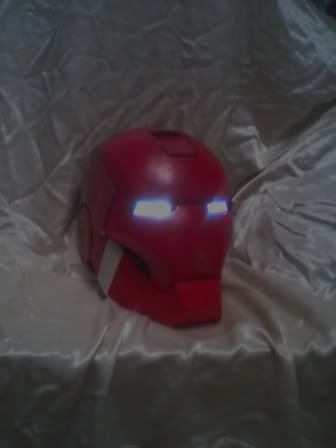

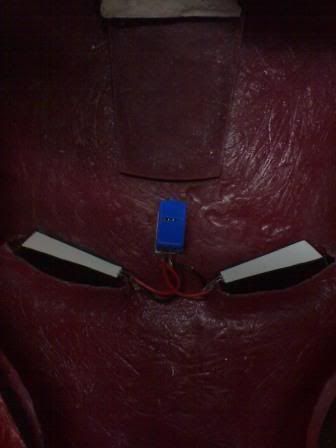

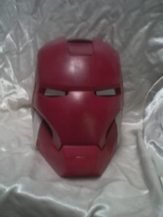

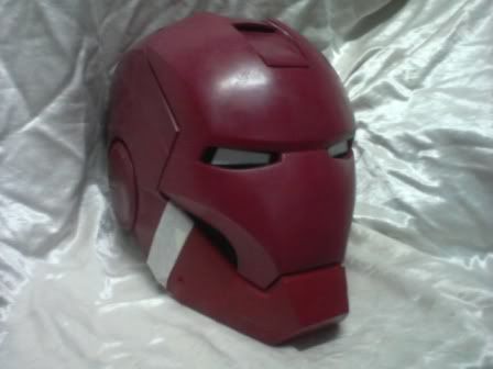

After we finished the teeth and the back-piece magnets installation, we proceeded to install the LED eyes...
(sorry picture heavy, but hope everyone appreciates)

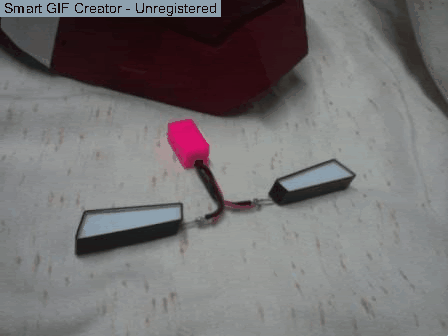

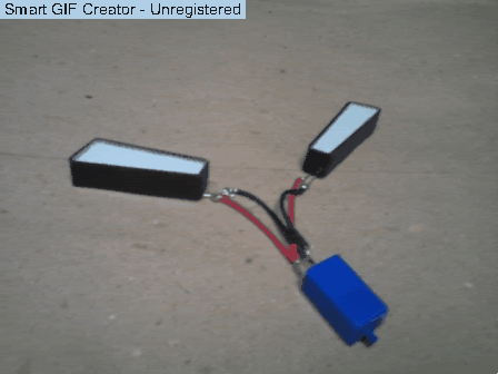

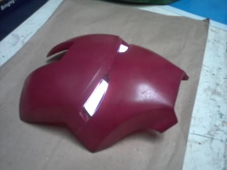

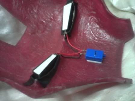

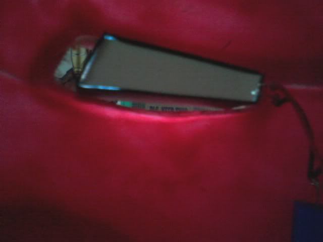

We used 2 high intensity LED's from a local electronic store...
Put an enclosure made of aclrylic sheets...

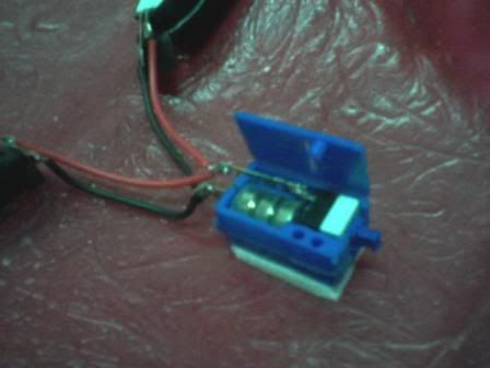

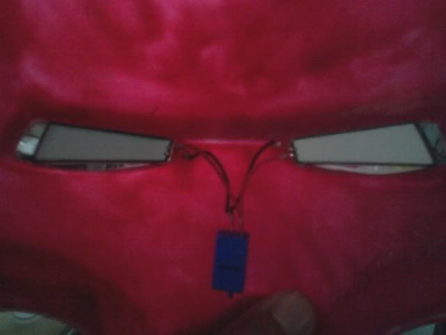

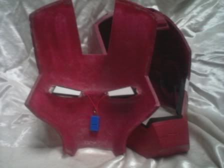

Connect the LED's to the power supply (3 watch batteries equivalent to 4.5V)... push button switch included
Slide-in the LED enclosure to the faceplate's eye socket... to be permanently fix using super glue (later)...

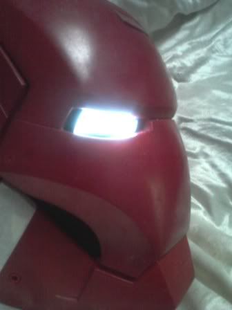

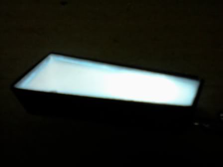

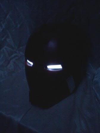

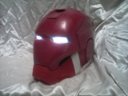

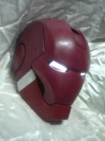

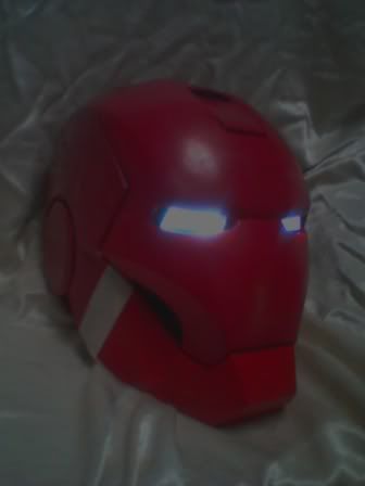

Let there be LIGHT!:)

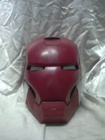

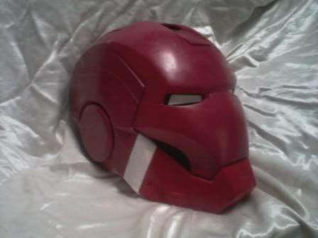

We've followed the shape of the eyes in the IM movie (i hope:confused)

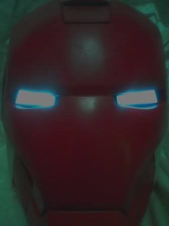

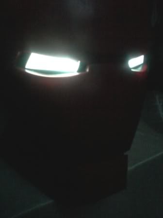

Changed the brightness (to low) setting of the mobile phone cam...

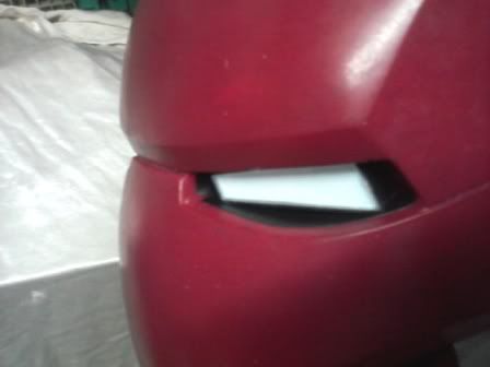

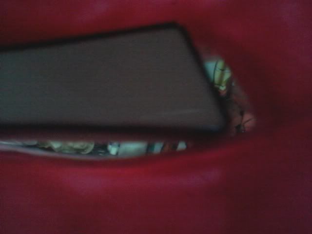

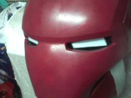

The shape of the LED eyes allow the wearer to see thru the remaining uncovered space of the eye socket...
Can you see the ironman poster?:love

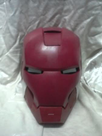

Even with the lights ON, you can see clearly thru the slit... you dont need to worry about the light blinding your eyes :confused as the LED is completely sealed...:):thumbsup

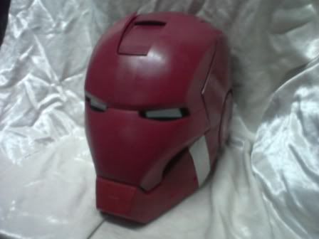

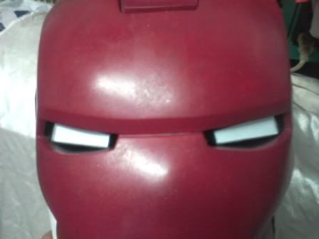

The slit, where you see thru, is hardly noticeable... specially when black eye shadows were put around the eye socket...
The black eye shadow will be painted on but since we are still not in the painting stage, I tried to simulate it using black vinyl tape...
You wont notice the slit since its also dark inside the helm...
I attached the power supply using double-sided foam tape...
Even with the lights ON, still you wont notice the slit...

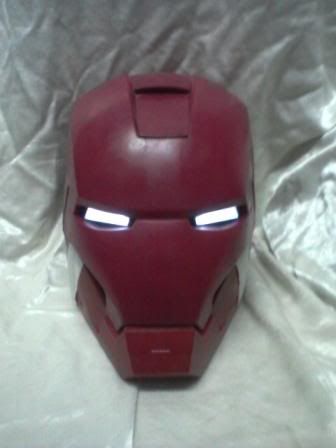

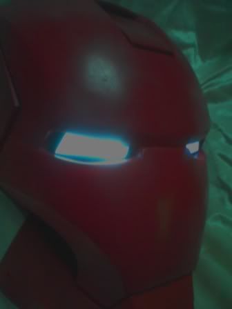

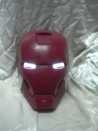

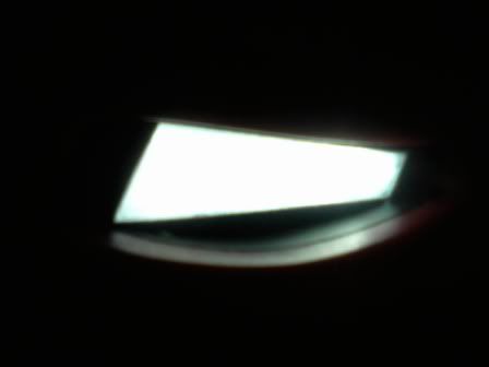

Im not sure if you can see it on the photo (below)... but I managed to put a subtle blue lining around the eyes to mimic the effects on the movie...
Hope this adds up some percent on our 99% target accuracy...:confused
The LED eyes assembly has the following qualities:
1) Compact design (no messy wire running along the helmet)
2) Very light weight (approximately 10 grams)
3) Energy efficient (uses watch batteries, 4.5V)
4) Provides just the right light intensity (not blinding)
5) 99% movie accurate
6) Allows the wearer to see thru the open space (slit) of the eye socket
7) Absolutely NO glare (no blinding light inside)
8) Ideal for motorized face plate
9) Easy to install
Comments and suggestions are highly appreciated...
Thanks for viewing and for your time...

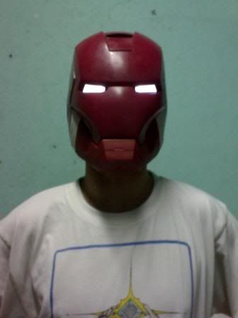

Re: Ironman mkvi pep helm (aiming 99% movie accuracy) --- LED EYES INSTALLED!

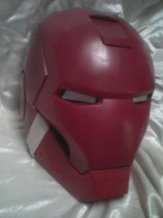

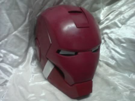

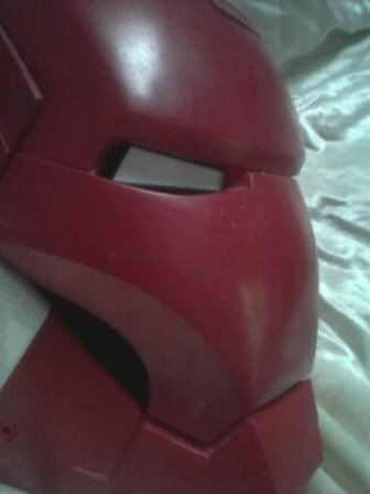

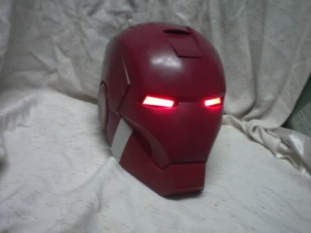

Today I took a photo of my brother wearing the helm with LED eyes ON...
My brother's nose is almost touching the LED eyes power supply so I relocate it on the forehead side...

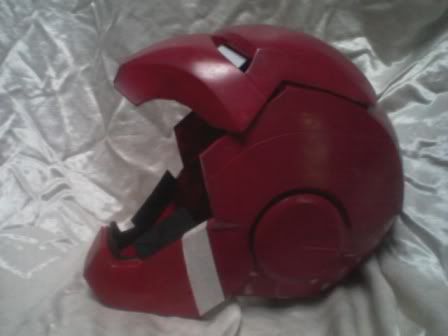

Currently working on the hinge setup... hope we do good...:confused
cheers!

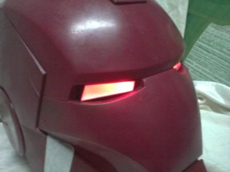

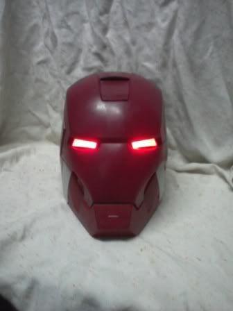

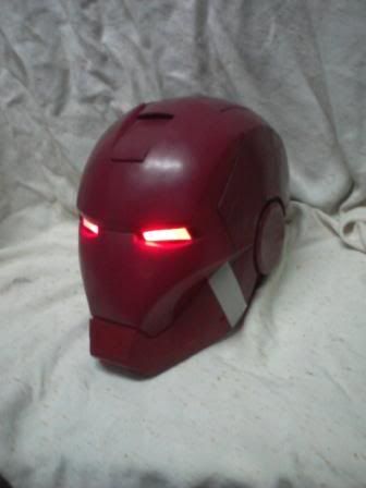

Re: Ironman mkvi pep helm (aiming 99% movie accuracy) --- RED LED EYES FOR WARMACHINE
Someone requested for RED LED eyes for warmachine application...
So today we tried to make one...
We dont have a warmachine helm as of the moment so we just installed it to our IM helm...
I think the result is quite good...:):thumbsup
Kinda movie accurate...
Thanks for looking and for your time...
cheers!
I cannot lie, that looks sick! I really like how clean it is and the fact that it replicates what you see on the movie. Awesome job!
I coudn't replicate what you did because one set of my leds were broke but I made do with one set. Not as screen accurate as yours but I'll still rock it!
