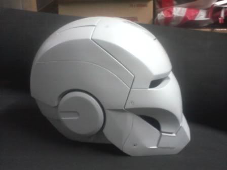

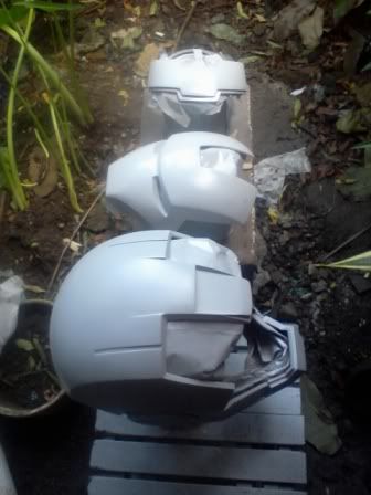

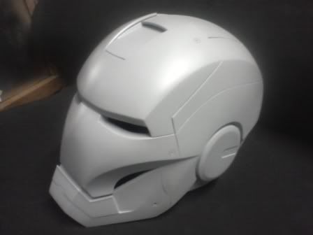

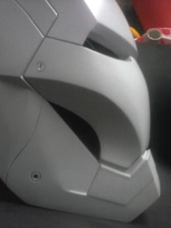

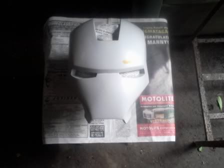

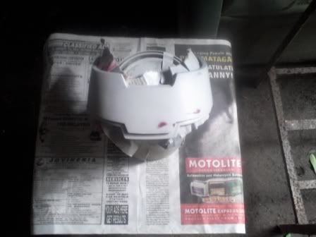

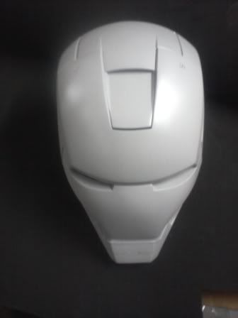

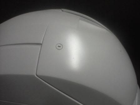

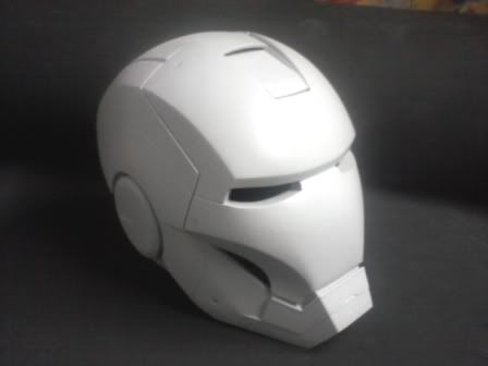

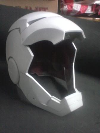

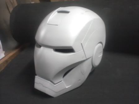

Anyway I just wanted to show everyone a freshly primed helm cast...
At first I bondo some pin holes and bubbles on the cast... then sanded it smooth...
After that is the first coat of primer filler... then sand it again...

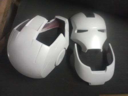

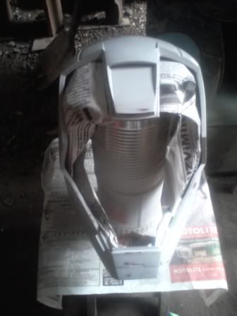

I covered the inside using news paper to avoid painting it...
I strongly recommend to avoid painting the inside of the helm since you'll be gluing/attaching some padding, hinge system and other thing inside... it will be a better bonding if the glue or adhesive will be directly in contact with the inner wall... paint on the other hand will weaken the bonding of any parts that you will attach...

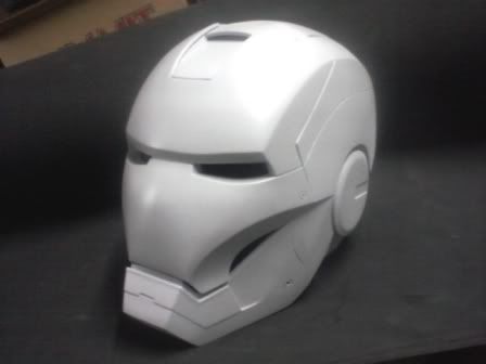

On with the 2nd and final coat of primer...
Looks exactly like the master plug...:love
