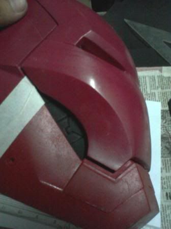

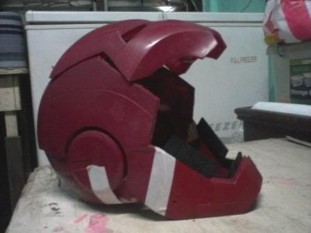

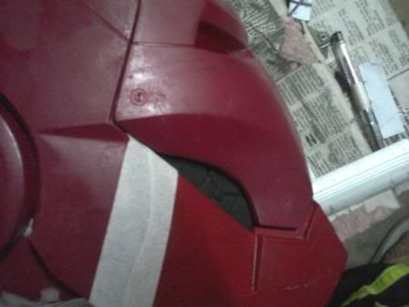

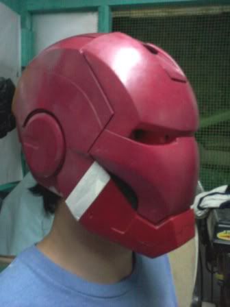

Been a den-tech today... after the "HULK" broke my IM teeth lol:lol, i finally restored it...
TEETH WERE BACK!!! :love woooo-hooooo!!!

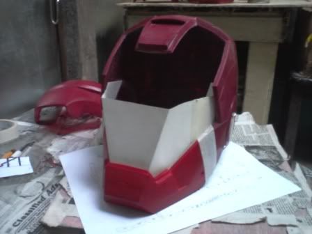

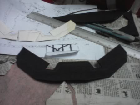

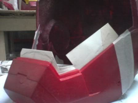

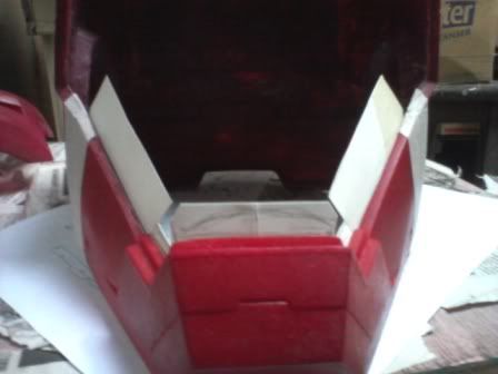

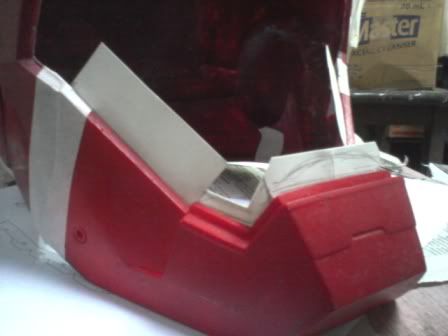

First I attached a card stock on the chin to make a pattern...

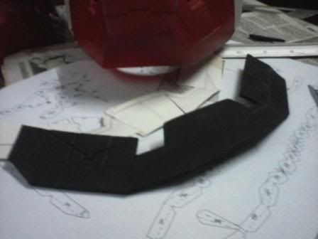

Drew and cut the pattern...

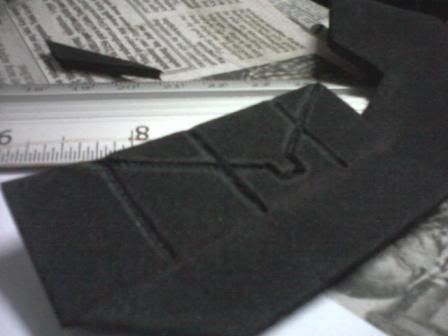

Traced the pattern on a 2mm (thick) foam...
Drew the teeth details and made the indentions using a soldering iron...
Temporarily attached it to the chin using double-sided tape...

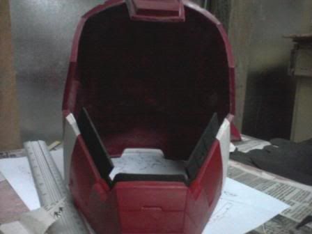

We decided to make the teeth from foam since it is most likely to touch the cheek of the wearer... to use a soft material seems a good idea to provide comfort :):thumbsup
Isn't that the sweetest smile...:love
Hope we achieved a movie-like-effects on the teeth...:confused
I think we can leave it as is (matte finish)... or we can also seal it using white glue (for a semi-glossy finish)... what do you think guys?
Comments and suggestions are highly appreciated...
cheers!

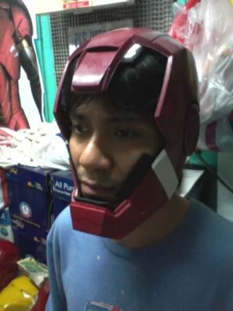

Re: Ironman mkvi pep helm (aiming 99% movie accuracy) --- MAGNETS INSTALLED

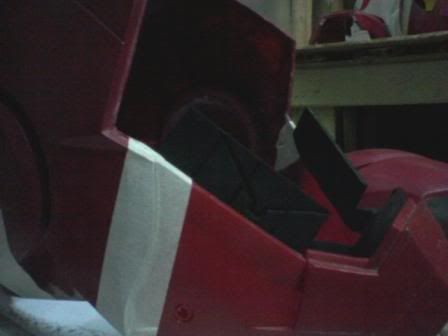

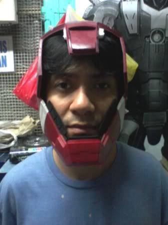

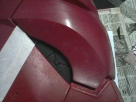

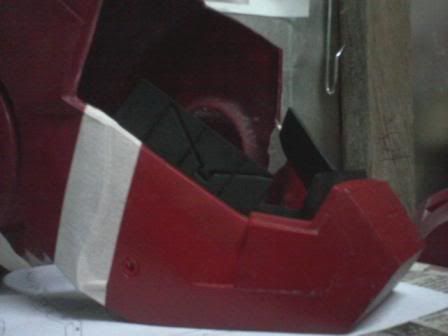

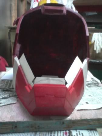

Today I had the chance to take photos of my brother to show how the foam teeth performed...
It is touching the cheek...
And proves comforatable since its a soft material...
Faceplate and teeth fits well...

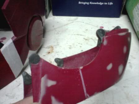

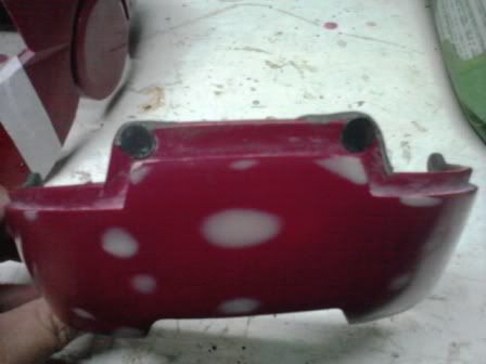

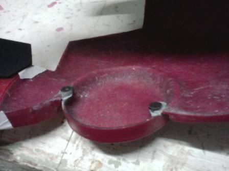

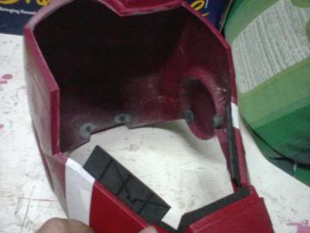

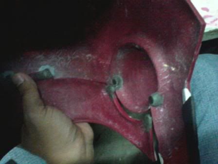

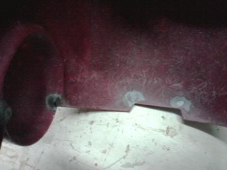

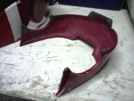

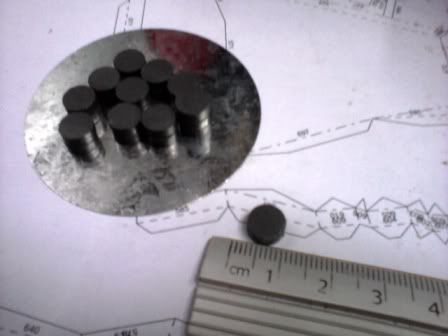

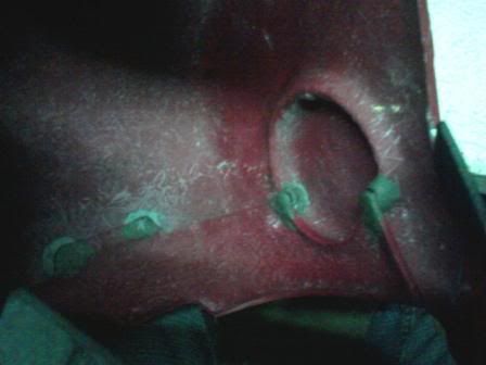

Then magnets were installed on the back-piece part.
We used a 8mm diameter x 2mm thick magnets bought from a craft store...
Initially we planned to put 4 sets of magnets only, but the magnets are not so strong... so we decided to put 2 sets more...

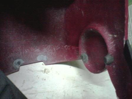

The magnets were attached and secured using epoxy clay...
Sanded some excess epoxy clay...
Back piece fits quite well... but i still think if we used rare-earth magnets, 3 sets are already enough to secure the back-piece part to the helm...
Any comments and suggestions are more than welcome specially regarding the cheap source of rare-earth magnets...;)
