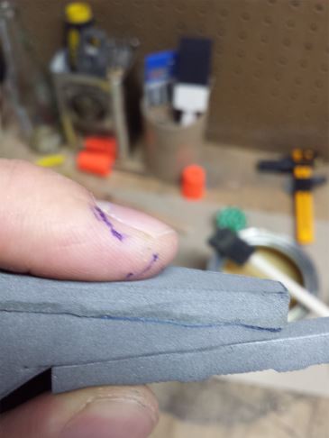

So i wanted to share with everyone a concept that i use to make edges you are gluing together meet up with out having to use tabs or having to sacrifice edge thickness to make pieces appear they are convex or concave. I have had countless builds that needed to have an edge slightly overlapped to make a raised edge or had a suit that had a piece that was an exact fix but there was no ware to glue to. So here are a few steps i use to remedy the problem.
So you have two pieces that need to be glued together, but if you use the two piece you are gluing, you would have to adjust how they fit together to put them together. The example below is what i am talking about. notice how the two edges need to meet up, but if i just glue them together, i would have to overlap them to put them together. by doing that the result of this piece would be shot and mostly would not meet up with other parts that surround it.
What i do is take scrap foam and glue them to the opposite edge of the piece i am looking to glue.
Now with those pieces glued on, i can attach the adjacent piece and make them match up right to the seem like it should.
