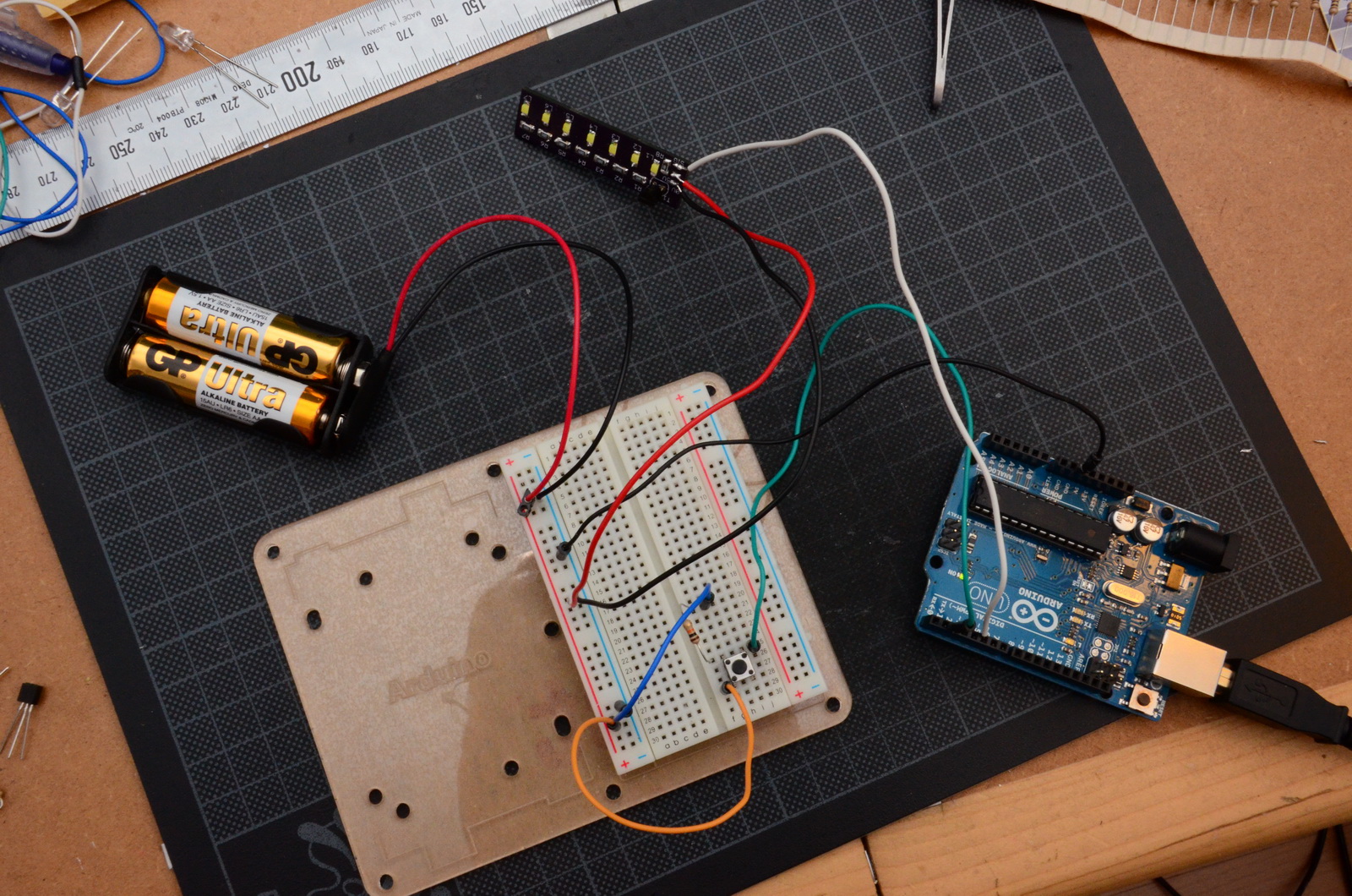

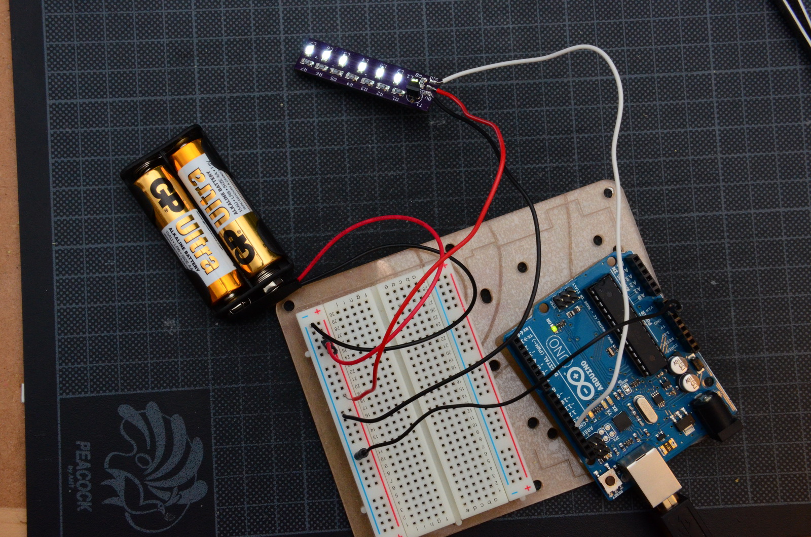

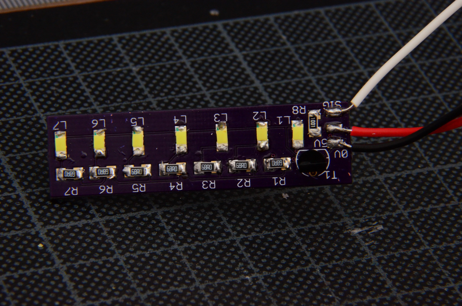

I got my eyes PCB! I soldered everything and ran some tests.
I got some trouble. As you can see on the pictures, I made a simple circuit to test the PCB with button but that doesn't work.
PCB is powered by external battery, arduino is powered by usb, arduino ground is connected to the other ground.
I tried the blinking sketch with my board and that works so I assume I soldered everything correctly. Also checked the LEDs separately. They work.
What I do:
- connect everything
- check the code
- upload the code
The LEDs are bright but the button do nothing. I haven't connected the servos. Only tested the LEDs.
If I disconnect the USB port, the LEDs stays bright and the LED on the arduino are still on too, seems strange to me.
Any advice? Thanks

1.) what battery pack are you using? +7.4 volts? are the resistors on your eye pcb rated for the direct +7.4v+ pack? (most diagrams have the source coming from/after the +5v voltage regulator that powers the servos too. (so Im checking/asking)
2.) Is the switch in the one position? (hard to see) can you run a simple button sketch and get the button working first..?
you say a simple BLINK sketch using the same pin the eye pcb/transistor is hooked up to does WORK though?
I tried 2 batteries 3.2V and 4.7V. I still don't have the Vreg so I don't want to blow everything up.
The resistors are rated for regulated 5V. This is why I used two <5V batteries.
The switch is on position 2 (as usual with this sketch).
The BLINK sketch with PCB connected on pin 5 (same as for the faceplate design) work.
I tried (but will try again) a simple sketch with button but didn't work. Tried 2 different buttons.
the resistors should have been calculated for a smidge UNDER +5v.. (remember)..
the voltage drop across the transistor?
anyways...
the +3.2v battery wont cut it.. it wont even turn on the leds without resistors.. if the fV is +3.3v (maybe it will but not for long?...you get what Im saying)..
over the transistor..and resistors.. no way (IMHO at least)
the +4.7v maybe...
Im not asking what pin the switch is connected to.. Im saying is it in the right position/orientation on the breadboard?
get a plain button sketch working.. THEN move on to incorporate the eye pcb's..etc..
you'll get it! :)
I'll give another try tomorrow with a fresh head. Will start again at the beginning then add the PCB :)
BTW, yeah, the switch was correctly oriented. Thanks XL97!
It worked. Dunno what I connected wrong but I start from scratch, made all the connections and that works.
