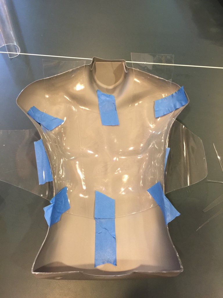

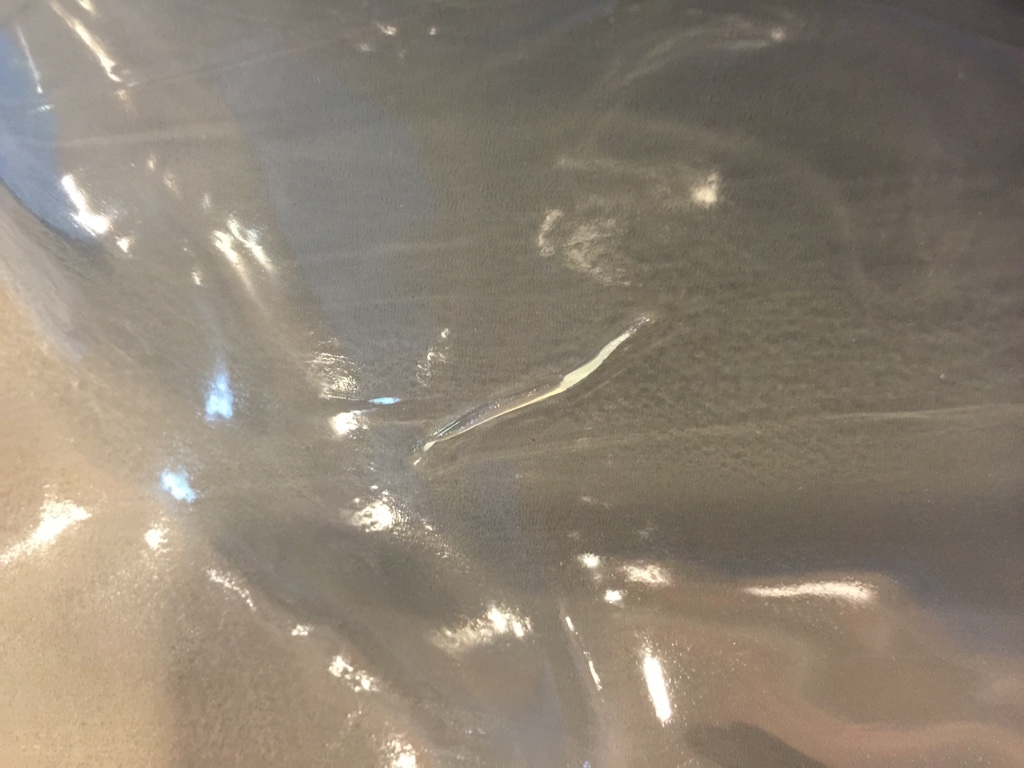

Here is the Worbla smoothed out into the front half of a cheap blow-molded torso mannequin. I wouldn't say it is easy , but it wasn't really difficult, either. Heat the Worbla to flatten it first so you can cut it out symmetrically, then heat and tape as you go, starting from the depth of the pectoralis muscles first and working outward, smoothing with a wet rag. Don't let wrinkles or folds get started because if the hot Worbla touches itself, you are done
(here is a small area that did that)

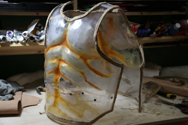

Soo I have decided to make the armor out of PETG i've seen a fellow cosplayer use it with a heat gun to make a successful chest and back piece and I hear too many horror stories about worbla here's a Picture of the success with PETG
From-rawrbomb
I'd love to know what they shaped that over. If it's vacuformed, they're working with a sizable table. I have 24" square PETG sheets but I have no clue what I would heatgun them with to form them.
Just dawned on me what the edge is on the screen-used armor: mole skin. It is a pinky-beige adhesive flannel shoemakers use to cover rough areas on shoes so they won't make a blister. I am going with the beige Worbla , at least for now.

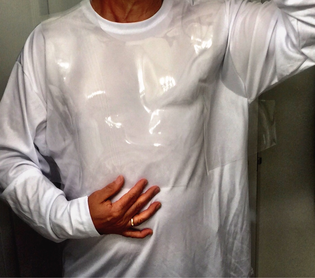

Just tried on the chest piece and figured out what the medals and the "cocktail strainer" are for: they hide your nipples so they don't look like a little kid's nose squashed up against the candy store window…
