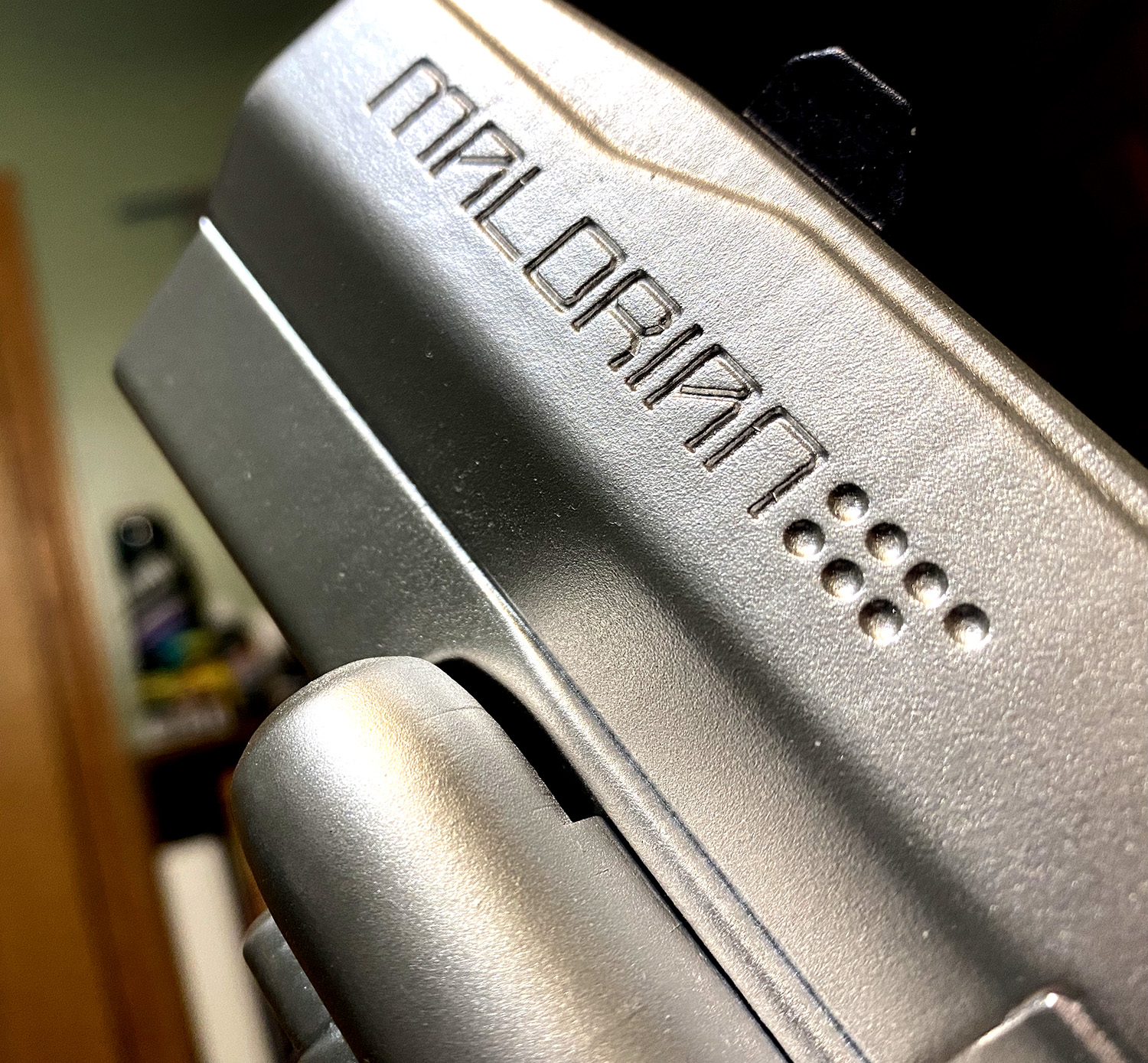

For silver, particularly aluminum, I use Rustoleum Imagine silver. In 1 or 2 coats you have a very convincing metal surface. I have only ever found it at Target. I order it from their website now as I live far away from a Target store. But they have always had it in stock.
Once it's cured it can be handled without any dulling.
