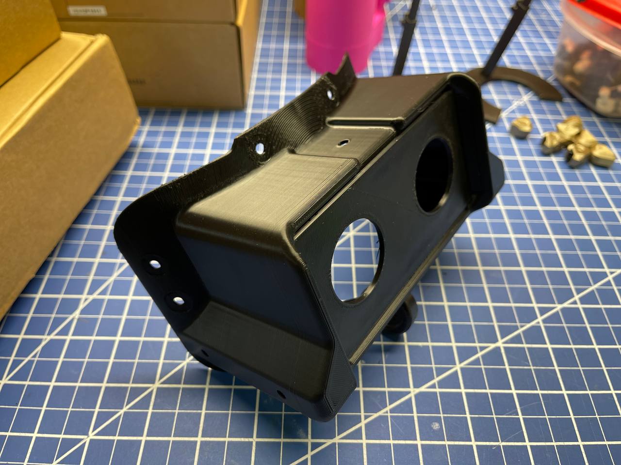

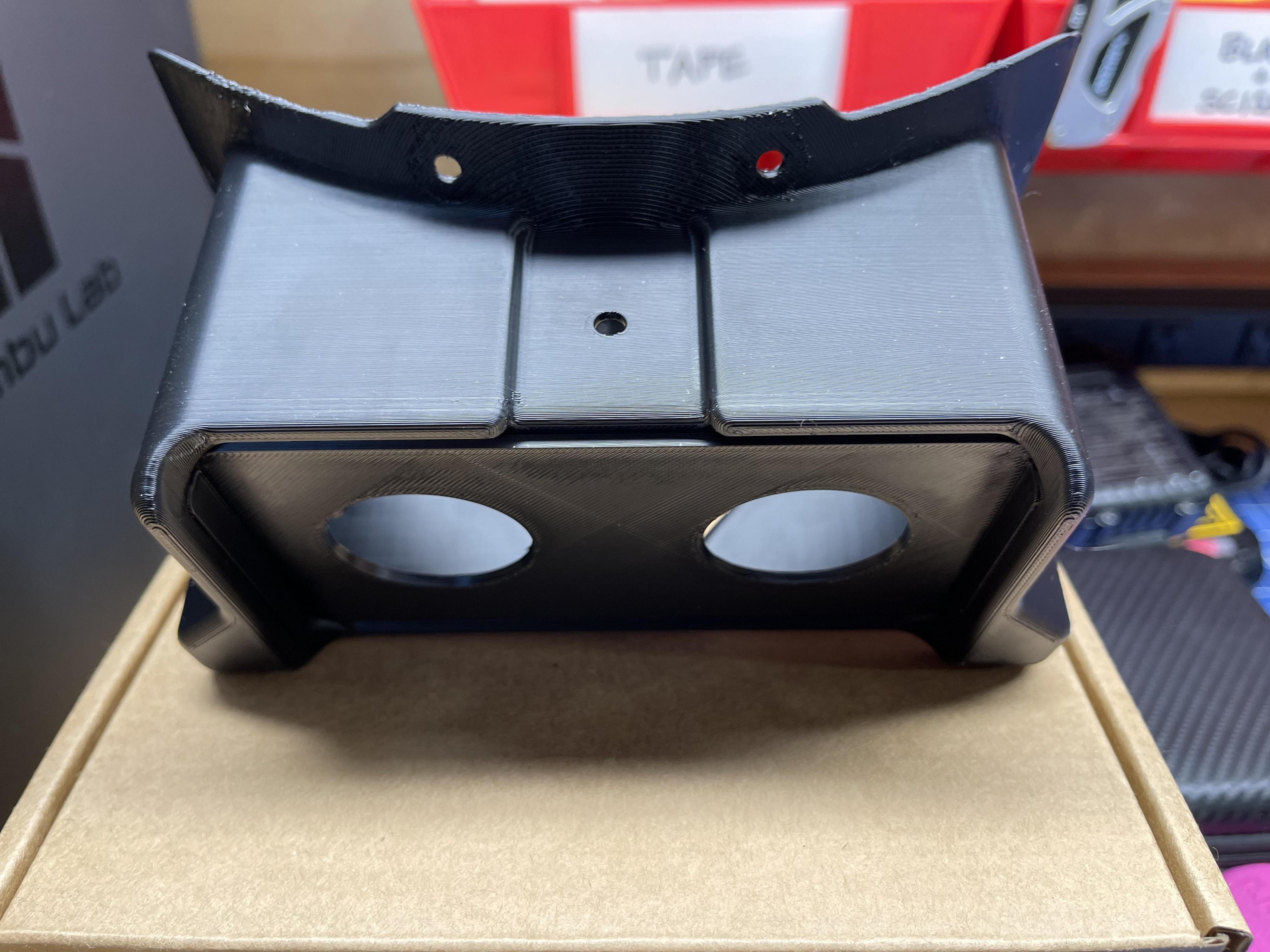

For this build, my 'in' was a recently purchased Bambu Lab P1S, and realizing a few people had been working on Goggle 3D models. Rather than buy one, I decided to 3D print the frame out of ABS, and try my best to sand and fill to make it not look like a 3D printed part. This was actually pretty fun. A huge part of the enjoyment of this hobby for me is the actual building, filling, priming, sanding, painting, and problem solving. I didn't really want to just fully assemble a kit, I always want to learn a few new skills.
I printed a frame from TheGoon, intending to do a fully 3D printed pair of goggles using NotSabbot's lenses. But, well, you know how it goes once you start putting time into a project. I opted to print with ABS to prevent any shrinkage or warping, and because it's fairly robust.

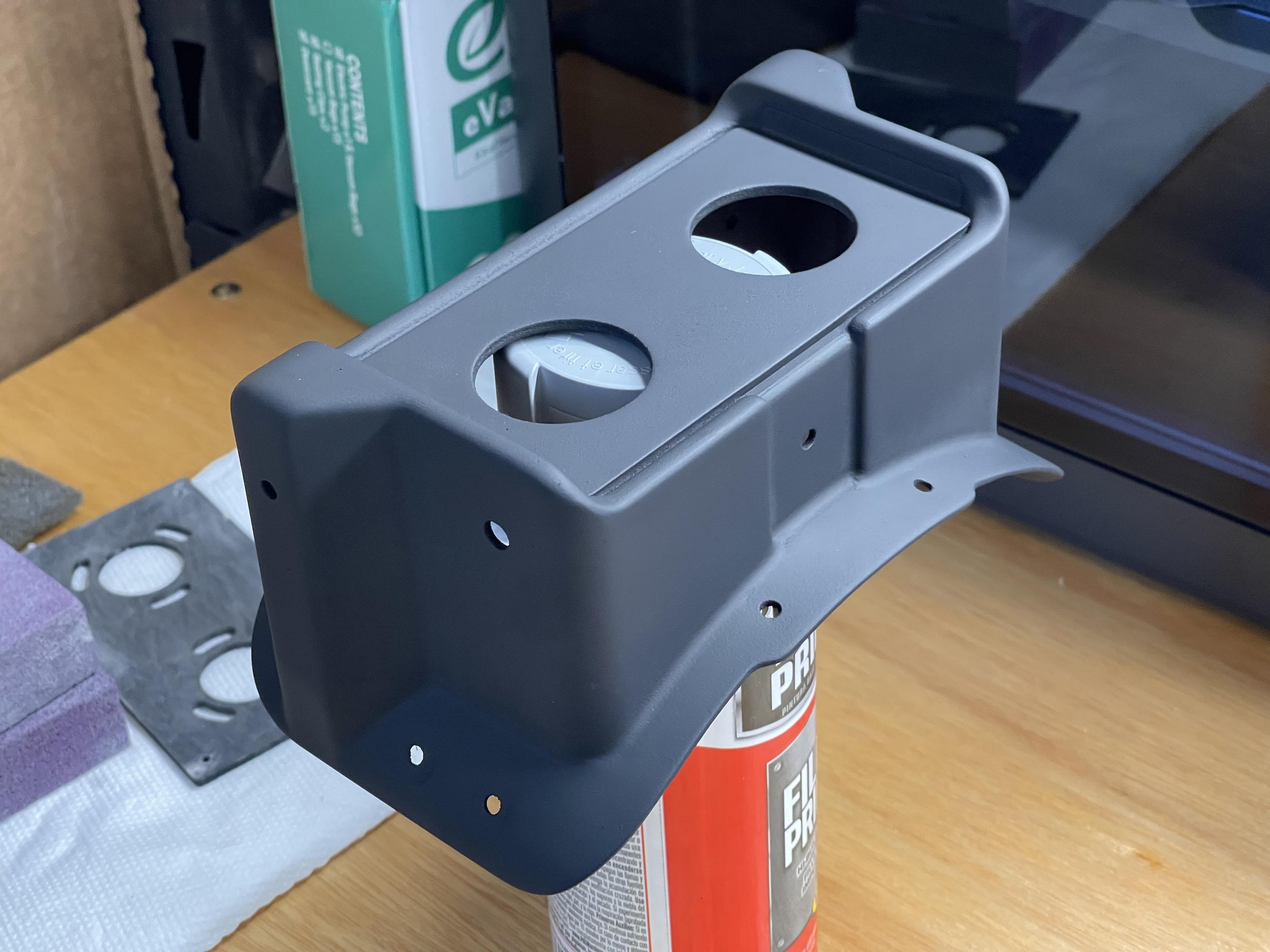

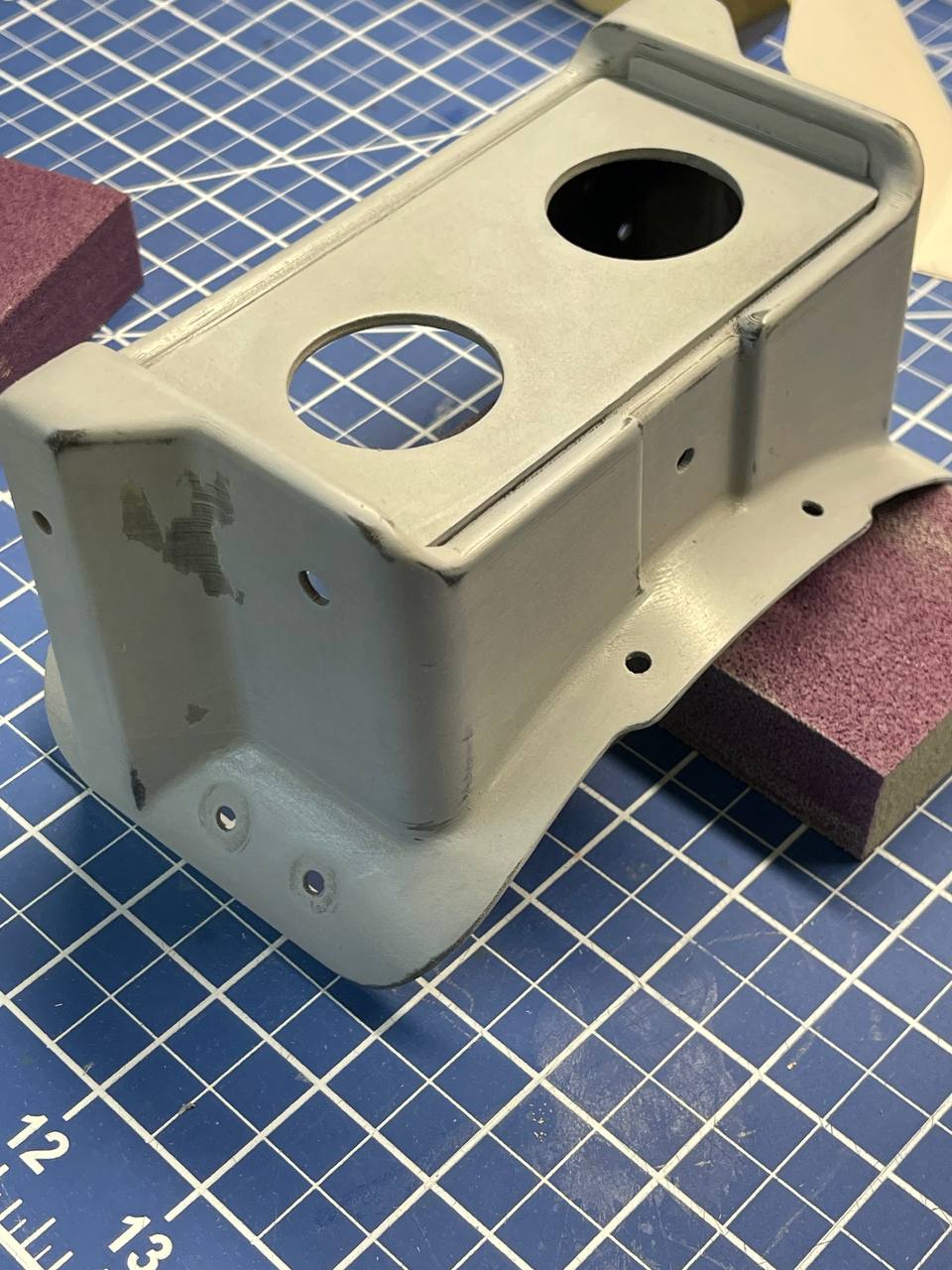

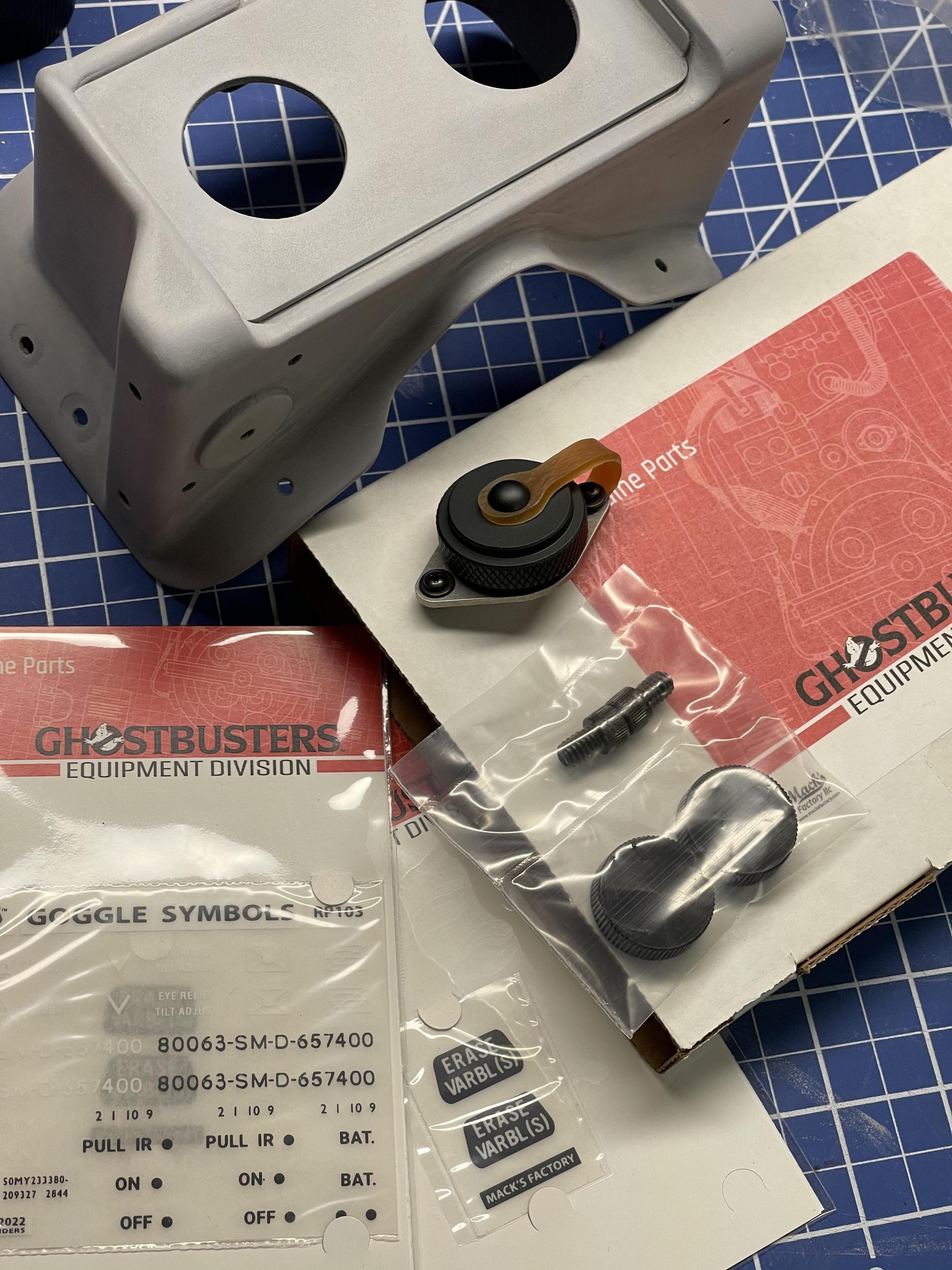

I found my preferred way to smooth out the layer lines was by wiping on a thin layer of DAP Plastic Wood filler, let it dry, sand, and repeat. I did this for a couple of days until I had a pretty smooth base form. Then I used some Rust-Oleum Hi-build formula Filler Primer to check the surface and help fill in the finer lines.
During this process, I also stocked up on some dry transfers from Mack's Factory, and some other labels from VanOaks Props.

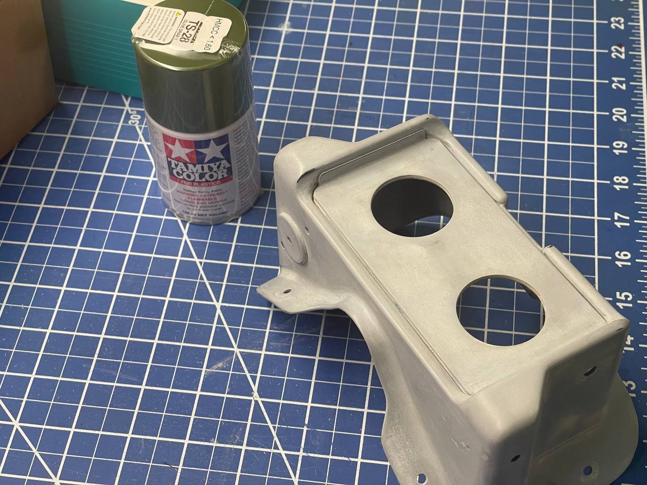

After a few passes priming/sanding/priming/etc, I was satisfied and gave everything a coat of matte black enamel.

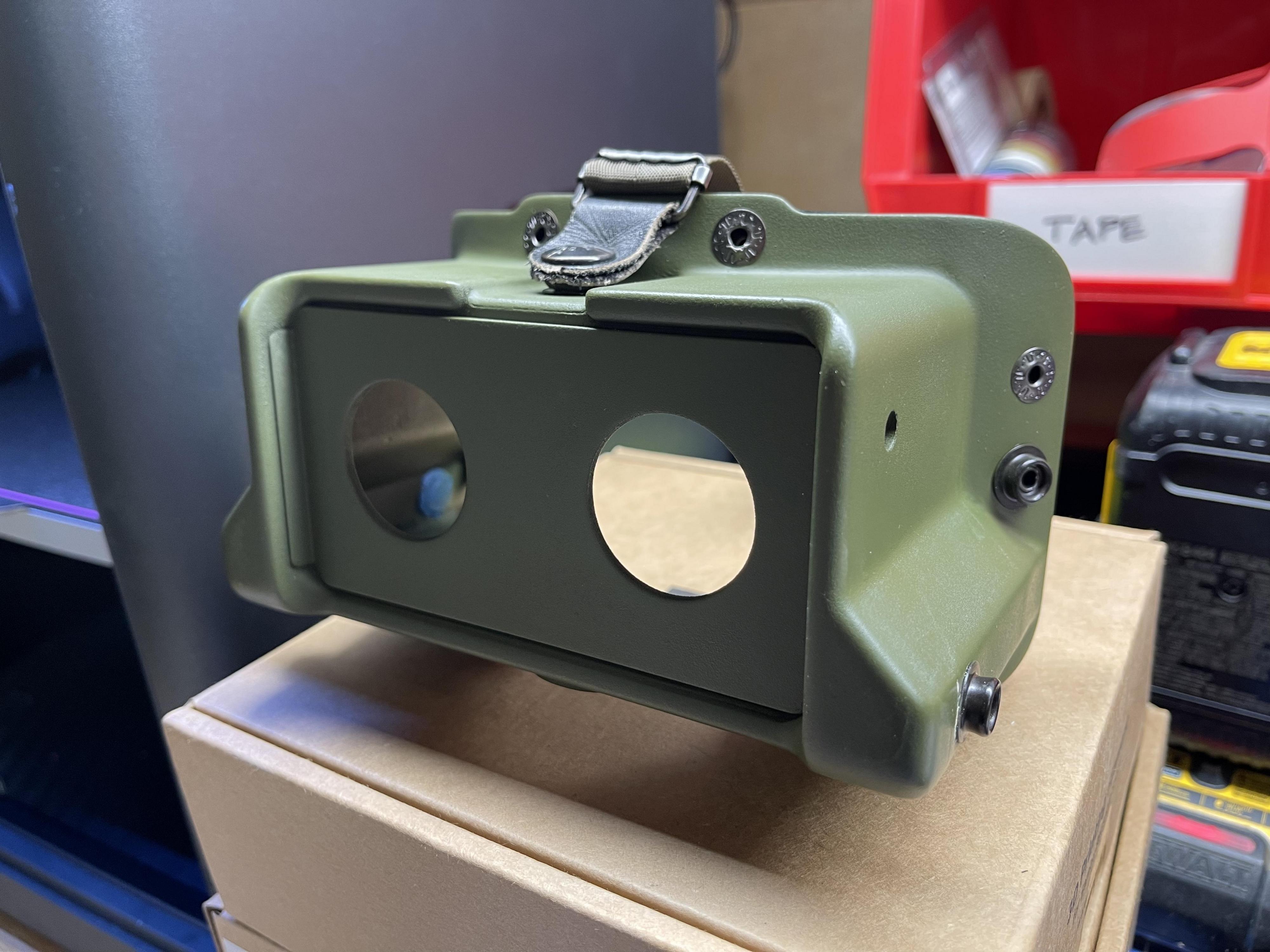

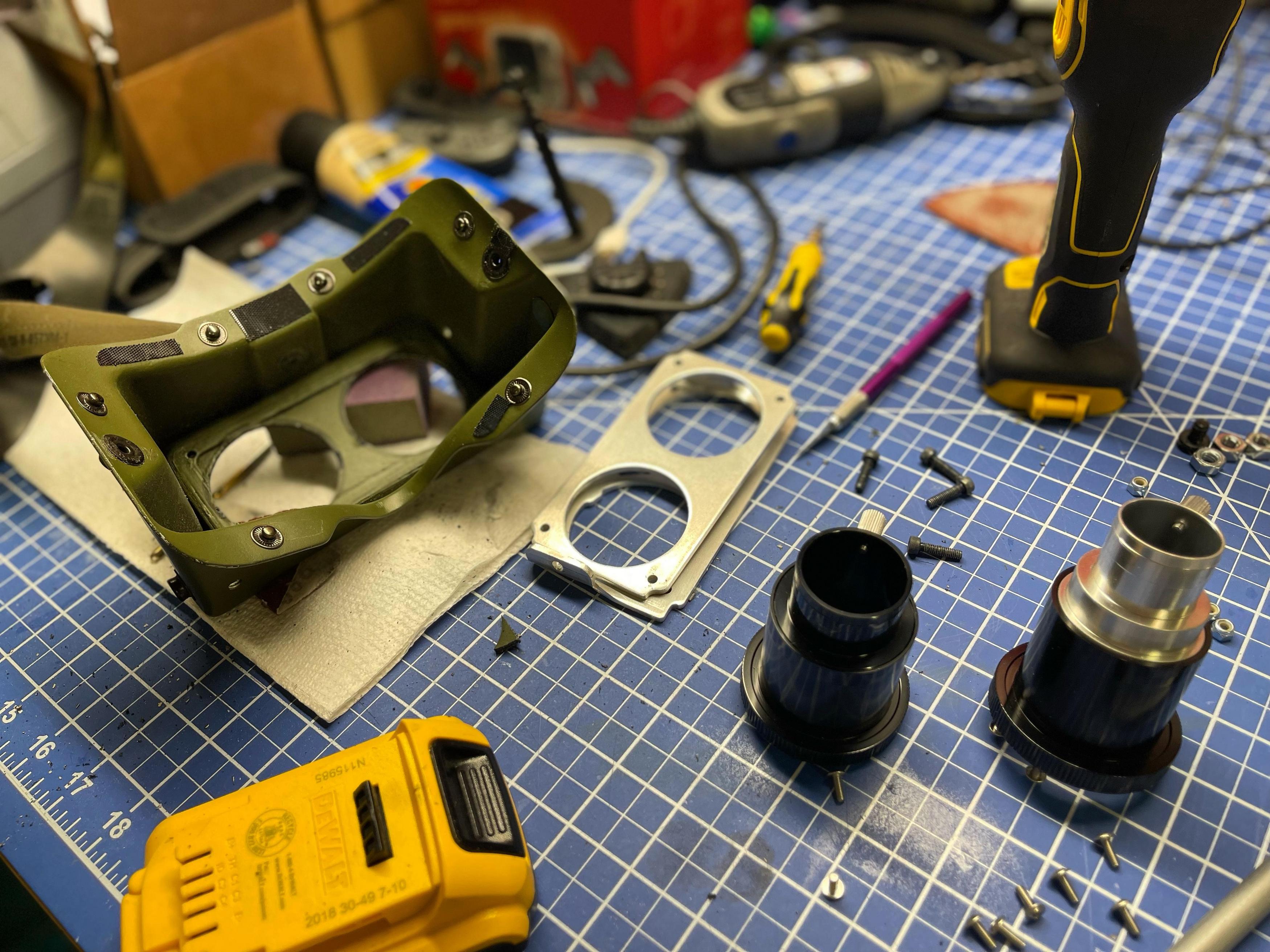

And then a coat of Tamiya Olive Drab (TS-28). Once this had a day or two to cure, I was onto snaps! Snaps were a new thing for me on this project. Attaching the snaps to the 3D print I had just spent a couple of weeks painstakingly priming and painting was VERY TRICKY. Especially those two snaps toward the lower front corners. The tool I had was a bit too wide to fully clamp the snaps down in that tight area, and I slightly damaged the frame trying to find a way to get them to secure. I ended up having to improvise a bit by using a really big pair of channel locks to squeeze a rod to crush down the center of each of those snaps. This was maybe the most difficult part of the build for me, but I wanted to learn!

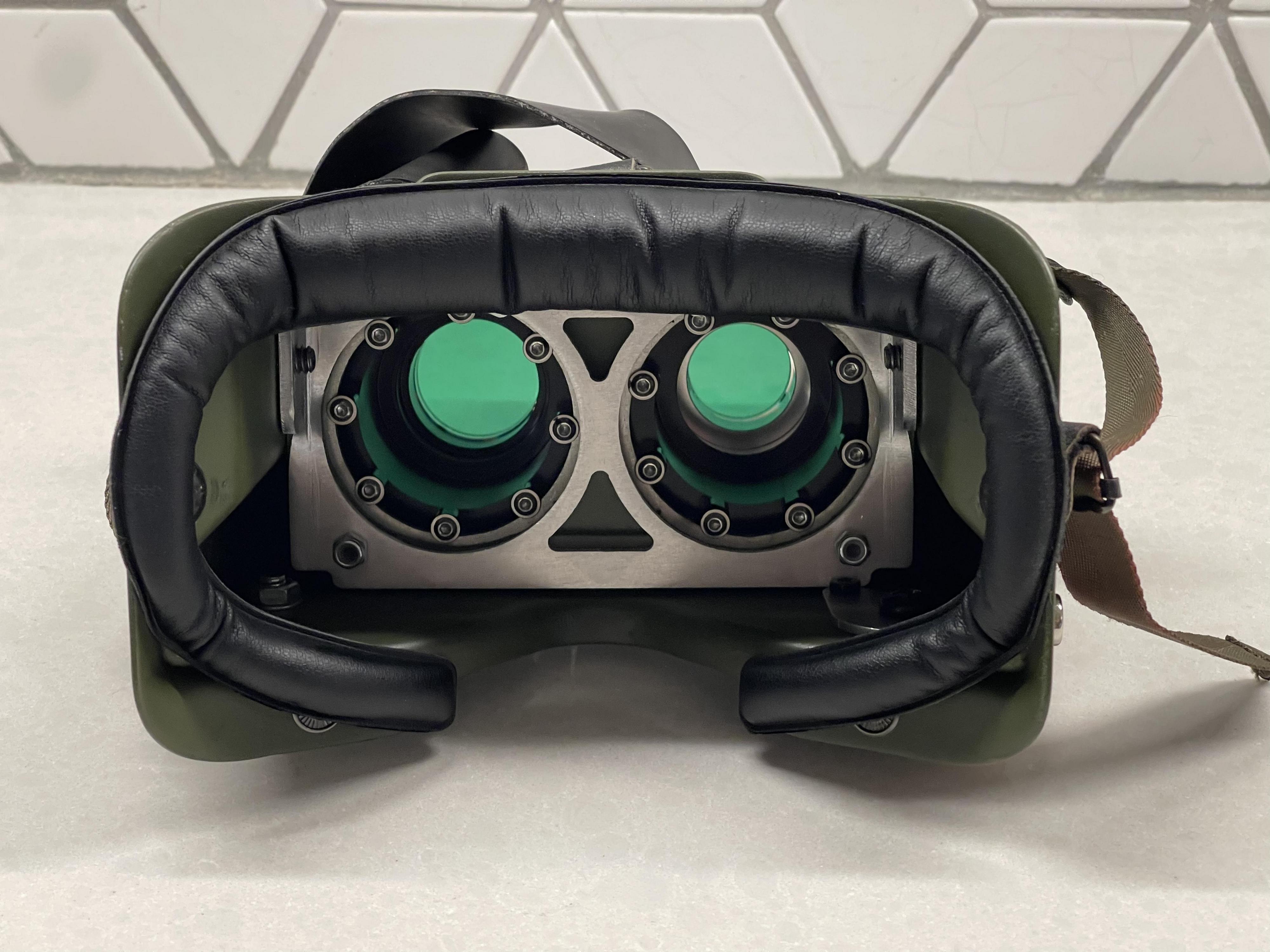

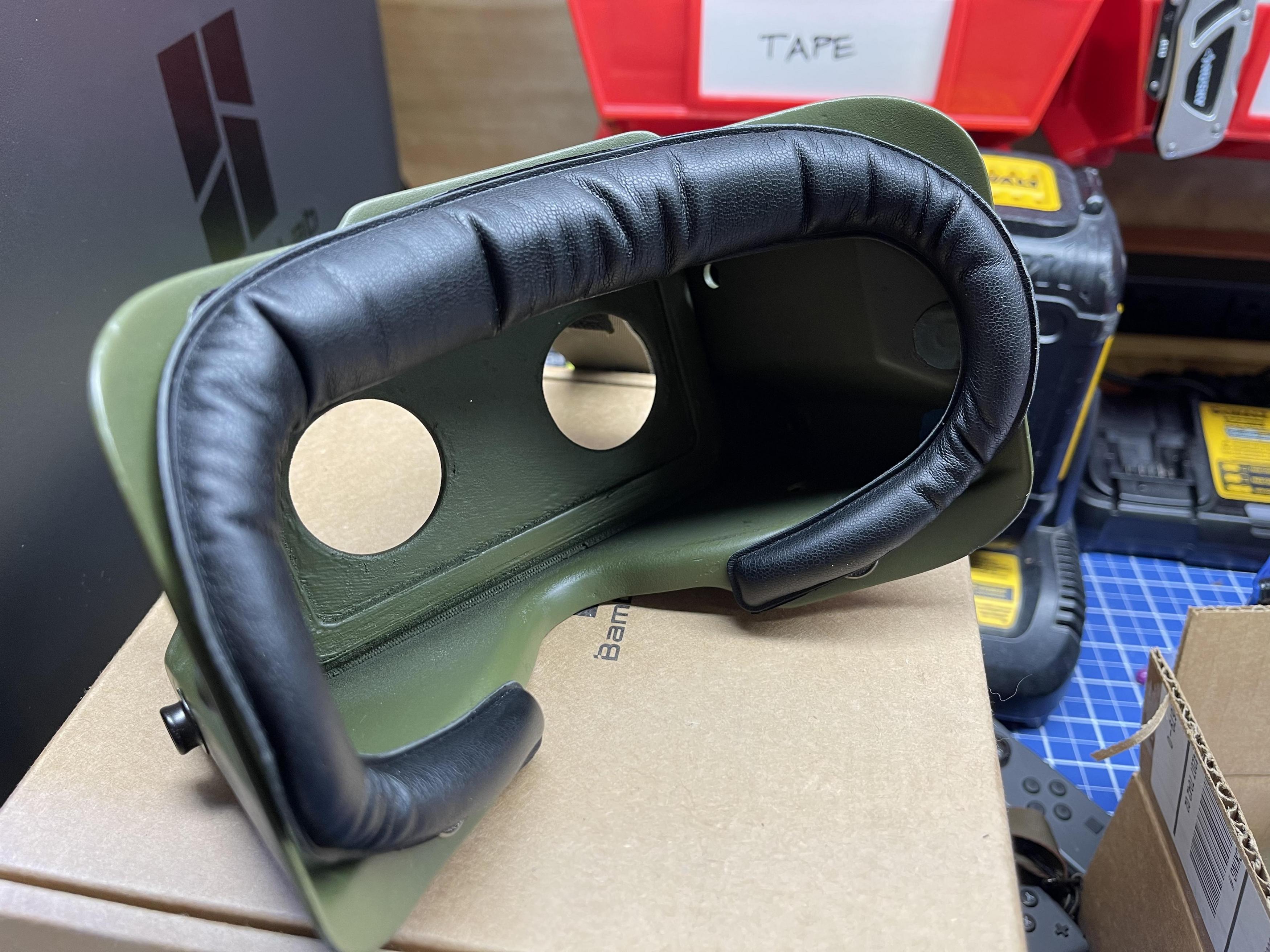

At this point, I was trying to find something to use as a face pad. I considered laser-cutting foam, but liked the aesthetic of the shiny foam filled leather you see on some headphones from the 70s-80s. I found a third party Meta Quest face pad on Amazon that had this look, and while a little small vertically, I found a position that I was happy with on the frame. The pad is intended to Velcro to the frame it came on, so I just transferred some small sections of that Velcro over to my frames.

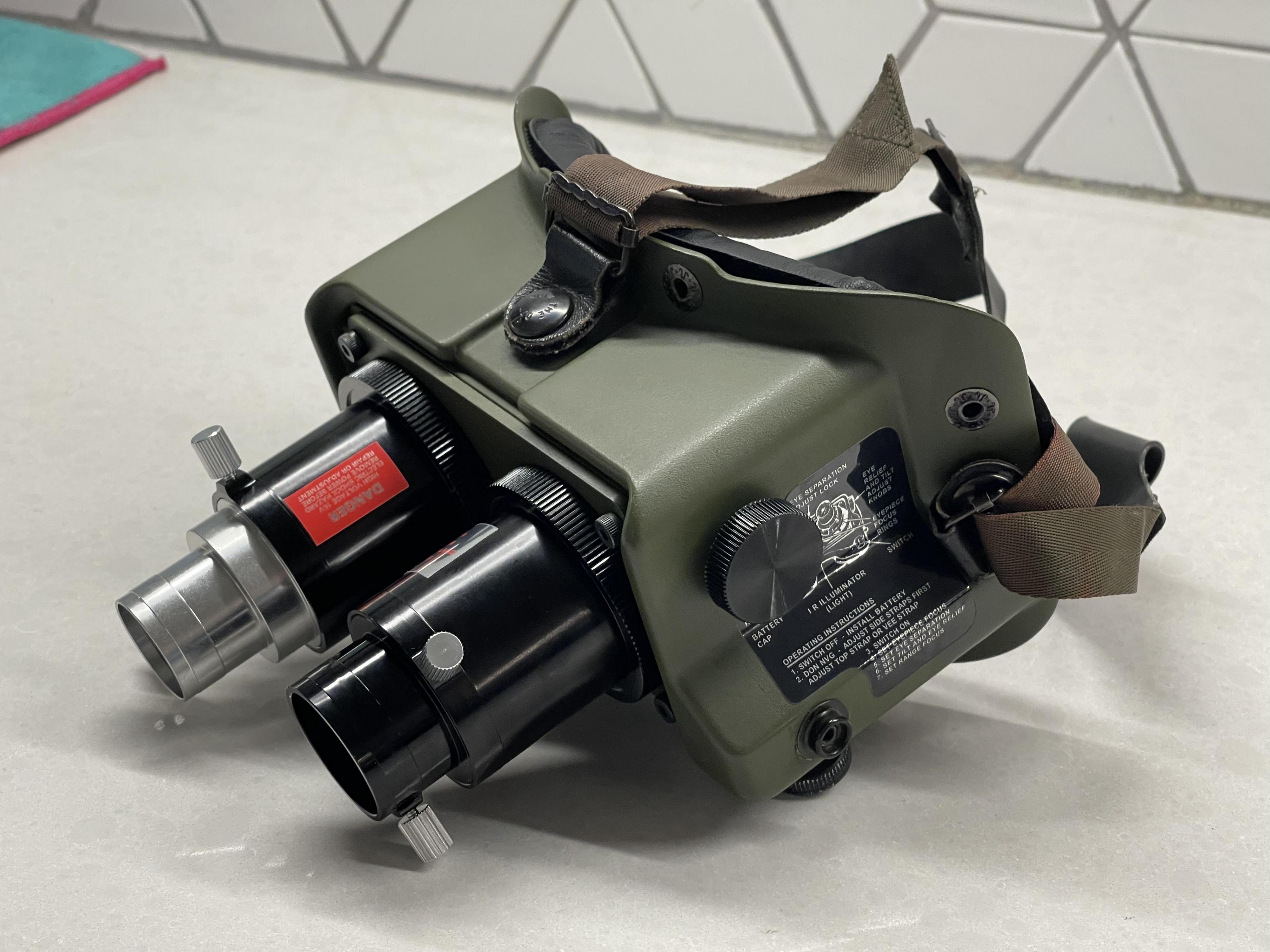

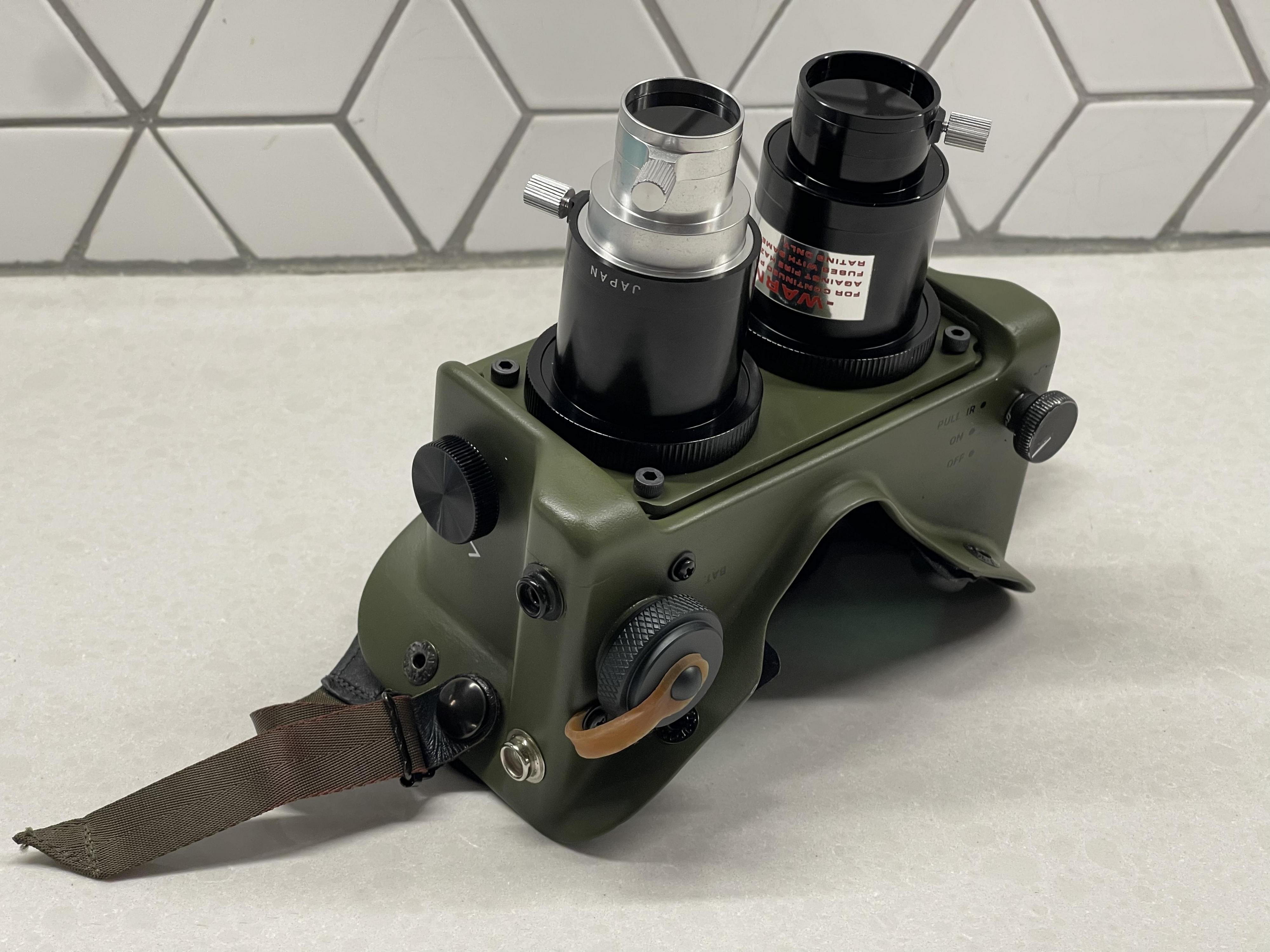

Now I was on to the final stretch, and was liking how things were shaping up so much that I decided to pull the trigger on a gorgeous set of GBfans goggle lenses. These things are so nice looking, and really help sell the Goggles as 'real' - If you can shell out for them, I highly recommend them for this prop.

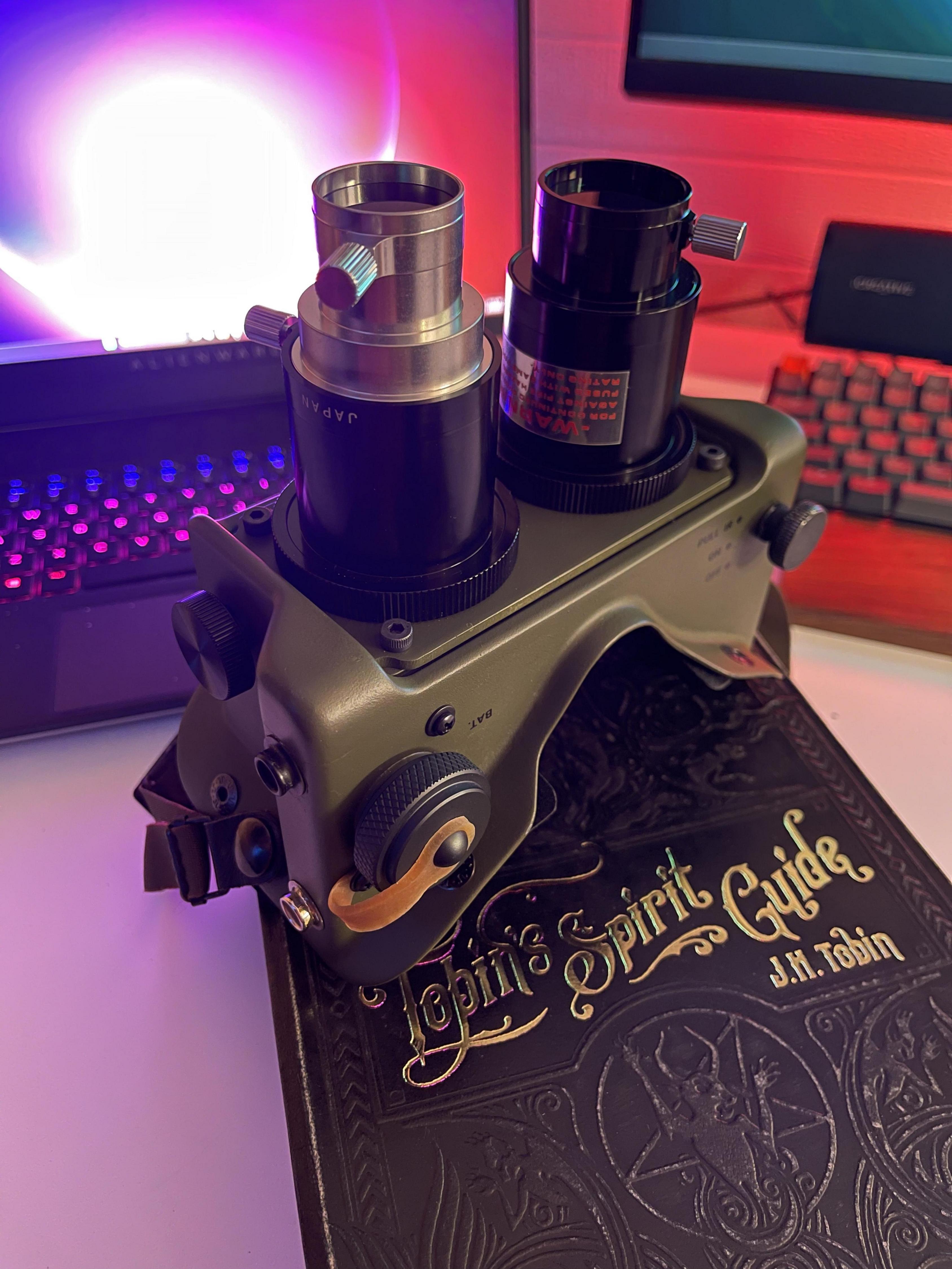

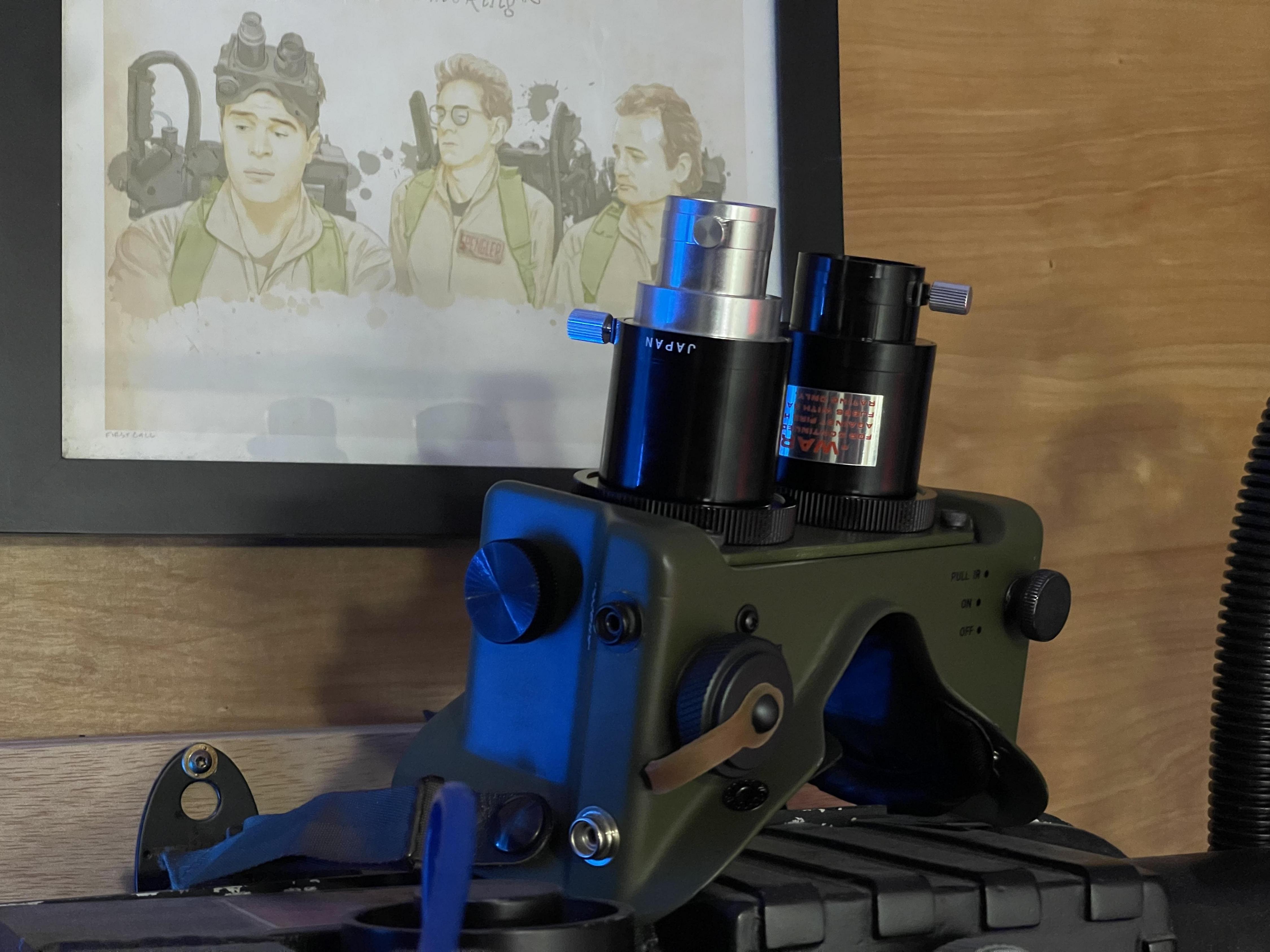

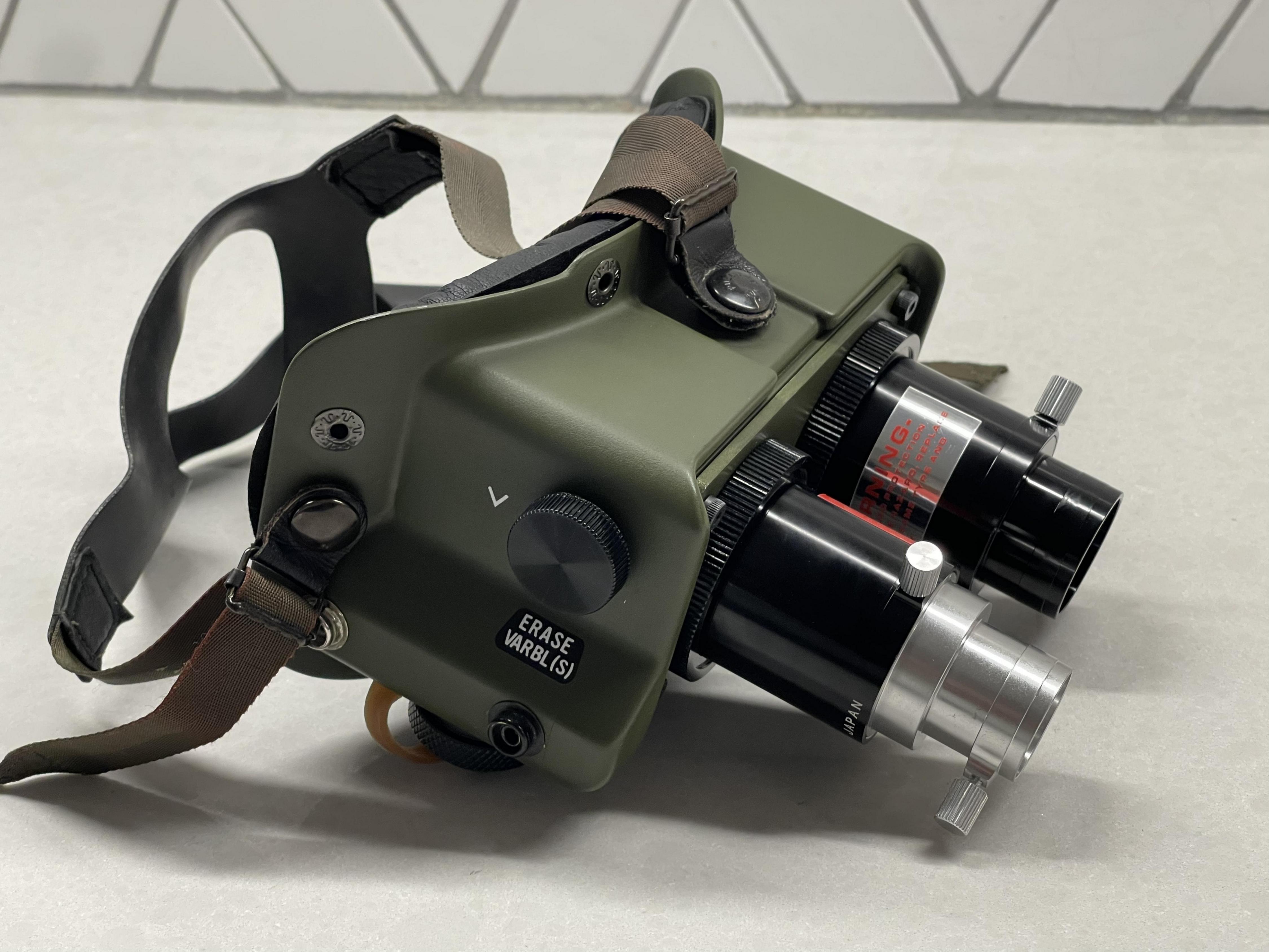

And here are some shots of the final assembly!

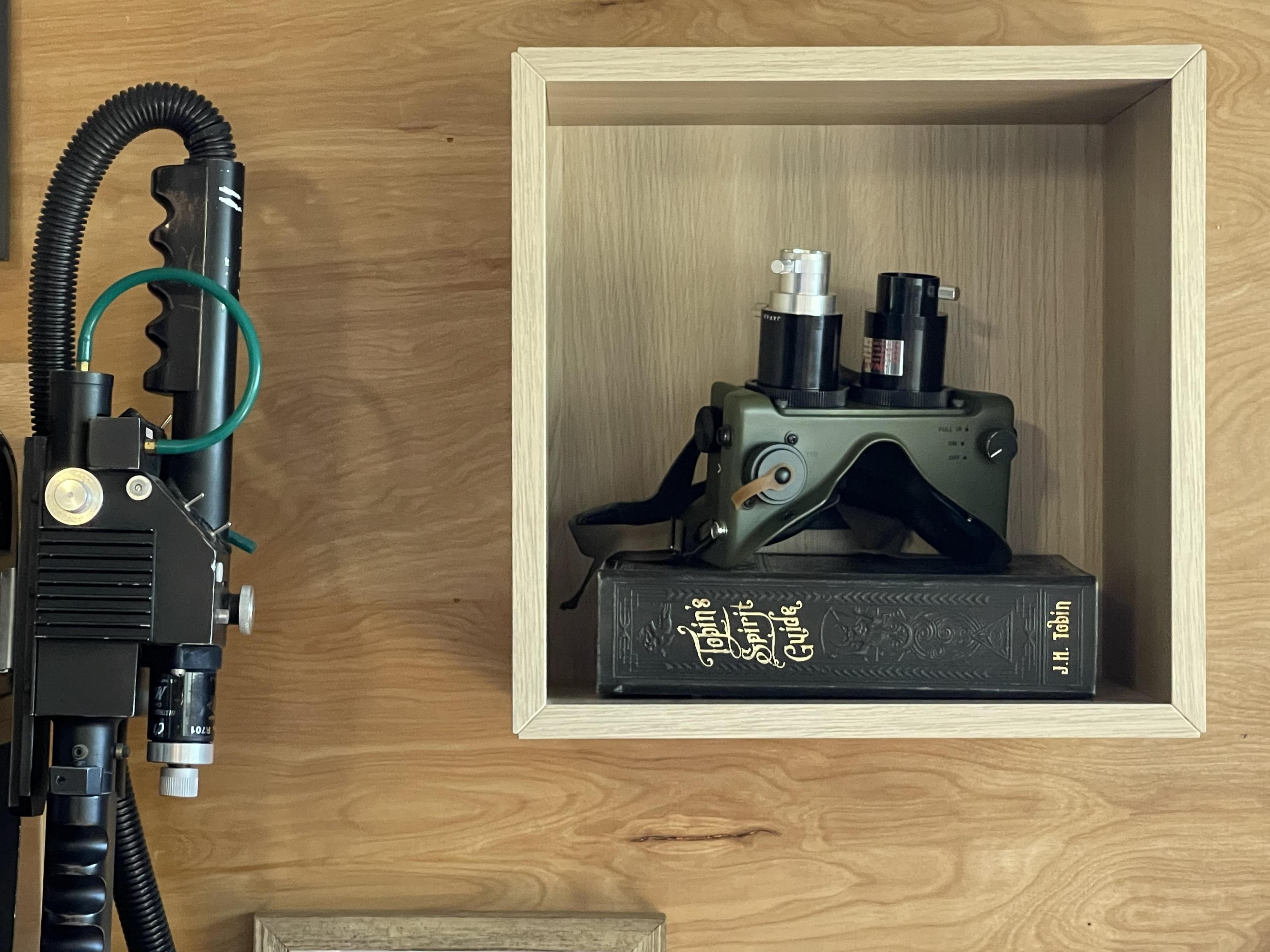

And finally, another addition to the corner of my studio
