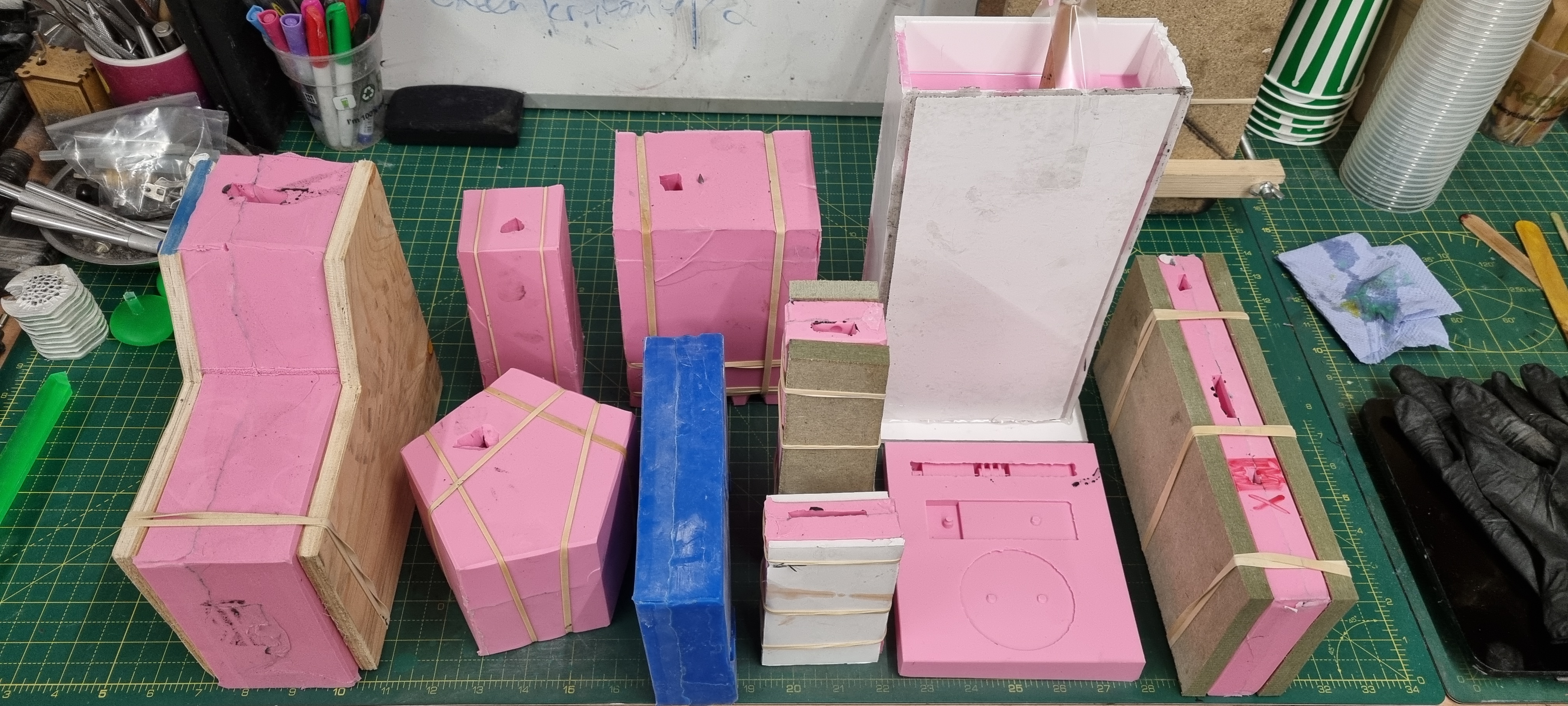

Here is this weeks progress and its a big one :D

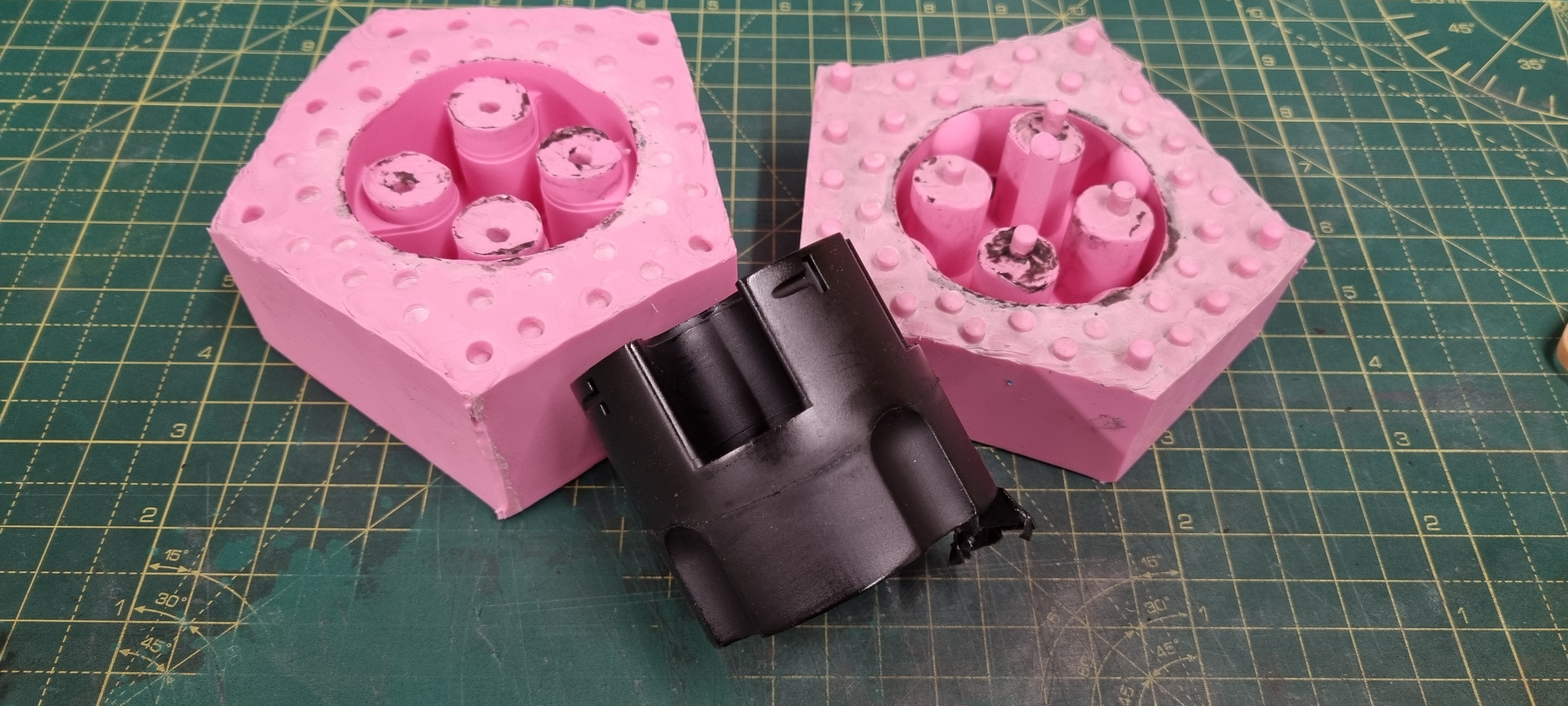

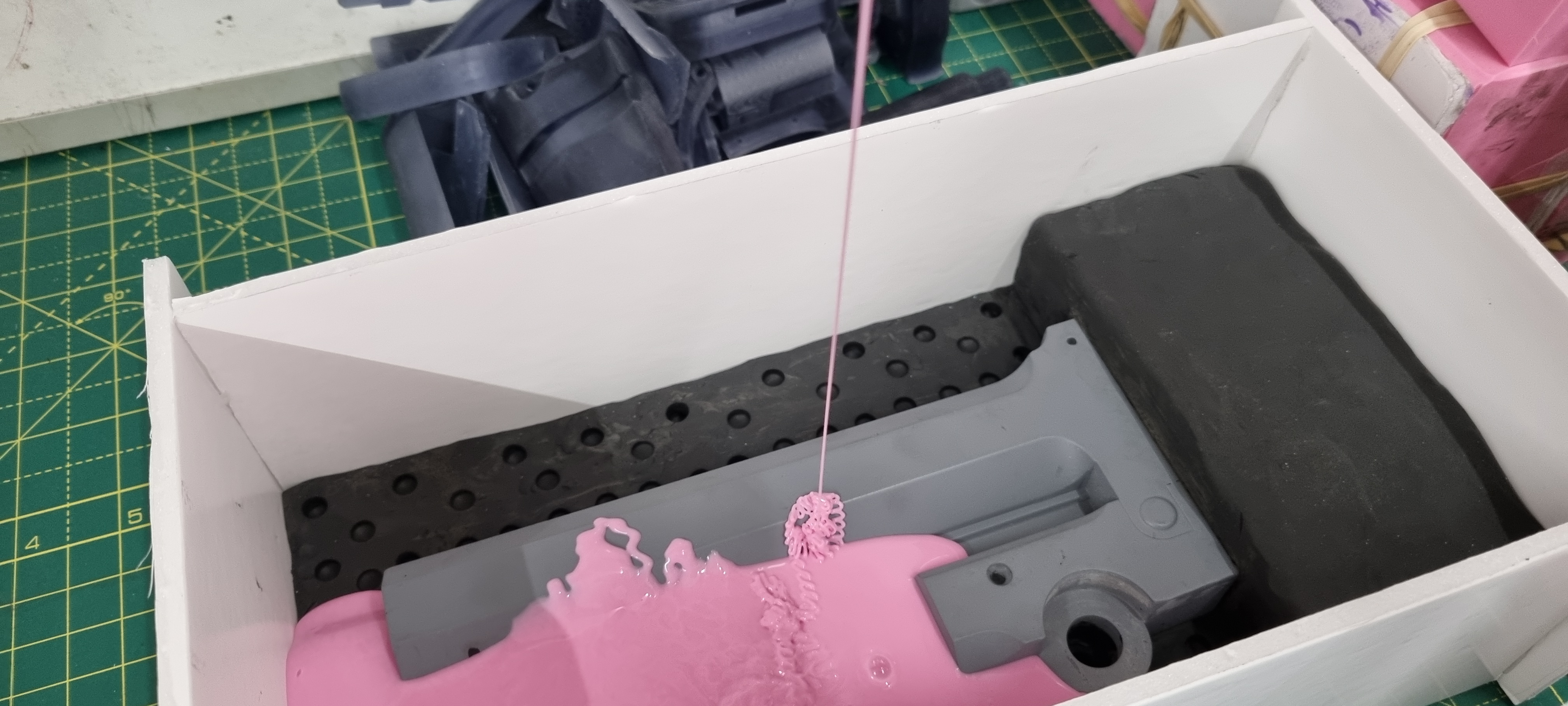

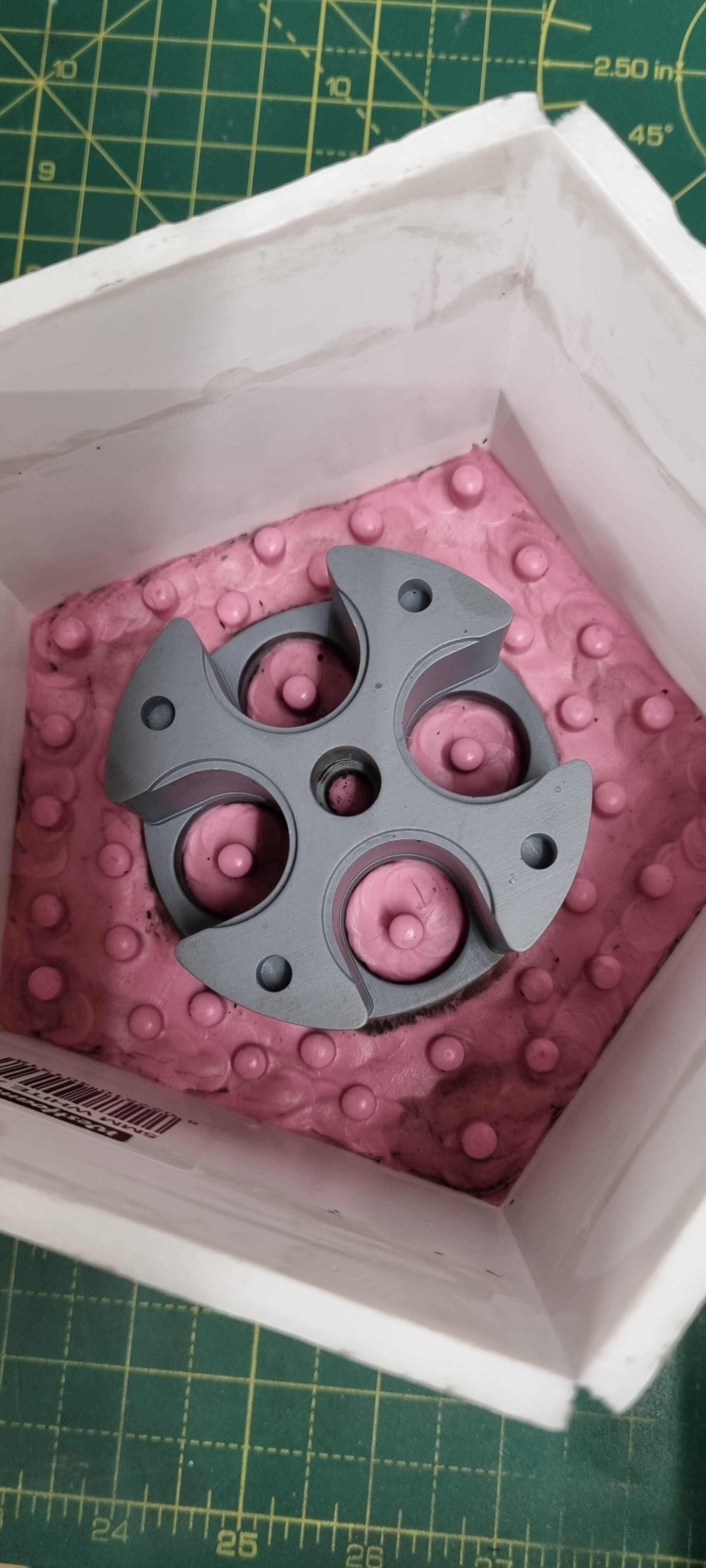

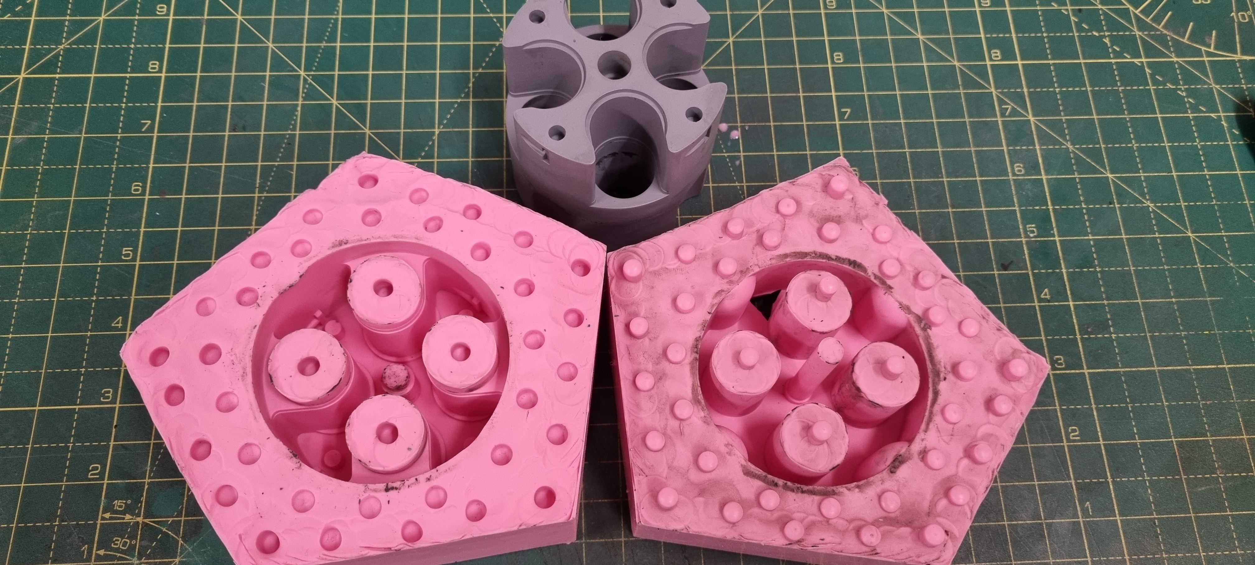

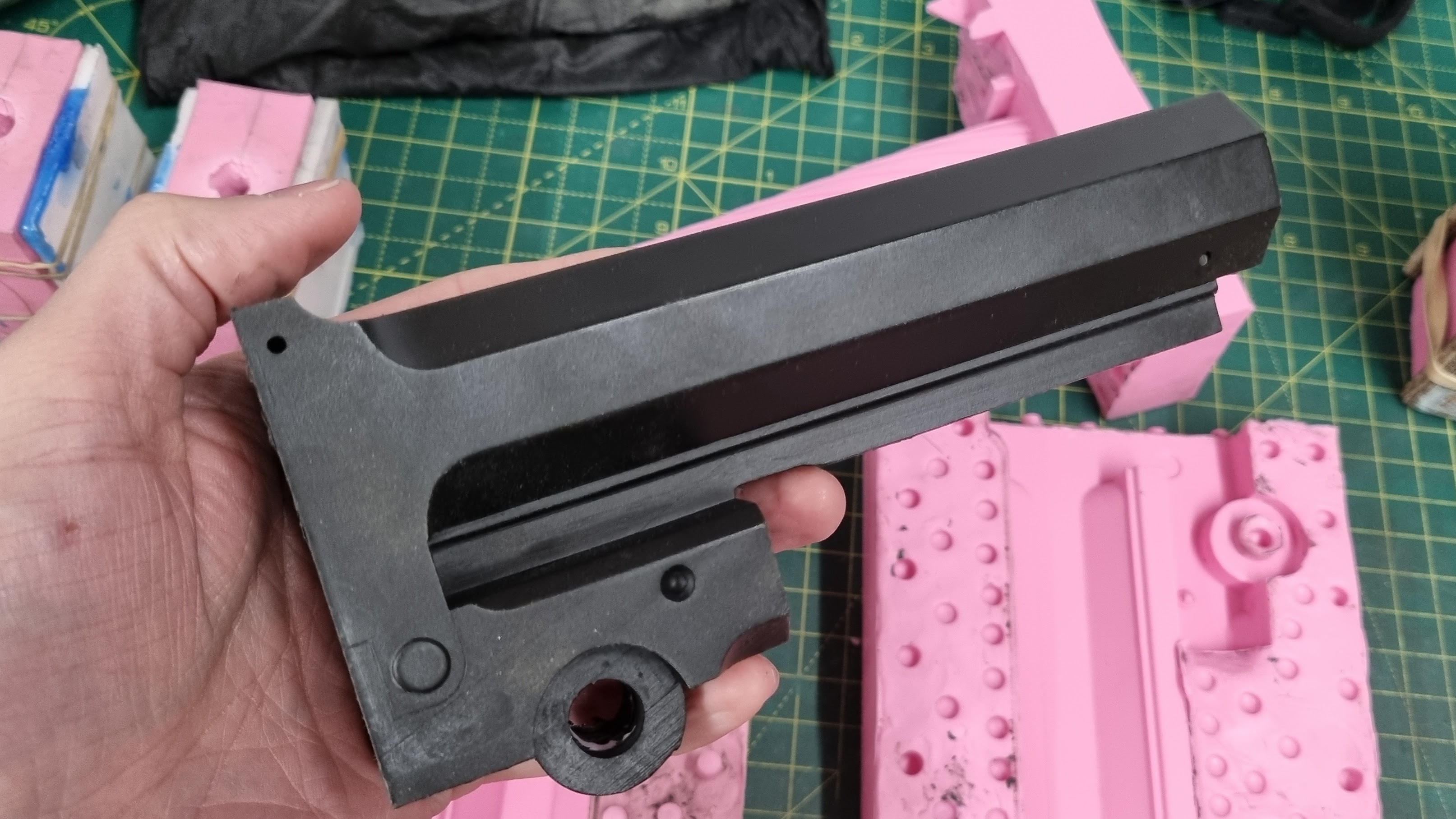

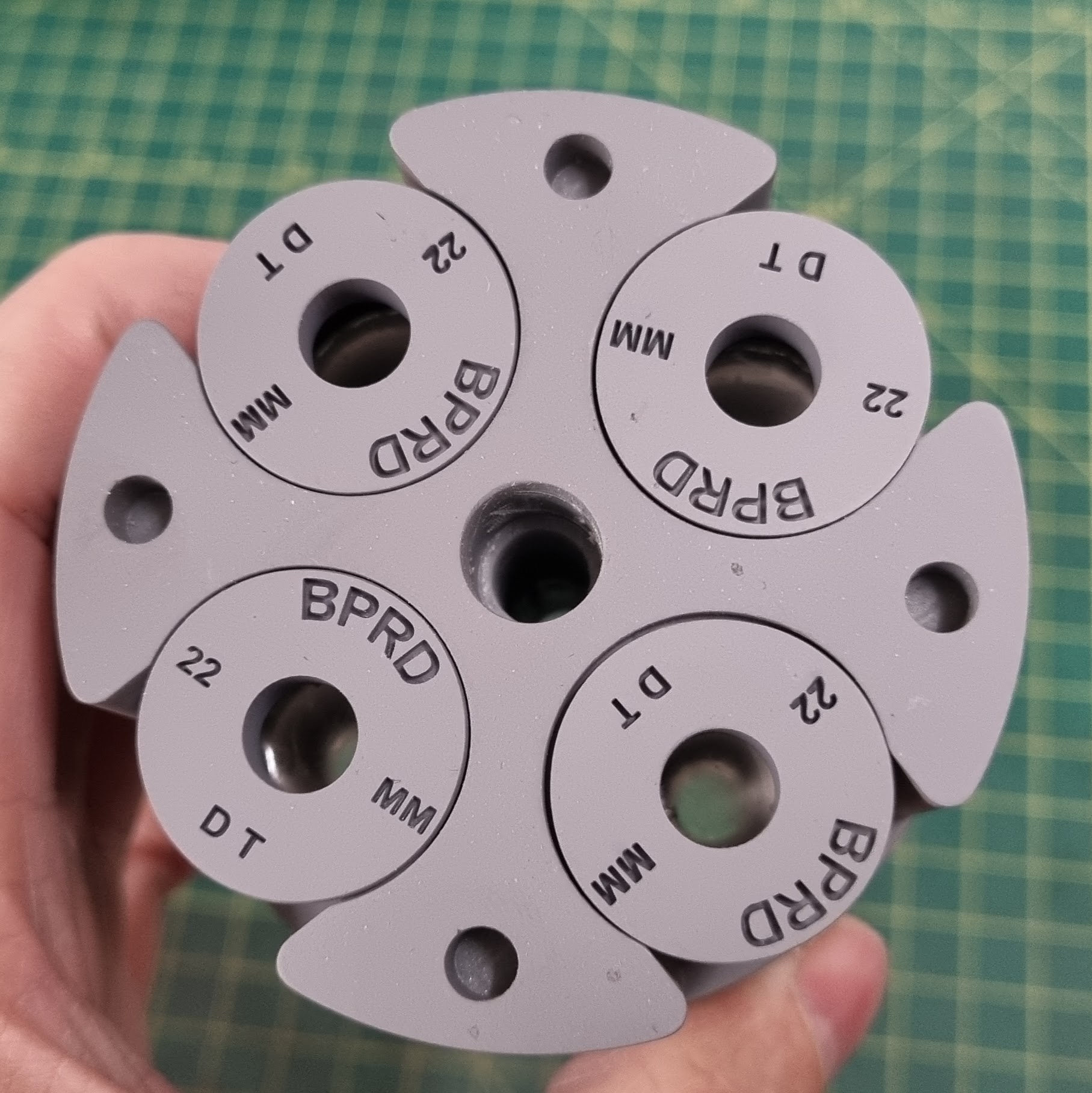

So thats all the moulding done! and there is quite a lot of silicone used lol

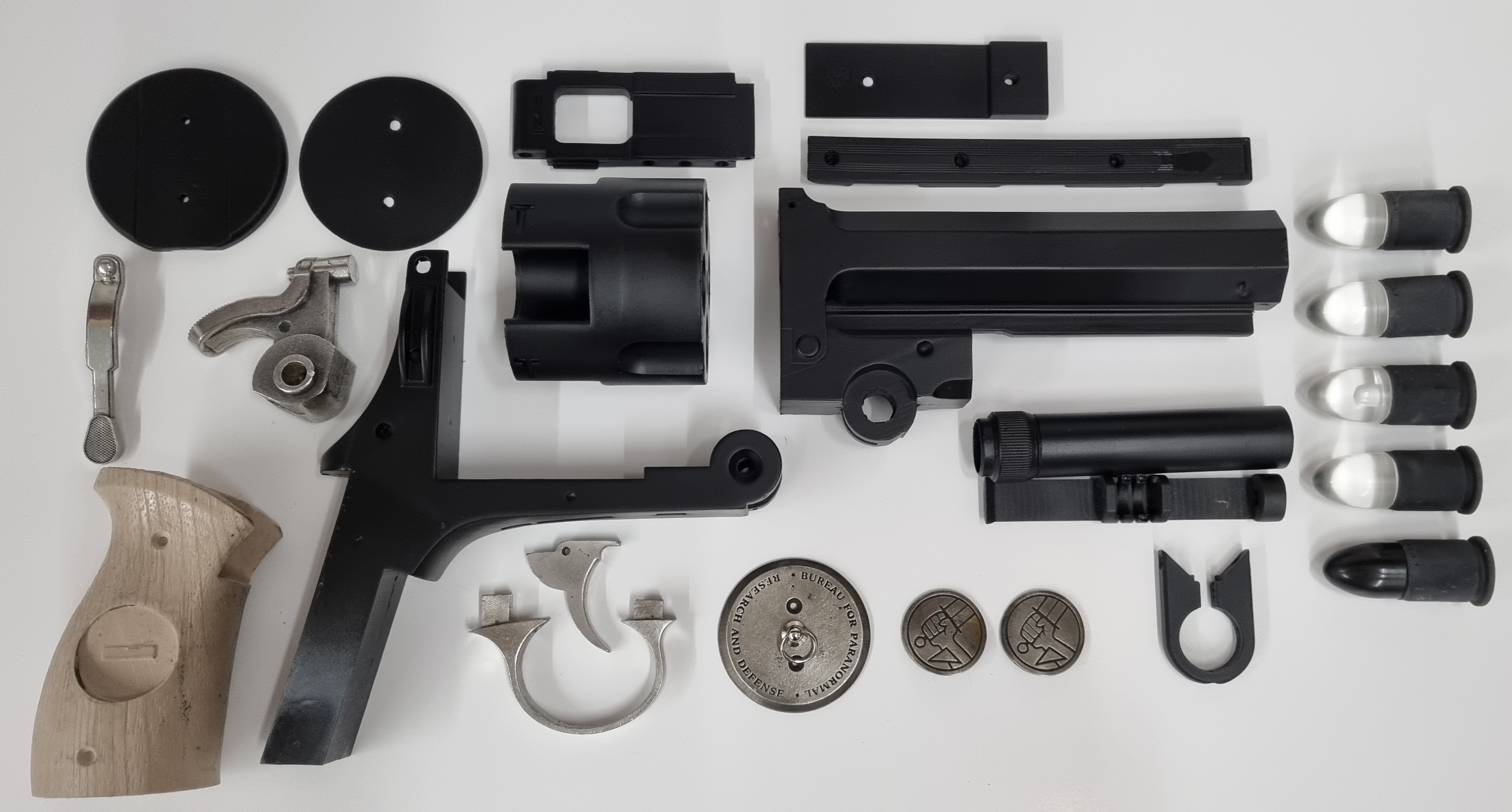

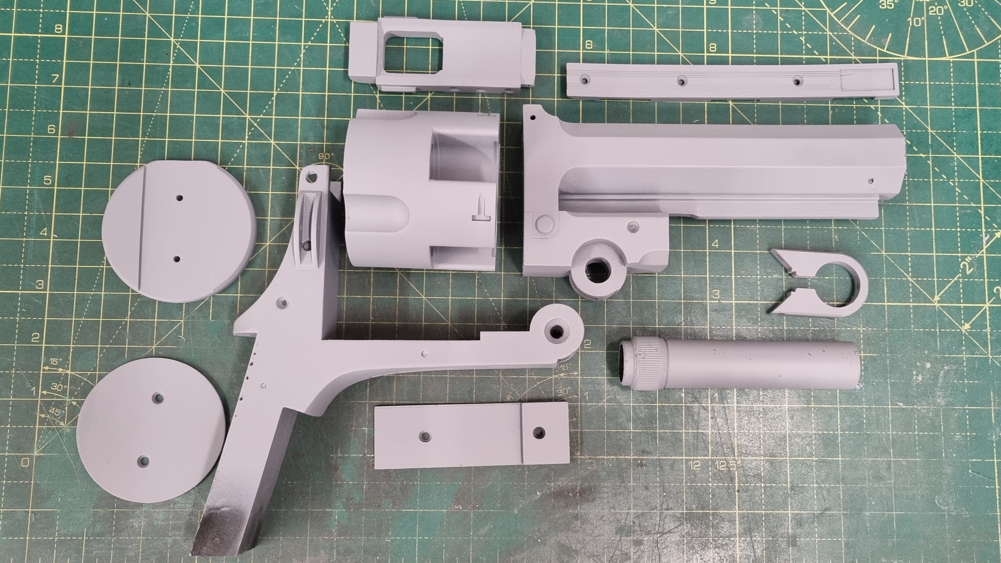

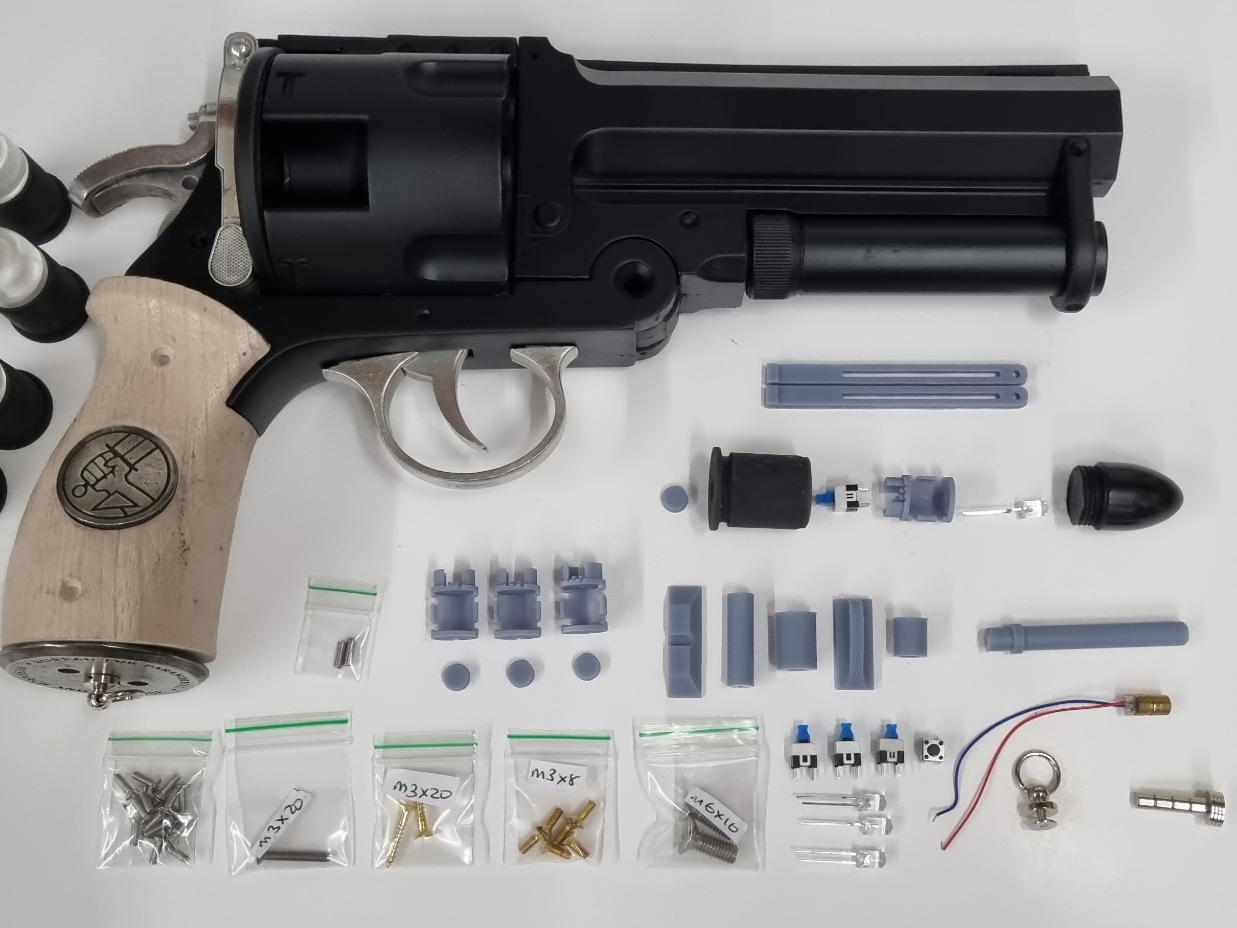

Next up is to sand the Casts.

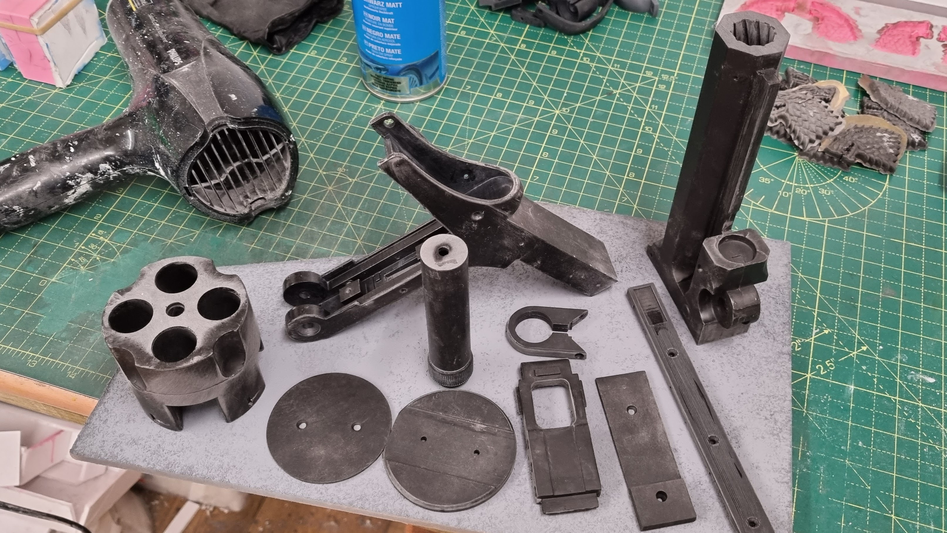

Prime them.
Then a layer of Matt Black and some knolling :p

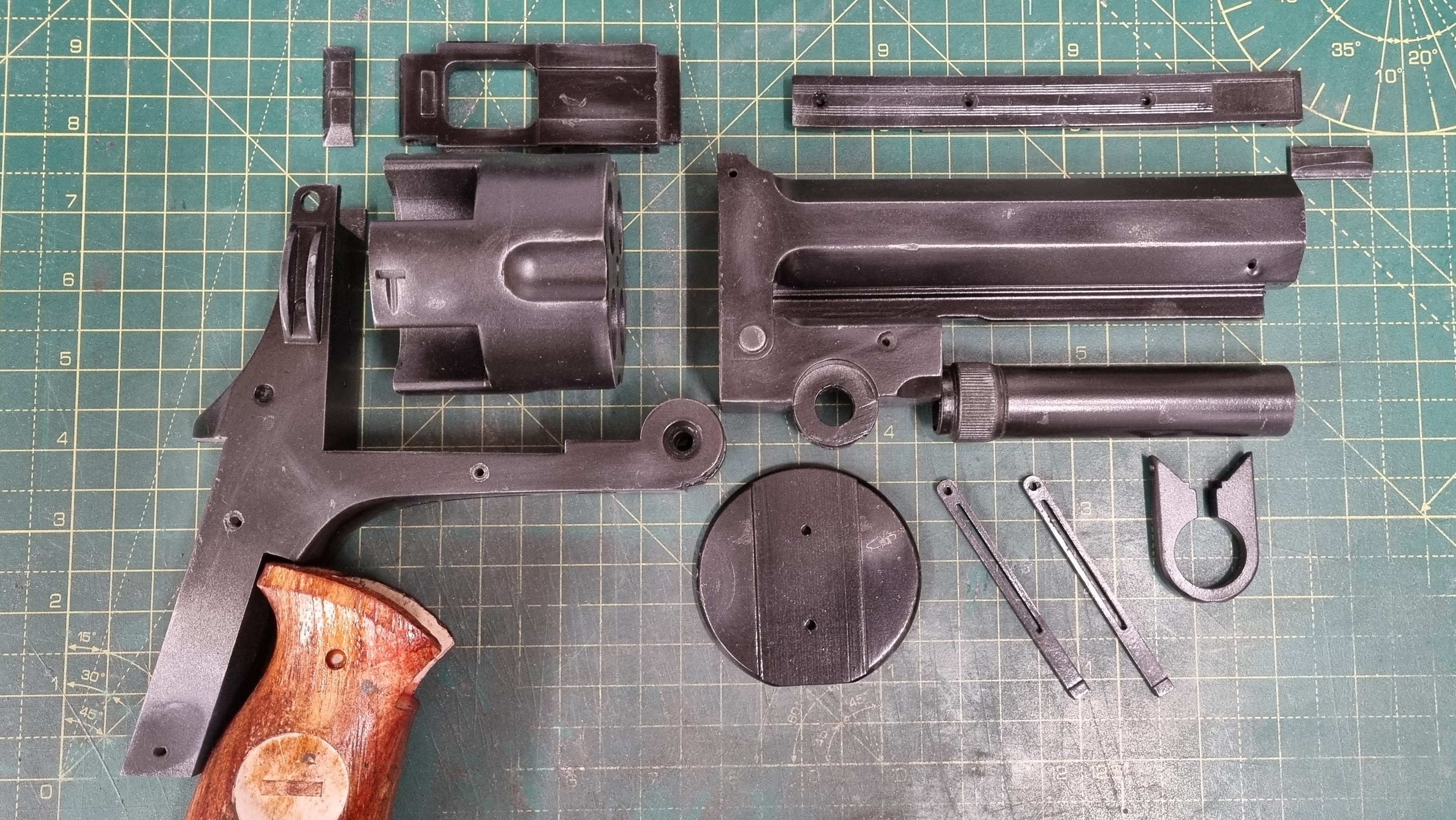

Finally a dry fit!
So next job is to drill and tap all the screw holes, then I will give it a coat of silver and then its final coat of Gunmetal before weathering. Once that is done I need to work on the electrics for the Bullets and Laser and finally put it together!

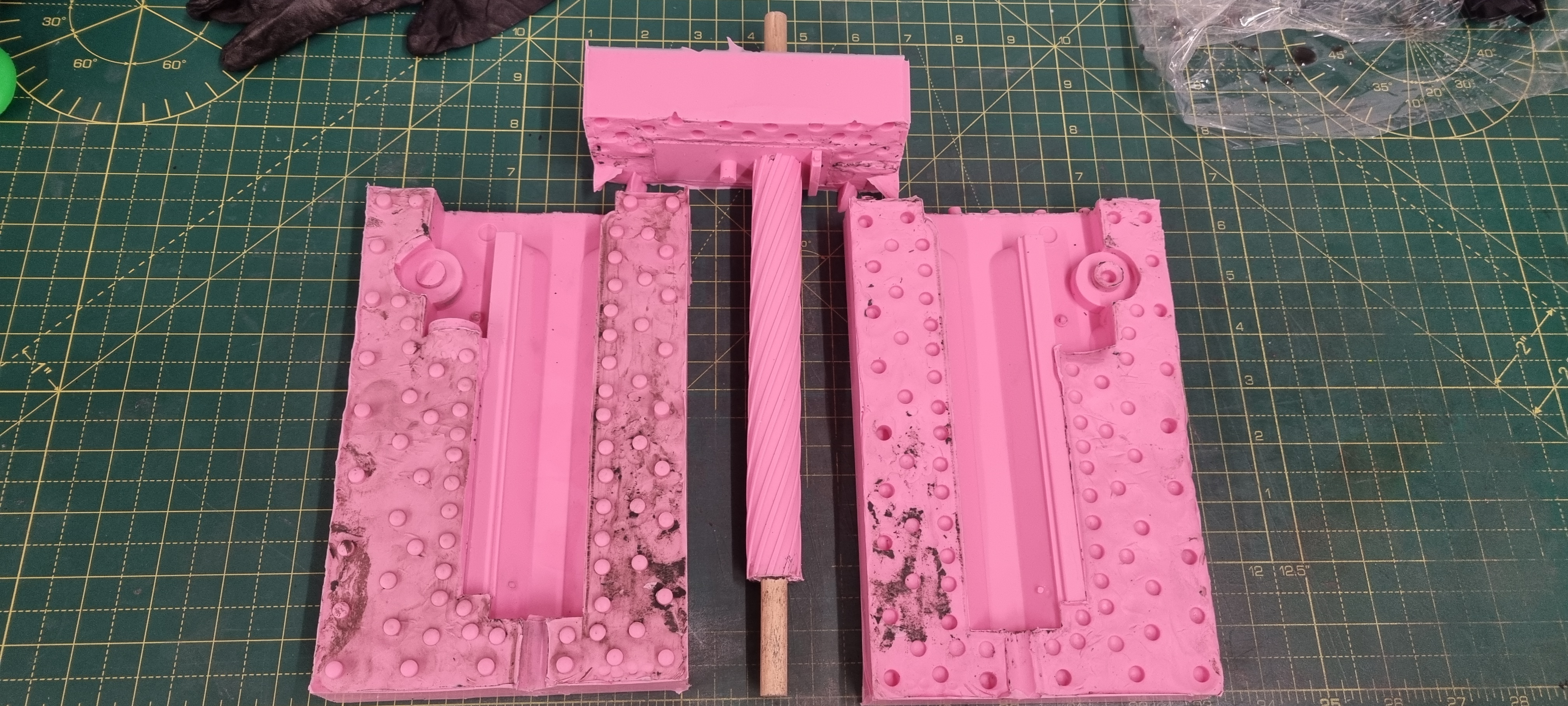

oh cool! that's a nice update indeed!

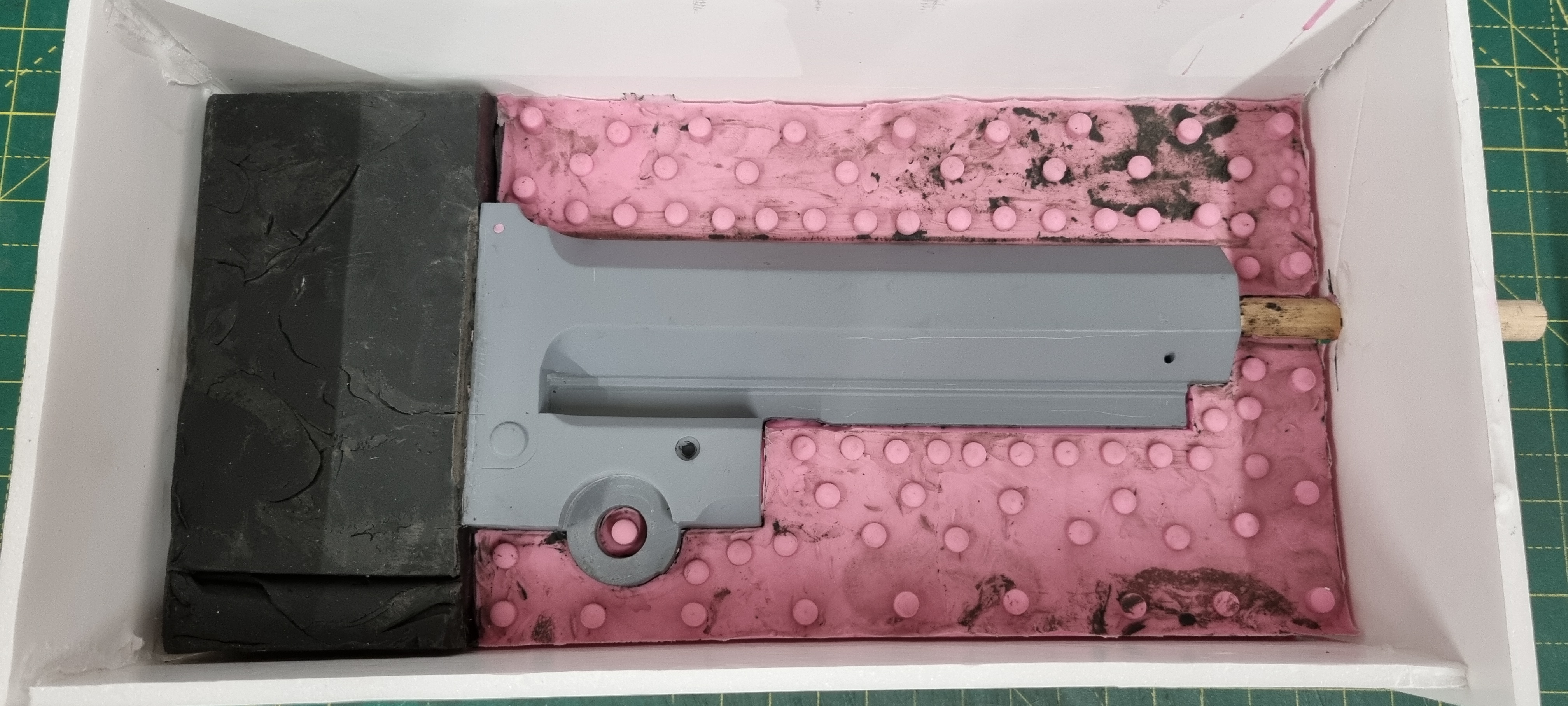

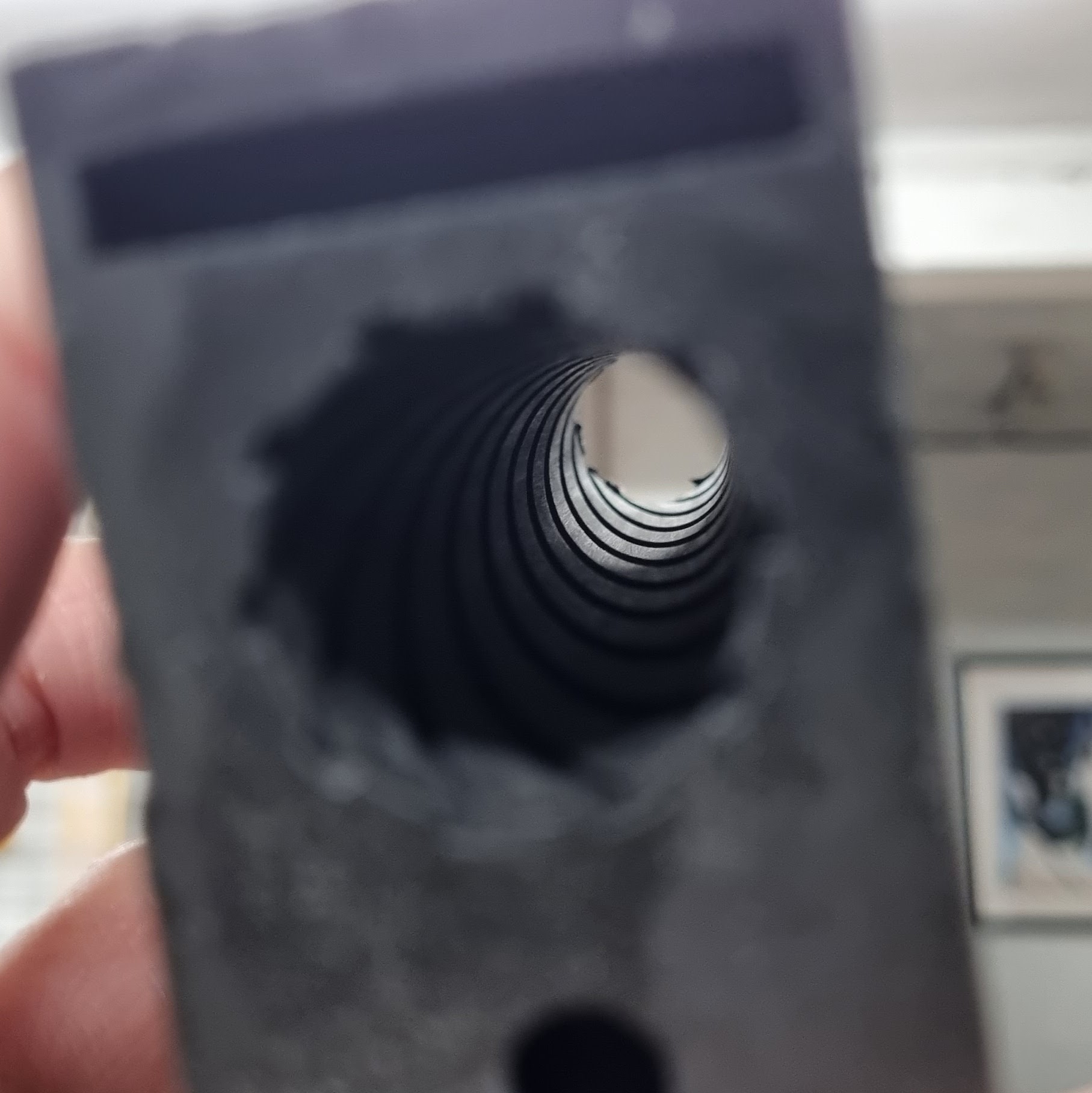

removing the center part of the mold with the rifling on it must not be easy!
That's what the wooden dowel is for, it helps keep the mould centred and once it's cast I can pull it out of the silicon so that's it's more flexible to remove

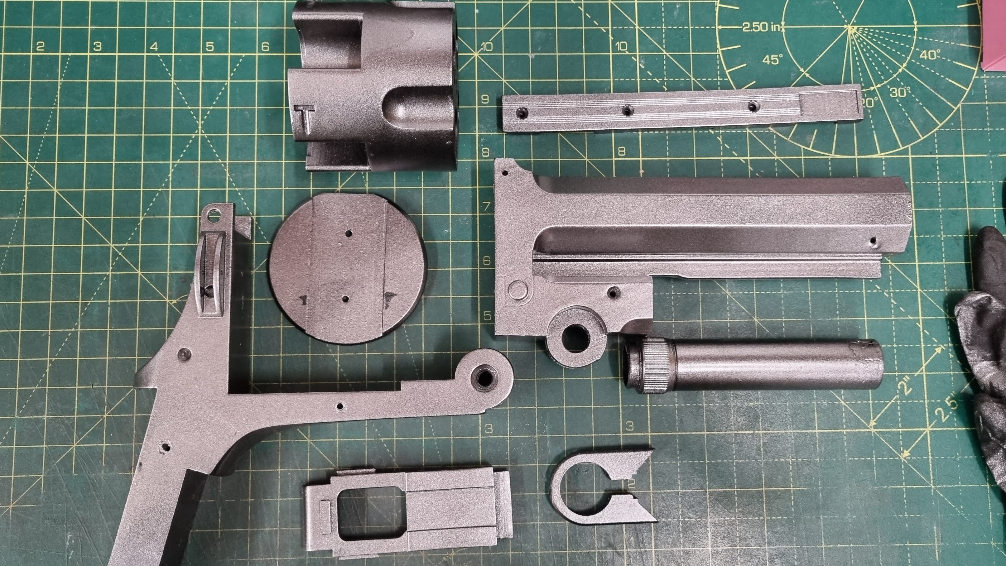

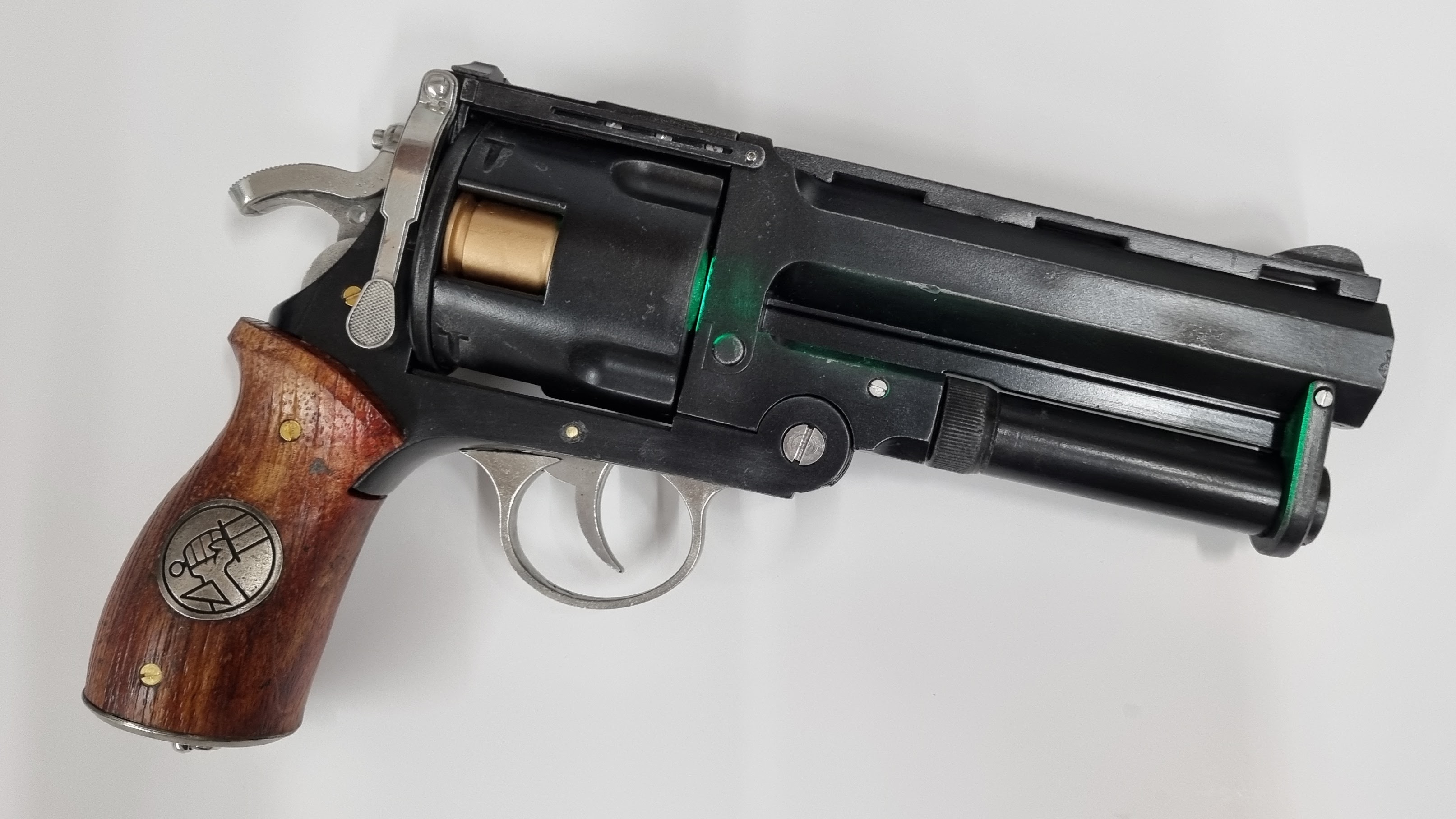

So today I got to do a good chunk of the finishing work. After I Primed and sprayed it Black I added a silver layer to the parts that are exposed to the elements.
Then I hit it a few times with a hammer o_O and sprayed a coating of mixed Black and Gunmetal. Once that was dry I went at it with some 0000 Wire Wool to bring up all the scuffs and worn edges.
I also gave the handle a faux wood effect following this video guide...

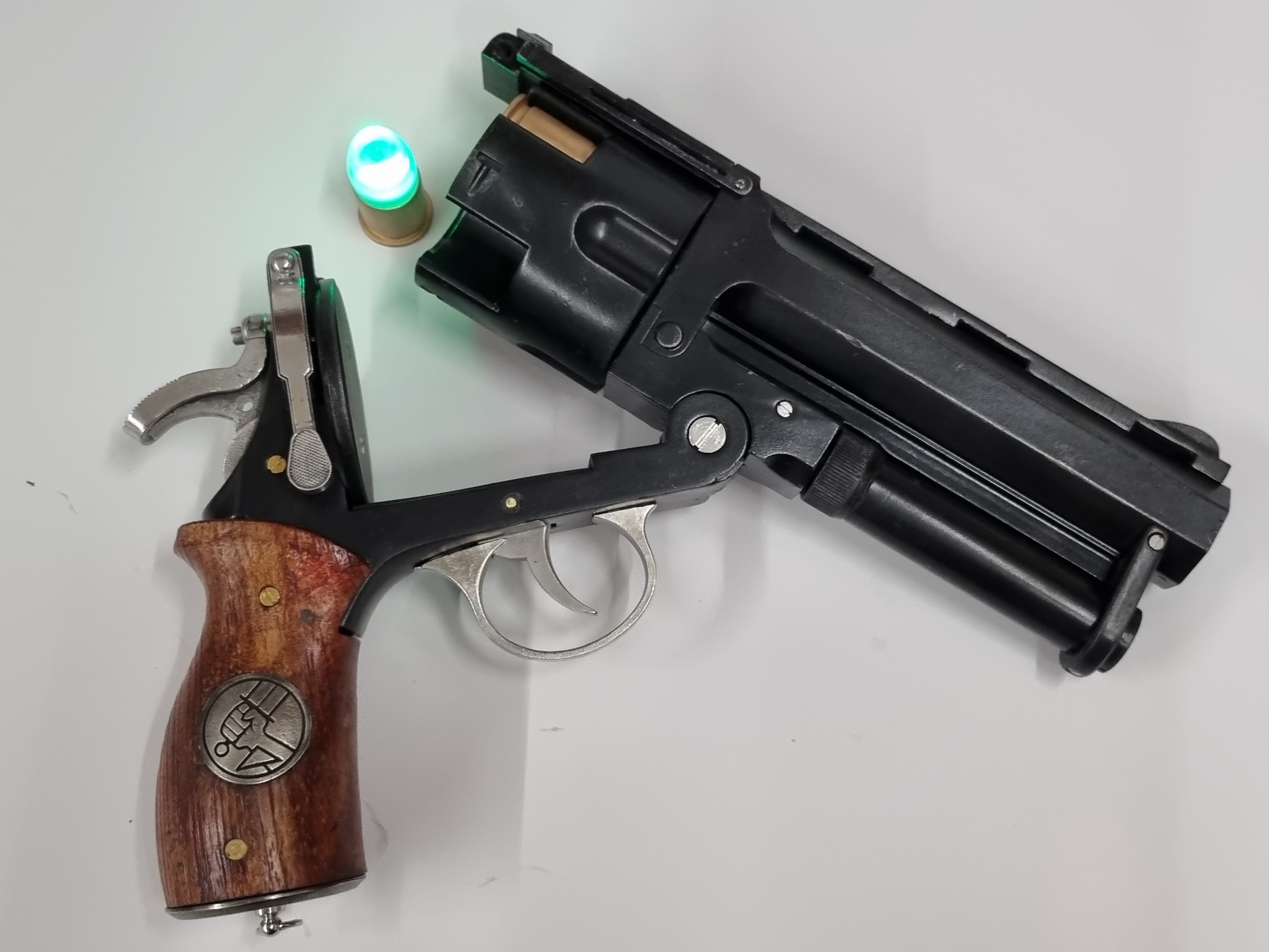

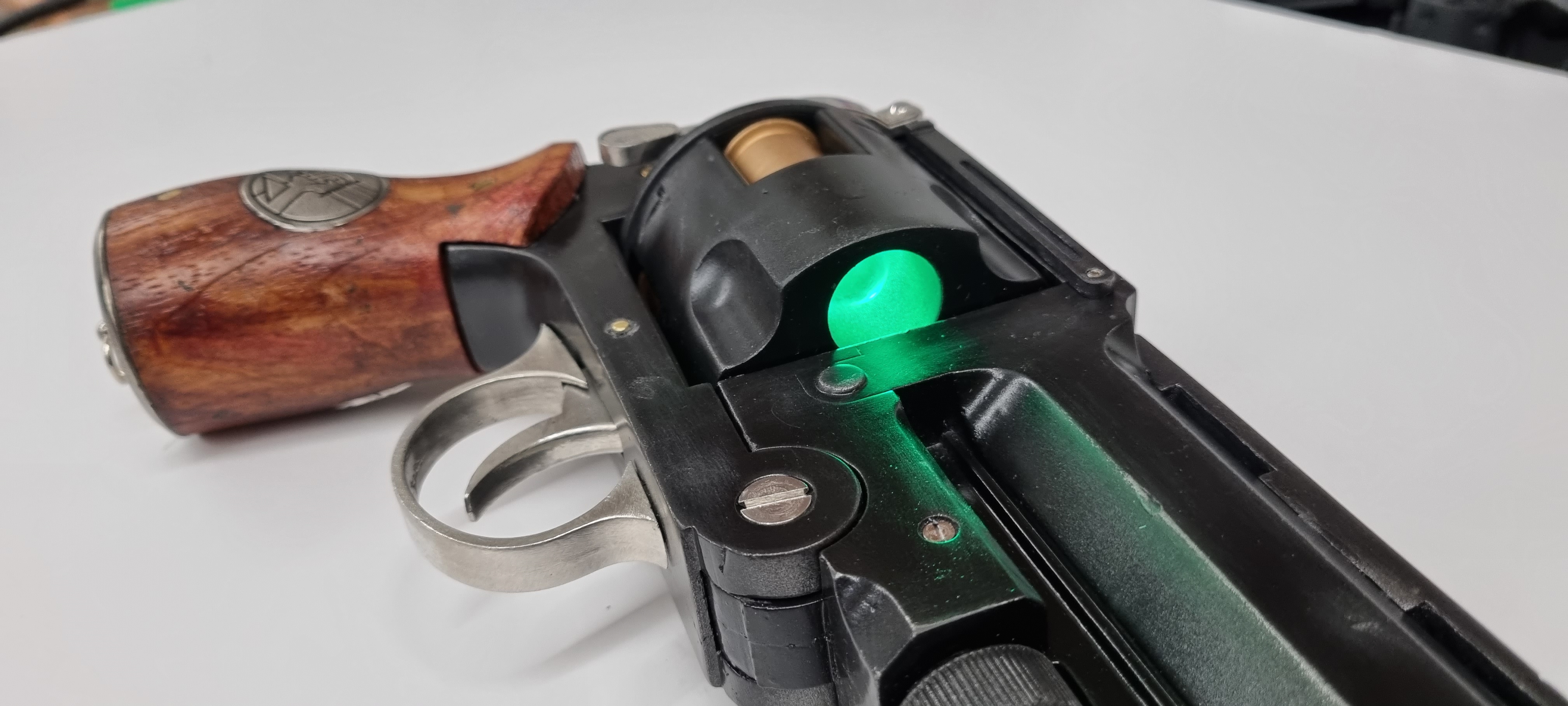

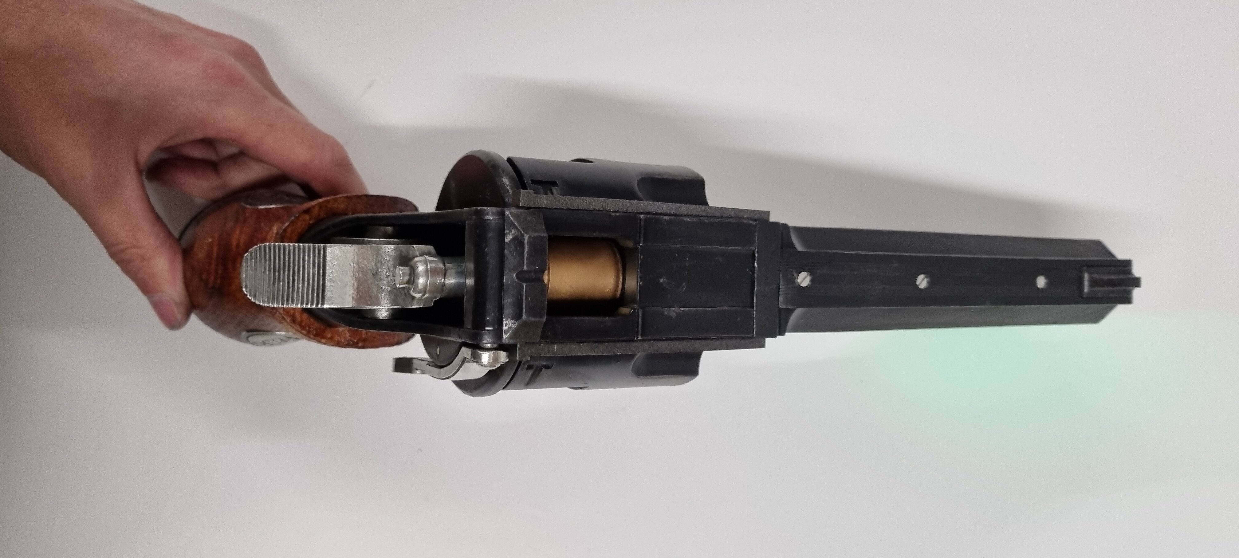

After that I drilled and tapped the holes and put it together!

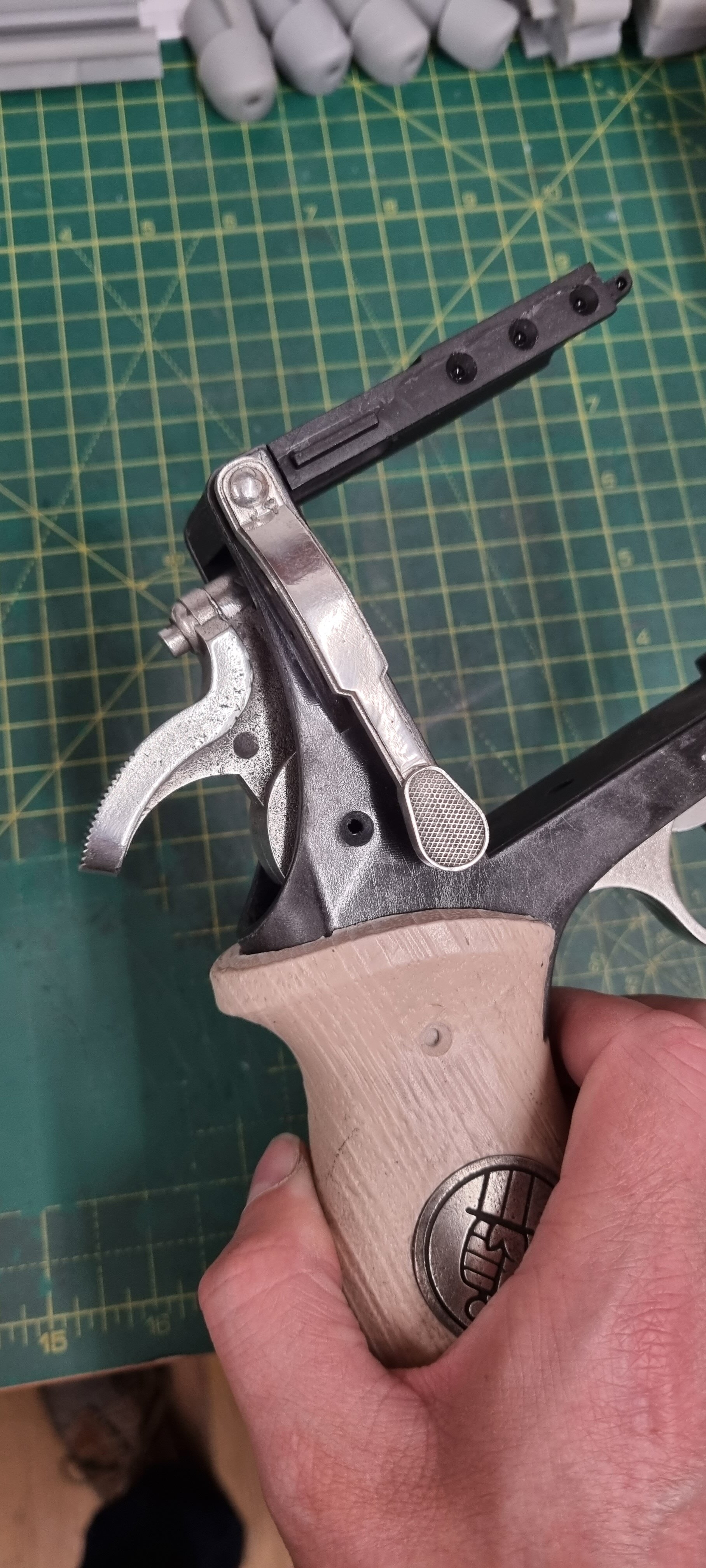

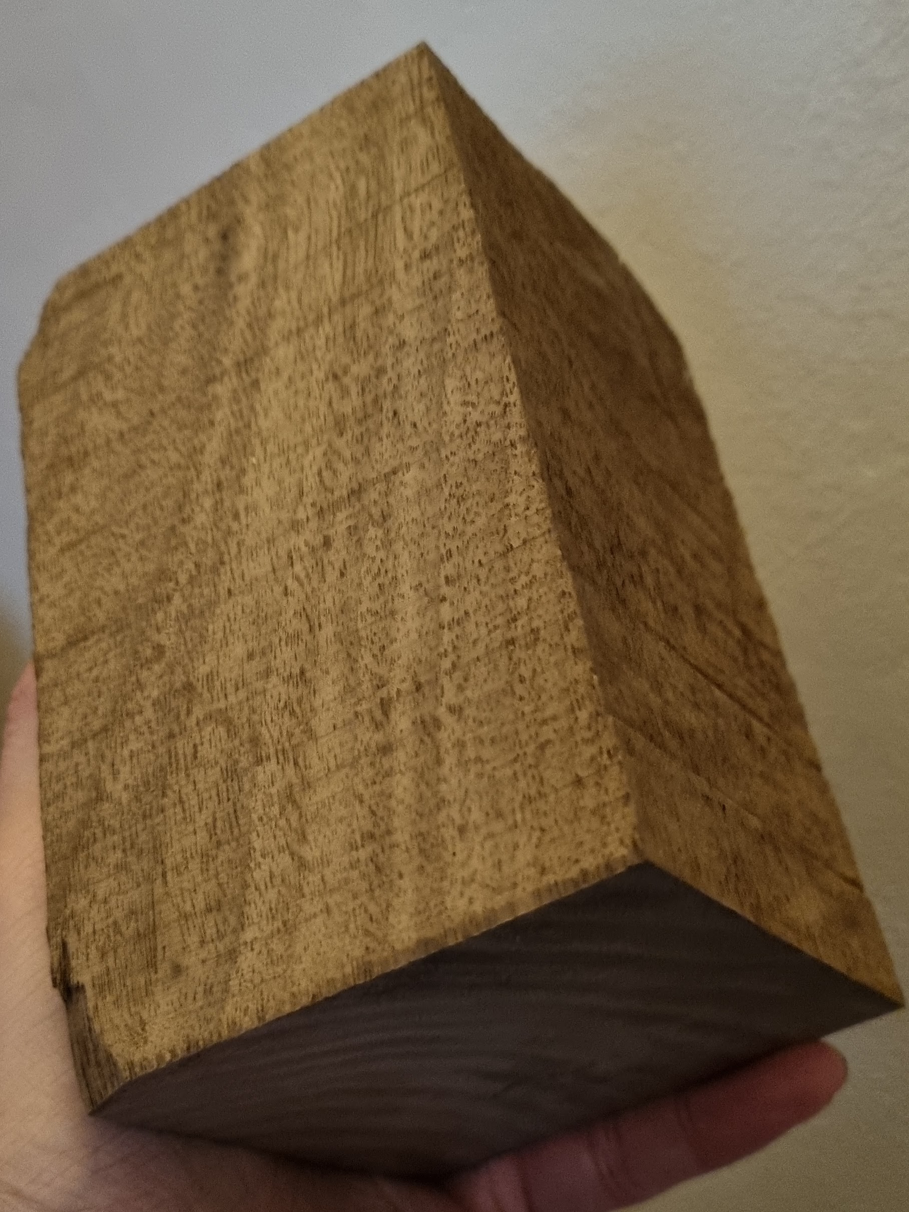

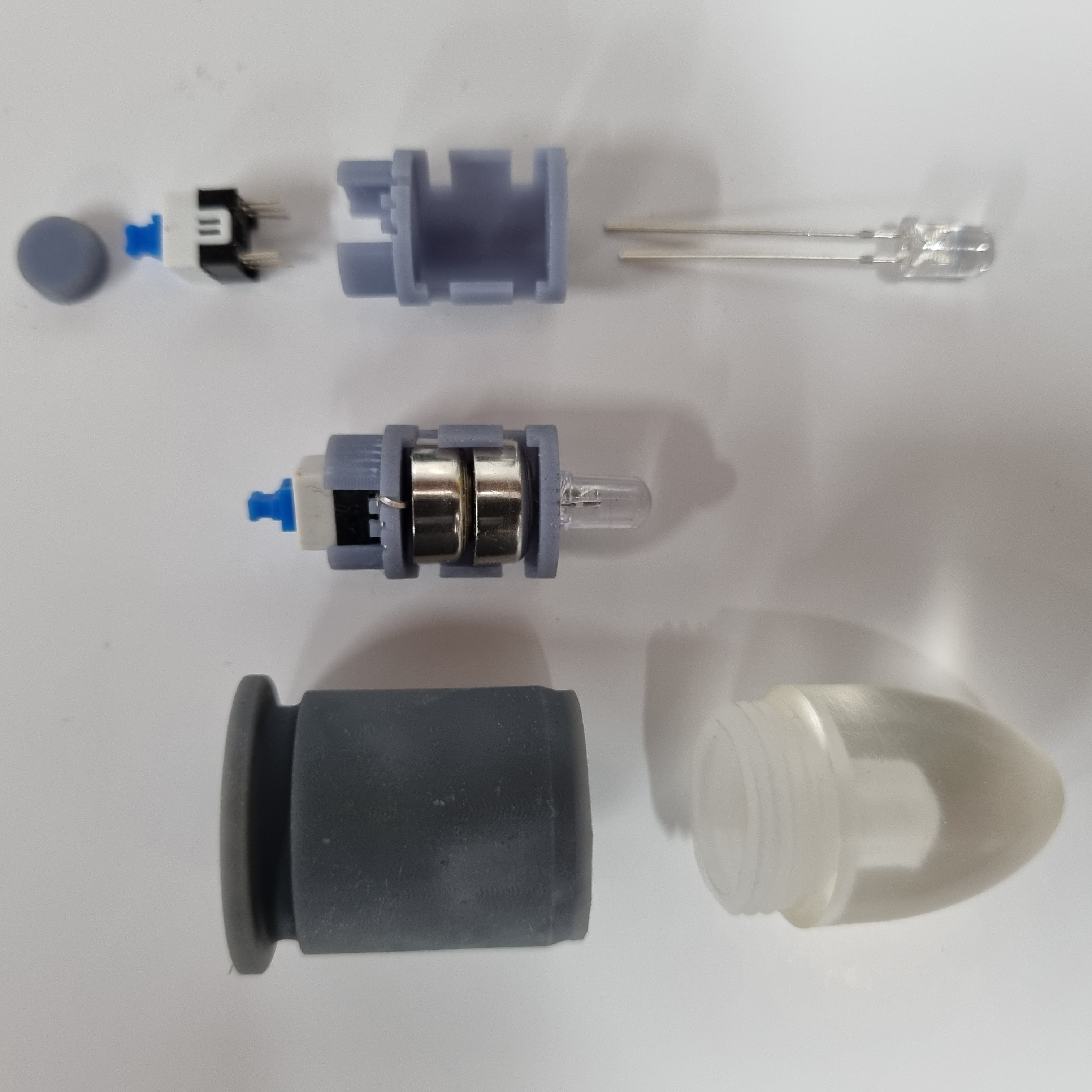

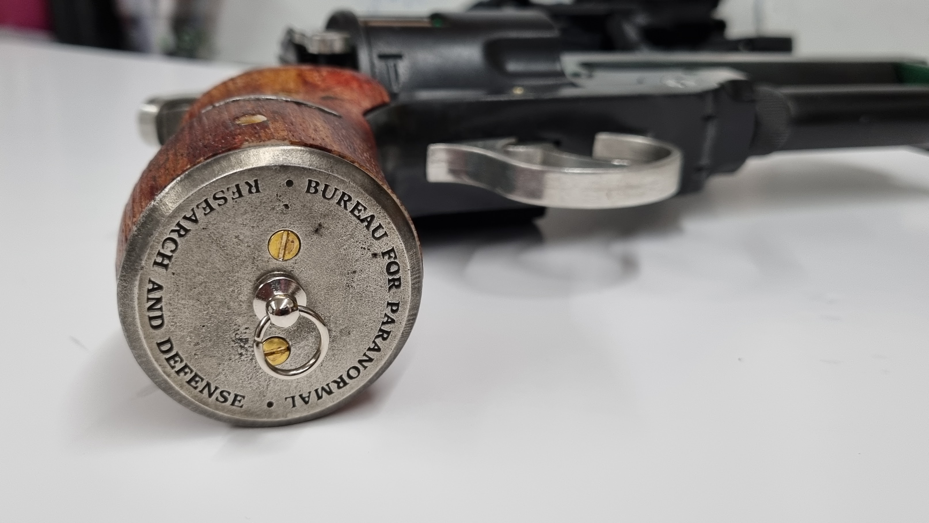

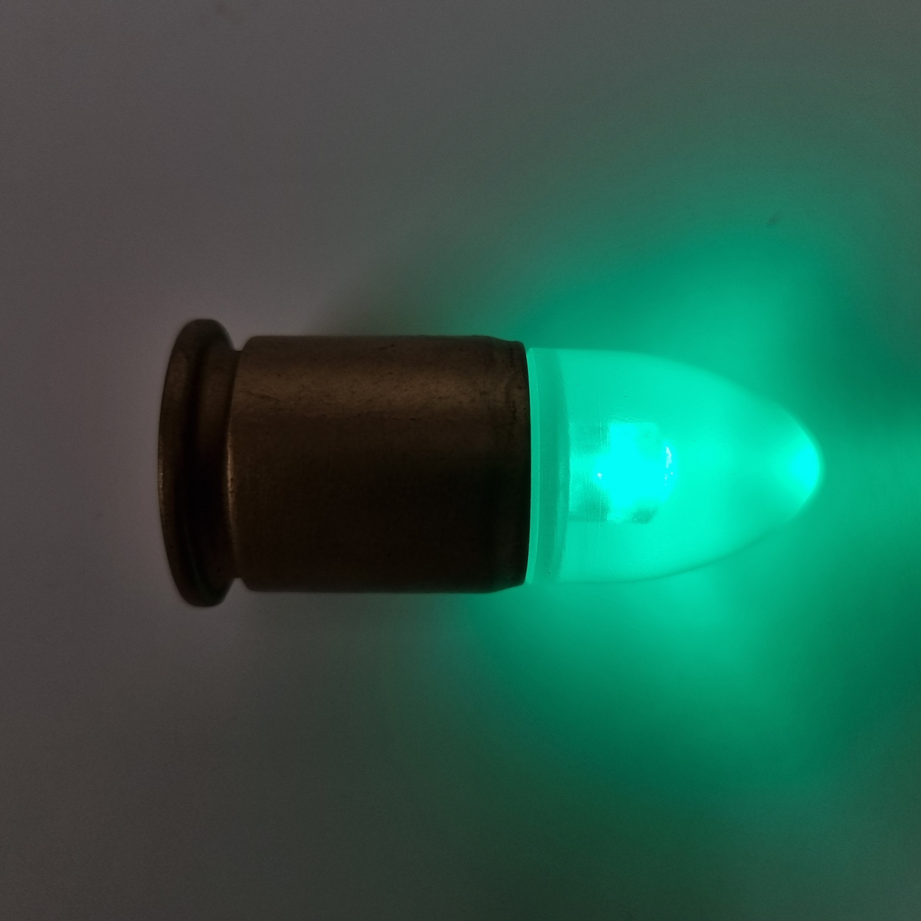

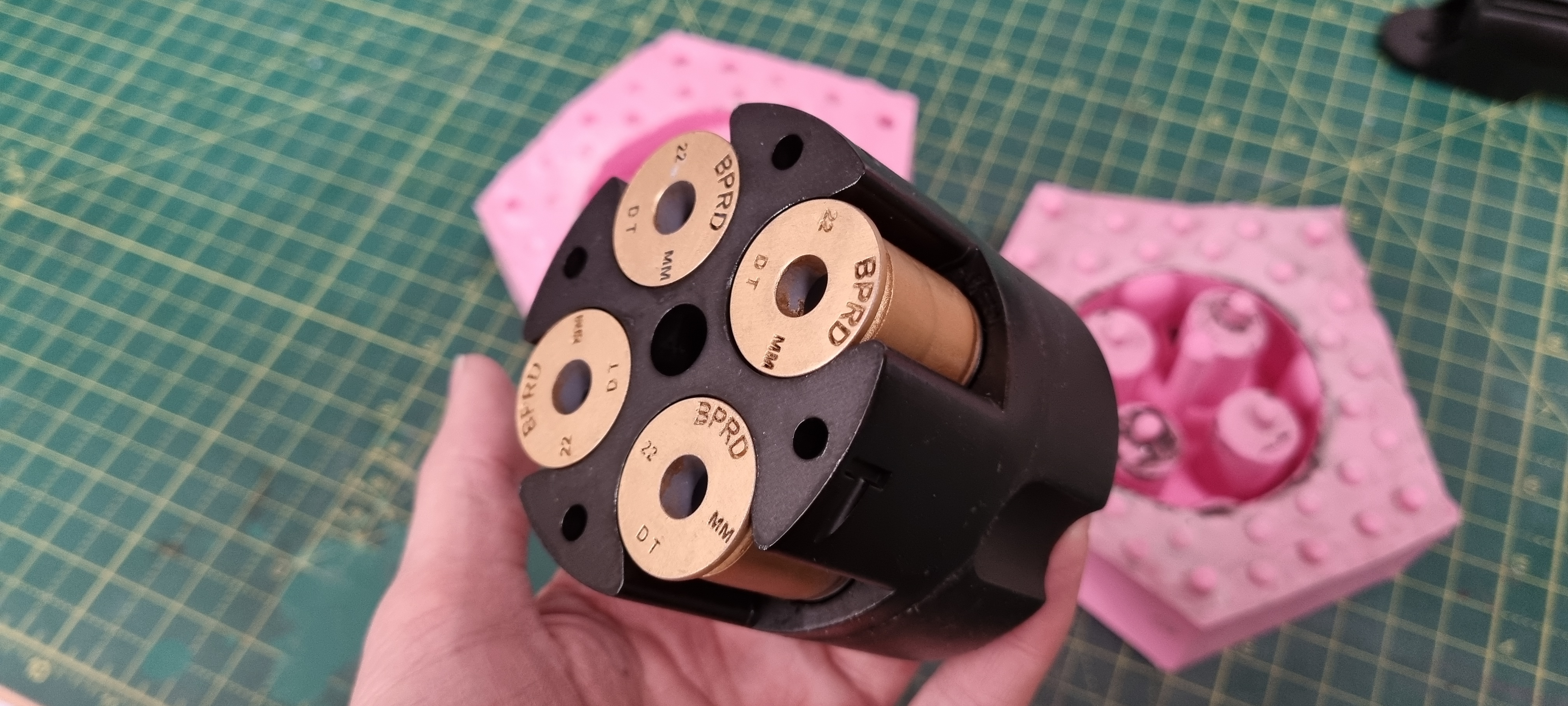

I got one of the Bullets wired too, I still have a few more jobs to do. I need to wire the laser, that is activated by the trigger via a switch. I need to electroplate the Hammer, Side Catch and Trigger so they're Brass and finally I got myself a lovely chunk of Walnut to carve into a new Grip!

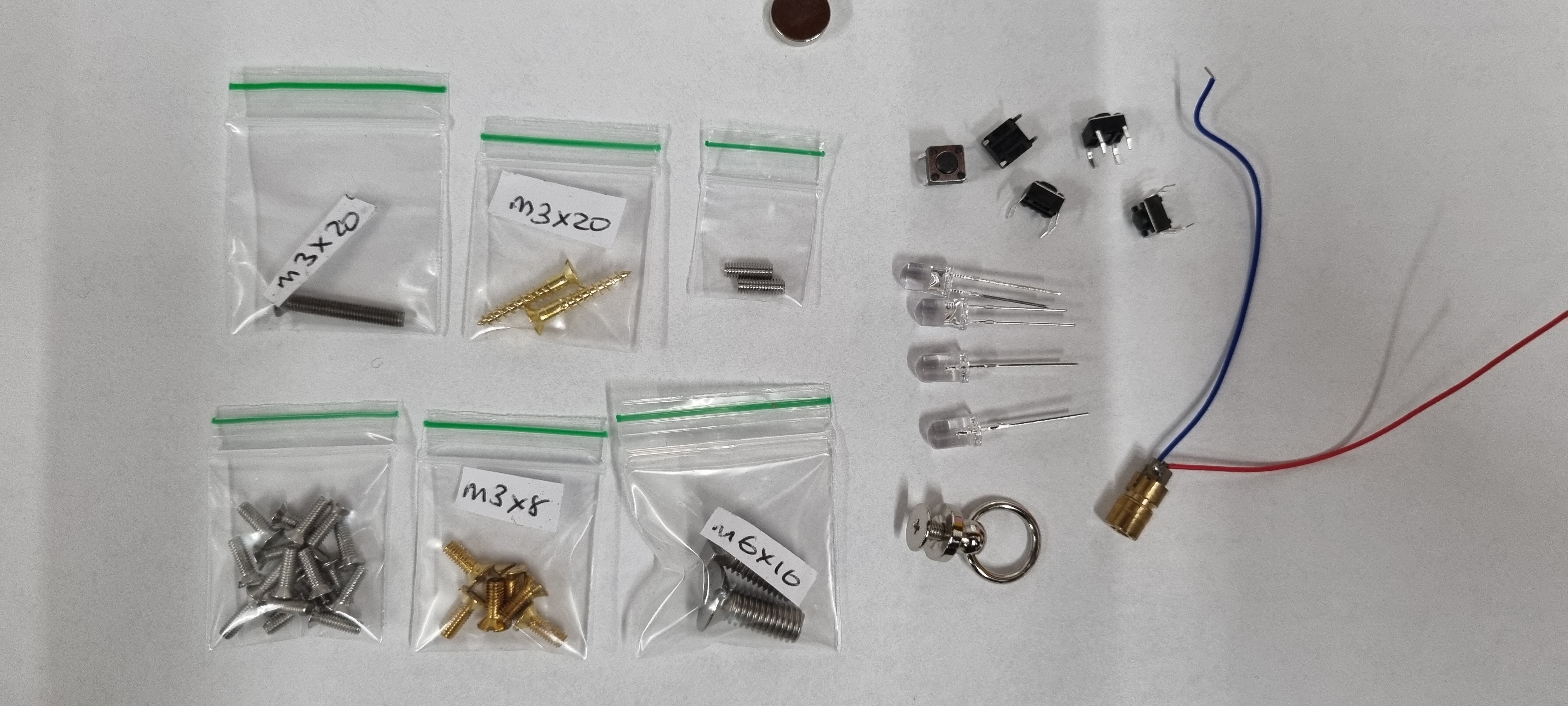

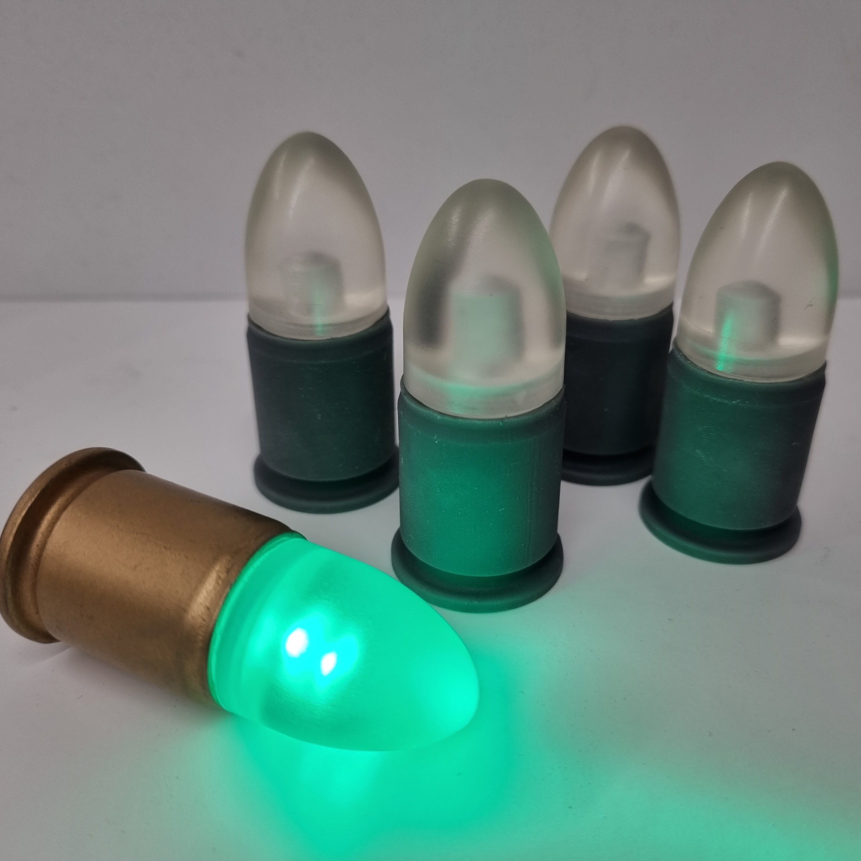

Since starting the run I have had quite a few requests to make the bullets on their own available, so I have done just that! I can only do them as a DIY kit for now as I have other projects on. So if you're interested they're available on my Website Hell Boy

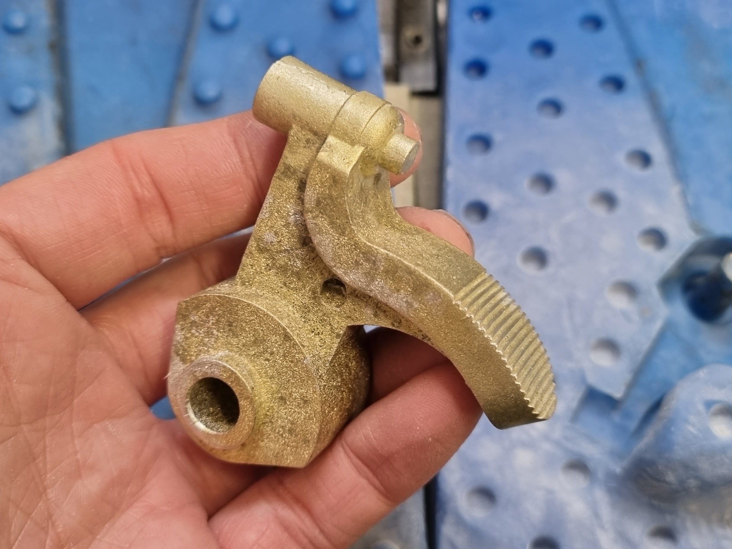

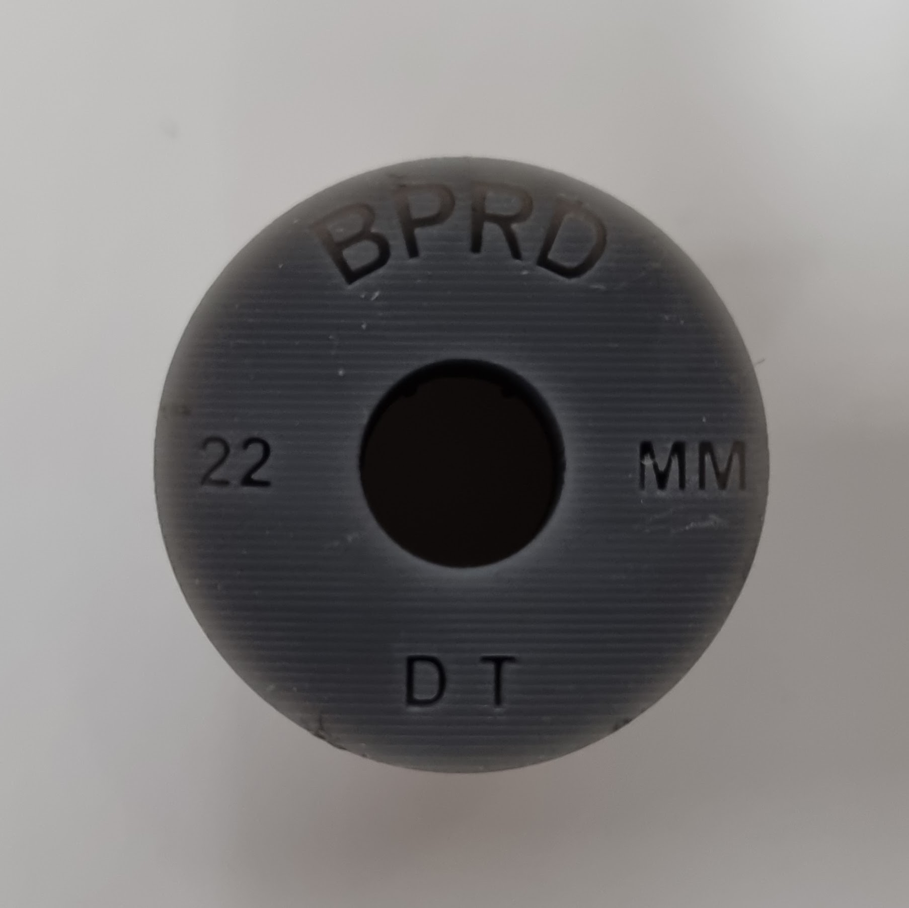

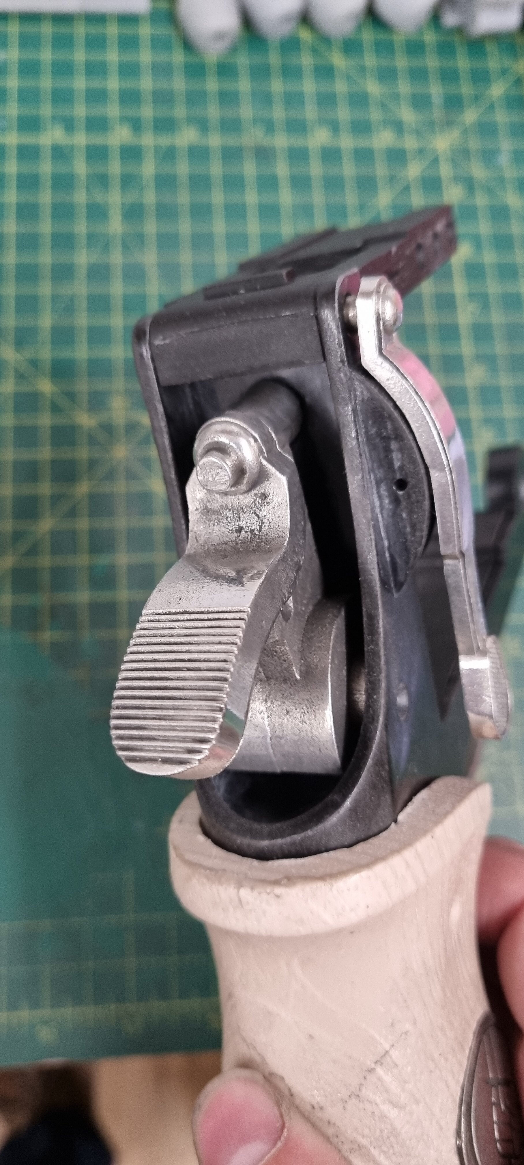

I got myself a desktop Lathe so that I can turn some Brass as the 3D resin printed bushings are a little too soft for the job. I completed my first set today and I'm quite happy with the results.
Turned to speck, drilled and tapped all on the Lathe :)
