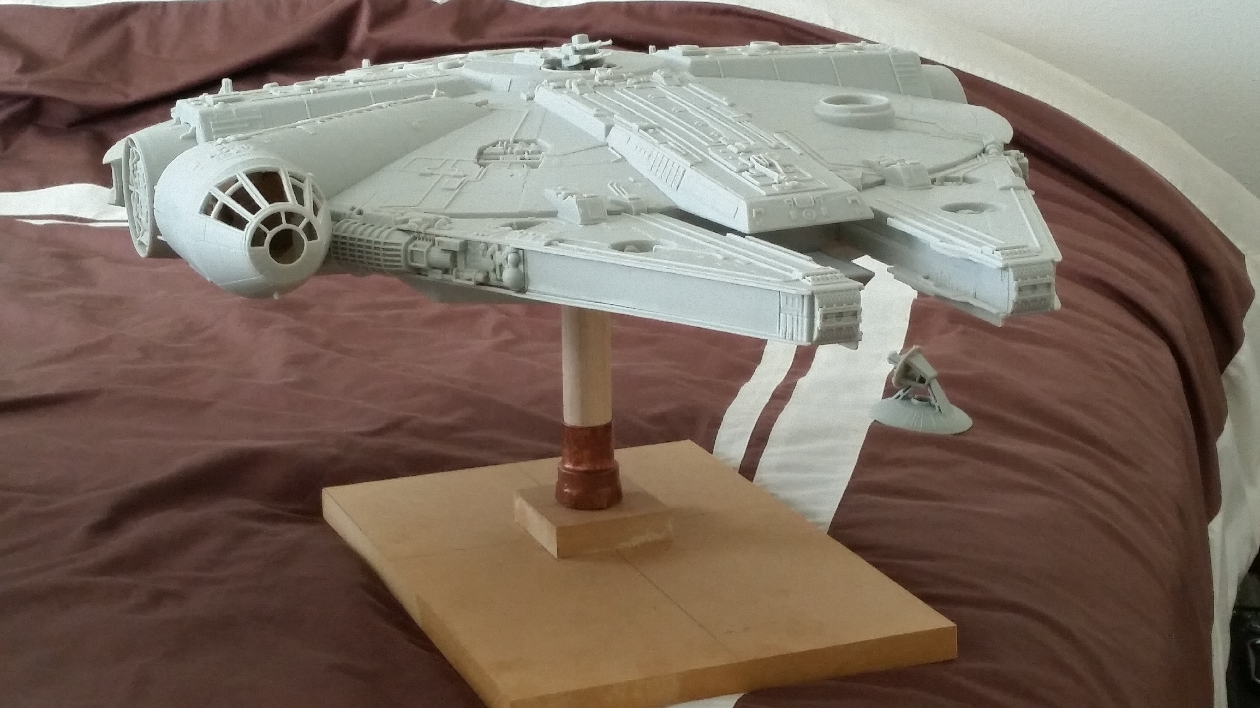

I also started the beginnings of a stand this week. Not sure how I want it to sit on there yet.

On this build I think ill mount it from the docking port on the side am mount it on a wall. On the 32" Hasbro MF ill do a MR style base.

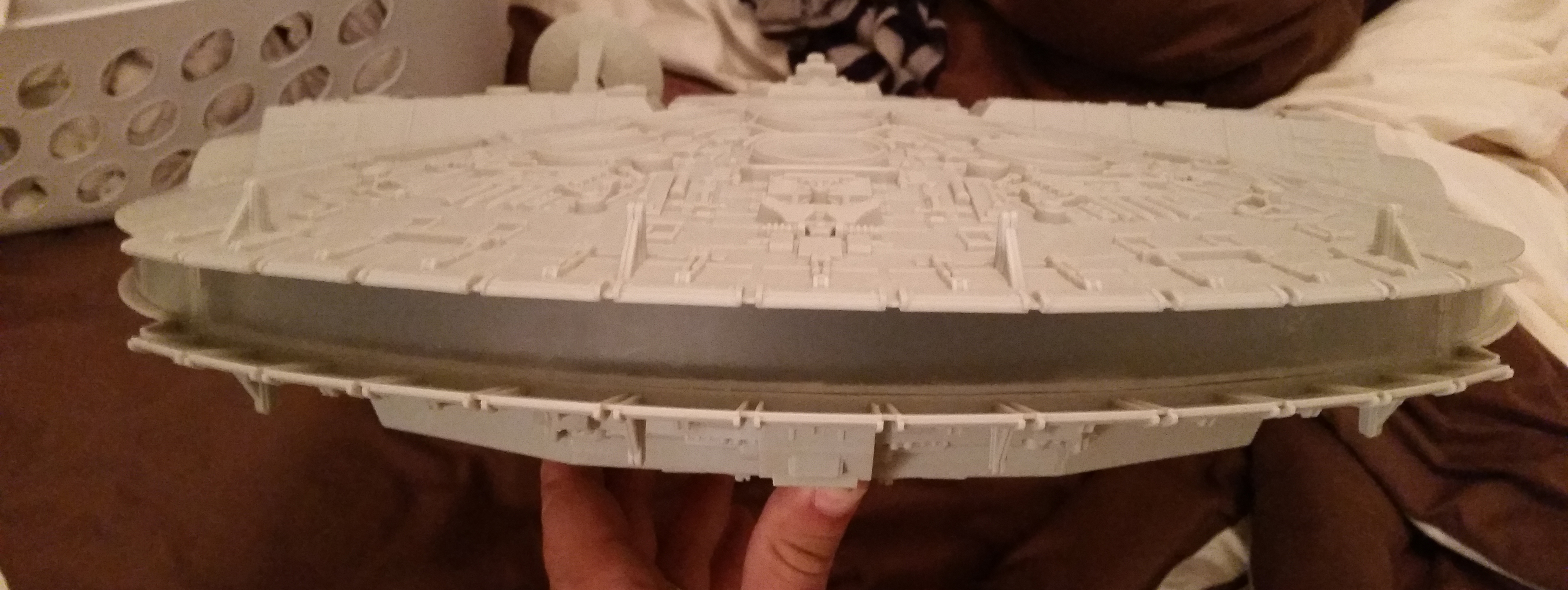

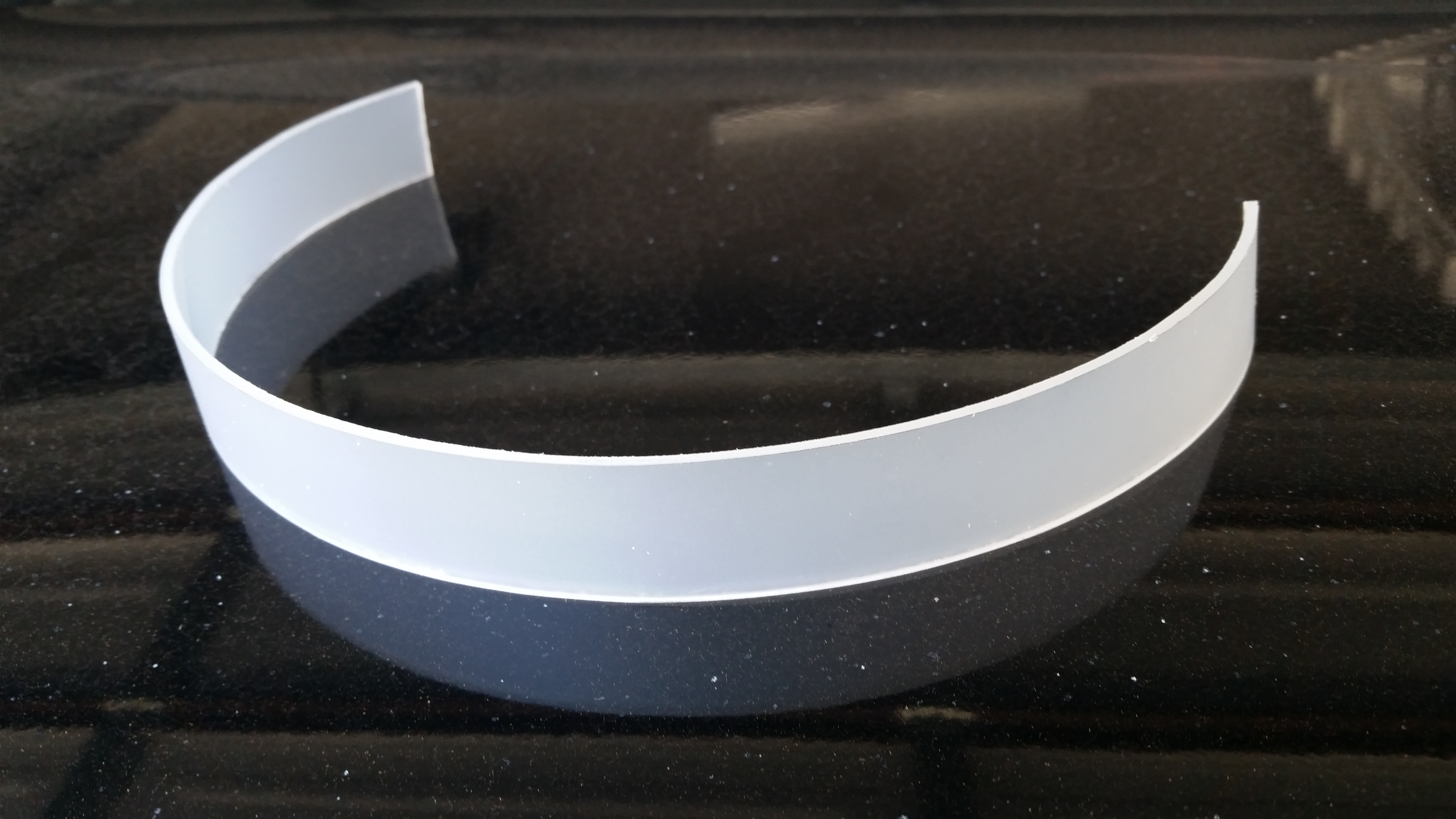

I found this little waste basket at the drug store and thought it would work perfect for the semi translucent engines. First I used a piece of painters tape to mark off the length and then stuck it to the waste basket.
Next I cut it out with my dremel then used my belt sander and a utility knife to smooth it out.
I cut out the plastic piece that was on the falcon then I used my gas stove top to get the new peice hot and bend it to a better suited radius for my falcon and then vuala!
