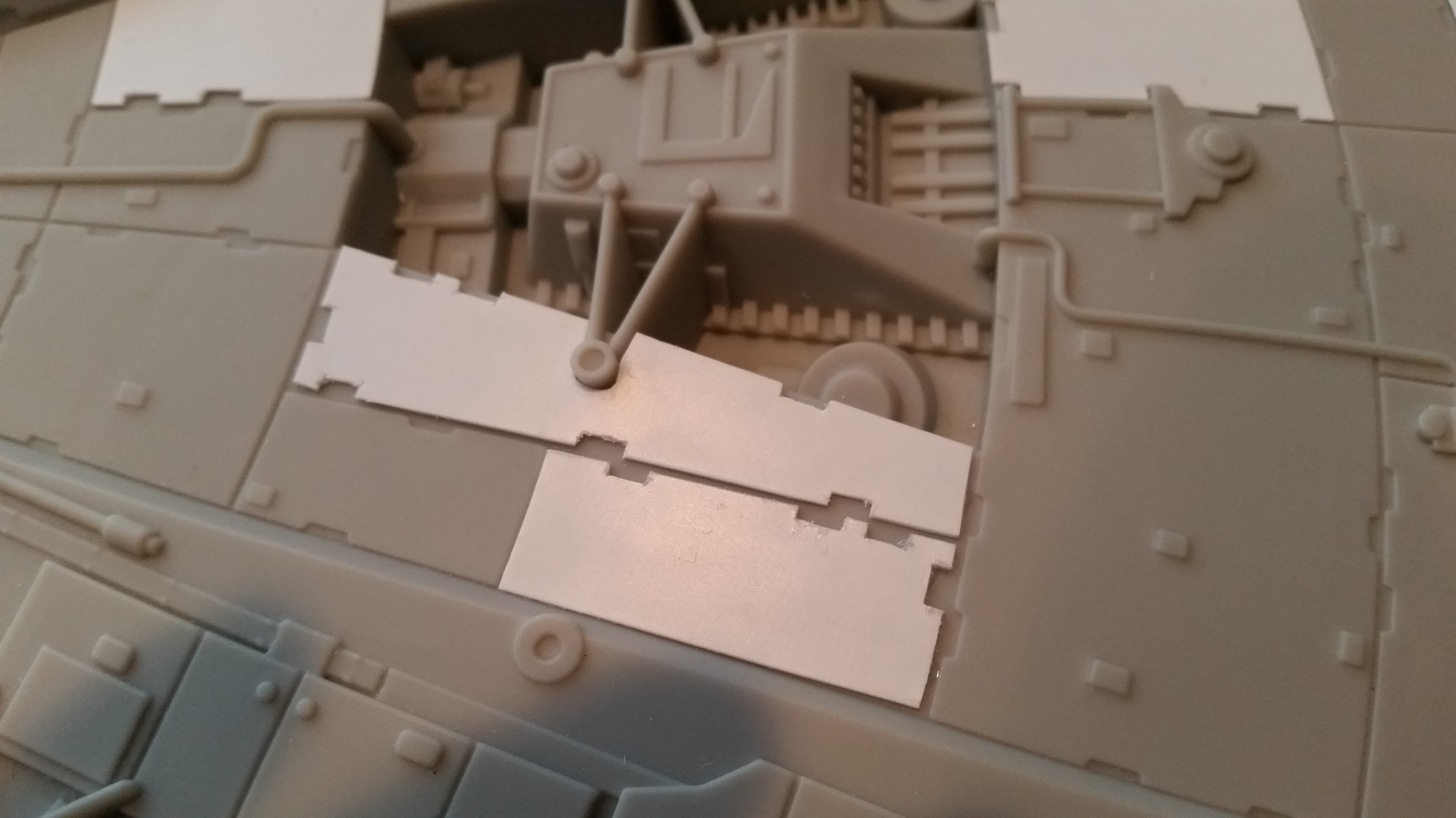

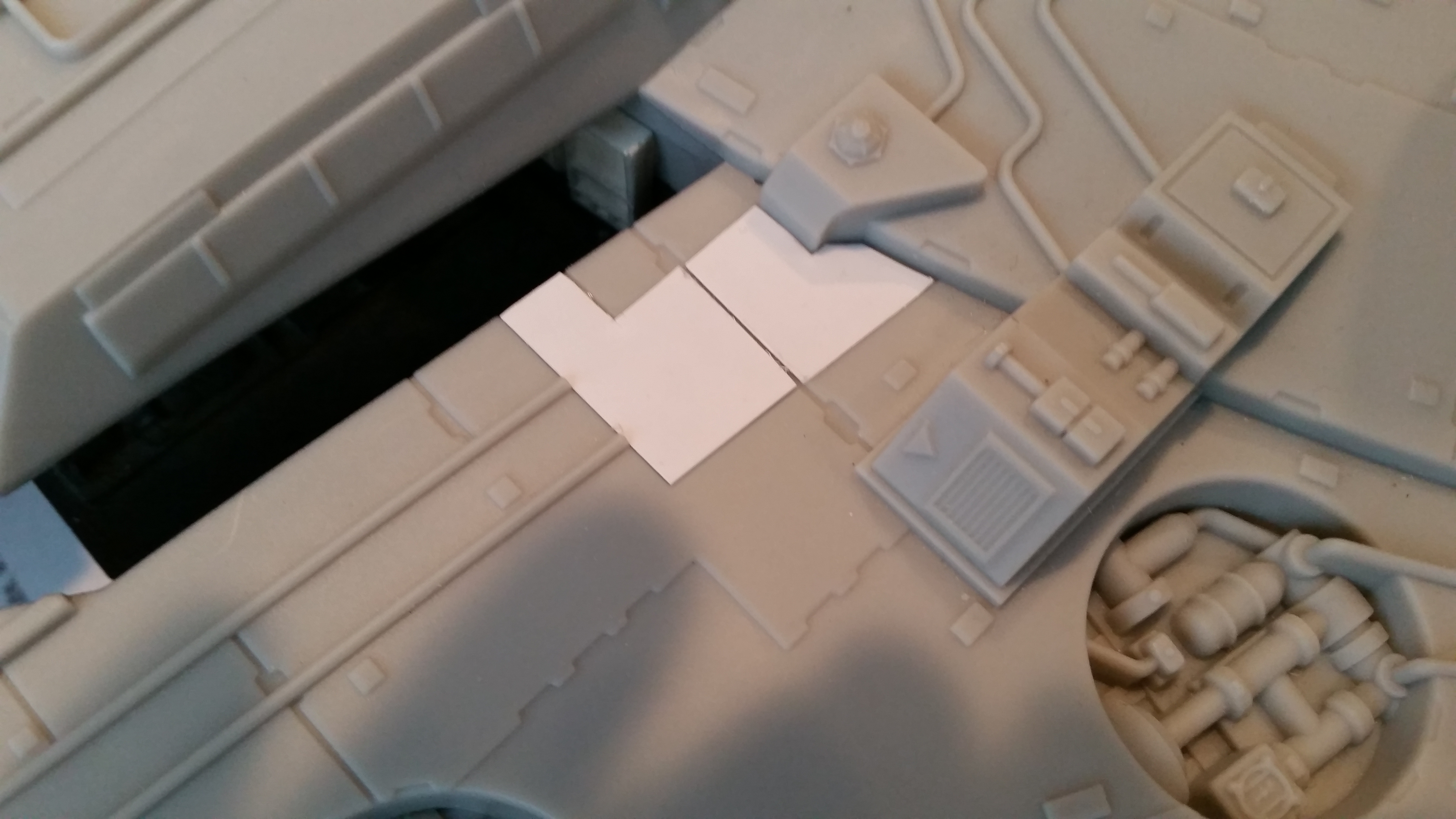

I found the sticker template to be a little under sized. When I cut them out I just included a .5 mm boarder as I cut them out. I test fit them, then traced them onto the styrene before cutting them out again. They're fairly accurate, but found in order to be completely accurate, I had to make 2 pieces out of their template of one piece on occasion. I did this on about 5 pieces. I counted a total of 36-38 on top. The other pain in the butt is cutting all the little notches out, not to mention adding the little square greeblies that are all over the Falcon hull. The good news, is I think I only count 13 that need to be cut out for the bottom. Here's what I mean about cutting some pieces into two.
View attachment 477453View attachment 477452
These were originally 1 piece according to the stickers, but are actually 2 on the real Falcon.
Kokkari, what did you use to cut out the little notches? did you make a template out of something? just free hand the whole thing?
Nothing complicated. I had a pattern where I traced it onto the styrene pieces then I cut them out with an exacto knife. I then used a file to clean them up.
