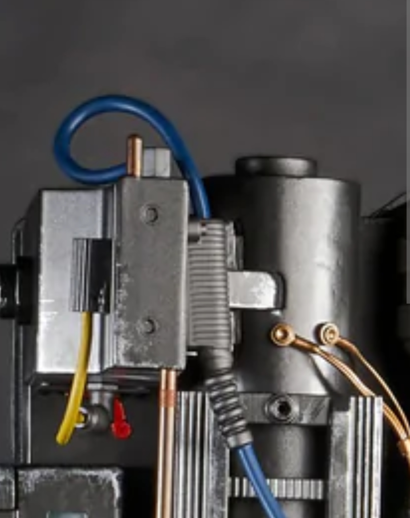

That is really odd why they would change that but keep so many of the other tiny details, less obvious details. Hmmmm...
-B89!
The funny thing is the hex heads were part of the iron arm piece on the Hasbro prototype. I don't understand why they would remove that. The other major difference between the prototype and final product is the scuba hose section of the wand loom being black instead of green.

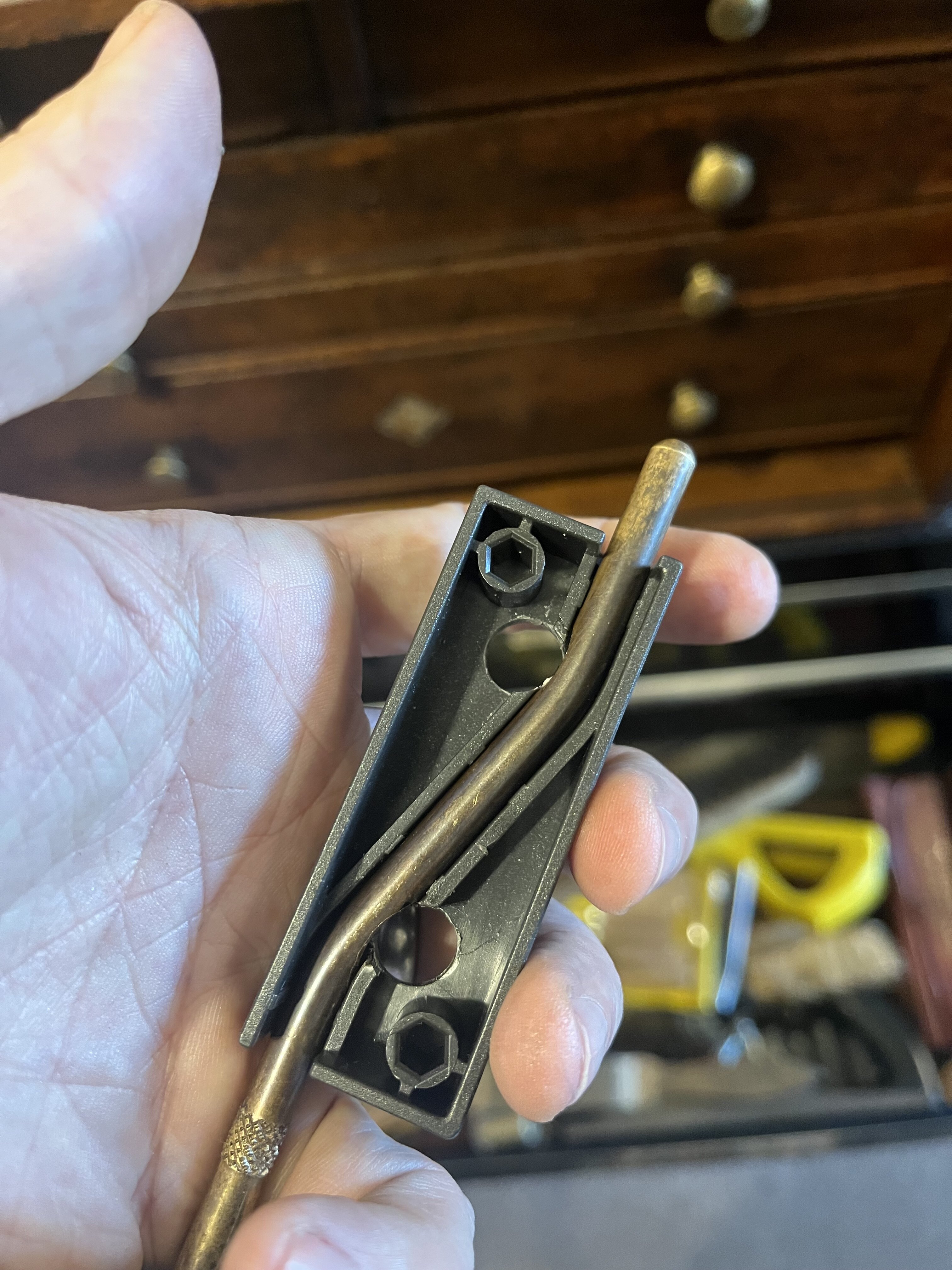

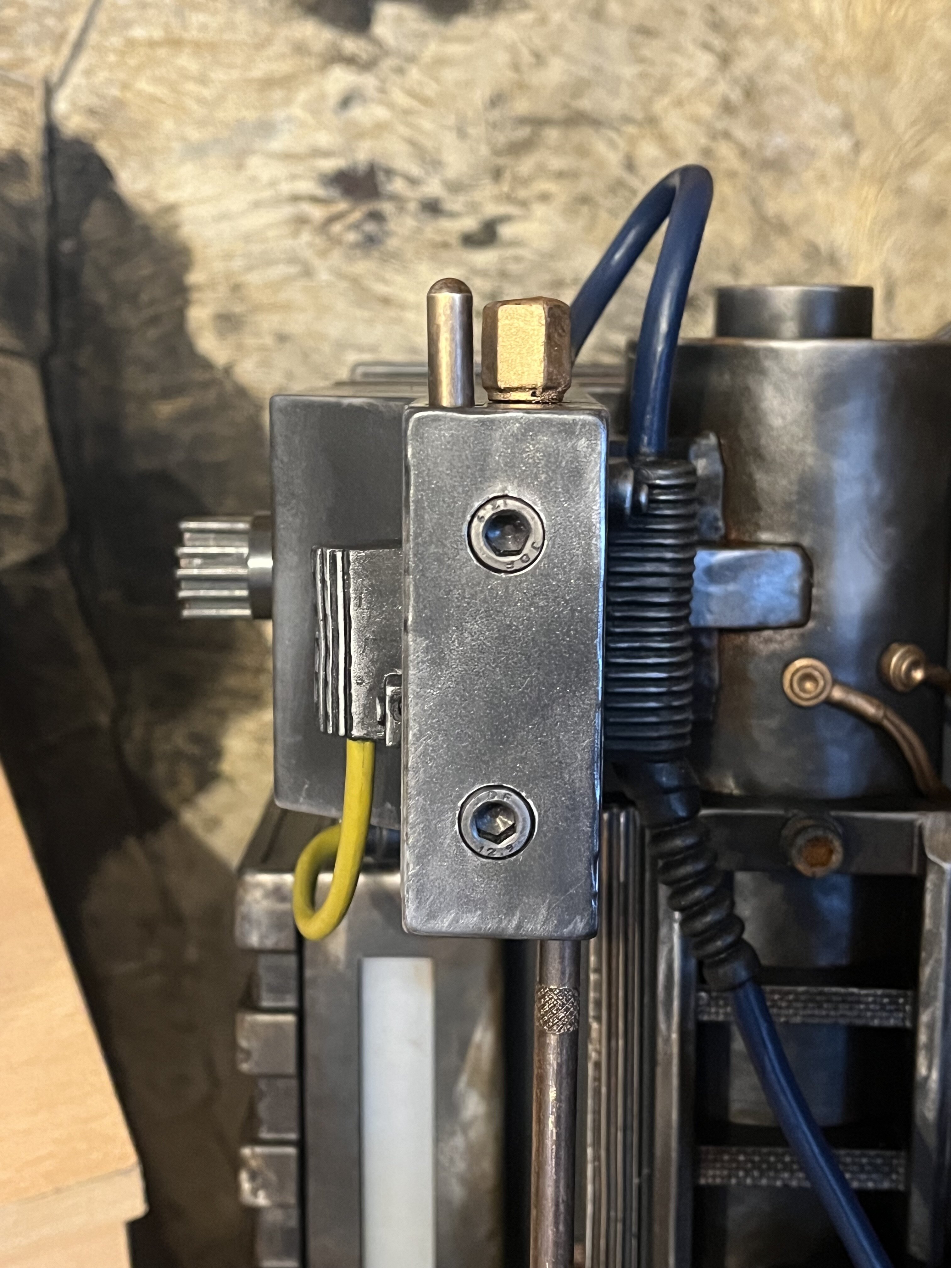

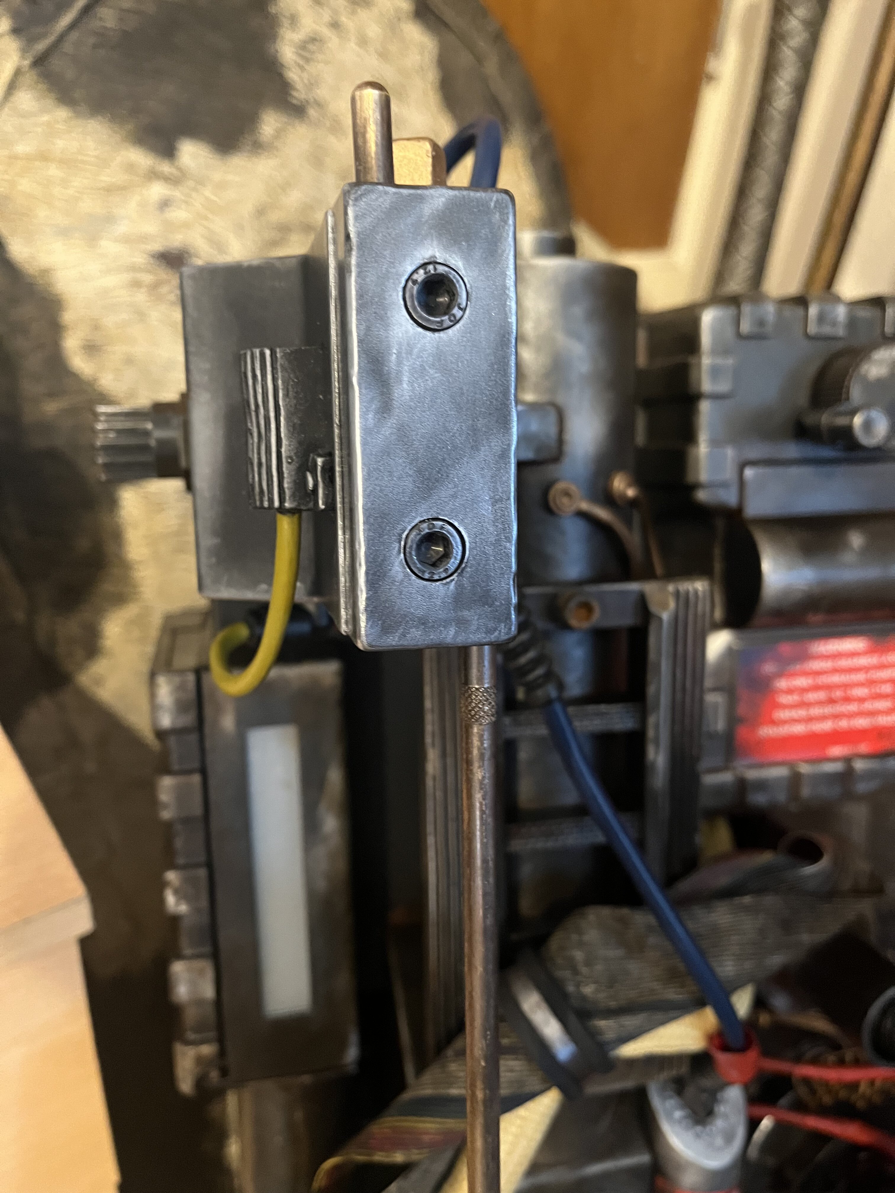

I've updated my Ion Arm, and it's now bolted into place.
I used M6 cap head bolts (which I had left over from the ladder frame), which have a 9.5mm head. I initially drilled two 5mm holes, about 36mm apart, through the removable Ion Arm and into the main part of the pack where it mounts. I tapped that to M6, and then expanded the hole the centre of outer part to 10mm.
Everything should fit, but I was about 0.5mm out and the head of the bolts just fouled the brass. So I filed a little away from the brass rod near the bolt hole and now everything fits fine and the bolts recess flush with the surface of the plastic part.
This does destroy the screw bosses which hold the back plate on, but this isn't too much of a deal as the new bolts mechanically connect everything together anyway.
View attachment 1661666 View attachment 1661667 View attachment 1661668
I don’t quite understand how this holds it onto the pack, with the holes big enough for the nuts to sit recessed into the plate, can’t it just slide off the heads of those nuts?
