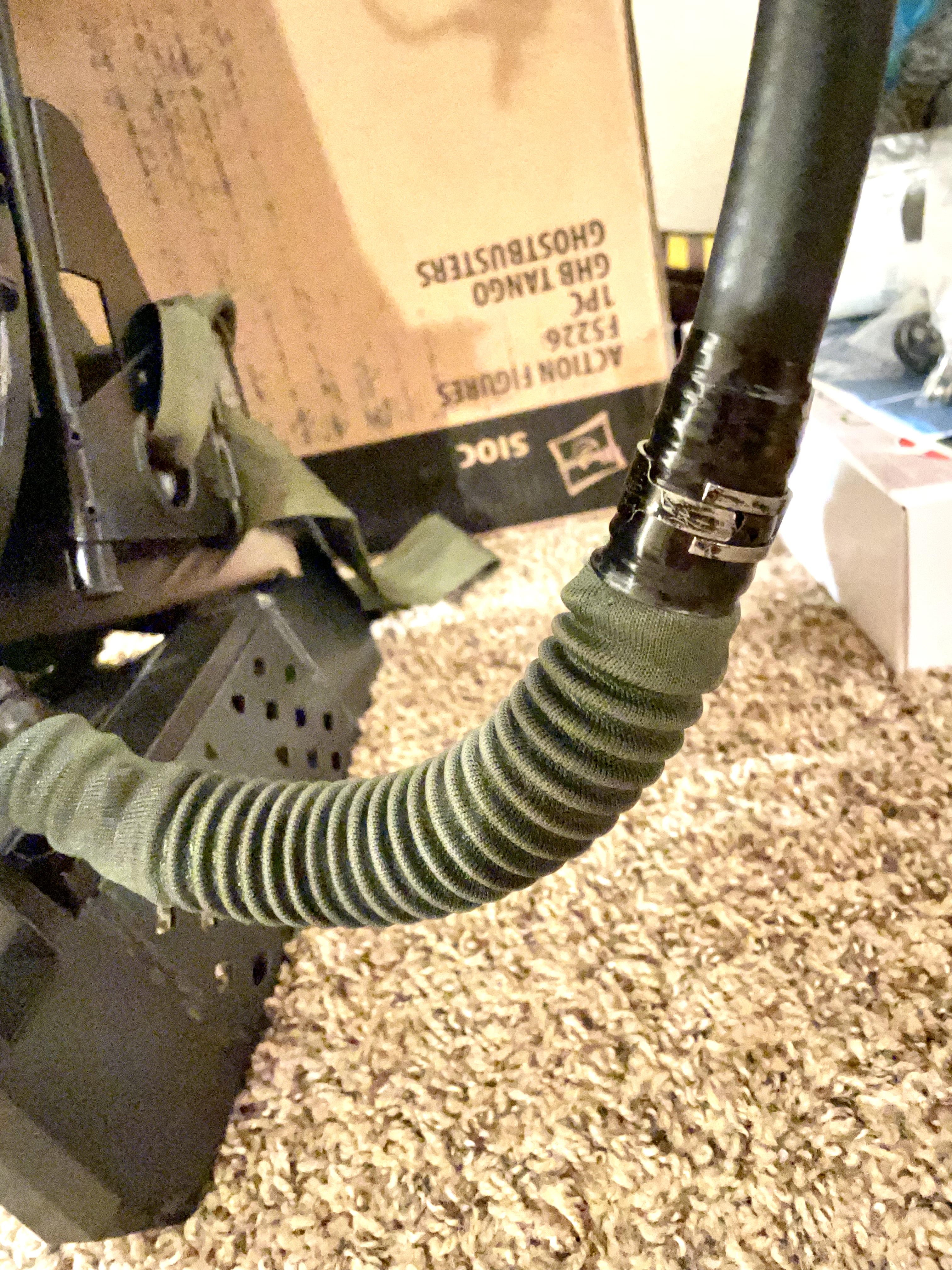

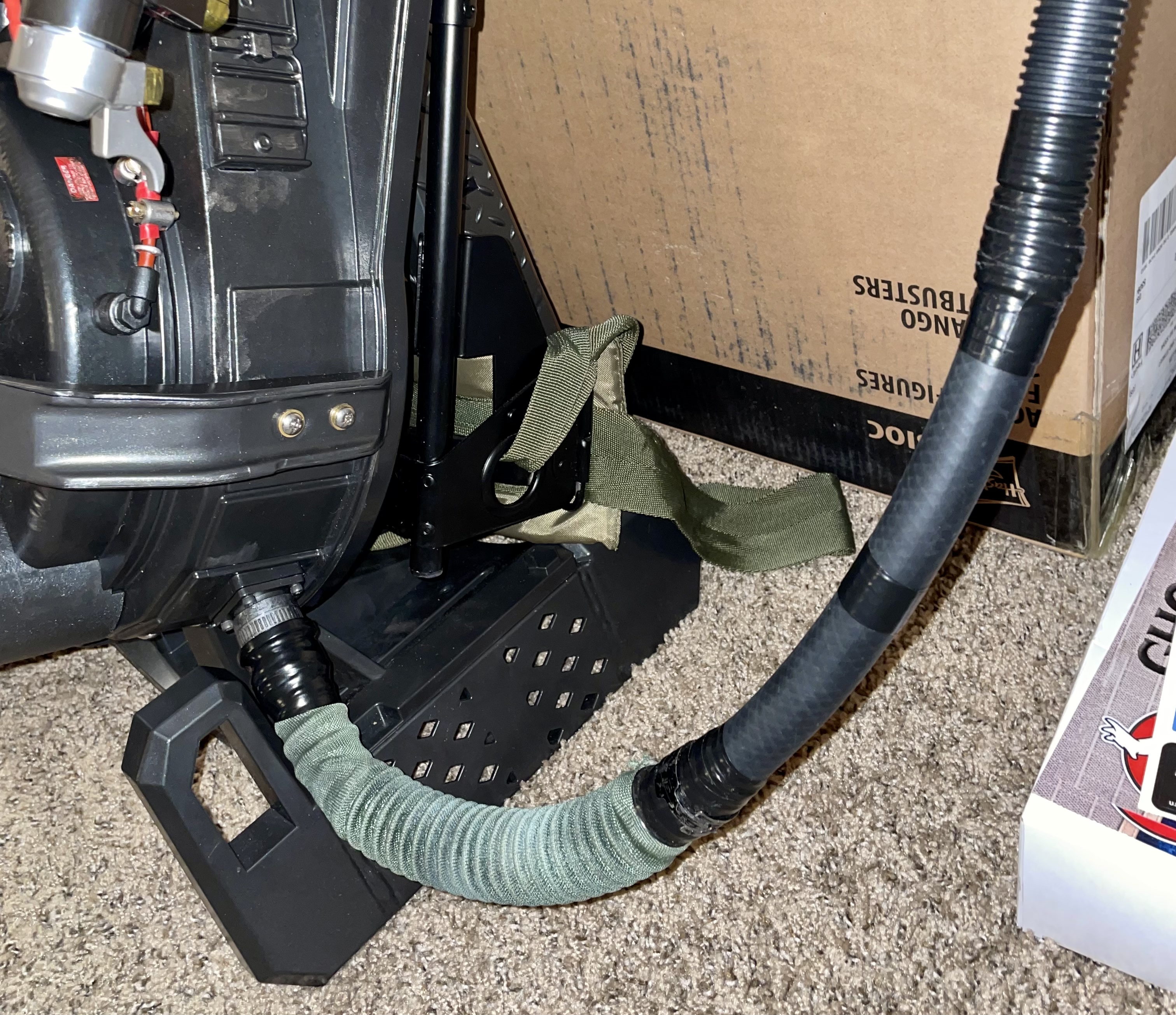

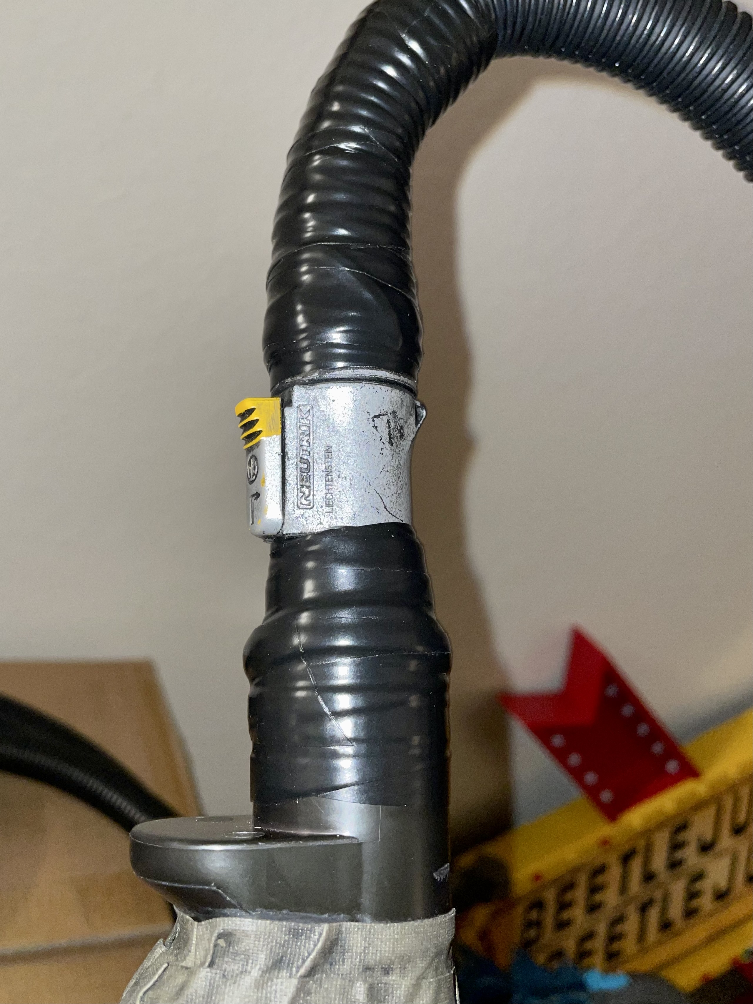

A few have mentioned this is some of the Hasbro Pack FB groups - some have suggested a piece of electrical tape around the internal hose fitting on the pack seems to solve it. For some there is just a bit too much play which can cause the pack to shut down if the hose is wiggled. There's a video here with someone showing the fix - give it a go and hopefully sorts it. I've seen Hasbro has sent out a few replacement hoses to people as well so worth reaching out to them.
I have a second pack to open up and make sre it works. After I do I may reach out to hasbro just to see if they'll send a hose. But most likely it's gonna be the electrical tape tin foil solution. They probably wouldn't have too much of an issue if the hose wasn't so stiff.

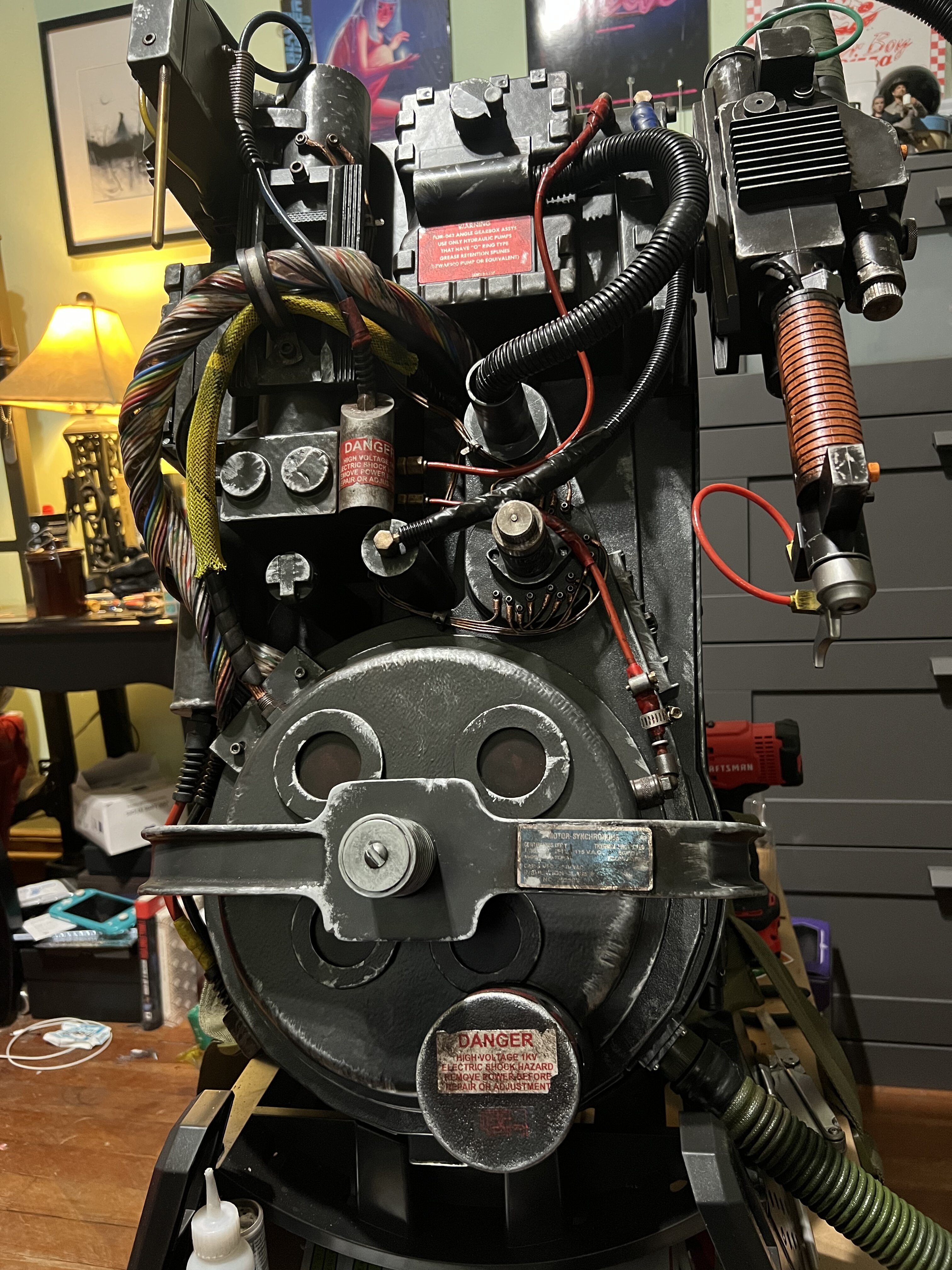

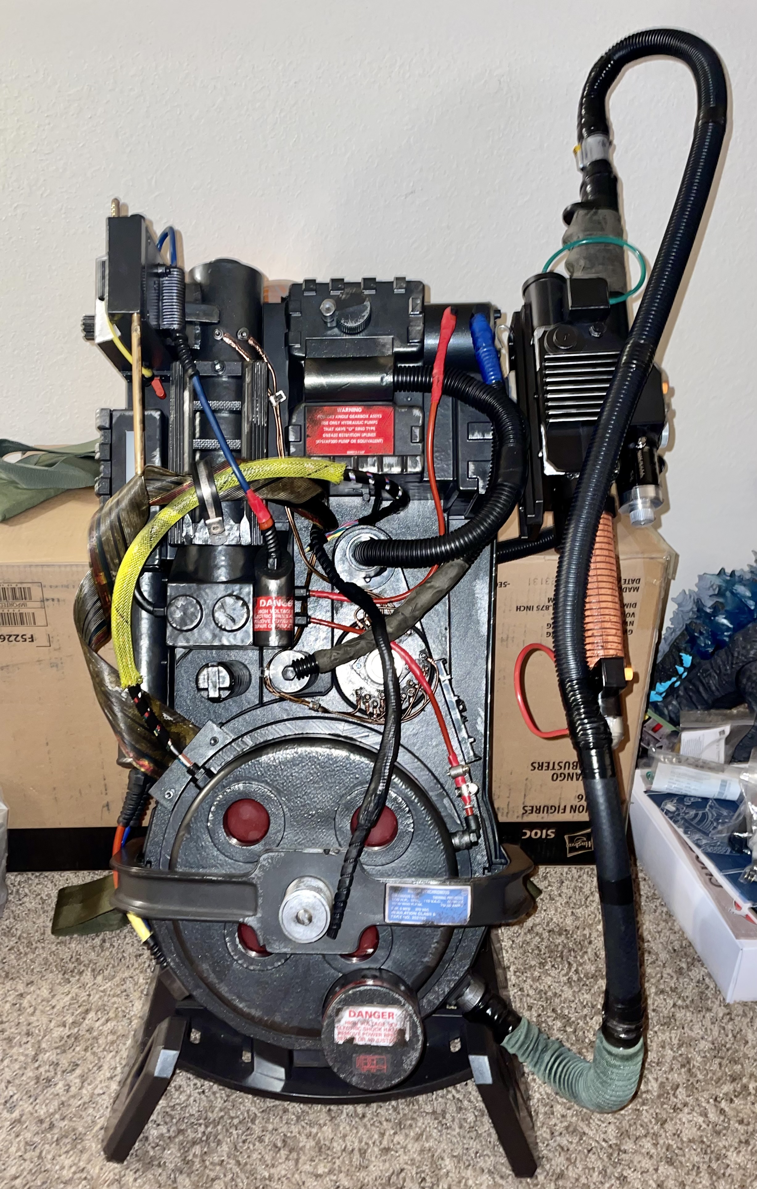

Finished my full hose & loom replacement with real parts. Ignore the rest as it’s in a state of mid-modification.
Couple more updates. Opened up the pack and replaced the power cell lense with a piece of smoked acrylic.
Also, the mad lads at Hasbro read our minds. I was tired of opening the cyclotron to switch modes. Hasbro included a mount in the dummy switch that the mode switch fits perfectly into. If you attempt this mod, just note that you will only want to push the switch in until it’s flush with the top of the mount. I added a dab of super glue so it would not move. The only downside is the mode switch Will no longer make the sound effect when you switch modes. It seems like it only makes that sound if the cyclotron cover is removed.
